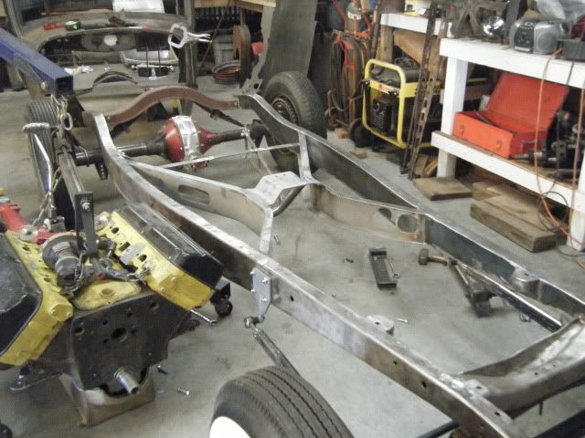

    Time to finalize some things. First up were the split wishbones. In order to get the bung to look right, I needed to pie cut the ends.
    Got them all welded up and tacked in the bungs for one more check.
    I decided to put a string line on it to make sure I was were I needed to be.
    About the time I got down on all fours to check the string, "Big ***y" (my favorite neighbor Lyle) came through the door. He was looking at me laughing and I said, "Hey go sit on the back spring so I can see what it does". I'm not sure what Big ***y weighs but I don't call him Little ***y for a reason! Lyle and I were laughing when I took the picture. It all looked good and he was good sport!

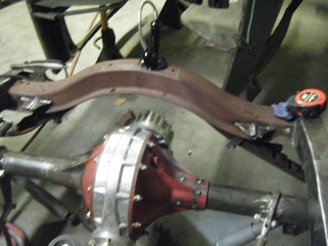

    Time to finalize the rear crossmember. I cut a wedge out of 2x3 and welded everything in.

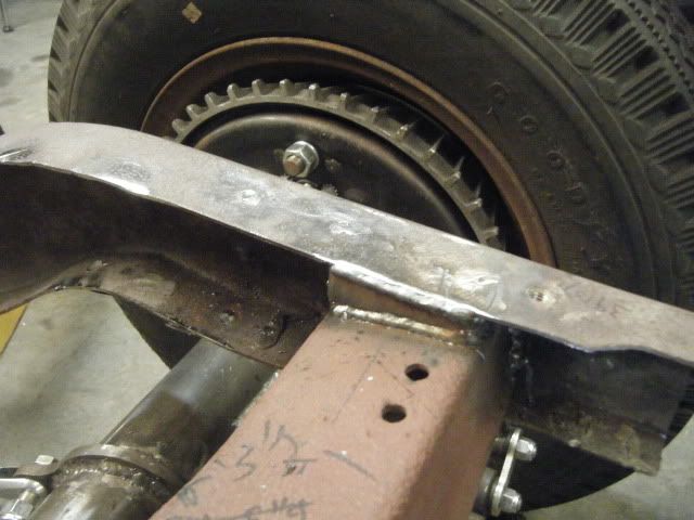

    Got the rear boxing plates welded in.
    Pulled the engine out again to start boxing the front end. I have lost track of how many times but I am getting closer.
    Always feel like I am going to forget something. Here I am in my dirty girl thinker pose! ;)

    Got the front boxing plates in. Man that is a lot of welding and grinding!

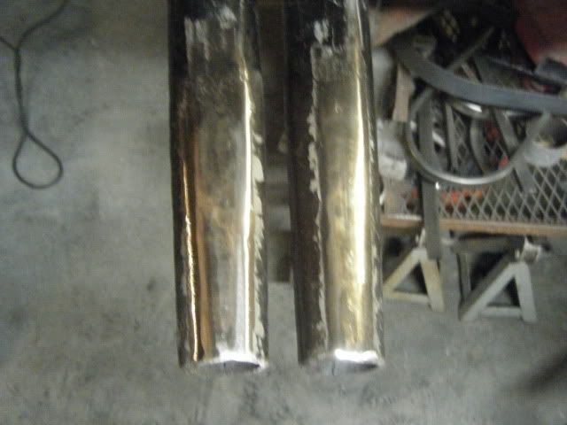

    My Porter Mufflers came in. I decided to let someone else run the exhaust and bell the ends for the scavenger pipe look. Everything was going great until I went to grab some lunch. When I came back, this is what I had. My Dad always told me - "If you want something done right, do it yourself"! Time premitting (Lonestar Roundup), I will redo it myself.

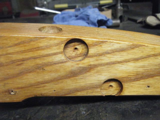

    Pie cut on the Hurst shifter which was in my knee.

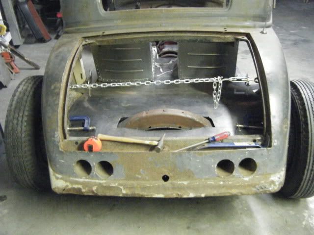

    Rear deck lid is about an 1/8 too wide in this area. Any suggestions?? Bracing??
