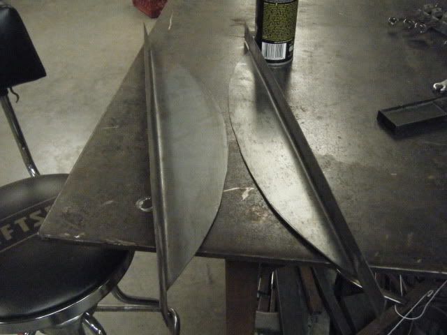

    I went ahead and Shellac'd the wood kit. I know, I know, but it will be preserved, covered up and I like it.
    You know those people on TV never make faces like this or do they edit it out? Scary!! Not sure how many times I was hit on the head while trying to get everything marked.
    Back out and back in.
    Door headers, pillars and top bow in.
    I have a problem here on the rear top bow. With the p***enger side partially bolted in, the drivers side bolt hole is off about a 1/2". The pencil mark on the wood is where the bolt hole is that should be lining up with the inside hole on the bracket. There is no way that body has a 1/2 give up there. Does anyone have a measurement of the inside bracket bolt hole from the p***enger to the drivers side?
    Had two warm days so I got the rear wheels painted. I will let them cure a few days before I mount the tires.
    Started finishing up the rear floor.
    Time to make a rear crossmember cover. My sheet metal brake didn't like the 16 gauge. I ended up having to use cheater pipes and a lot of straining. I got it tacked together.

    Hey Kathy, is the bracket in the same place on the drivers side?
    One of mine was off by about 3/8" on one side, just thinking out loud here but I realized my body wasn't as square as I thought it was, took a little work but it all came out ok.
    I need to make that rear spring mount cover for mine this weekend, Are you going to make it removeable or weld it in place?

    Paul, I have to go to work to rest;), it's the only place I set down. I'm not getting much done working 14 (12's) and I have been trying to get sick. I can't get sick that ot is designated for Hemi parts!:) That poor pool table.
    Gary, I will make it removable. It turned out way bigger than I thought - too bad it can't double for a cooler or something;). Richard D would make a beer holder in there. I may cut it down and use some flat bar on the edges?
