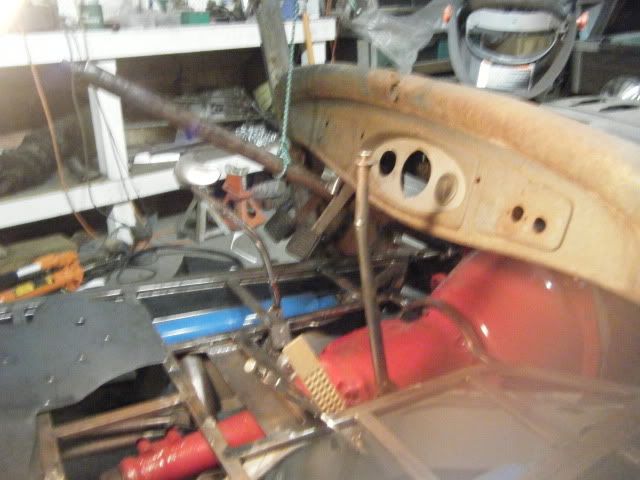

    OK, the trans tunnel looked cool but I opted for more leg room and redid some stuff.
    I could have added to the floor that I already had cut out but I decided to start a new one and fix a few other places that I was a little short. Note the old one to the right.
    Got it roughed in and cut the shifter hole.

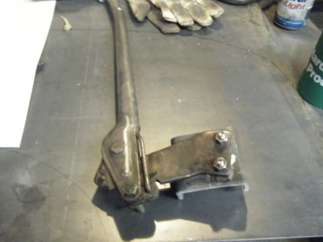

    Almost welded it but decided to wait until the next night. Good thing cause I had forgot something. Made a bracket, welded on some bolts, and fitted it to crossmember. It took forever because I needed to make it removable and easy to get to. I can just reach it from the firewall (if needed).
    Got it tacked in.
    Starting to look like a car (at least I keep telling myself that).

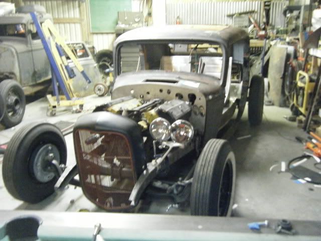

    I still need to figure out the cooling issue. It doesn't appear that Ron ever ran a mechanical fan. The only way I can run one, is to raise the grill up to this height. I just set the grill and lights on for mock up, but I need to find some Unity H-1's with the 4" lenses. My other option is to put and (dare I say it) and electric pusher fan in the grill. I am going to think about this one a little more.
    Big difference in appearance that I am not sure I am willing to give up.
    Which will put the fan about where it needs to be

    I know you don't want to change the overall appearance of the car but make it drivable. If that means having an electric fan so be it. I'd rather see it tearing up the roads than looking nice in a parking lot because it is overheated :D

    As for the radiator/grille placement, obviously the decision is yours to make, but we all know we can't get by with marginal cooling down here in Texas. For what it's worth, I've always thought the original radiator/ grille placement was a real "detractor" from the overall look of the car and I can't imagine a radiator that small will be adequate for keeping that hemi cool in our climate. I would vote for a "variation" in favor of a larger radiator mechanical fan. Even with a "pusher" which will be less effective than a "puller" I'd be concerned about cooling, and the mechanical fan will look much better than an electric.

    Did you consider mounting a radiator in the trunk or maybe under the car somewhere?
    You would be able to run an electric fan out of sight, and keep the grille the way it originally was.
    It seems like a dumb idea, but if you do it right it wont be as silly as it sounds.

    Eric, still trying to figure out what I want to do. I may leave the mechanical fan for now and come back to it.

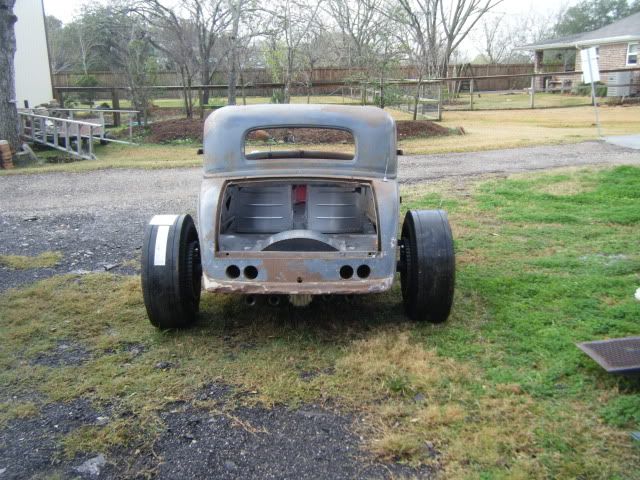

    Not much of an update but here goes! Levi (Kona Cruisers) and Heather (Kittens Mittens) came and picked up my wheels and mounted the slicks -and even delivered ! How's that for friends - Thanks so much!
    So I wanted to roll him out one more time before I start tearing him apart. I am pretty pleased with the final stance but I think the rear needs to be up just a little.
    Hard to tell here cause he setting on an slight incline.

    I think the car looks better with the grill shell in the pics now as compared to the original sectioned grill. Car is coming along really good you should be very pround.

    Grille height? Electric fan? :)

    the car looks unbelievable, i can't get over how much you have gotten done. The work you have done looks great, i was in awe when we were over last. I would go with the bigger grille shell and bigger radiator, i think it would look better and run better just my .02 for what its woth. Keep it up, it looks awesome!!!!!!!!!!!! Call me if you need help, i'm always down.

    been half ***ed checking this out, I really like the shell where it is in your mock up shots. The original was set way too low for me(out of proportion), and from looking at them, maybe that's why he didn't run a fan..The whole motor was basically in the air stream. Driving these cars is as much fun as building them for me.Cant wait to see more, and please see this reply as my 2 cents...

    Bent up the brake pedals to work a little better in the limited space.

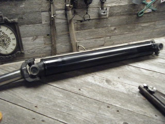

    Picked up the drivshaft.
    These guys are fast - I dropped off the yoke about 1pm and they called me the next day at 8 am to say it was done - great people!
