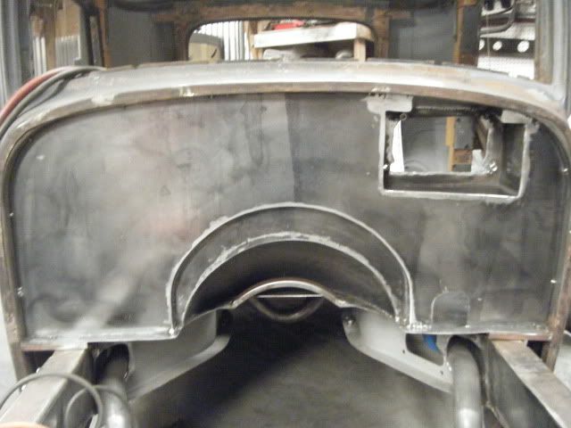

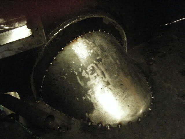

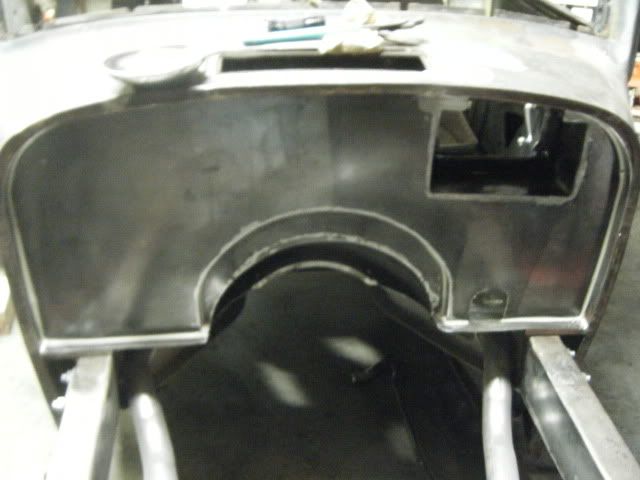

    Started on the trans tunnel. I kept thinking, this would take five minutes with a planishing hammer. My crude tools of attack and pattern.
    About an hour or so later.
    Done
    Done
