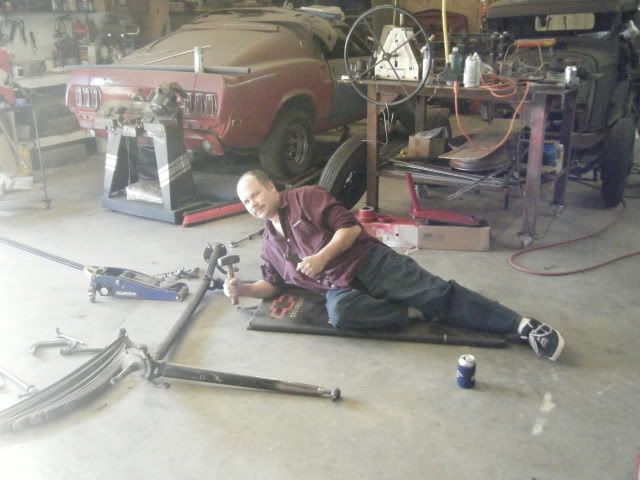

    Then Richard D showed up with beer in hand.
    We got the front end pulled.
    Richard set his beer down to pose... Note he has work clothes on and had to have a mat!:)

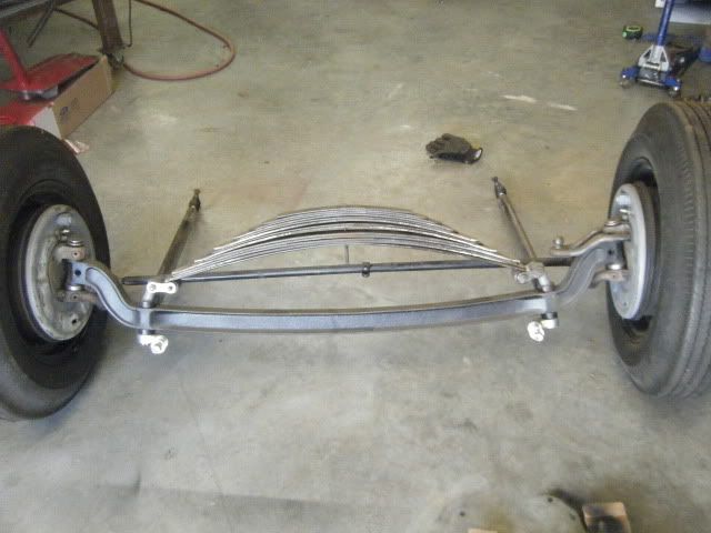

    Didn't get done near what I had planned so I got up early the next day and starting prepping, primer and painting.
    Radiused all the springs prior to painting.
