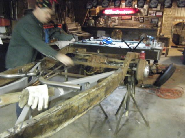

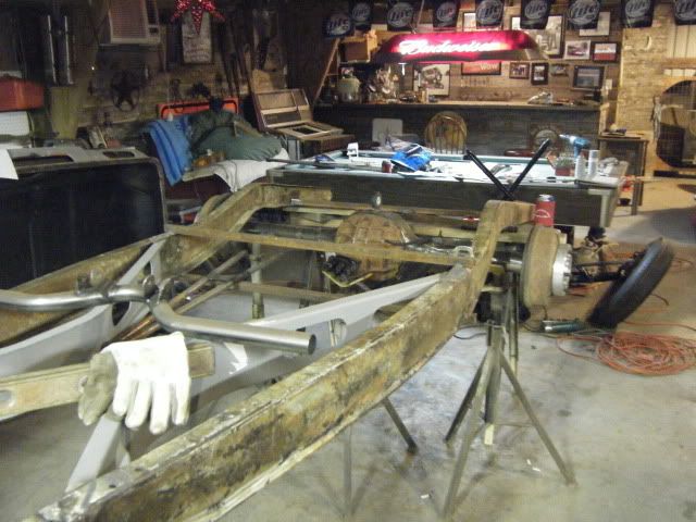

    Well, while you "boys" were off playing at Autorama I had to make a decision. Autorama or Tuffy. Yes Tuffy won. I started working on the front end/brakes.
    Pretty much done with that part.
    Guess I forgot to get a pic but you can see it here.
    This week, Lee and Louie came over to help. We all froze - one heater was not enough.
    I dont know anyone with a frame jig in town so we brace it up
    Out with the K member
    In with the new
    Louie's laying down some nice welds!
    Needed a new rear crossmember, so we went outside pulled one from a Model T frame.
    Realized we had the wrong diameter ladder bar set up so we decided we would go ahead and use the rear end from Tanya's build for mock up. Started grinding
    and grinding - I was supervising!
    Break time
    Patiently waiting!
    We ended up running out of Argon/CO2, and it was a good stopping point anyway. We need to find out how much to pinch the frame. So we played for a while.
    Called Skotz to talk about the quickchange rear end and get a direction. Pulled it apart to see if it was spooled or not. Missing:mad: diff.
    That's all for now! Lee and Louie -thank you so much for everything!
