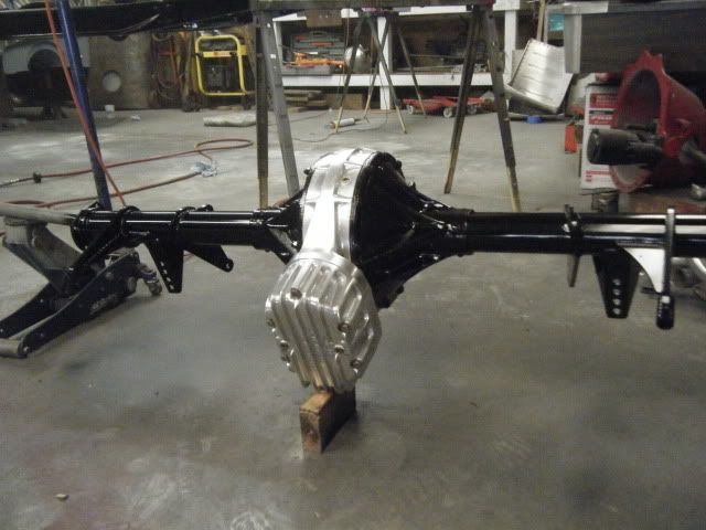

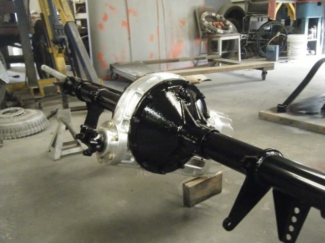

    Got a day off! Took about six hours to prep the front of the frame. Longer than I had thought.
    Blamo for Cactus!
    Better than beer Chaddilac! Car **** for sure!
    My two new favorite colors!
    Seal of approval!
    How many days left till Roundup??
