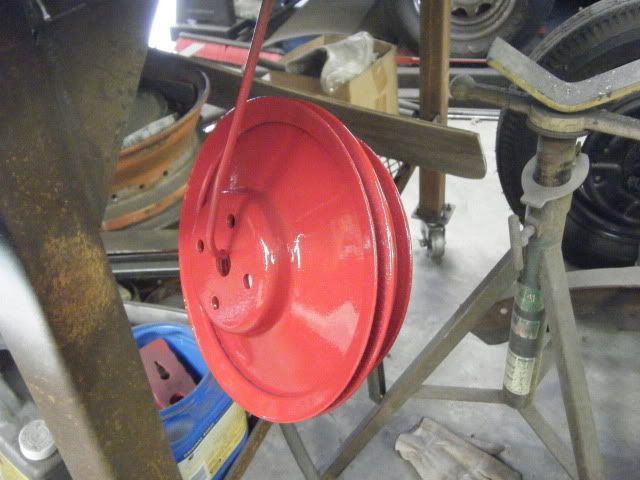

    I found the water pump pulley! And then I got sidetracked since it needed paint and I hate cleaning paint guns, one thing led to another.
    This a job I have been dreading. It took about three hours with a wire wheel to get this preped. Primer and leftover paint from I don't know what..

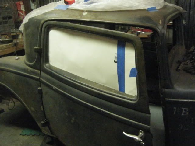

    Decided I needed to get glass ordered now! Made some templates and dropped them off to McCauley Glass at 10 Am today. He asked how soon I needed them? As soon as possible and at 4PM I got a call that they were ready! Great service!
    My neighbor Gina went and picked it up for me! Thanks Gina!
