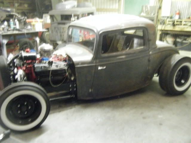

    I was wiped out yesterday so I rolled around on a stool and did some wiring. While I was wiring I noticed this.... exhaust manifolds donated by Richard D hmmmm? I don't think I will have time to address it before Roundup.
    Tanya came out and helped me install the windshield in the frame.
    Thought we did good untill the afternoon when I notice this... oh well, it can be fixed.
    Caught my second wind around 5pm and started dialing in the Hemi. Oh man is Tuffy purring now! I absolutly love the Porters! Wish the cam had a little more lope to it but lets just say "he's well manered but responsive". Thought I had a rear main seal leak and it was ticking me off since I went with neoprene instead of a rope seal. Finally got a mirror and crawled under. It was only the oil pan. Whoo! Ok had a bad noise coming from the bellhousing - not good. Turned out to be a starter clearance issue. Two nuts (spacers) fixed that. Got the clutch slave installed and semi adjusted. Got to bed around 1030 and by 230 I was wide awake. Big ***y said he would get his workers to put the body on at 7am. ****, I had a lot of little things to do prior to that. Still had four little tabs to weld on for the aluminum firewall when they showed up.
    Caddy tail lights installed
    Waiting on some parts to show up. So far everything is falling into place - fingers crossed for Roundup!:)
