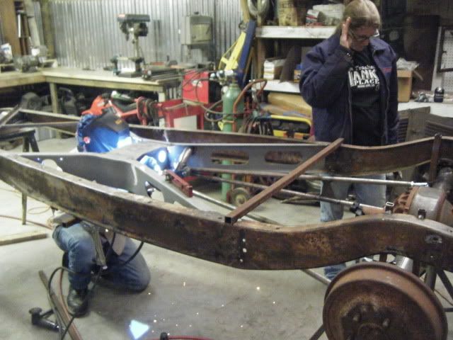

    Lee and Louie came over yesterday to play! We got the rear end tacked in.
    Lee trimming to fit x member.

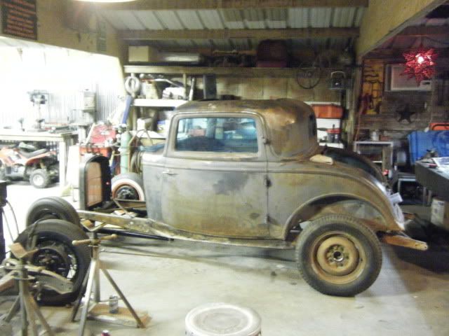

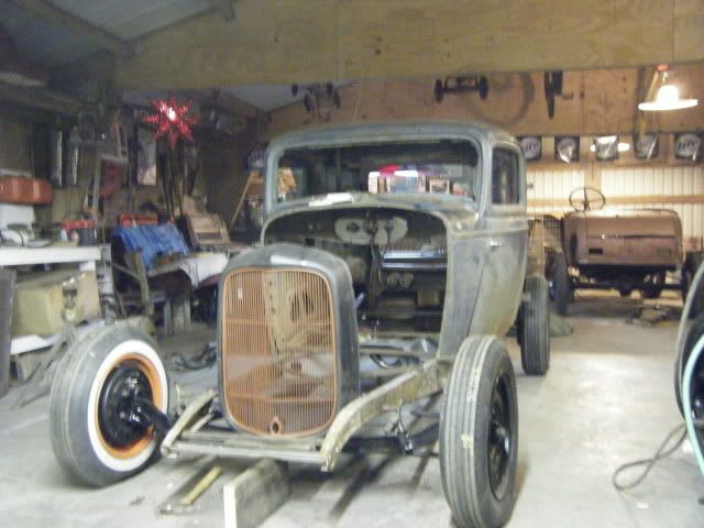

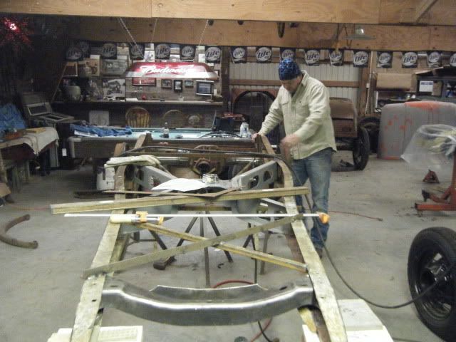

    At this point we decided before channeling the car again that we needed to use the frame to help get the body squared back up and replace the wooden supports. About that time, Tanya showed up so we had four of us to put the body on the frame.
    I was hoping for a roller by the end of the year. I think we made it! Lee and Louie, I cannot thank you enough! The next plan is to replace the wooden supports with metal and build the floor.

    I was extremely worried about getting the body squared back up as the hinge posts had deteriorated and the trip to Texas had moved some things around. But, after we got it sitting back on there and doing some shoring up I see that it's not so bad. We've come up with a plan to use some tubing and all-thread for bracing, that way we can jack it around till it's just right, then Louie's gonna fab up some new hinge posts in steel and also brace across the top. There will be room for the wood kit for the top, as it has to have that tuck & roll insert!

    When I tackle a wonky body, I construct a "box" out of 3/4" square tubing and plunk it in the center of the body, attached to floor or better yet frame. Turnbuckles in every direction like an octpus on steroids allow me to make small adjustments. Reference marks on the "box" allow me to center the body and make sure one side mirrors the other. Just a little unsolicitated advice......
