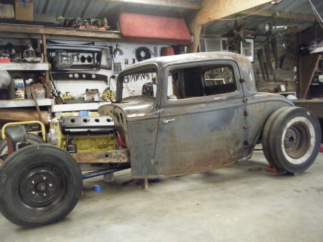

    Time for an update! I actually got my four days off! First things first! I found out that I can weld with my pacemaker. It's one of those things your not sure if you want to know or not. I am afraid that without being able to do so, Tuffy would have been stalled. I would have driven Louie S. crazy - "Can you come over and weld"?? (but he would have cause I have adopted him as my brother:)) So first thing I welded was a sign for the shop with it's official name. Only a gear head will get it.

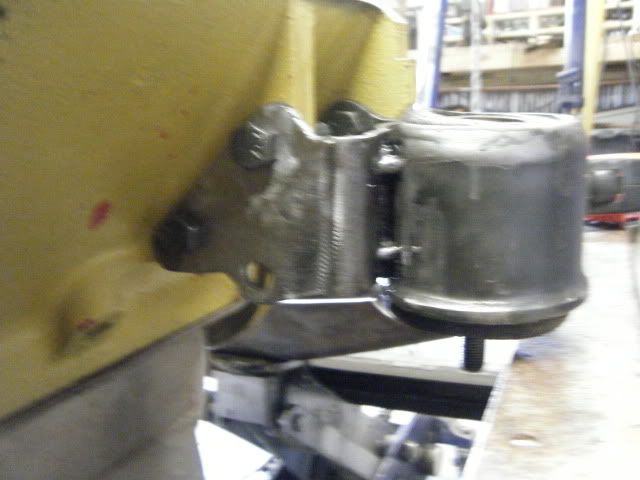

    Taking the engine to my buddy CB got a little delayed. He had a few engines in front of me. I thought it was a good time to get some stuff done so I could forge ahead while the engine was gone. I decided that engine mounts were where to start. I started making some, but they just didn't look right for Tuffy. I finally took the engine mounts off the 354 in the corner and started messing with them. Still didn't look right.
    So I re-angled them to 90 degrees, and added some metal. You can still see the original mounting hole in this picture.
    Onto the frame mounts. I thought I took a picture of the cut outs but guess I forgot it. Here I am bending up the bottom piece. Thanks Unclee for the use of your torch!
    The top piece is beveled so that it it flush with the top of the frame. Someone remarked they looked like batwings and did I do that on purpose? Anyone that knows me, knows how I feel about the Batmobile and Adam West - love em!
    Now keep in mind that I want to drive this car. I am trying to get the engine low enough that I can throw on a half hood if caught in the rain.
    So I put the heads on. Who needs weight lifting after carrying two of these across the shop, I could here my Dad saying "Don't strain your milk"! (I can't remember at what age I realized what he meant but he still says it at 84). To my dissapointment, I am thinking the stock manifolds are going to hit the engine mount and I don't have any to check, so I may have to modify. Three forward two back?
    Although the original aluminum firewall will go back on I wanted a cowl band for the half hood. Here is a recessed one donated by my buddy Skotz (one of my favorite people in the world). I don't know where Skot got this but look how close the colors match - kinda freaky?
    Then I pulled the engine out and put on the ******. I got the ****tershield from Tom aka TR Waters, who made me a smoking deal - thanks Tom. The ****** was donated from "My new best friend Norm". Why? Because it needs a four speed Kathy! Ya gotta love Norm - he's the best! The best part of this ****** is that it has two locations for mounting the shifter and after I got it in there I decided on the more forward position.
    Repaired the patch panel rear of the door. Were these leaded in at the door sill plate from the factory?
    Installed the front end and stuck a grill on there.
    Started playing with blue tape to see if carb/filter are going to fit?
    I have stared at the old pictures for hours and it looks like Ron had an F1 steering box mounted on top of the frame. After attaching the starter, I can see why. There isn't room for anything but, so if anyone local has an F1 for sale please let me know.
    The exact height/positioning of the car is still in limbo untill I get the rear end back from Bruce's Rod Shop. I know the rear end will come up a little and then I can get final stance closer to original, but it's getting there.
    I must have been dreaming at this point. I don't know why my eyes were closed. OK, I'm in love and I don't care who knows it!:p

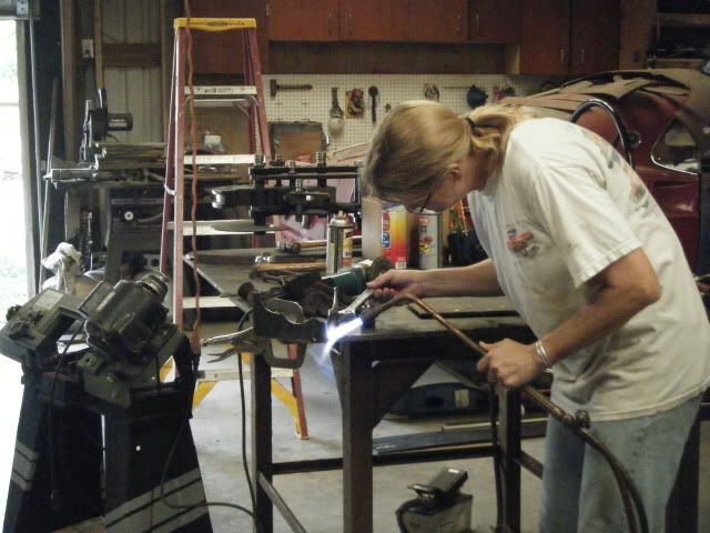

    About that time, Tanya walks through the door and says, "Can you teach me to weld"? I think she is a natural. I numbered the first five welds. Mind you the second weld she pushed, third weld she pulled, then it was uphil and downhill. I was very impressed and she was excited.
