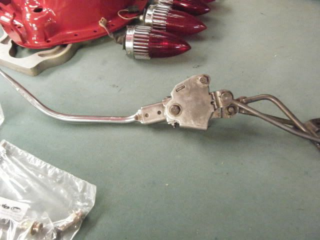

    The Hurst shifter showed up. I should have taken a picture before I rebuilt it. Wore out a wire wheel on it!

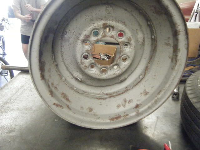

    Onto the front wheels. Here is what I started with. I forgot to take the camera out so I missed some pics.
    I drilled and punched out the rivets. Reversed the center section. Trued it up and tack welded. Rechecked for true and welded it up. Thanks to Little Bobby Bleed for the tech! Then I painted it with some PPG Single Stage. Anyway I am happy with the way they turned out. One of these days I am going to buy a decent paint gun. I am still using a Home Depot Husky:rolleyes:. My Dad always said to get to where you can paint well with a cheap gun first. The new tires should be showing up this week.

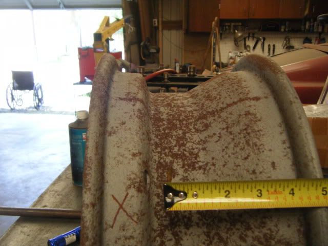

    Just an FYI, if you run the Buick drums on the rear with a reversed 15" wheel, you'll probably need a spacer for the drum to fit the wheel without hitting the rim. I went through this with a pair of reversed 15x5.5" Ford wheels that I run on my coupe from time to time. I ended up having to make a 1/2" spacer to get them to clear the drum.

  7. Did you figure out the shifter mount?

    Thanks for that tip B***, I would have messed that up. Sounds like I had better do some measuring.

    Got it, P***on Performance has one!

    Small update with pictures (that's a hint for Grits;)). First thing I measured the wheels per B***. I used 53-56 Ford truck rims which are about 5" wide and reversed them. That gave me 2 1/2" backspacing which was just right for the Buick rims.'
    But on the same rim that was not reversed it would be a no go

    I started on the rear wheels. There is a tech article on how to do this in "The Little Page" Community, but it is really set up for when you need a wide rim with alot of backspacing. So I decided I would reverse the 53 Wheel first and then mate it to this part of the Buick rim. This will give me about a 7 1/2" rim with 2 1/2" BS
    I got the first wheel reversed and started on the second. Note - before you do all the prep/cleaning/reversing -you should check to make sure it runs true. You can see some daylight there
    Ok, no worries, I have a 53 Truck that I will rob a straight wheel from. Fought with the tire for a while and got it off then I realized it was a 48 Wheel and not wide enough. Back out to the truck I go. "Mom - you should leave now before I start cussing". Crawled under the front of the truck and both fronts look like wide wheels -cool. Wrestled with the second tire and got it off, checked for true - good, knocked the rivets out and &^&%^&*()(( it's a 16" rim. Well that was a waste of an afternoon. Big Brown Truck shows up! Hell yeah, you can't whip me!
