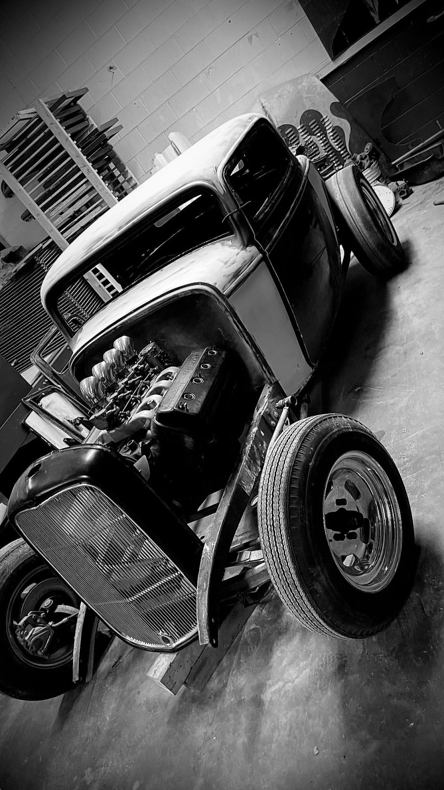

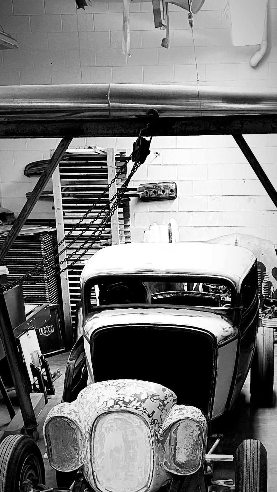

    So to get it this low I need to the fun part which is build the ch***is. Right now judging from the pic the bottom of the body is (maybe) 6” off the ground. So I need to bring the ch***is down that much.
    I plan to flatten the front crossmember and reverse the eyes on the leaf and that’ll get me 3” in front.
    The rear I’ll run an A rear crossmember with a T spring/or and A… and z the frame a bit.
    The hemi will get lowered in the frame a little too height wise, I’m going to make a thick aluminum firewall that is flush with the front that has a cap that covers the hood lip like the pink one too. That’ll take care of my ugly firewall.
    I have a set of old chrome reverse with spider caps. F-1 steering, I have a column shift out of a car , I have the headlights and stands that match the pink one.
    I started to machine the Buick drums, gave them drilled for small ford.
    as you may or may not know… 32 3 window windshield frames are different and almost 500 bucks… I took a standard one and heated it up and reshaped the corners as a test… well it worked. Plan to make a template and reshape this one to start- it had gone through my shop fire and I had kept it.
    pulled this ch***is out of the weeds today- using the wide 42-48 rear axle from this, it turns freely. Needs new bones…
    I’m cutting the x member from this and plan on using it in the 32 along with the pedals. I got the zephyr trans out of storage and the cragar adapter I need to run this behind the hemi. Have a steel flywheel and pressure plate.
    running the Horne 4-2 manifold…. It’s similar to the flathead with 4-2’s in looks just bigger and better.
    I plan to chop the top another inch. I don’t think it’ll be too bad.
    I have fibergl*** mat and a five gallon bucket of resin and all the tools at the ready.
    I stopped by my buddy’s junk yard today and found the solution yo finishing the channel. I’m cutting slab sides of fibergl*** out of a 1980s era boat. I’ll just use it as material like steel and cut out the 6 x whatever length needed and cut them out from templates and cl*** them on the top and bottom. I would’ve cut them today just needed more tools, didn’t have a cordless grinder with cut off wheels handy…. Heading back over there later this week.
    chryslerfan55, Stogy, RDR and 13 others like this.
