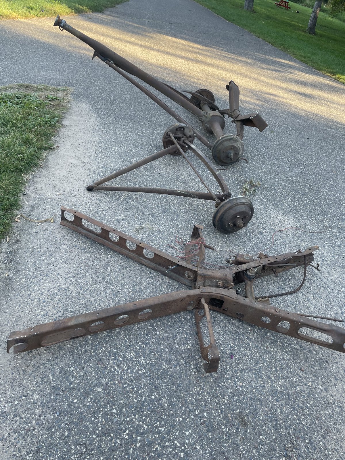

    Processed that frame like a buffalo! The*****er bit me though o_O now to clean it up a bit more and drop it off at the blaster.
    I’ll use the pedals, x member, rear axle and the front spindles and hubs for this car.. I’ll save the crossmembers and bones for swap meet fodder and I’ll drop that axle and sell that too-!
    Chassis building is my favorite part of hot rods, I think it’s all the problem solving combined with creativity-
    I have a 33 ford drive shaft for this I can shorten when I shorten up the torque tube. I’m going to need different rear bones but the bones on the 33 axle might work if they’re straight.

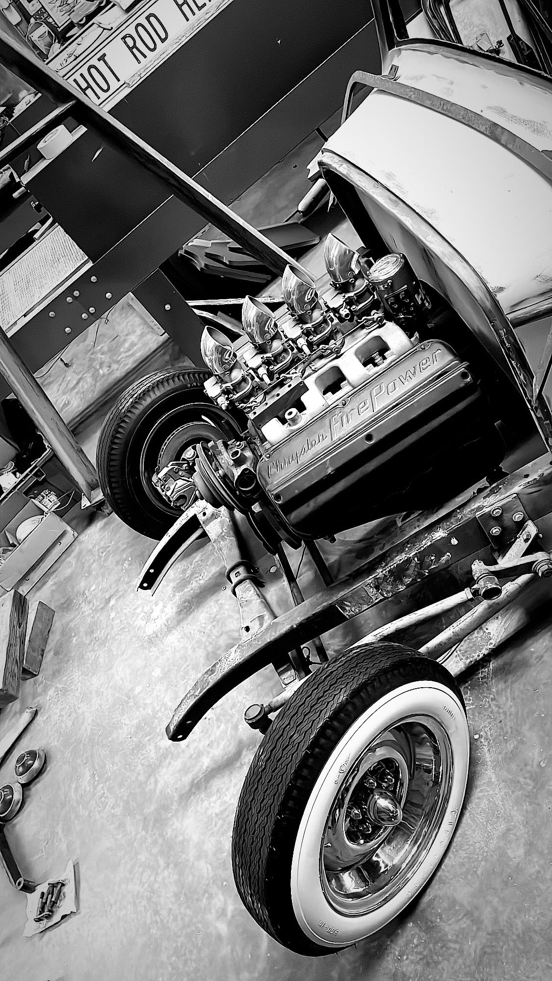

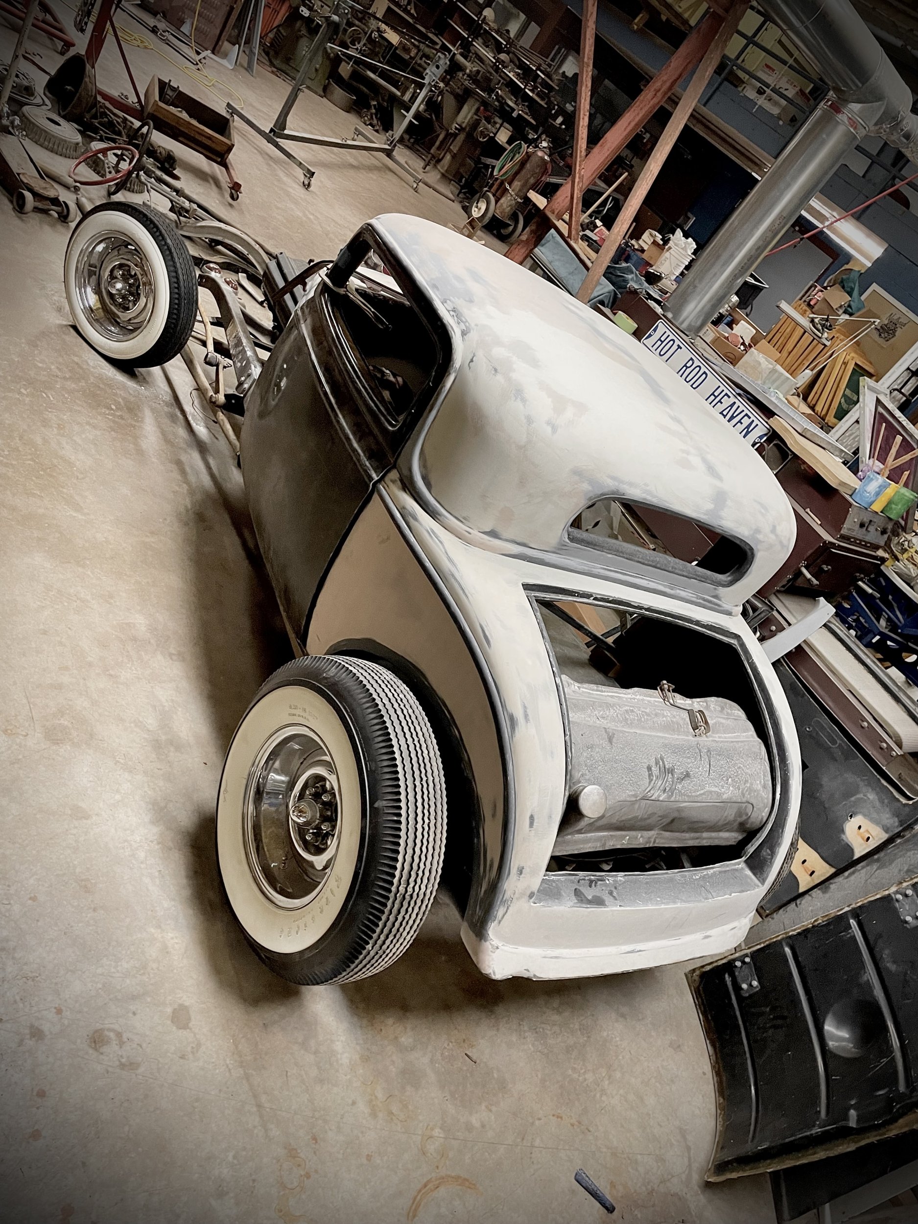

  7. Tuck
    Joined: May 14, 2001
    Posts: 5,872
    Tuck
    Tech Editor
    from MINNESOTA
    Got some 5.60 15" and 8.20 15 stones and mounted them on the old home made chrome reverse I had with spiders. My fav wheels... the rears are 7" wide, the fronts 6.
    45A899CD-8376-403B-BC8E-715C562E336A.jpeg 07A472DA-CE40-4FF7-B1DD-13EFC506EEA2.jpeg IMG_2631.jpeg
    The one utility that is included with my lease is electric and it got cut off for a couple weeks so I had 4 days over MEA weekend free to work on hot rods and couldn't... todays the first day I've had free to even touch it and I'm sick!!!
    Stoked I got the tires and got them mounted- they look******en!

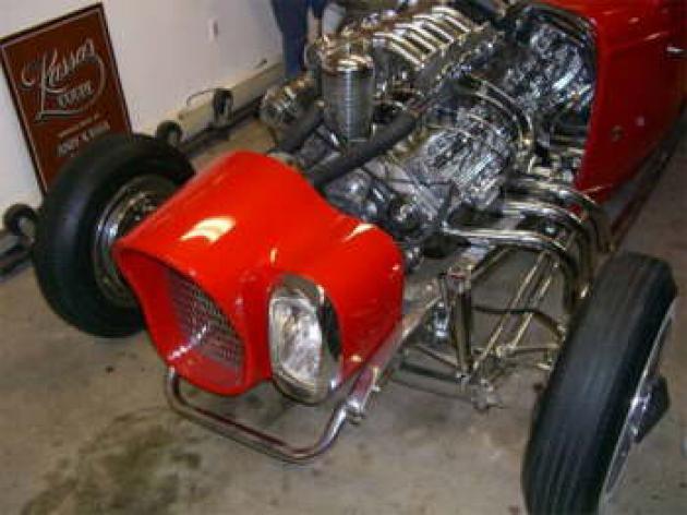

  17. Tuck, I always admired your hot rod vision, the very moment that I joined the HAMB and discovered your build threads because you clearly "live" for custom show rods of the 50's and early 60's as I "live" for!
    Back when I lived most of my life on the east coast, I hardly ever got to see famous hot rods that had exposure in mags like HOT ROD, Rod & Custom and the like. The very first one that I did see in person was Andy Kassa's coupe at a big show in New Jersey by promoter Terry Cook, who named the show, "LEAD EAST". Andy's coupe was bright Red and had the most chrome that I ever saw on a hot rod - hell, even most of the engine if not all of the frame was chrome plated! And the car featured a "Cyclops" custom grille by Barris with only one headlight. Bizarre, but radical and cool as you can get! It's the reason why we have seen the car in other stages, doing whatever he could to win at any show that he entered! I'm very stoked about your 3 window coupe build too!
  18. Make that TWO. I'd be very eager to buy that grille as well! Thanks!

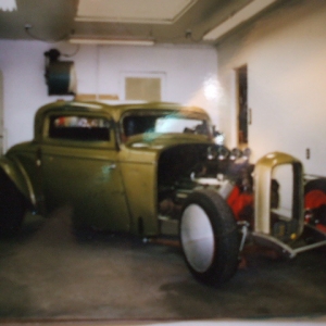

  19. RDR
    Joined: May 30, 2009
    Posts: 1,544
    RDR
    Good on you Tuck !
    At 6'2" Iv always loved chopped and channeled but now at 81 I just don't squeeze like I use to.

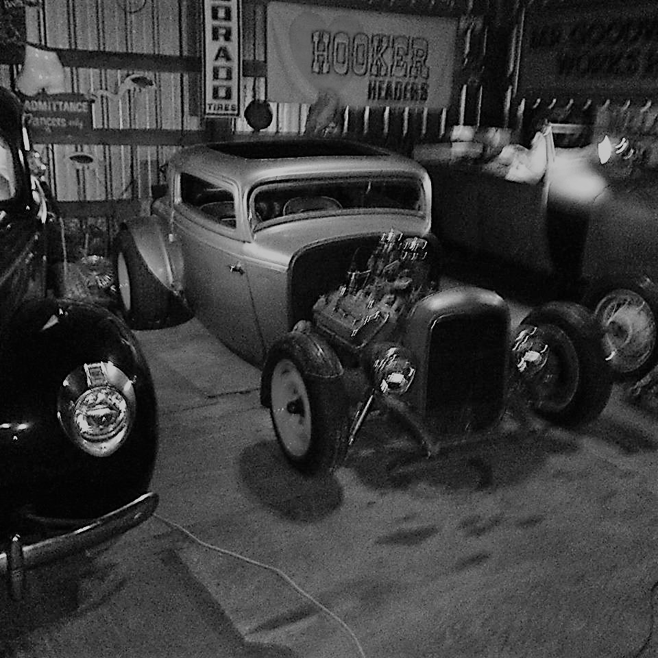

    In the late 90's I had the pleasure of owning the remains of the Bo Knabb 3 window built in 1948 in Portland, Oregon. Many things in life drew my attention away from getting onto that project and age
    finally became the final decision to give it up. I did a trade with a friend for the running '34 Dodge
    pickup in my avatar. Told him the reason I wanted the 3 window was the suicide doors and his PU
    had those... a done deal. Best part was knowing Paul would never change the coupes history.
    Enough of the BS and onto the project as it sits in Paul's barn:
    mocked up at my old shop, sold the house and shop in early 2000... build was getting complicated,
    coupe went into storage...wouldn't have a shop again until 2013 after selling a custom chevy to finance the shop...back to building... but... other projects seem to come up instead of the coupe.

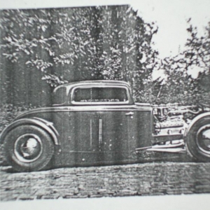

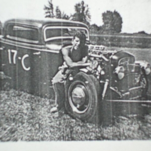

    Here are some of the pictures of Bo's coupe back then (1948-1952) He sold it in 1952.
    Met him in late 90's and had a great visit about his roadster racing days and I mentioned to him
    that I would be running a Hemi instead of the big flathead he had built. Then he told me that the coupe had been destined for a Hemi as he had bought a complete 331 crate engine for it but ended up
    putting the engine in a ski boat after he sold the coupe.
    Anyway, Tuck, keep on keeping on'
    Randy

    Thanks Mike! The A symmetry Cyclops grill is wild and I really love every version of this car it's cool how much it changed and evolved over the years. Thanks for sharing this stuff man it's rad to hear how Andy's car has impacted other people too.
