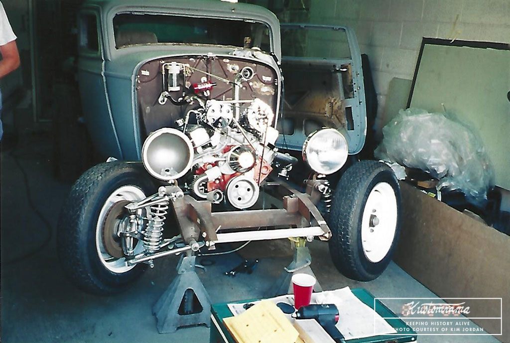

    This is a good example of what happened to the majority of these old *****en channeled 32 3 windows and other cool hot rods.... people changed and updated them and they're still here in plain sight its just they look lame now... LAME. haha-
    VIEWER DISCRESSION IS ADVISED!
    Example of the above car Copied from Kustomrama-
    Only the body, grille shell and rear nerf bar still existed from Conrad's creation when Kim went to check it out in 2000. Dudley had gotten rid of the Chrysler Hemi and replaced it with a 327 Chevy smallblock. "His reasoning was the lack of speed parts available for the Hemi. Dudley unchanneled the body filled the roof and placed it on a reproduction frame with a Kugel independent front end, 327 Chevy w/ Turbo 350, and a Maverick rear. A machinist friend was making billet parts to accent the coupe." Photo courtesy of Kim Jordan.

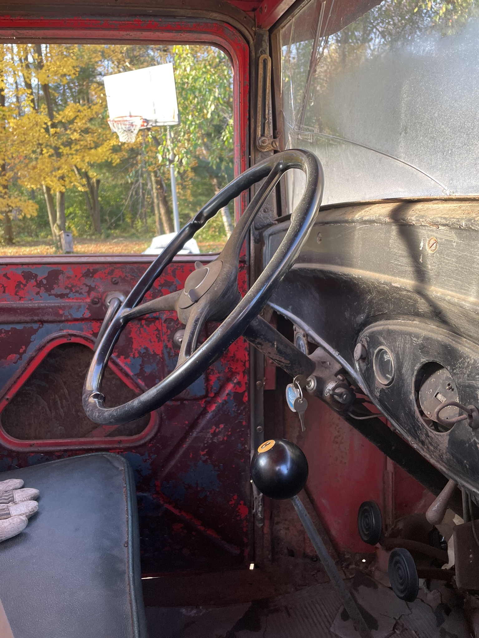

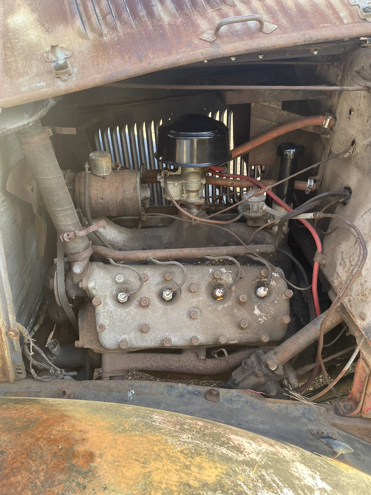

    Life has been good but busy, I'm working full time at the college and part time at the high school and still slinging dies... so I just havent had a lot of time for this. I did get some parts for it... a REAL steel firewall surround, I'm running a polished firewall but I hate the fibergl*** lip so much, I'm really stoked I got it..., I also ordered a real windshield for a 3window. I'm still hunting for hinges. I got more parts but I can't remember what all I picked up for it besides the hub for the other side. I finished the conversion and added the Buick drum to the other side.
    I did however acquire another project (I traded a project for it though so I don't think it counts??) and ended up with a Canadian 34 pickup. It all but runs... brakes have been rebuilt all the way around and work perfect... the flathead looks like it would fire up but its stuck. I'm going to swap it out with a running engine and just drive it. Its so cool.. It came with a couple boxes of NOS parts and casting patterns for the V8 emblems on the side which you know I'm gonna cast a few sets! :) It came from an estate north of Duluth.
