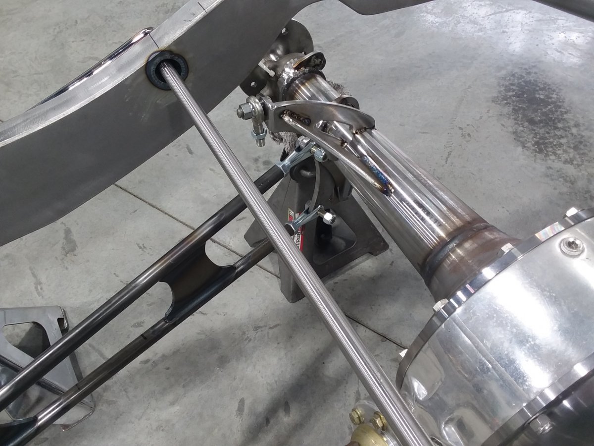

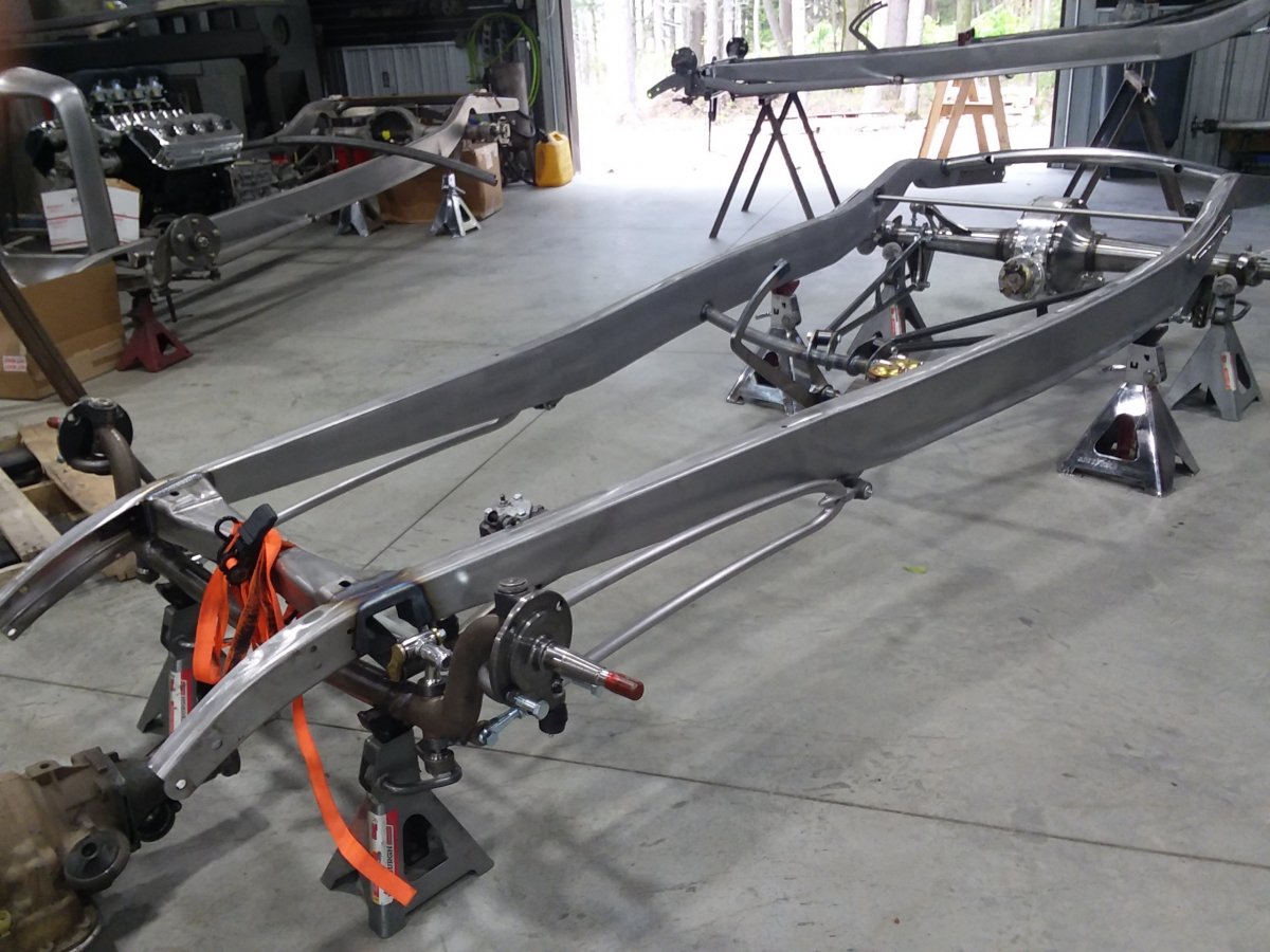

    Excuse my ignorance but what is that bar for running through both ch***is rails?

    @panhead_pete sway/anti-roll bar. Arms are pointed forward in these pics but, they'd point backwards in operation and have a small links to the diff housing

    They are Alan Johnson pieces. There is also a version that mounts to the inside of the framerails in addition to the outboard version pictured. Beautifully made stuff.
