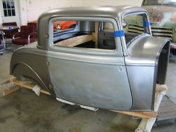

    Fitting door tops today then a soak in vinegar to get the ******* galvanization off .

    I've sold a couple of Brookville 3 windows, I didn't pay any attention to the fact that they were galvanized?

    My Brookville 3w body/doors definately isn't galvanised......:confused:

    I have heard too, that the doors were galvanized. Even some pics show them to have a more silver like finish, compared to the bare metal body.

    Last 3 I did had galvanized dooors and decklids . And one had the rear window panel galvanized .

    Have you noticed any of the welds more brittle on panels that have been galvanized? I know you strip the "to be welded" area first. That's a hazard in itself...
  19. Flop
    Joined: Jun 8, 2006
    Posts: 3,885
    Flop
    Not that I’ve noticed .
  20. alchemy
    Joined: Sep 27, 2002
    Posts: 23,467
    alchemy
    Could it maybe be aluminized like exhaust tubing is? Usually a thinner coating, and easier to weld. Plus welding on it won't kill you like welding on galvanized steel will.
    Flop likes this.
  21. Flop
    Joined: Jun 8, 2006
    Posts: 3,885
    Flop
    No this is straight up white floaty things in the air and ruining gas lenses like it’s going out of style with all the **** popping back when you start an arc .

    You could call Brookville to confirm?

    For what reason ? If it welds like galv smells like galv puts white things in the air like galv it’s a good chance it’s galv . Wear your respirator remove as much as ya can and weld away .

    It's not galvanised fellas, it's zinc coated. Galvanising is a hot dip process. This stuff is I think a plating process. In the uk it's called Zintec, but that might be a brand. It has a uniform surface finish, unlike galvanising, and it is a very light coating which doesn't take much to remove for welding. It's the stuff that many / most modern cars are made of. My Brookville 3w has the 2 doors and the trunk lid made of it. Presumably they didn't make the whole body out of it for the problems in welding it? I dunno.
