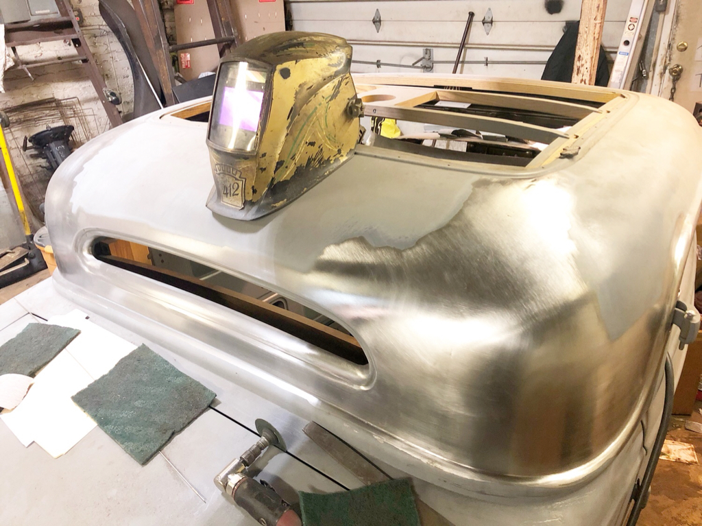

    How do you fill the front slice above the door??

    I have to make a die for the pull max to reshape the reveal to make it flow a little nicer . Then just weld it all back up .

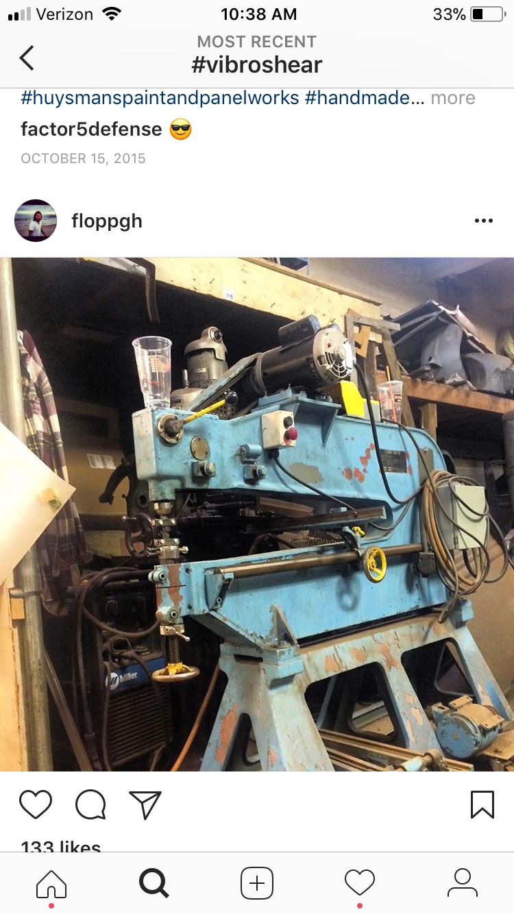

    Pullmax! That never got any camera time, guess that is were the great body beads that match the factory ones come from. Have a Happy New Year! :) Bob

    Well it’s not actually a pull max it’s a Japanese knock off from the early 60s called a vibroshear

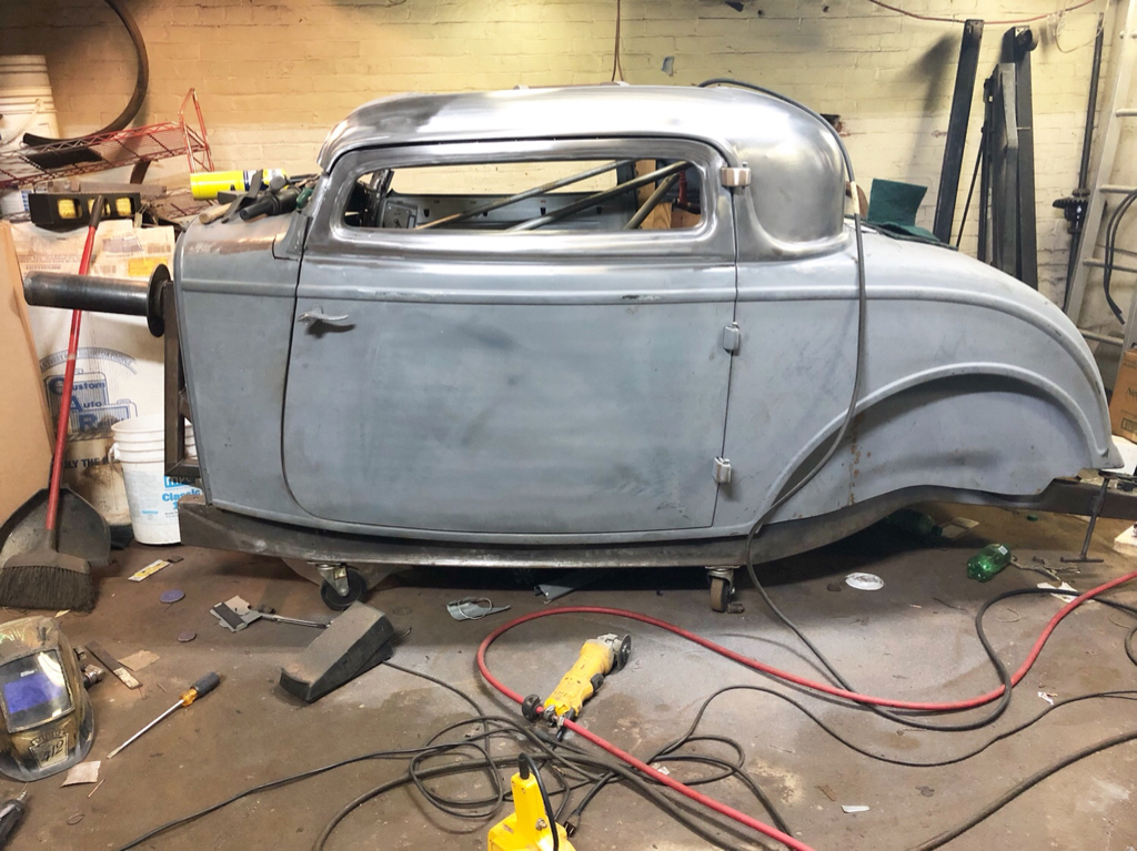

    The middle hinge is what was removed in the last one I did .

    Do you keep all three in place now??

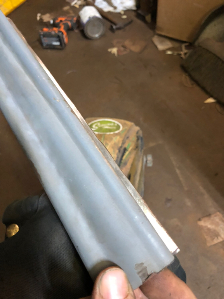

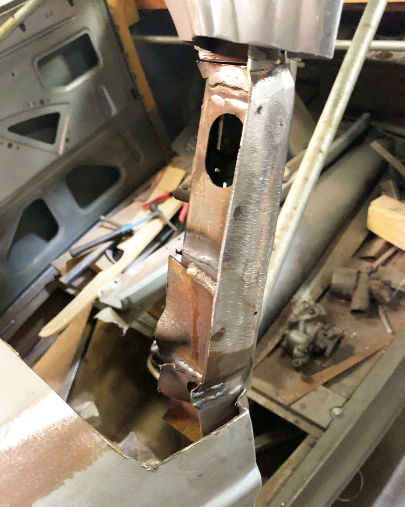

    Solid pillars all the way around for piece of mind . Safety first .
    Body lines washed out for some reason
    Stock 3w
    Gonna use the piece I cut out for the body line .

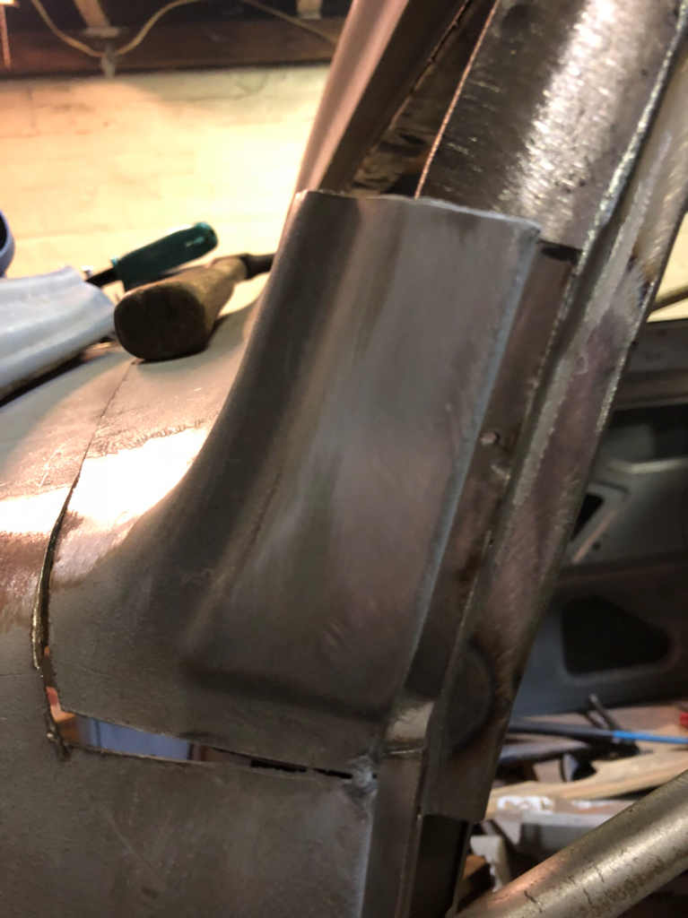

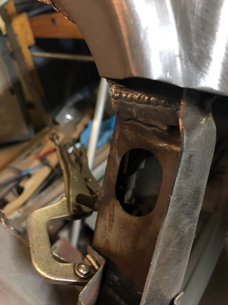

    Filled in a lot of blanks .
    Totally reshaped reveals so they flow into themselves better
    Last weld on the pillar tying the roof and header back into the pillar .

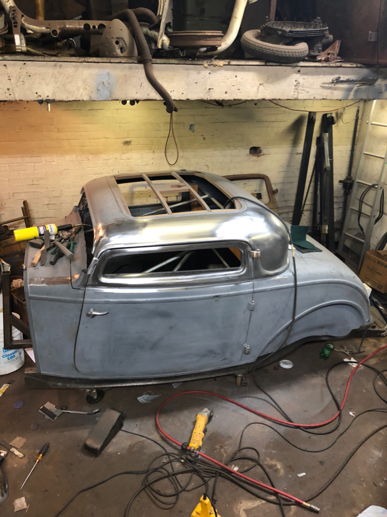

    Other door top on . Gaps need work as this side was a bit screwy when I got the car
    A pillars are now both solid .
