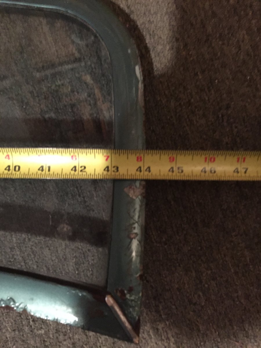

    IMG_1187.JPG Anybody have the width? I just bought a chopped windshield and I'm not 100% sure what it fits.

    Mine is 43.5 at the corners, and 44 1/8" at the widest point mid way. Yours might be wider at the corners if its been chopped. Sure looks like a 3w, for sure not a 32 5w. Dont know about 33-34

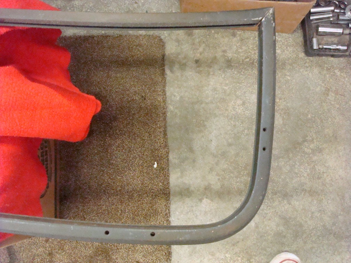

    The holes on the side of mine are 1" center to center.

    Your talking about the screw holes that hold the bottom of the windshield frame to the top? The last pic?

    No. On the side for the swing out bracket.

    Yup mine are 1" too

    The two hole for the hinge are 2.250 apart. The distance between the two set of hinges is 27.750 to the closest holes. If this frame is not NOS, it's dam close. DSC09903.JPG DSC09904.JPG DSC09905.JPG

    The hinge holes threaded?

    Yes, very fine thread.
