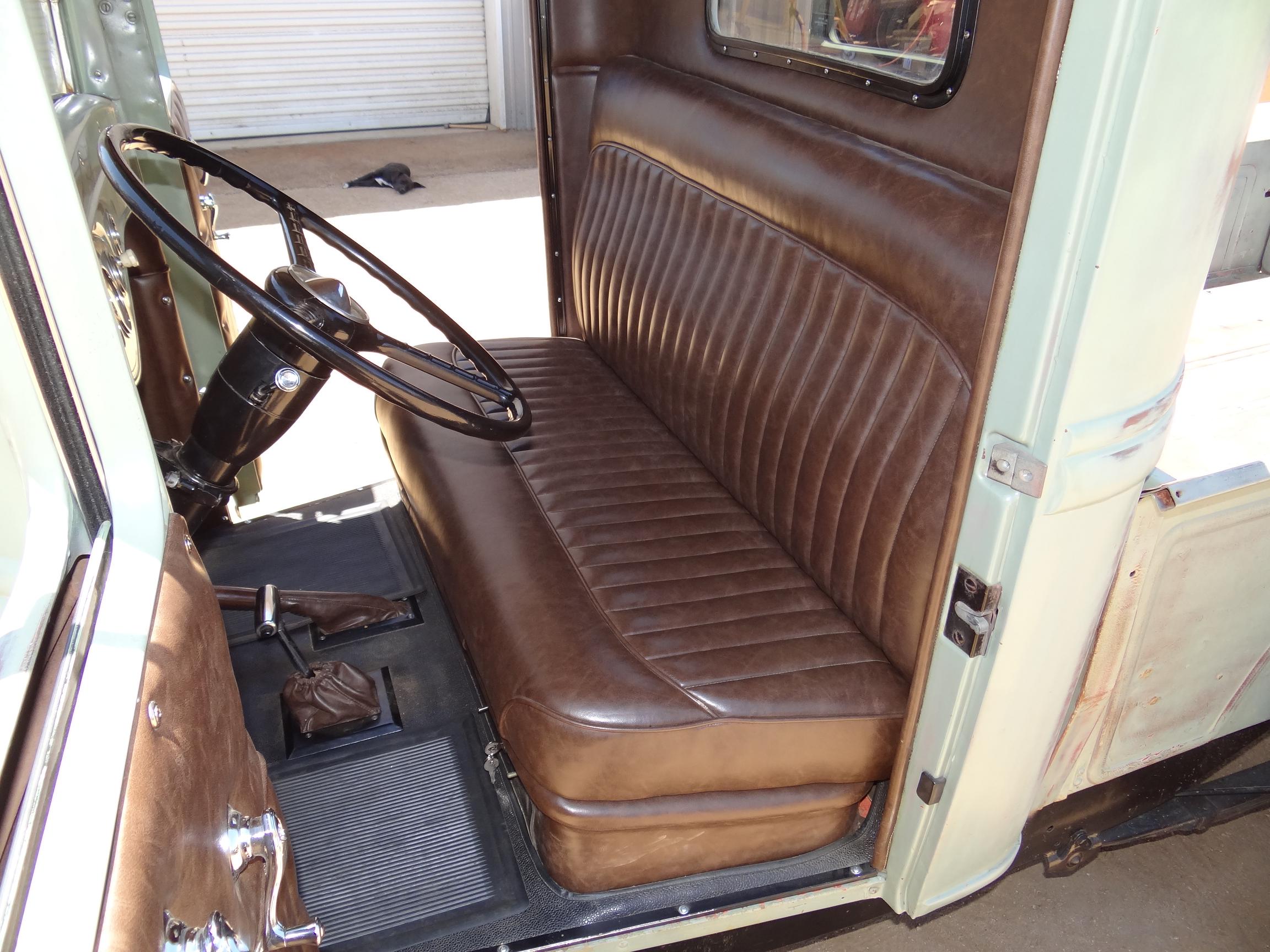

  6. Here's what I did, I thought the Caravan seat seemed a little to narrow, and I wanted to have better access to the area behind the seat.
    So I got a seat from a Ford Ranger (80's) and took it a apart and then sectioned the back of the seat by 4 inches, then with the bottom part I sectioned it 4 inches in the rear and 6 inches in the front so the seat followed the norrowing of the cab.
    It also tilts forward for easy access to the storage area behind the seat, and this is important when the truck is so small to start with.
    Sorry for the shitty picture, its all I have on my PC at work, if you want to see some better pictures, let me know, I can take some when I get home tonight.
    Eric
