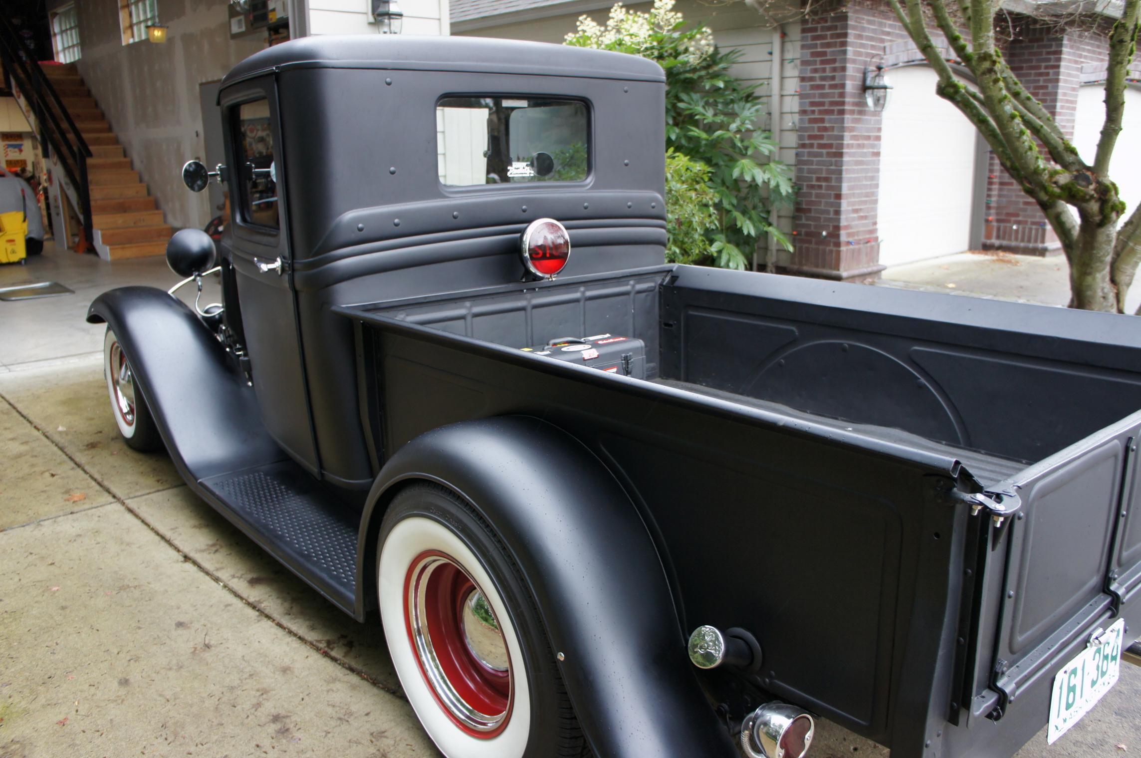

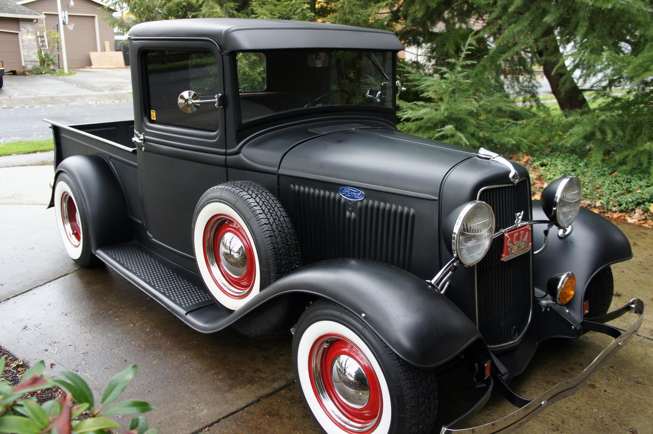

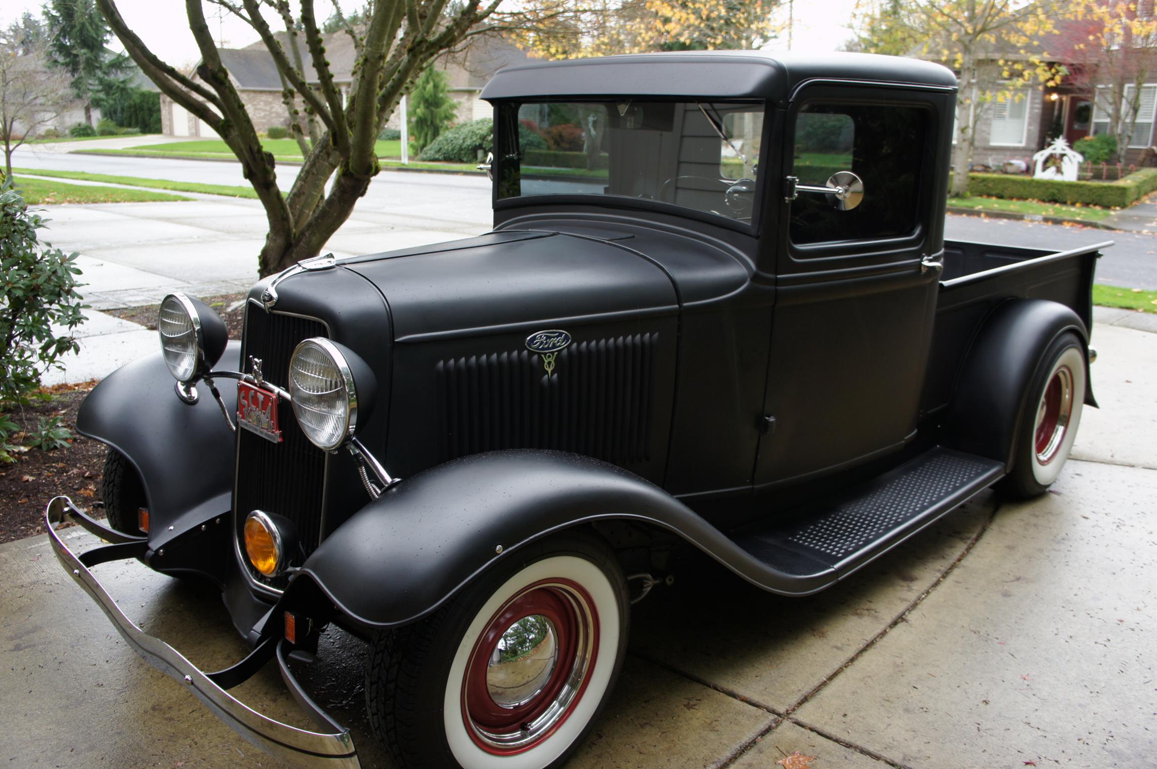

    Here's my '34 still working on it.
      416.5 KB
      906
      376 KB
      430
      322.8 KB
      443
    31hotrodguy likes this.
  14. ^^^ Looks nice, and done to me!
  15. Hotrodmyk
    Joined: Jan 7, 2011
    Posts: 2,357
    Hotrodmyk
    Thanks Man, still doing a little body work (hood id a little rough) and some small stuff underneath.
  16. Jeff Norwell
    Joined: Aug 20, 2003
    Posts: 15,526
    Jeff Norwell
    MODERATOR
    Perfect Stance

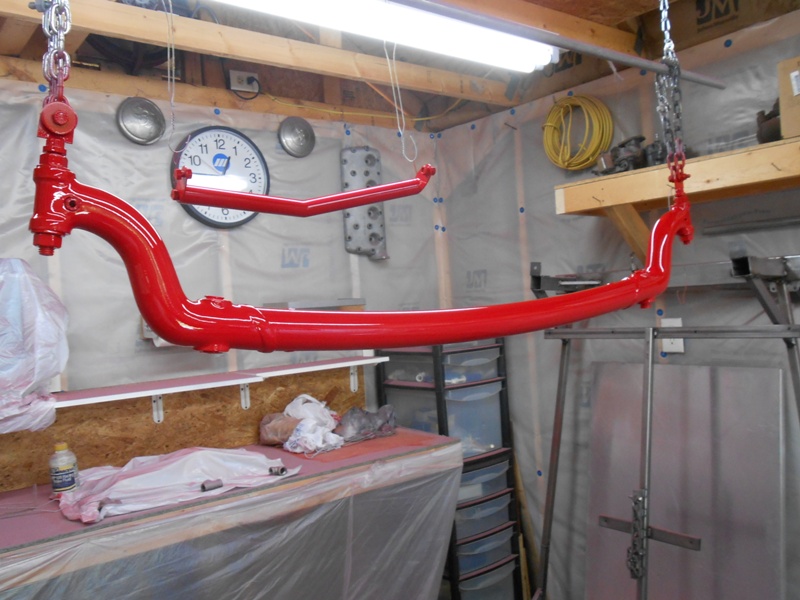

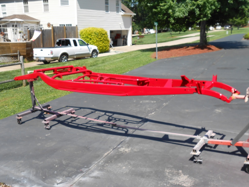

    Its been a while, finally got some painting done.:)
  19. DANA RED
    Joined: Jan 6, 2009
    Posts: 138
    DANA RED
    After mockup, now all apart.
  20. HOTRODPRIMER
    Joined: Jan 3, 2003
    Posts: 66,050
    HOTRODPRIMER
    Looks great Henry,,what color are you going to paint the truck? HRP
  21. DANA RED
    Joined: Jan 6, 2009
    Posts: 138
    DANA RED
    :)DANNY, sorry for the delay, been waiting for better weather to finally get the frame painted. YES it is RED.
