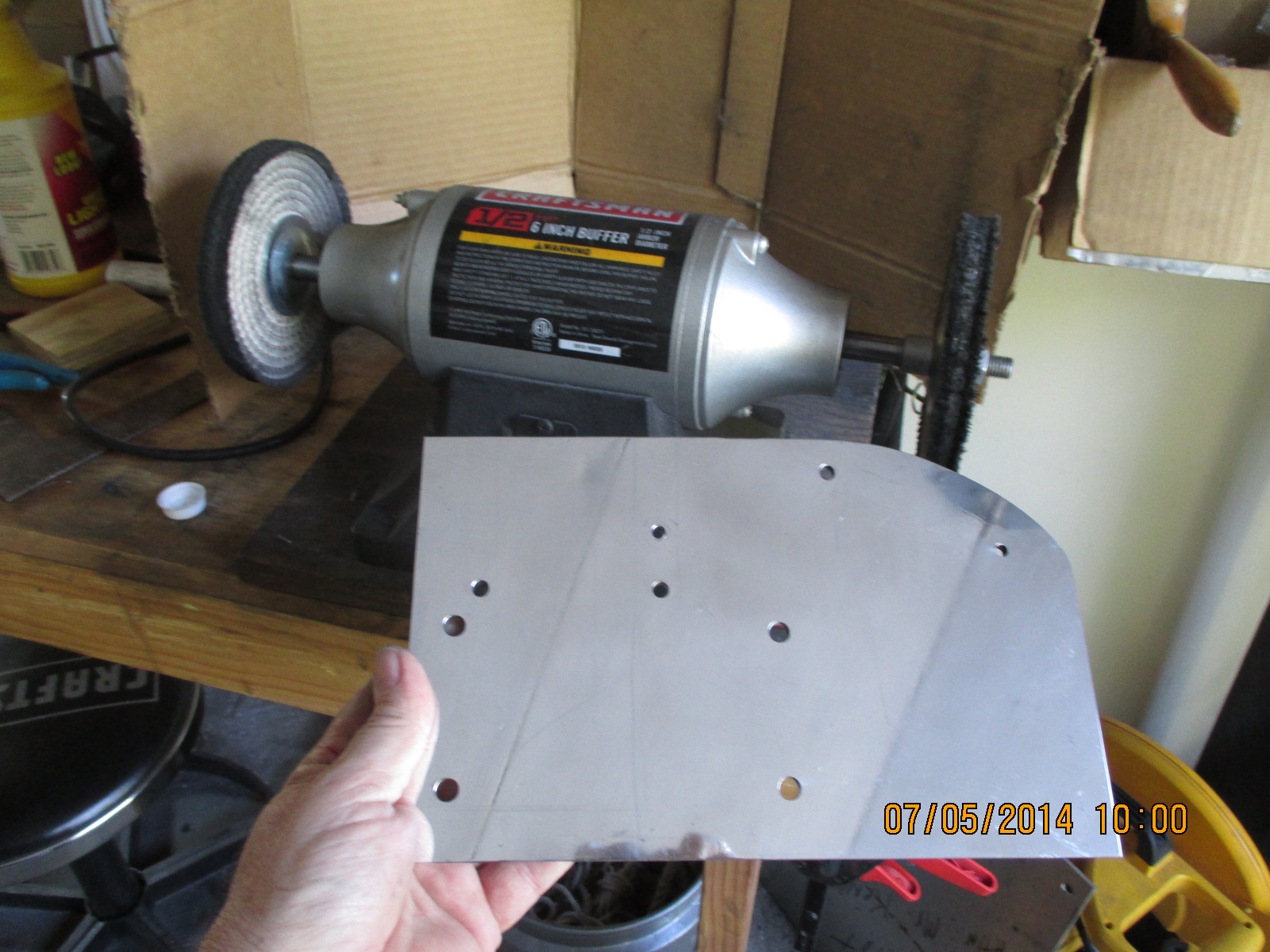

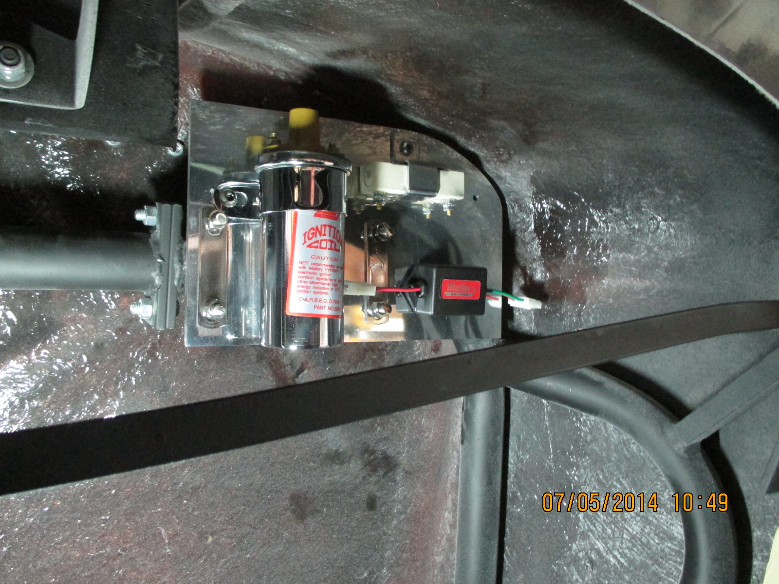

    Making a bracket for the Mallory coil, resister and surge protector

    Mounted under dash with u bolts.

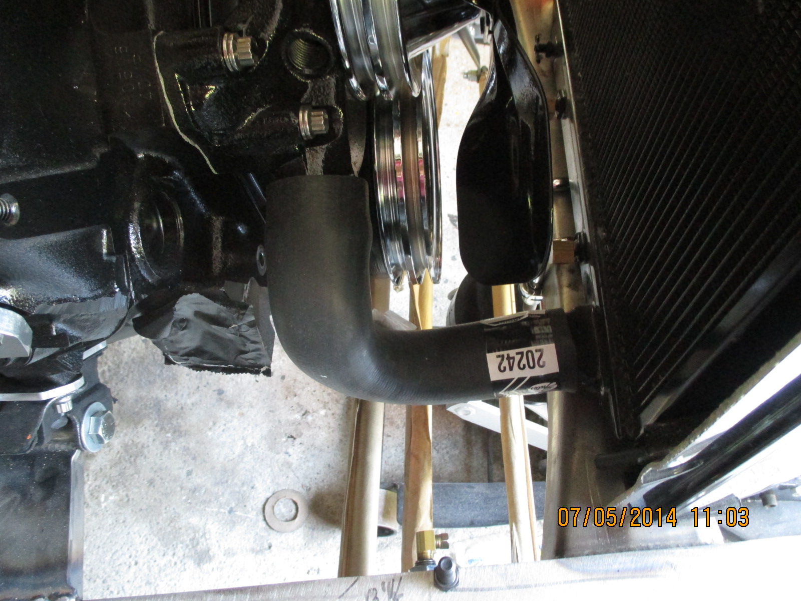

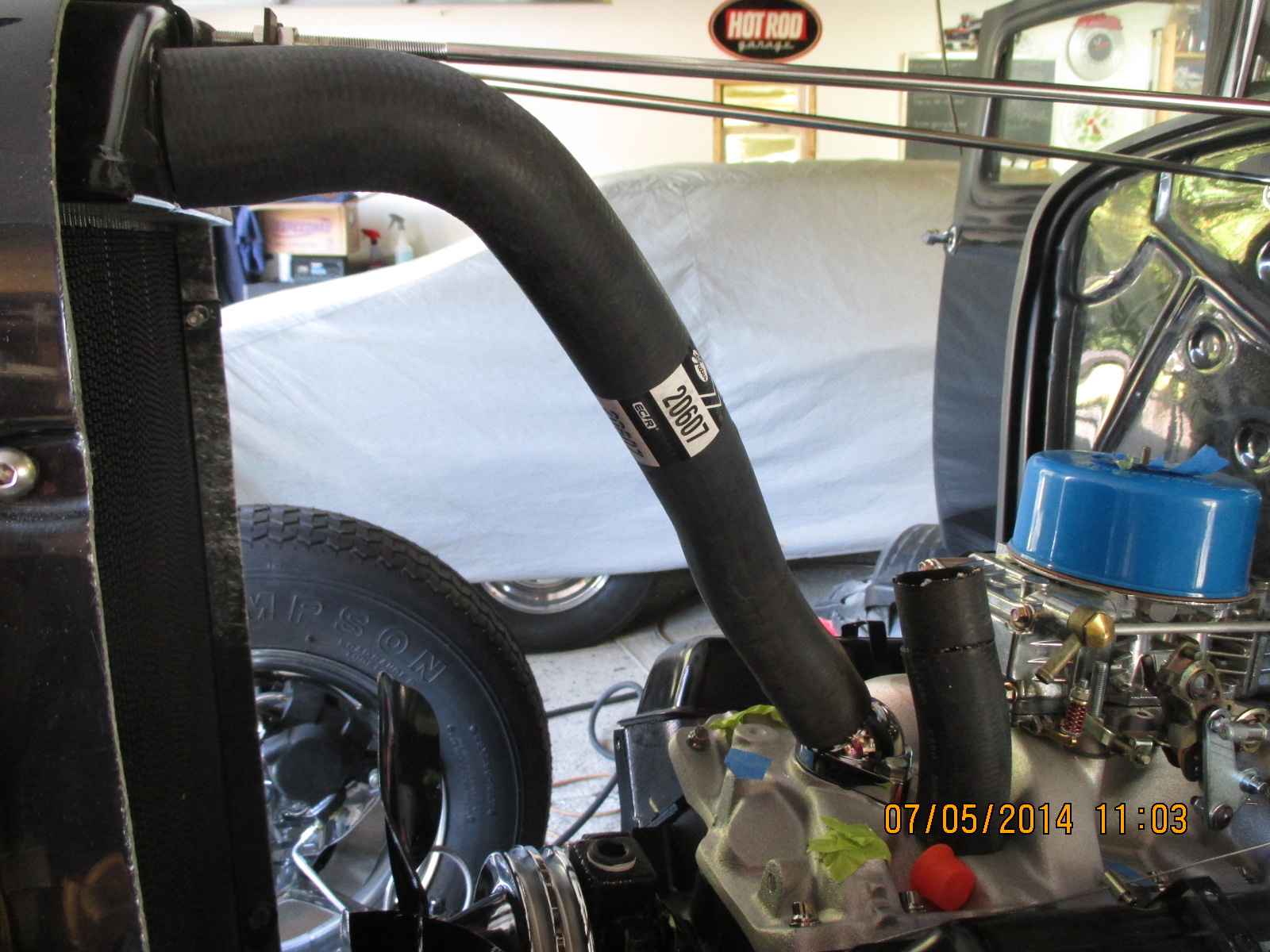

    Upper radiator hose. Gates 20607. Straight ahead thermostat housing. The cut off piece is sitting on the manifold.
  8. Novaron
    Joined: Mar 12, 2010
    Posts: 188
    Novaron
    from New York
    Bottom hose. Gates 20242. 1956 Chevy. Fit perfect, no trimming required.

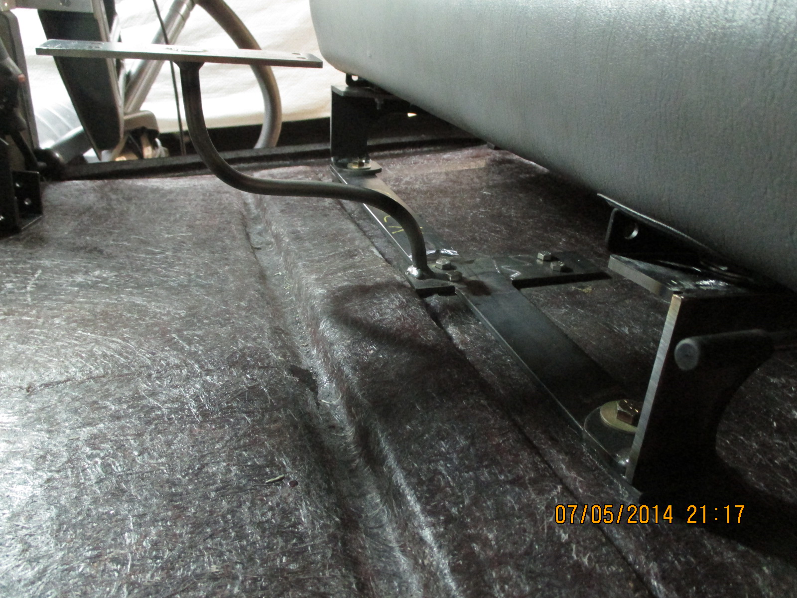

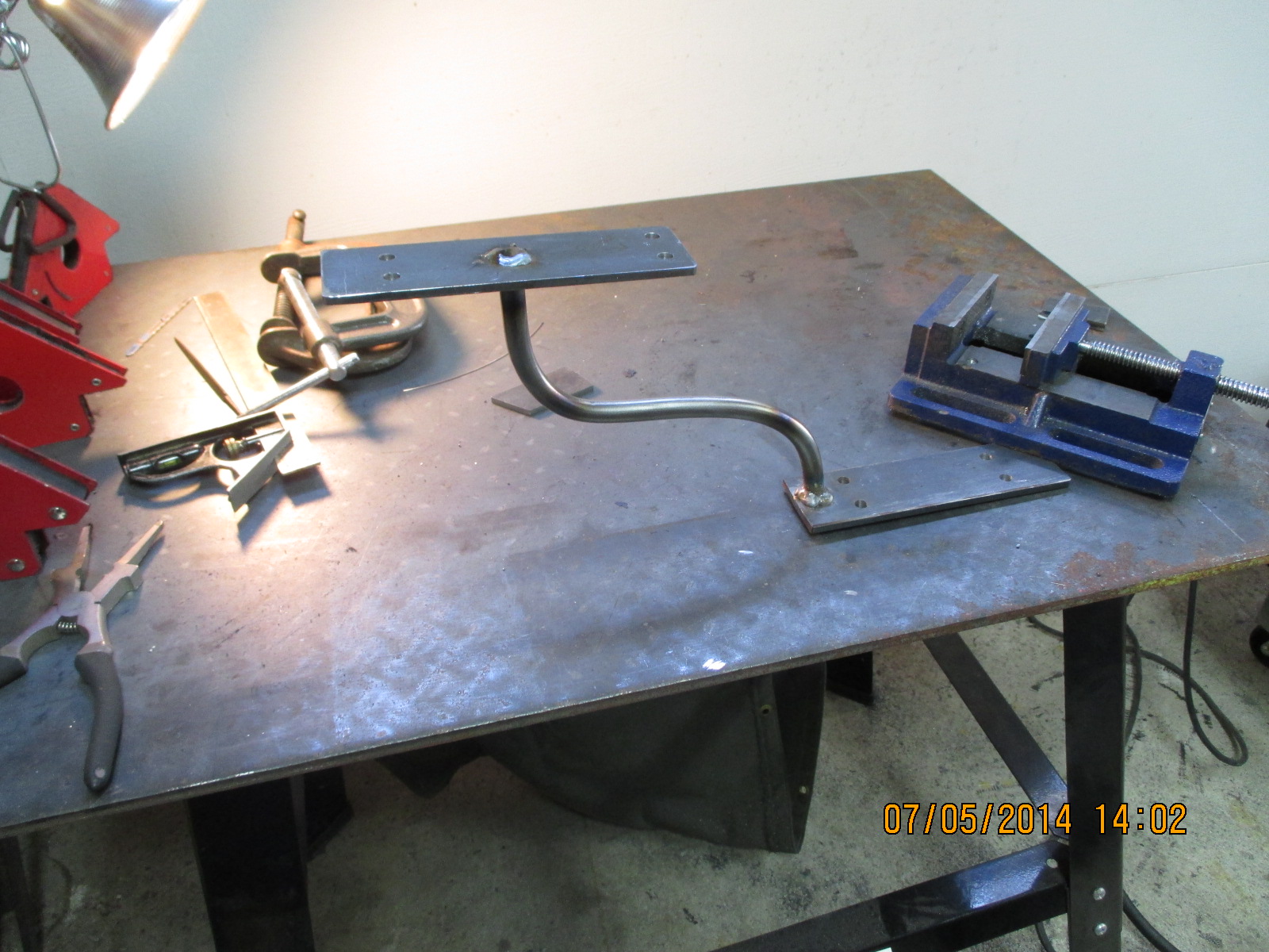

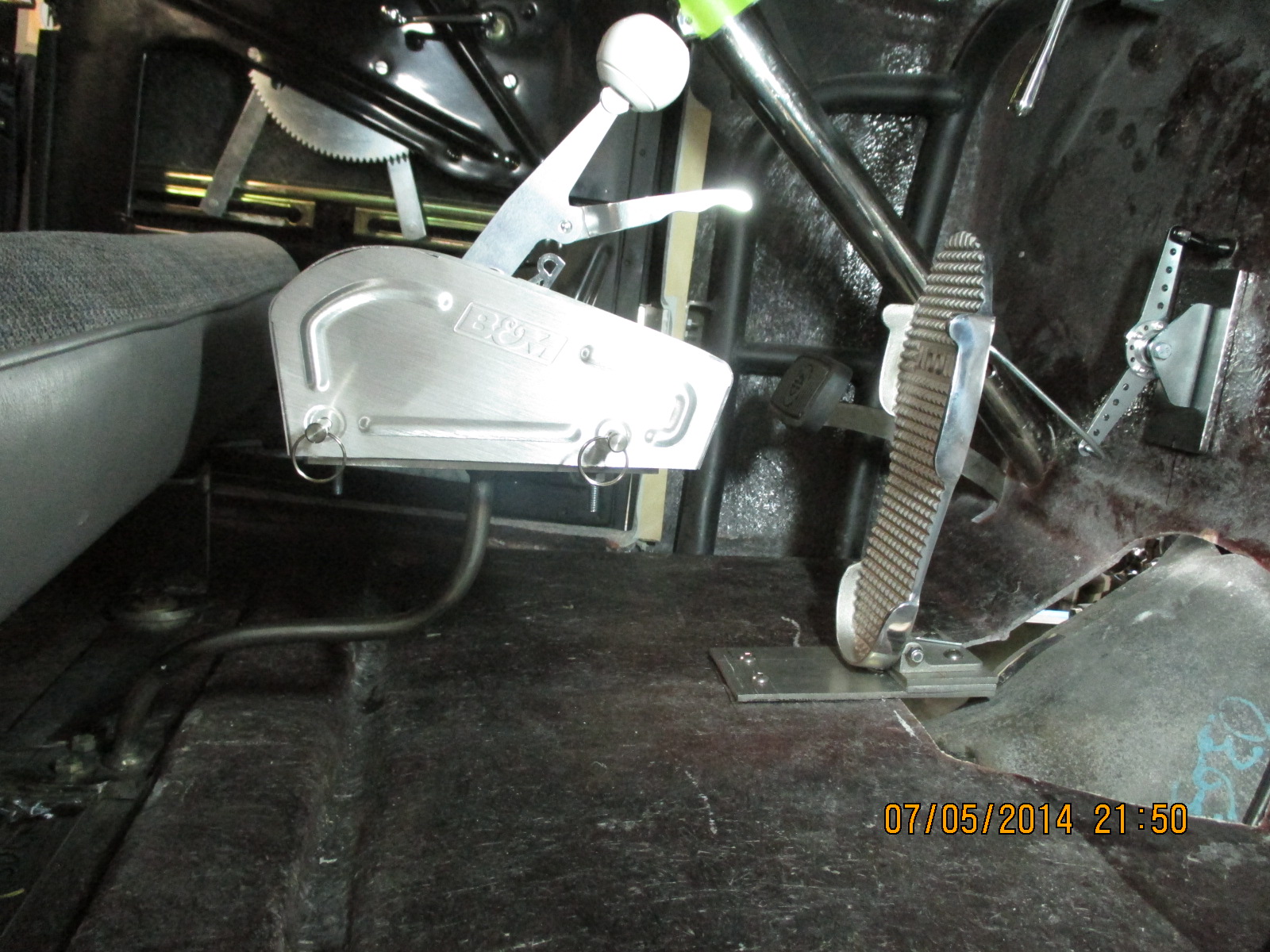

    Shifter mount.
  10. Novaron
    Posts: 188
    Novaron
    from New York

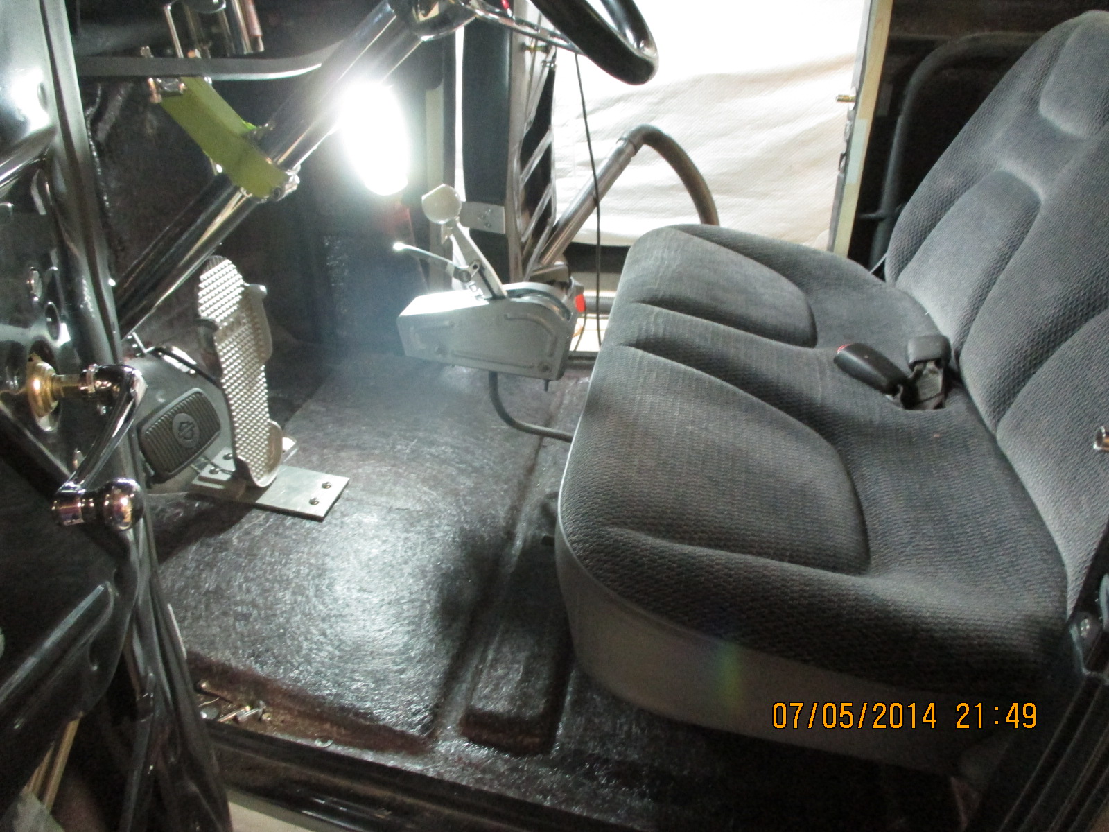

    B&M prostick works with an overdrive automatic. Moon pedal all mocked up. Brake pedal is from a Harley. 20140705_214903.jpg
  11. Novaron
    Posts: 188
    Novaron
    from New York
    Shifter mount still needs some legs to add a little more stability.

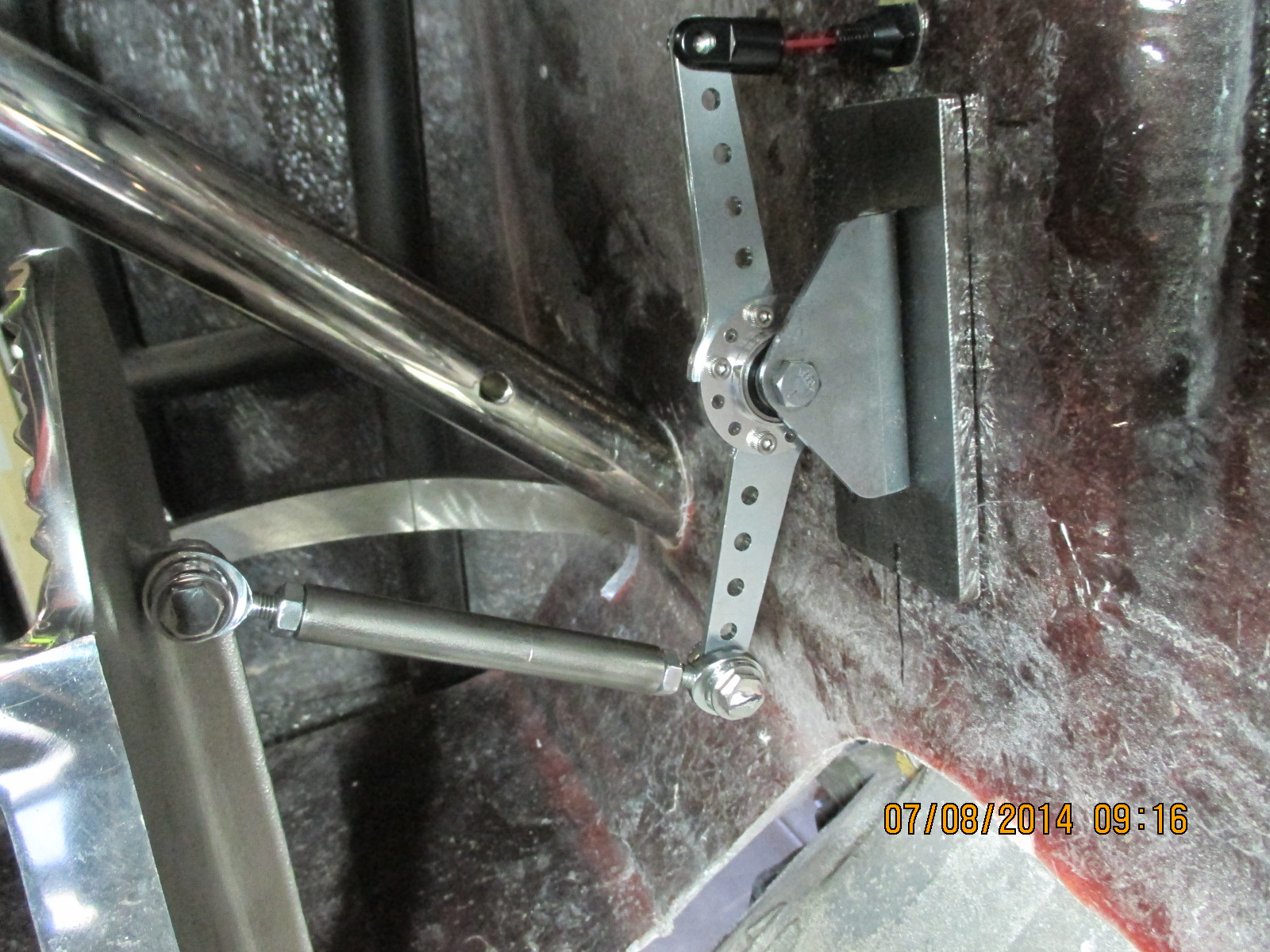

    Better shot of the Moon pedal. The metal plate, for now, is bolted to the firewall with some small nuts and bolts. After I expoxy the mounting plate to the firewall, I will remove the bolts and fill in the holesfrom the outside for a clean firewall. I tapped the metal plate for 1/4-20 bolts. The bellcrank is Speedway. Throttle cable is Lokar. Pedal to bellcrank is just some medal rod for now. Seems to work alright. I hate auto correction. 20140705_215009.jpg

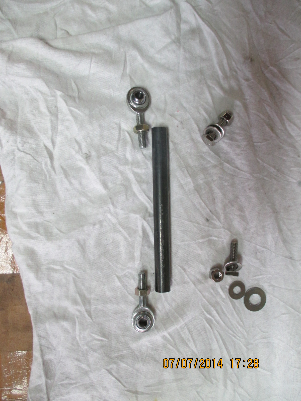

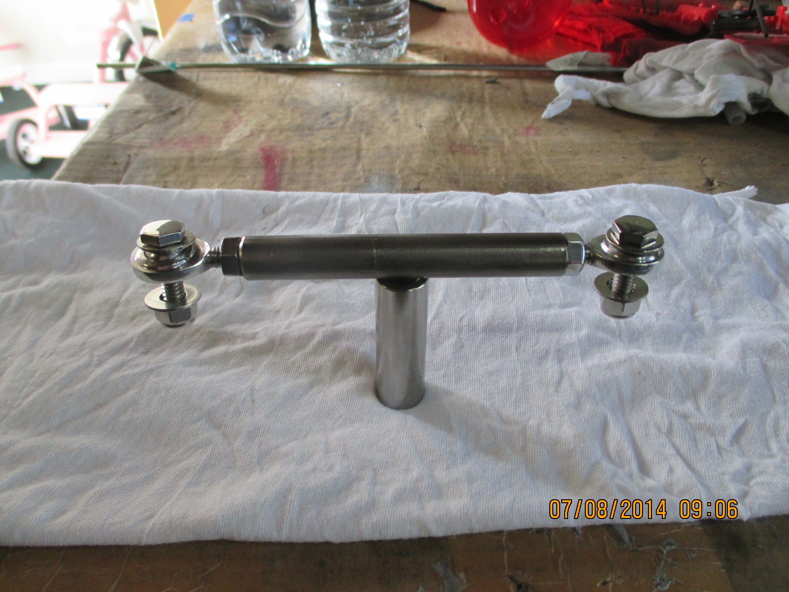

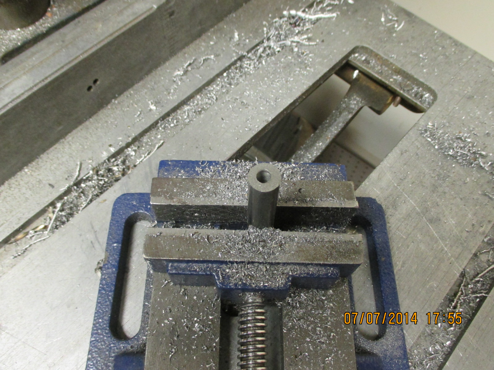

    Making linkage for the Moon pedal
    1/2 rod drilled and taped to 1/4-28 for QA1 CMR4 hiem joints.
  16. Novaron
    Posts: 188
    Novaron
    from New York
    Ground down the heads of the stainless bolts and polished it all up. Ready to install. 059.JPG

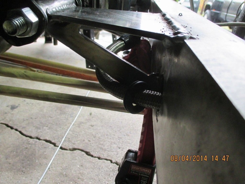

    Bleeding the master cylinder. Found some leaks at a couple of fittings.

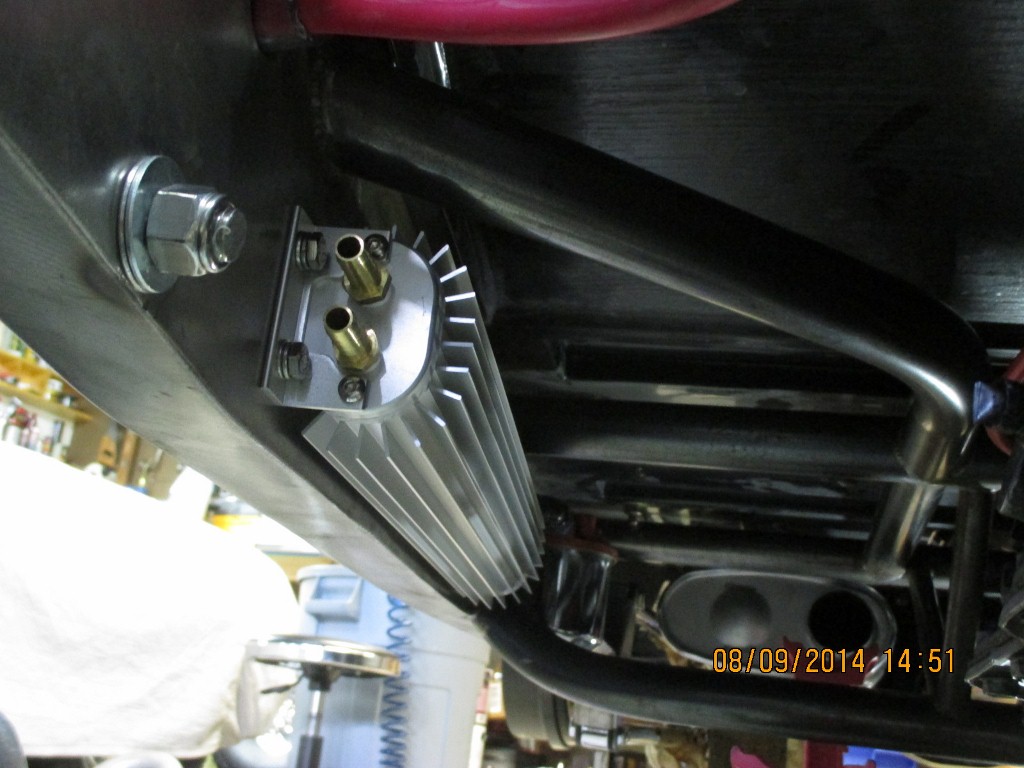

    20" trans cooler...
