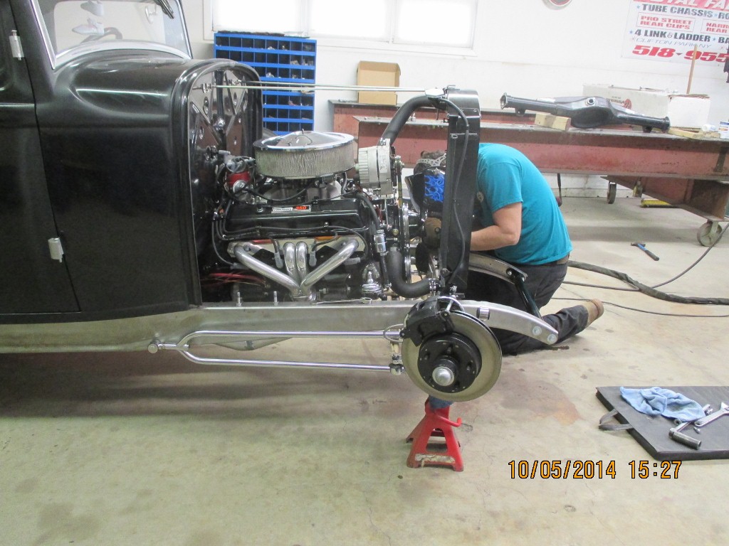

    HOTRODPRIMER

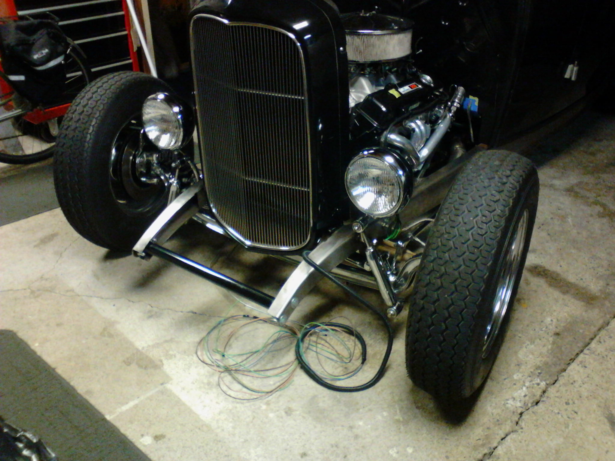

    Have you considered using a zips riser to get the fan centered in the radiator,the fan is so low it's probably not going to do it's job. HRP

    So-Cal speed shop alternator bracket.
  4. Novaron
    Joined: Mar 12, 2010
    Posts: 188
    Novaron
    from New York
    I might have to if this does not work.

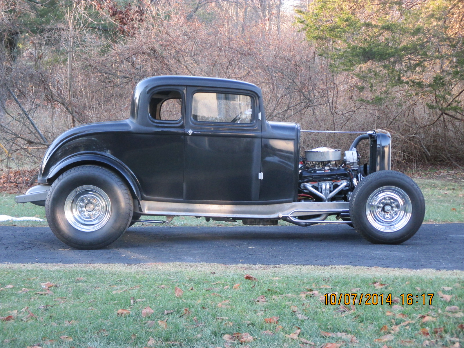

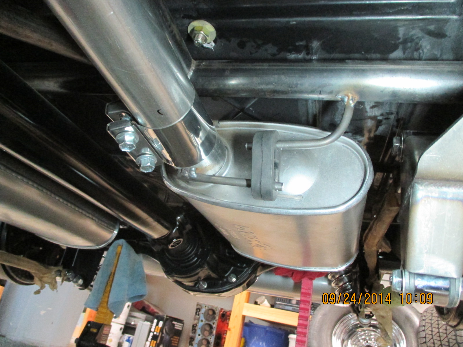

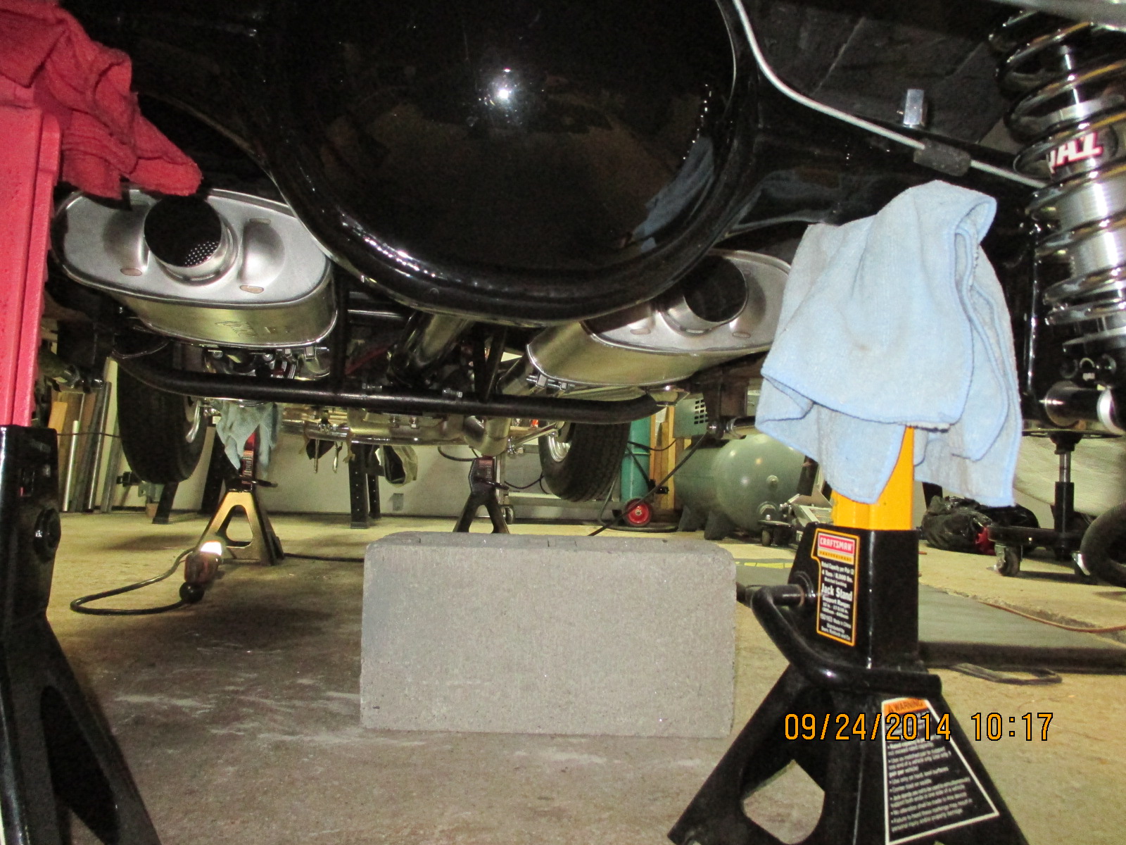

    Drivers side exhaust completed , at least back to diff for now.
  6. Novaron
    Posts: 188
    Novaron
    from New York
    Dynomax Super Turbo mufflers with a Jegs 2 1/2" street rod exhaust kit. Wish the exhaust kit had a few more 45' bends in it, but all in all very happy with the kit. I'll add the tailpipes later.

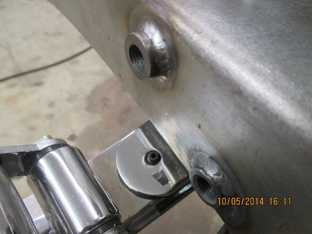

    Front shock mounts tig welded by Nick at Racemasters in Ballston Spa, NY.

  13. Blue One
    Joined: Feb 6, 2010
    Posts: 11,538
    Blue One
    from Alberta
    Nice job, the only thing I could be critical of is the welds on the exhaust. It always looks nicer if they are ground smooth.

    from New York
    Ill need to work on those after I tear it down for paint. Right now I'm kind of pushing to get it ready for the DMV inspection so I can get a VIN and register it...

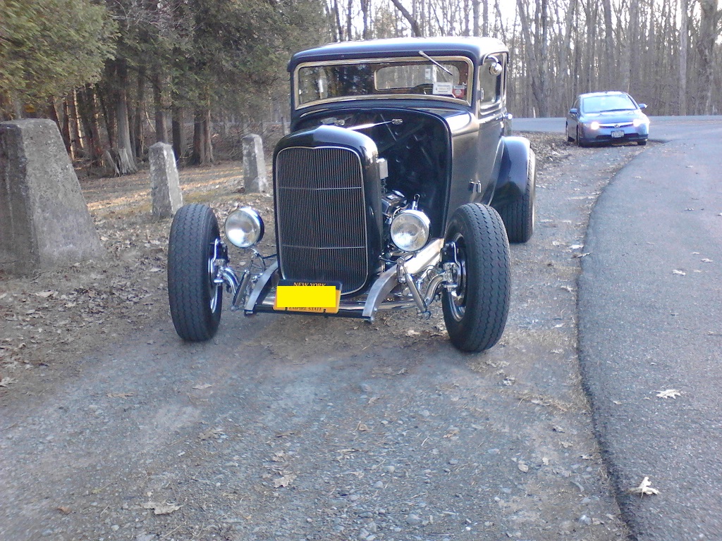

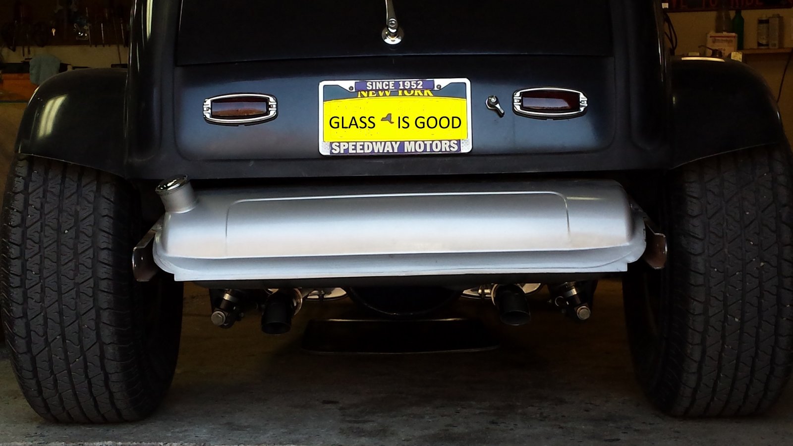

    Novaron
    from New York
    Well, finally on the road! Here's a shot of some tailpipe hanger brackets I made. hangersmall.jpg

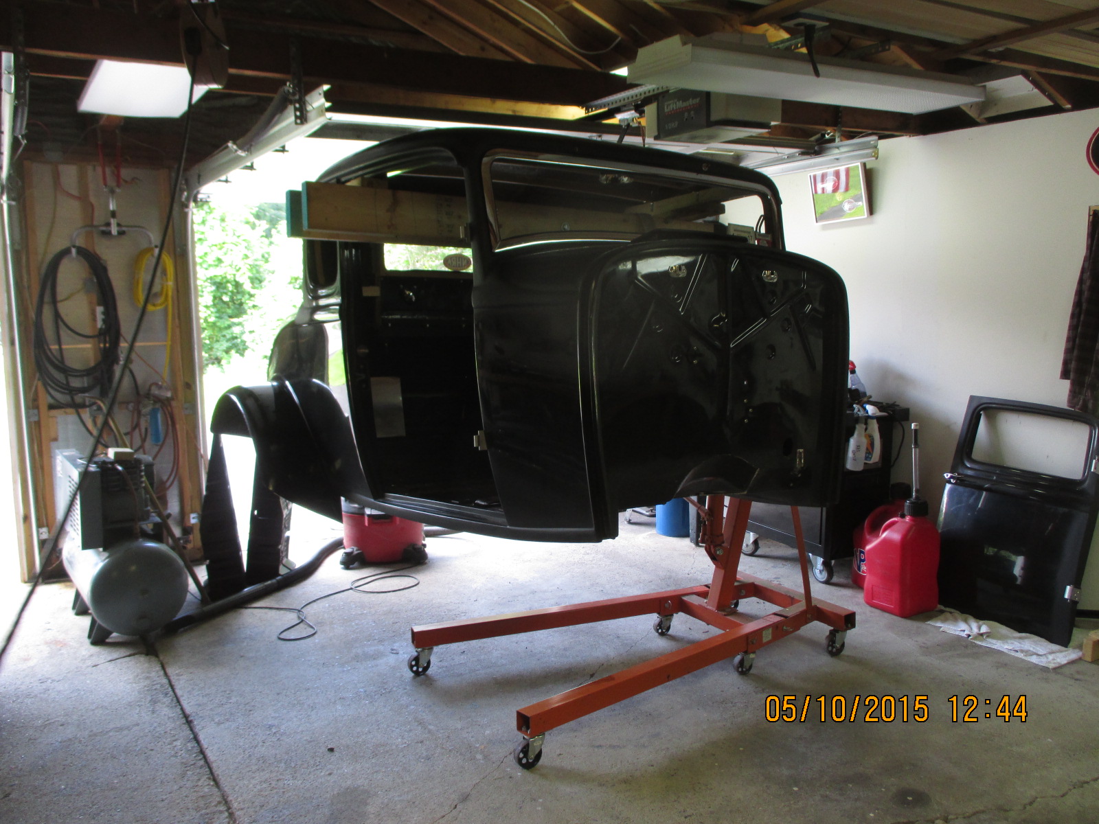

    Apart to paint the frame.
  28. Novaron
    Posts: 188
    Novaron
    from New York
    The tie down strap really helped keep it even as it came up. IMG_1722.JPG IMG_1724.JPG
