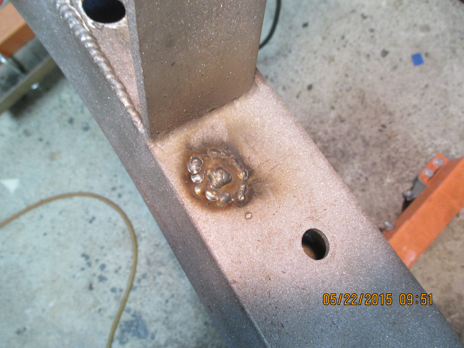

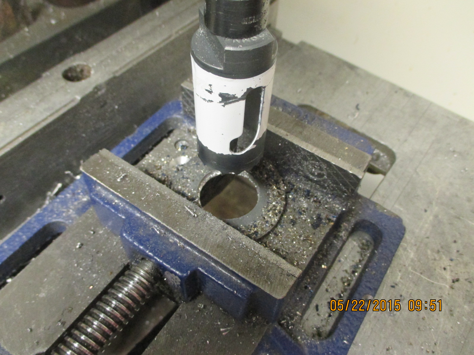

    Had the headlight wires running from this hole, but decided to run them into the cross member instead, for a little neater look. You can see the new hole inside the cross member in this picture. I cut a slug out of a piece of s****.

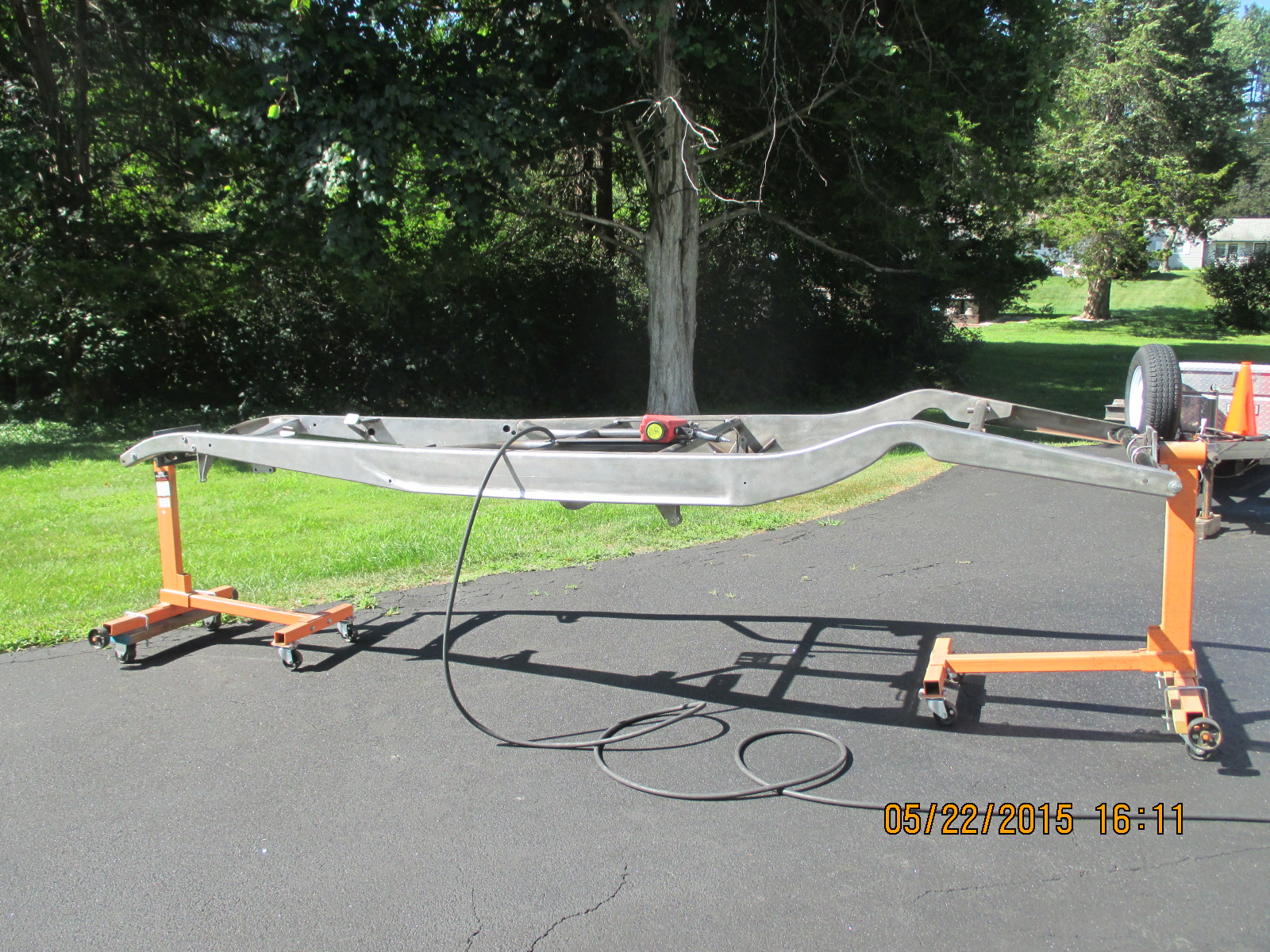

    Primed. PPG NCP 271-3 coats. Bought a Harbor Freight touch up gun to get into the cross member. Worked great. 20150730_113043 (1024x576).jpg

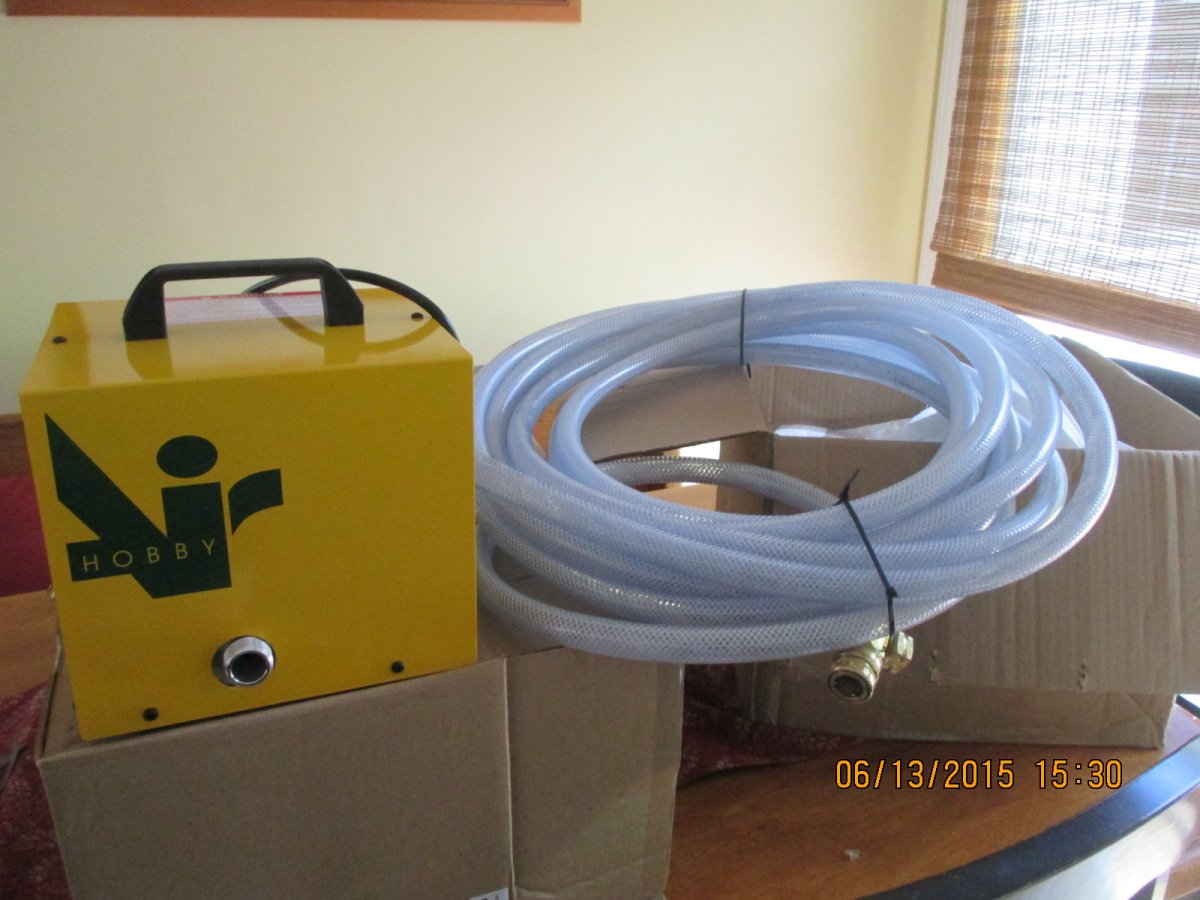

    009.JPG Don't want to press my luck anymore then I already have. Hobby Air 1 forced air system with full hood.

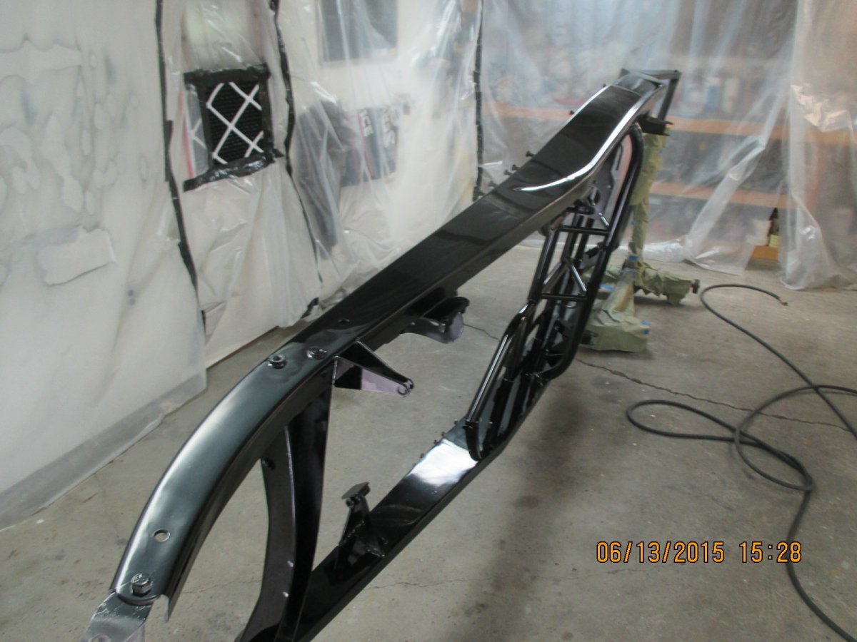

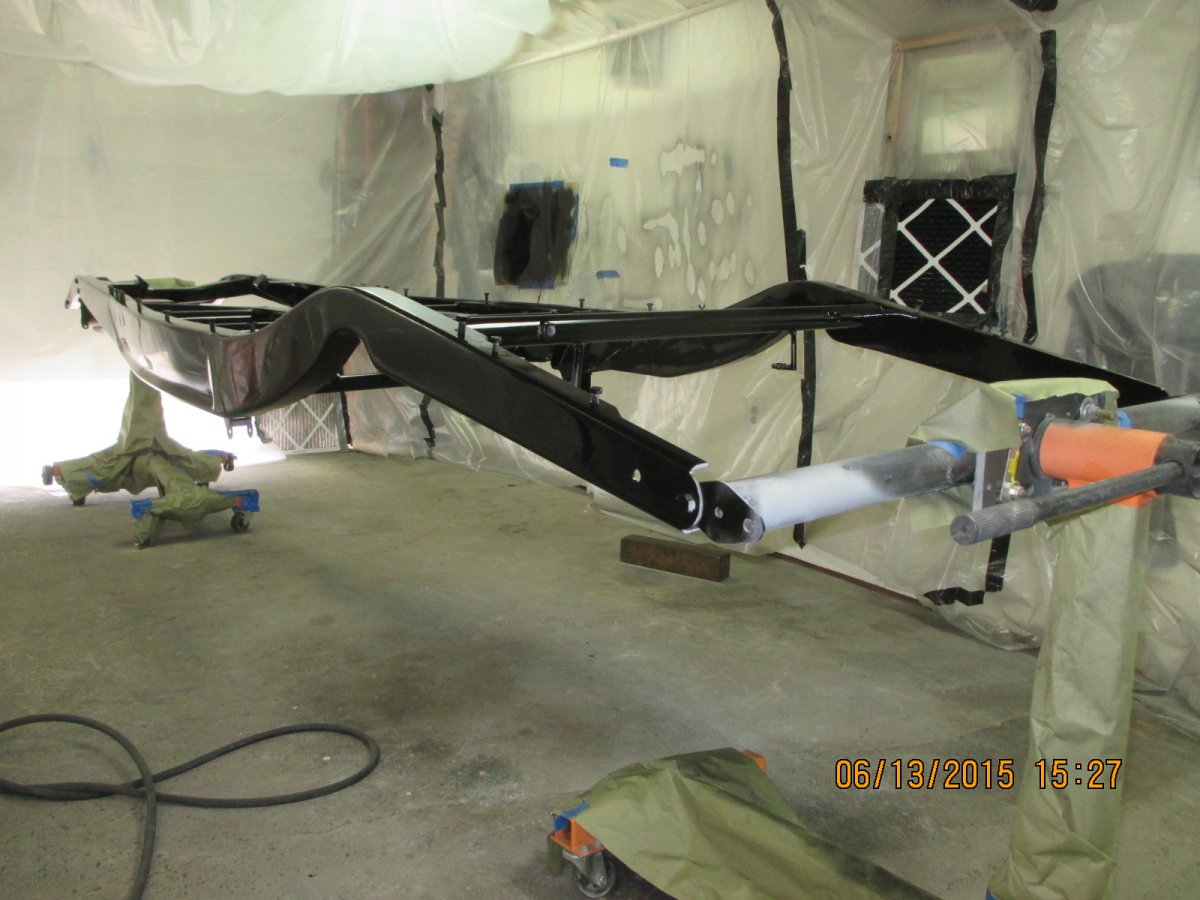

    PPG Concept single stage acrylic urethane. Two coats. Had a few runs, and a fair amount of dirt so I unplugged the gun and walked away. I'll fix it and try again after a little break. 002.JPG 003.JPG

    Frame painted again. Came out much better this time. Fixed the runs and imperfections and sanded with 1000 wet. Put on 2 more coats. Will still have to wet sand and polish though, 2 small runs and a few dry spots . Lessons of the day: Move the gun faster to avoid runs and practice makes... better! Up next is paint the firewall, gas tank and bottom of the body and then re***emble. Pyched!!
