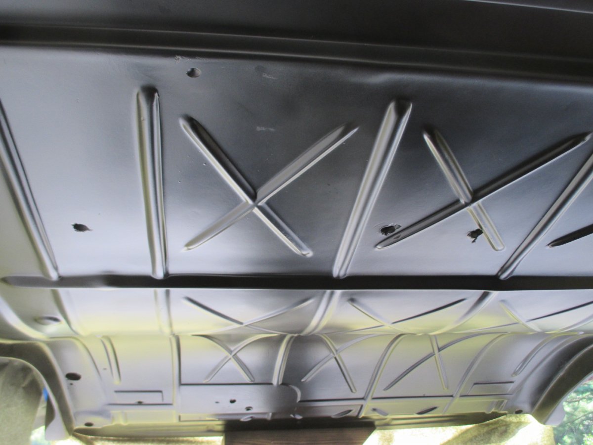

    Firewall primed. PPG NCP 271 primer. 4 coats.

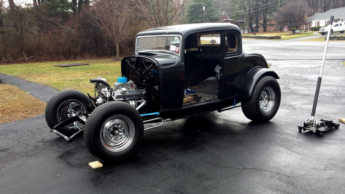

    Body going back on.
    1932 Ford chassis finished.jpg 1932 Ford body mounting2.jpg 1932 Ford body mounting5small.jpg

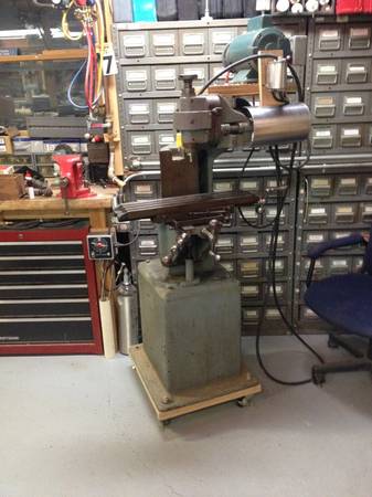

    A bit OT, but thought some of you might enjoy my latest find. A c1915 Van Norman Model 0 milling machine. Can't find much info bout it.

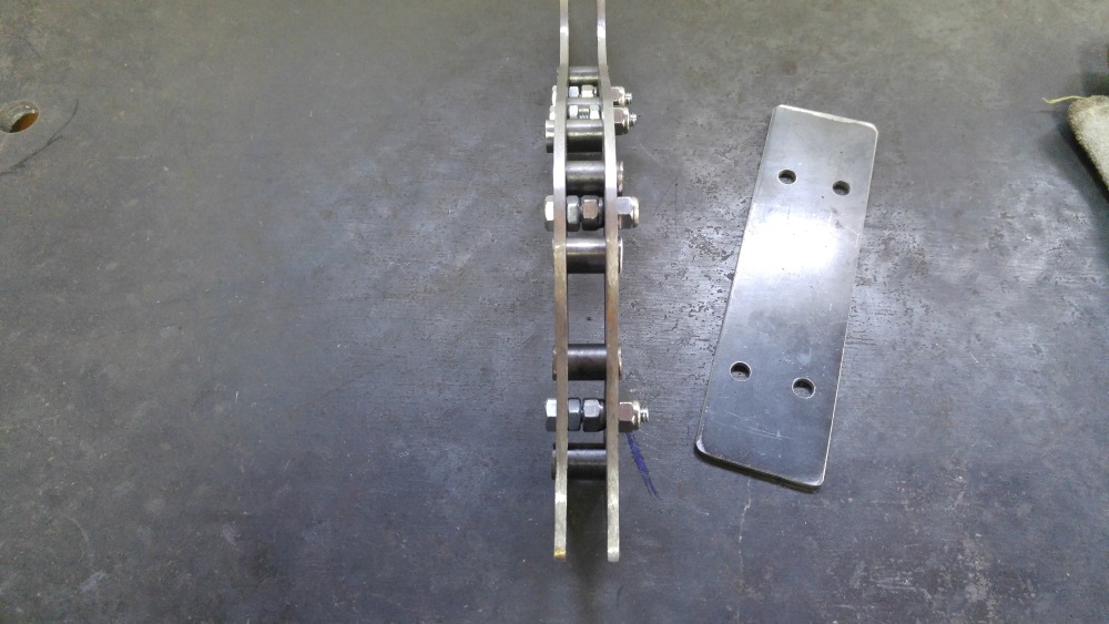

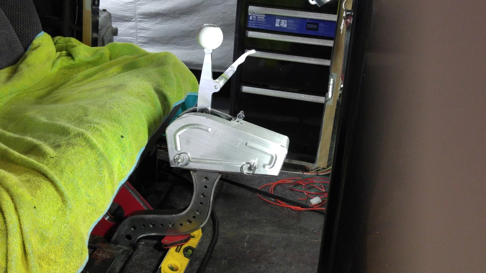

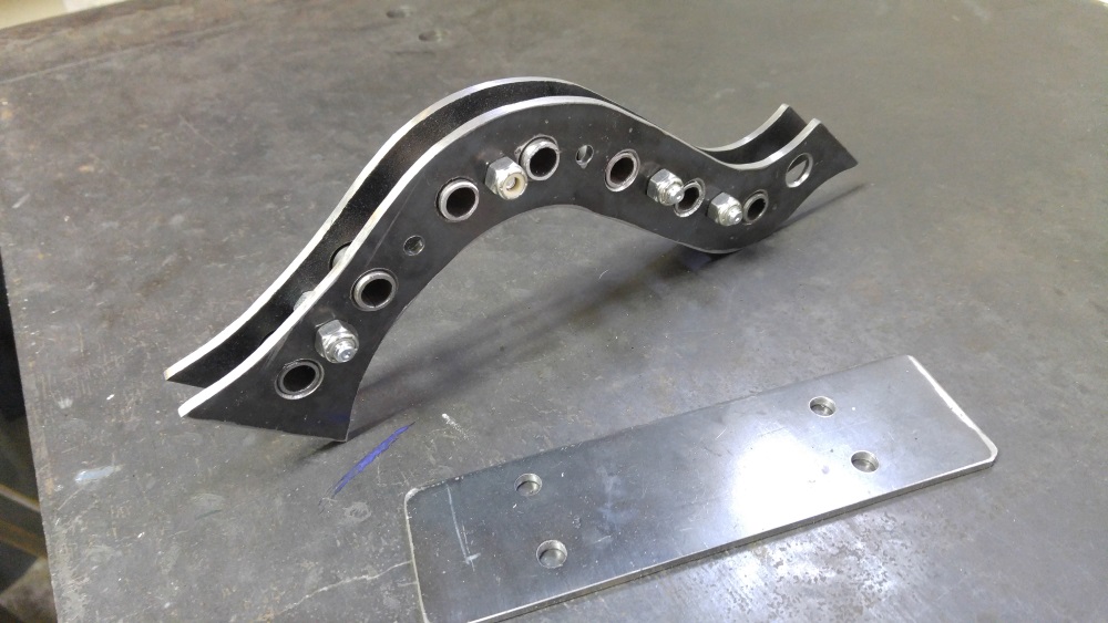

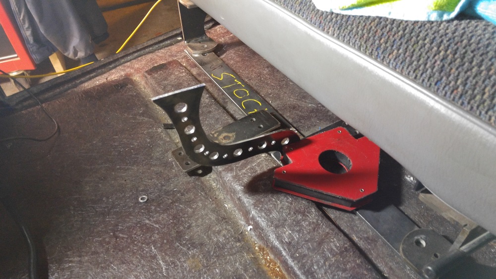

    Doing some wiring. Mostley done with that. Wanted to make a different shifter pedestal.

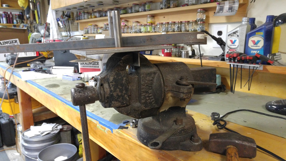

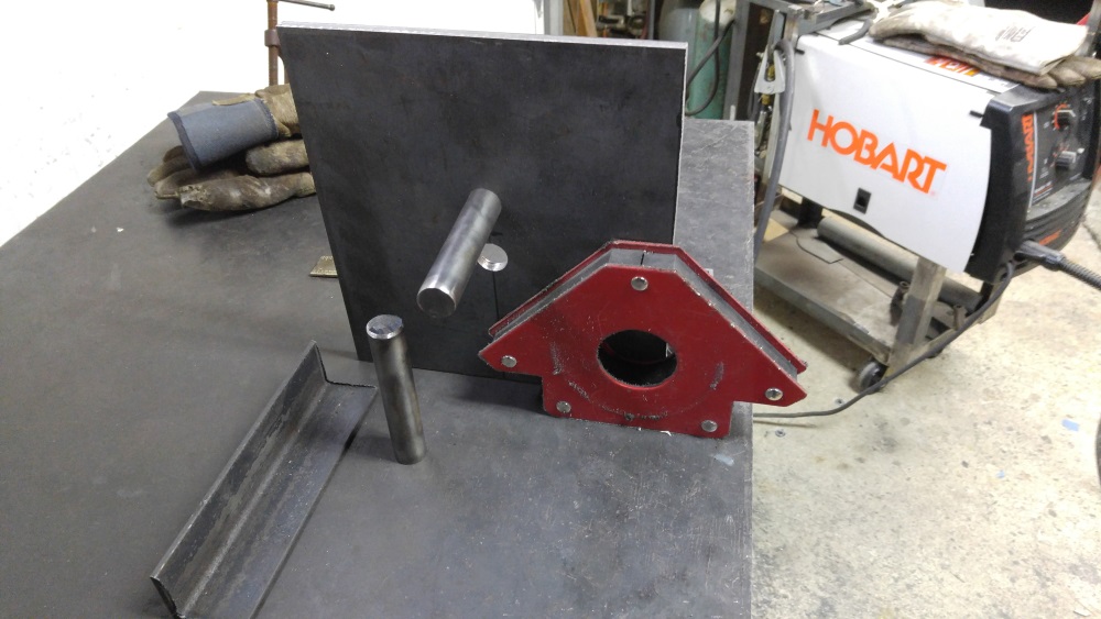

    Made a jig to bend the flatbar.

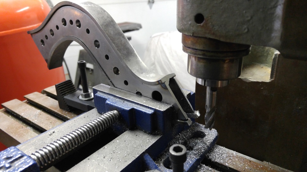

    Getting there. Milling a slot for the nutral safety switch wires to exit. shifter mock up  with mill.jpg shifter mount 4.jpg

    Almost done. I'll get this tig welded by a friend and then chromed.

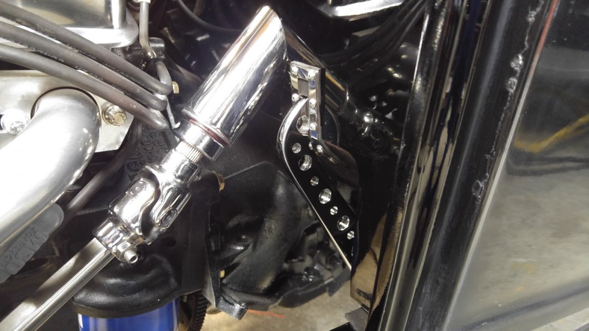

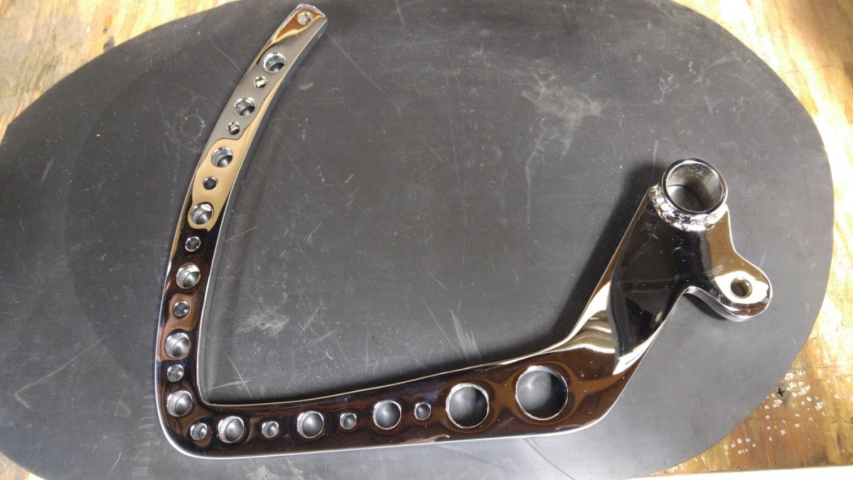

    Brake pedal back from the chrome shop and installed.

    Back on the road, just in time for spring!
