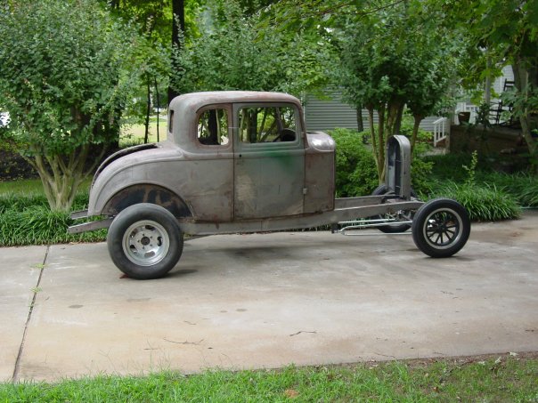

    Just about to start building my drag coupe and have a quick question.
    Will a 390 Cad flywheel fit a 371 Olds?
    Here are a few pics of what I'm building.
    Cheers! -Ryan

  9. Well turns out I ended up going with a 1958 392 Hemi in the end!
  10. I sent a lot of time in the mock up phase working out how to set up the frame.
    Then into it with the hole saw! still have to finish the lightening process.
    Thank to Mr Brian B***, he helped me out with the ****ter shield info I was after.
    Next I gave the body a general clean up, in with some bondo!
    mad mikey, hipster and kiwijeff like this.
  11. Out into the spray booth for a few coats of DNA primer and a pearl blue base coat for now.
    Next I cobbled it together for one last mock up now having gone to a tube ch***is design rather than '32 rails.
    This was the plan but in the end I had tube bent up for the main rail step up.
    Next with the help of my mates Big L, Ben, Aaron and Soco we spent a day on fabrication to get the old girl rolling.
    Then after a short sleep Big L and I dropped the motor on for a look.
  12. Next day I positioned the body up and mounted the motor and she was off to Chopped for display! I very busy three weeks I tell you! Next I will be building headers, setting up the steering and building the cage, so more to come.
    Cheers -Ryan Ford

    Tell us some more details- looks like a 9" Ford rear. What about the ******?
  19. Cheers guys! It's running a 4 speed top loader and a 1964 Pontiac posi. More pictures to come.

    Alex is in the early stage of building his 5 window drag coupe. HRP
    10392063_1113018072234_6675773_n.jpg 10392063_1113017352216_5603053_n.jpg full.jpg
