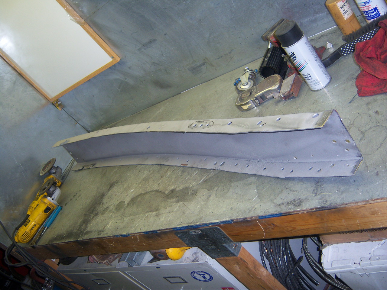

    ok ive been collecting parts for a while and a few days ago i figured it was time to see what i had...

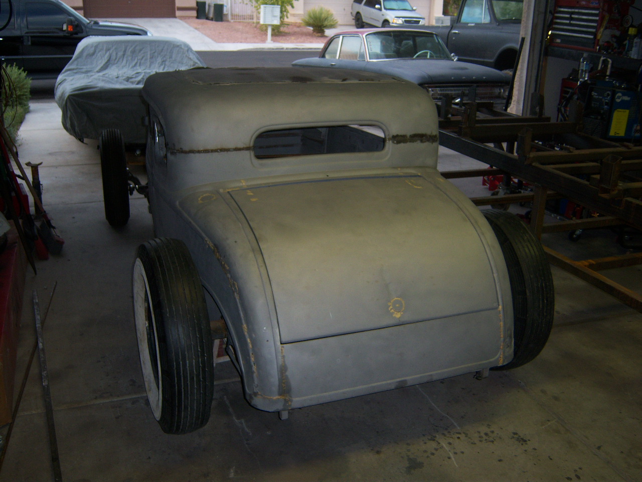

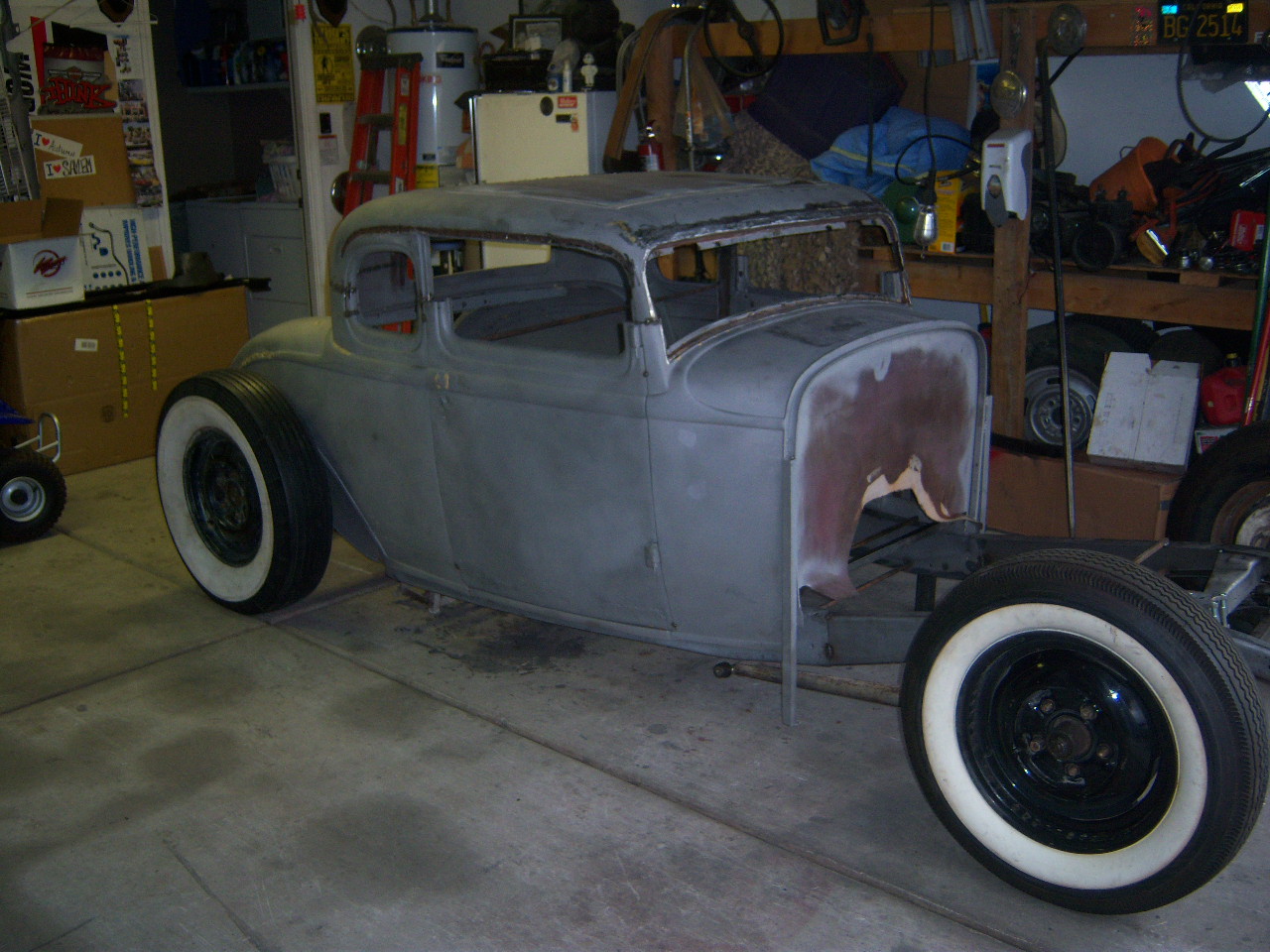

    it had a chop on it but it was hacked so i chopped it more and built new a pillars, also have a 700r4 trans because i plan on driving it state to state with ease.

    i have a schroeder steering box and plan on a push button trans shifter.. i sit in it now and seems to have alot more room than any of my model a's

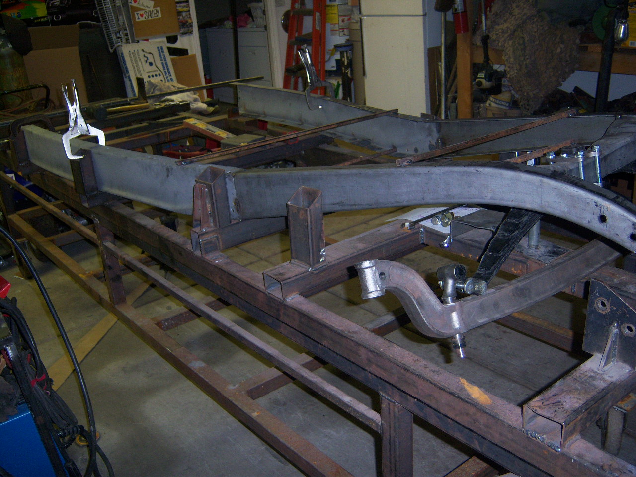

    that is a really good build. Is the center section of the frame from a 32? or repro? I really like the set-up on the chassis.
    How much is it channeled? chopped?
    Are you gonna put drip rails back on?
    I also dont blame anyone for runnin an overdrive. If you have run state to state with an early drive train without overdrive then you know.

    the car is chopped about 6 1/2 to 7''.. i was told it had a 3 1/2'' chop but it was crooked so i took out another 3 to 3 1/2 to get it straight. its channeled 4'' and the center rail pieces are original but the fronts are repos, i kicked up the front of the frame.. i have new drip rails and i will put them on.. the one that it had where welded solid.. i saved this car from being a tube chassis street rod..

    That definitely doesn't look like a 6 1/2 to 7" chop, more like 5".
    A stock 5W has a 10 5/16" w/s, 13" side, and 9" rear windows.
    Subtract your measurements from those, and tell us what you
    wind up with. Great looking start though.
