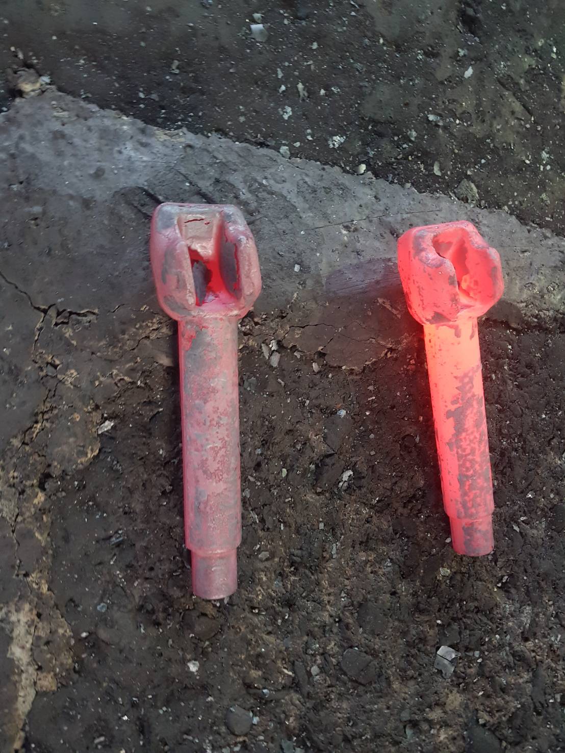

    I hit some milestones with the new steering box project.
    I assembled the 100th new steering box:
    And finally got somewhere with the new sector shaft forgings
    In that we finally have a fully machined and dimensionally correct sector shaft
    Now to machine a small batch and send them off to heat treat. This is what helps to keep the 5w project progressing.

  4. dwollam
    Joined: Oct 22, 2012
    Posts: 2,670
    dwollam
    Dang! Color me impressed! Wish I had just a small amount of your talent.
    Dave

    VERY Impressive! Proof that we can still build stuff in the USA. Bob
