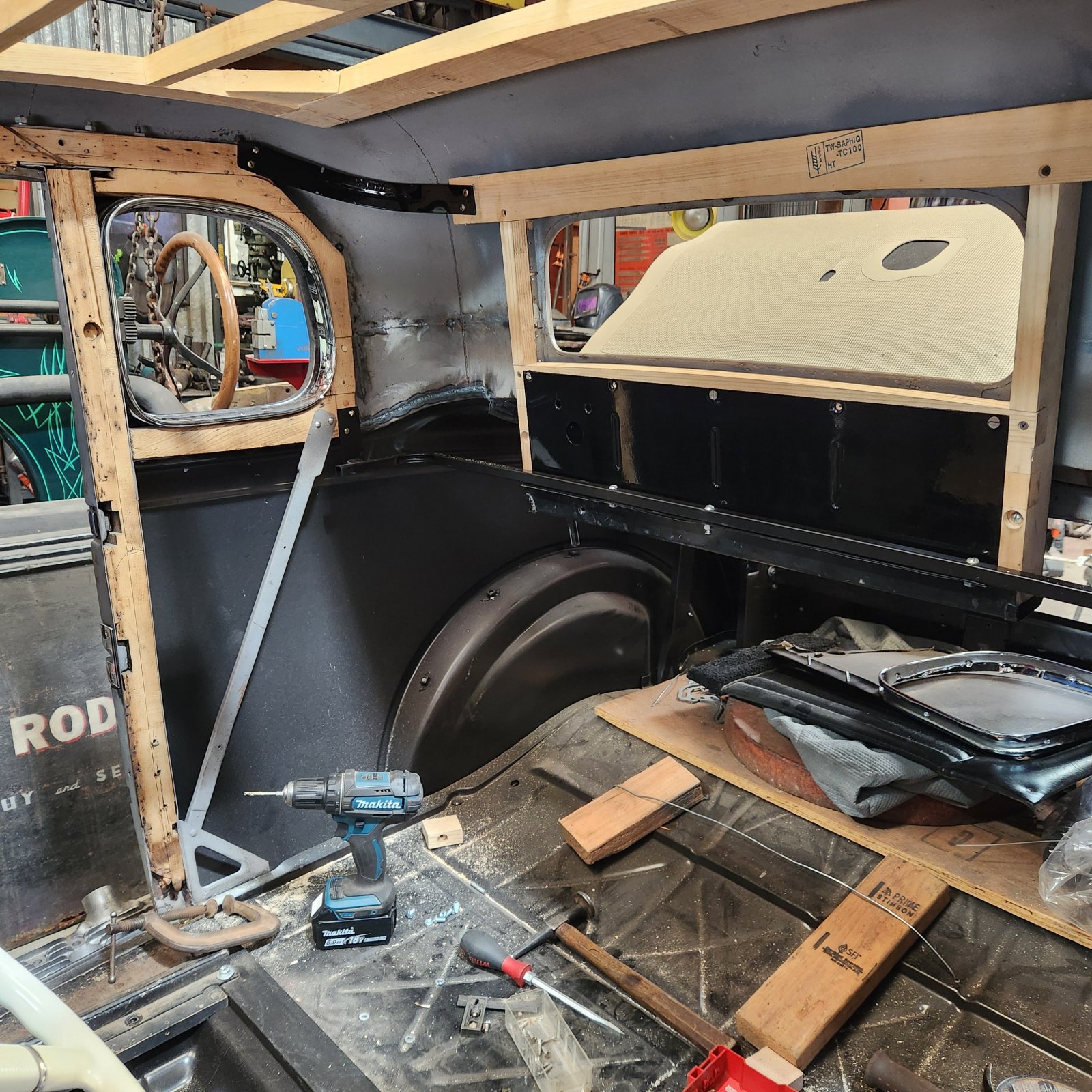

    Worked on the interior this weekend. Got the rear window gutter installed as well as some of the metal bracing that ties the wood together. Got the seat pan and original seat slides installed. Made up floor boards and started messing with seat position. Being 6'2", I need the seat pushed back, almost all the way towards the rear window. I also installed the pedaks with the 49-51 Ford pedal pads and mocked of the Shoebox accelerator pedal. I threw in the old interior panels i got from Flip. I'm digging the old interior vibe and think its all going to work out well

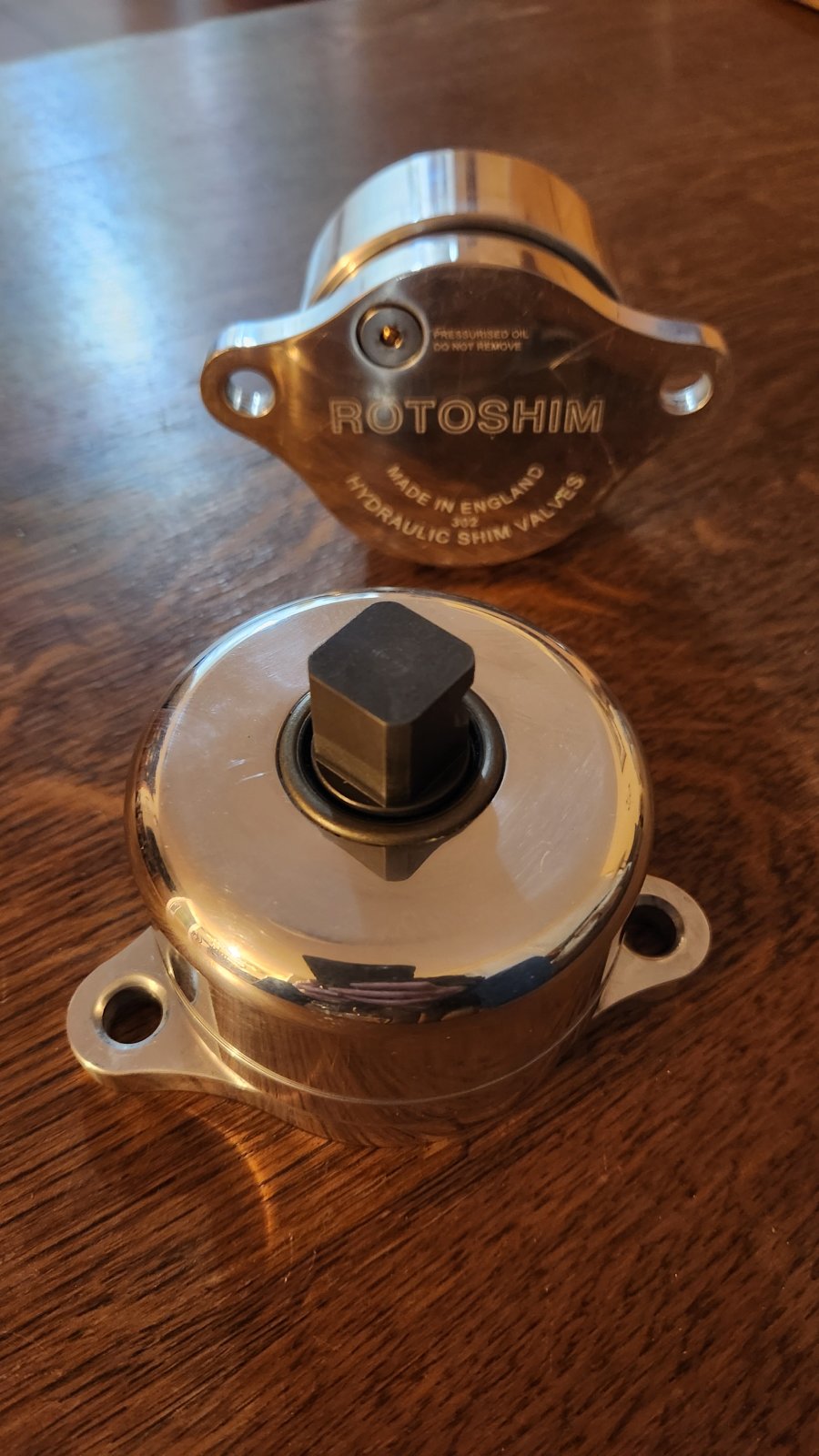

    I bought a pair of Rotoshim front shocks. I just got them and am really impressed with the quality. I am getting ready to send more parts off for chrome, so mocked up the shocks to get the arms aligned. They took a little bending to make the shorty links line up. I think Ford designed 32 shock arms based on the narrower Model A shock, because they all seem to need to be bent in 1/4" to line up with the axle. I've found this to be true on both front and rear.
    Anyway, a quick heat and bend takes care of it.

    Those shocks really look the goods, are they valved differently for a V8 over a banger?

    Looking at the shocks I ***ume they are the polished version? Interior looks good.

    Yes, the shocks are polished, rather than the usual black anodize. And the interior is temporary, but should get me by for a while.

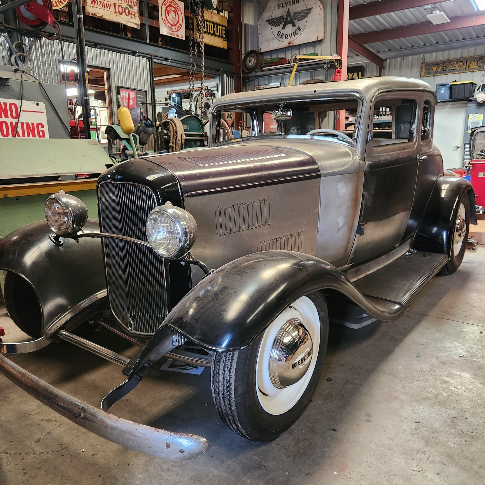

    Started stripping the body today. Got the driver's side done. 320 on a DA and 2" scotchbrite rolocs for the details. About 2 hours for the one side, so not bad.

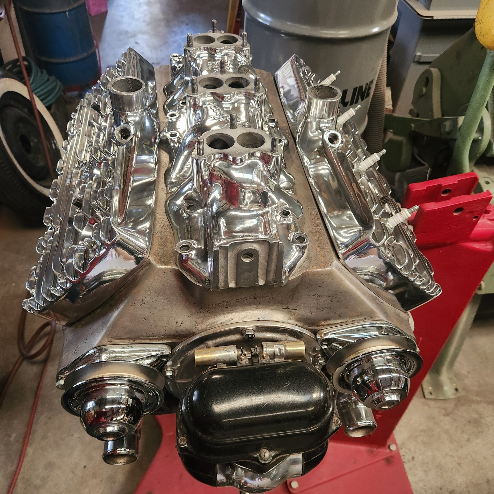

    Also got the heads and intake back from the polisher. I am working on colors, tyring to nail down an accent color for the engine, firewall and random ch***is parts.

    Ever see that Olds block that was plated by Advanced a little while back????

    Yeah, amazing project. I will have most of the parts polished or plated, minus the block.

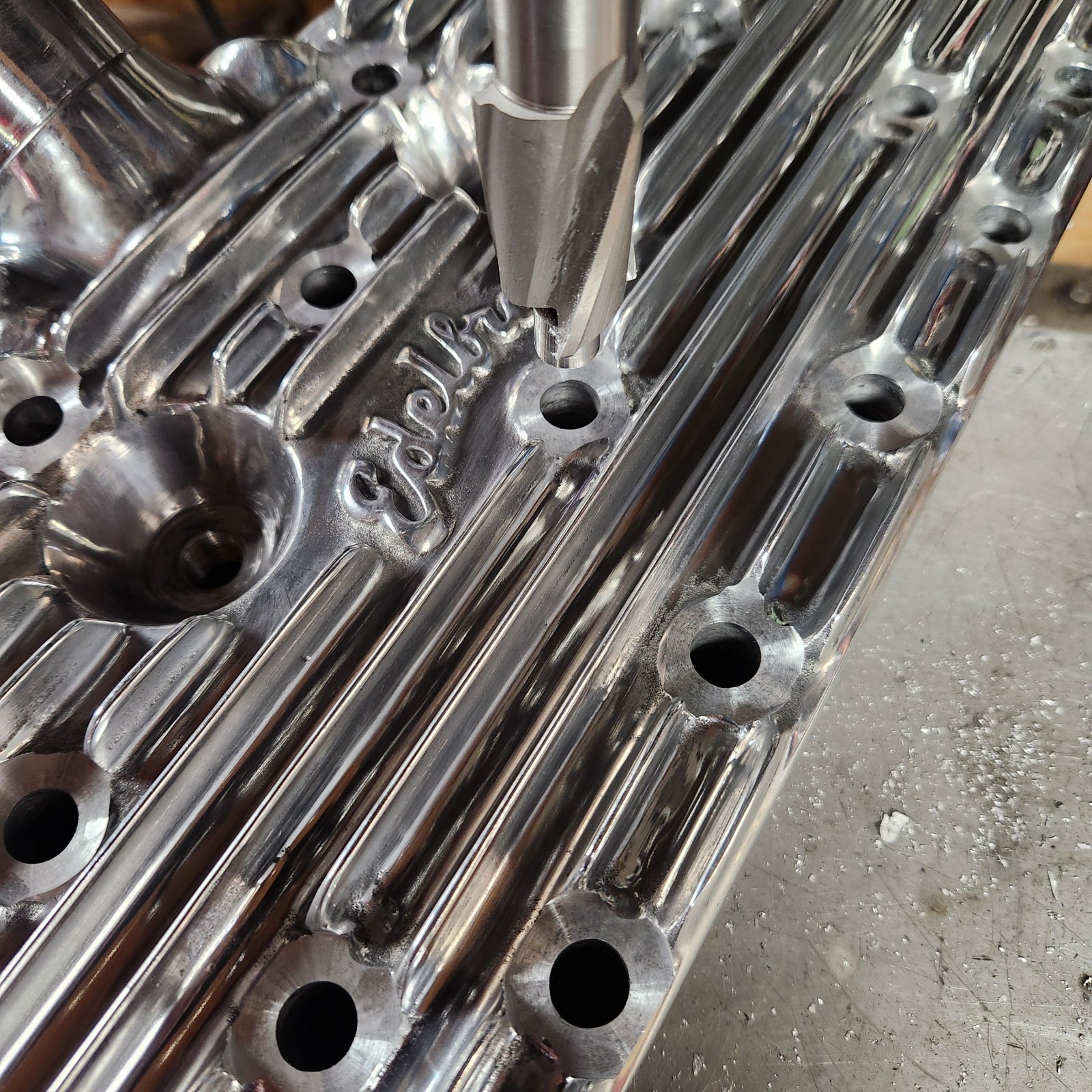

    The polisher got a little heavy into the head nut faces, so I had to spot face them to get a clean torque surface. Quick job, but another step I didn't anticipate. But I got to buy another tool (spot facing set), so that's always good...haha. I used a 1" spotface with a 15/32" pilot. The pilot had to be ordered separate, as the pilots in the set were by 1/16"

  22. The37Kid
    Joined: Apr 30, 2004
    Posts: 32,550
    The37Kid
    ^^^^^ Nice detail, acorn cap covers hide odd length head studs.

  23. 60 Special
    Joined: Sep 8, 2007
    Posts: 302
    60 Special
    from Omaha Ne.
    Nice work! That "spot facing set" is also referred to as a counter bore set. They are used to set the heads of Allen head cap screws below the surface of any project you are using them on. 60 Special
