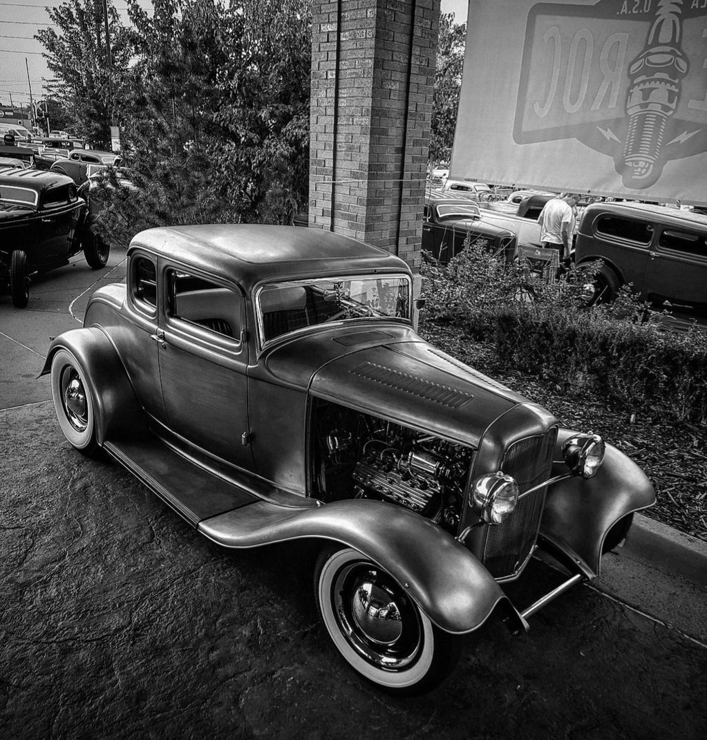

    A cool black and white pic that showed up on Autoiconic's Instagram page

    That looks wild. Out of interest did you get to finish your time at the ROC? Or did it need pushing onto the trailer?

    We were about a mile from the hotel when the cam let loose, so the car was pushed into the trailer.

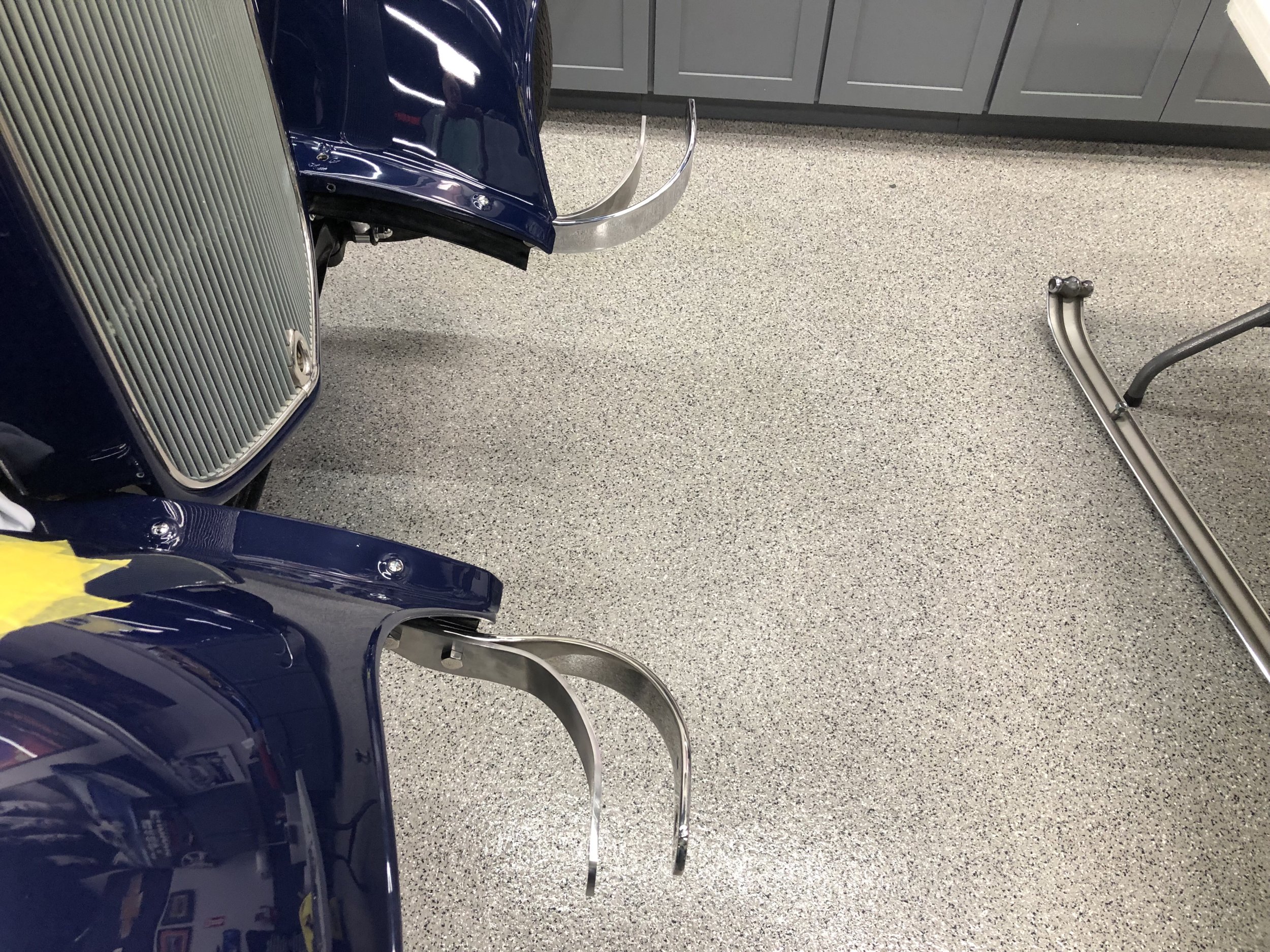

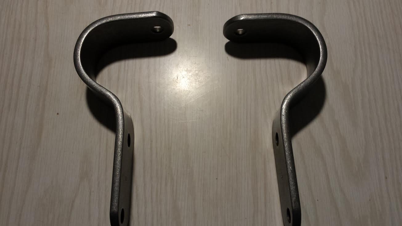

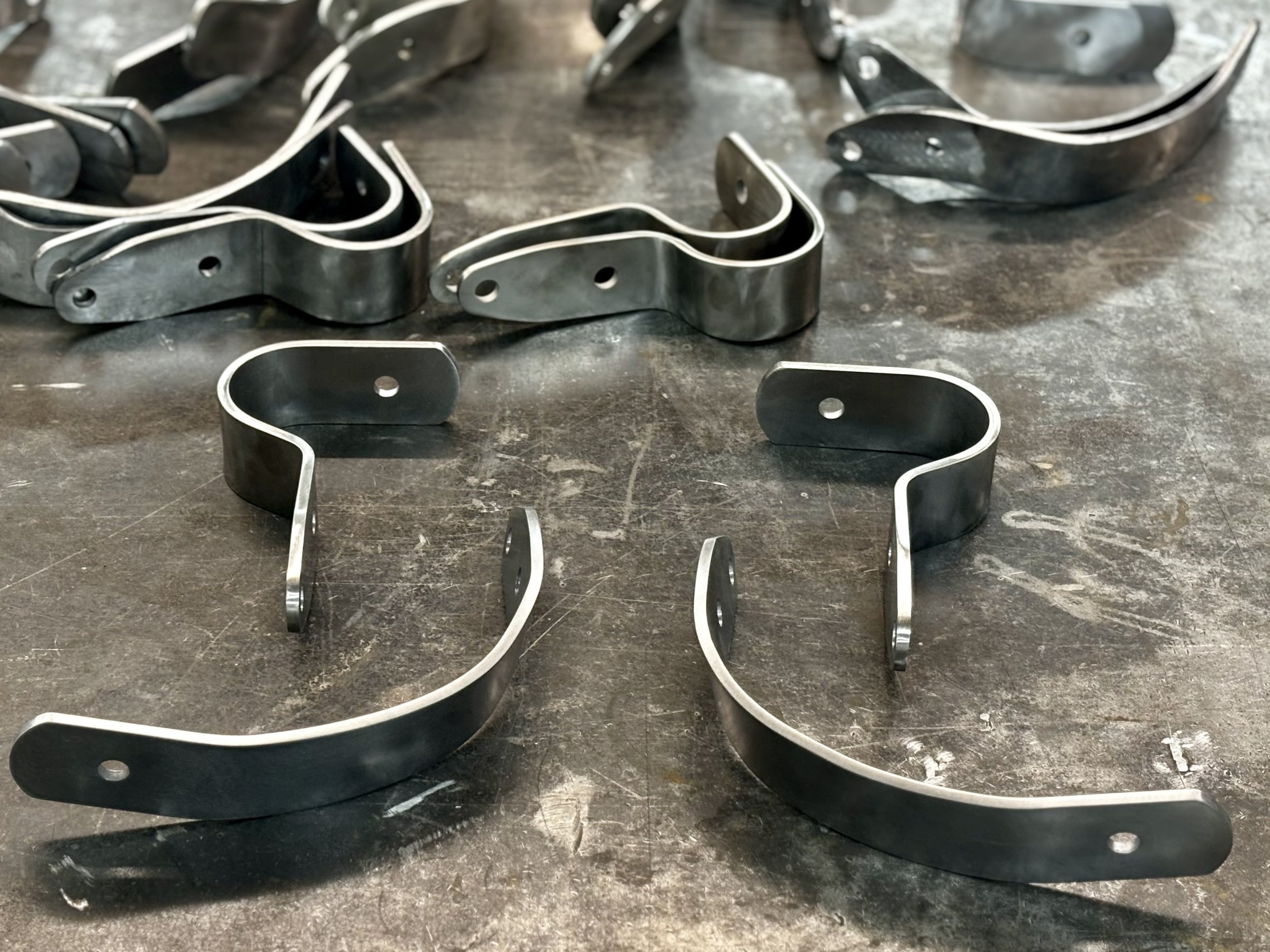

    I am producing these now. 3” shorter in the rear and 3.5” shorter up front. Fronts I make stock height or 1” lower. I am new to this site and don’t quite understand its format. I’m on Facebook an instagram, search metalguy34. Or message me here?

    Jason: Your bumper irons look good. The originals had radiused not square edges. The original reproduction shorty irons I bought several pairs of at the LARS made by Bob V had the radiused edge. Not a big deal but something a die hard deuce ***** like myself notices.

  18. Jason Arrigo
    Joined: Oct 26, 2024
    Posts: 20
    Jason Arrigo
    I have been making 32 shorty brackets for a few weeks now. I am new to this site, was planning on starting a post for these soon. They are 3” short in the rear and 3.5” up front, 1/4” material. I offer the fronts dropped 1” or stock height. Mild steel or Stainless. Let me know if you want more information.
  19. Jason Arrigo
    Posts: 20
    Jason Arrigo
    That is something I discussed with people as I was developing these, people seem to like them both ways. My thoughts are that detail can be added by the end user before chrome or polish or paint. They are also 1/4” as opposed to 5/16”. I found the thicker material, especially in the rear to look too bulky considering their smaller size.

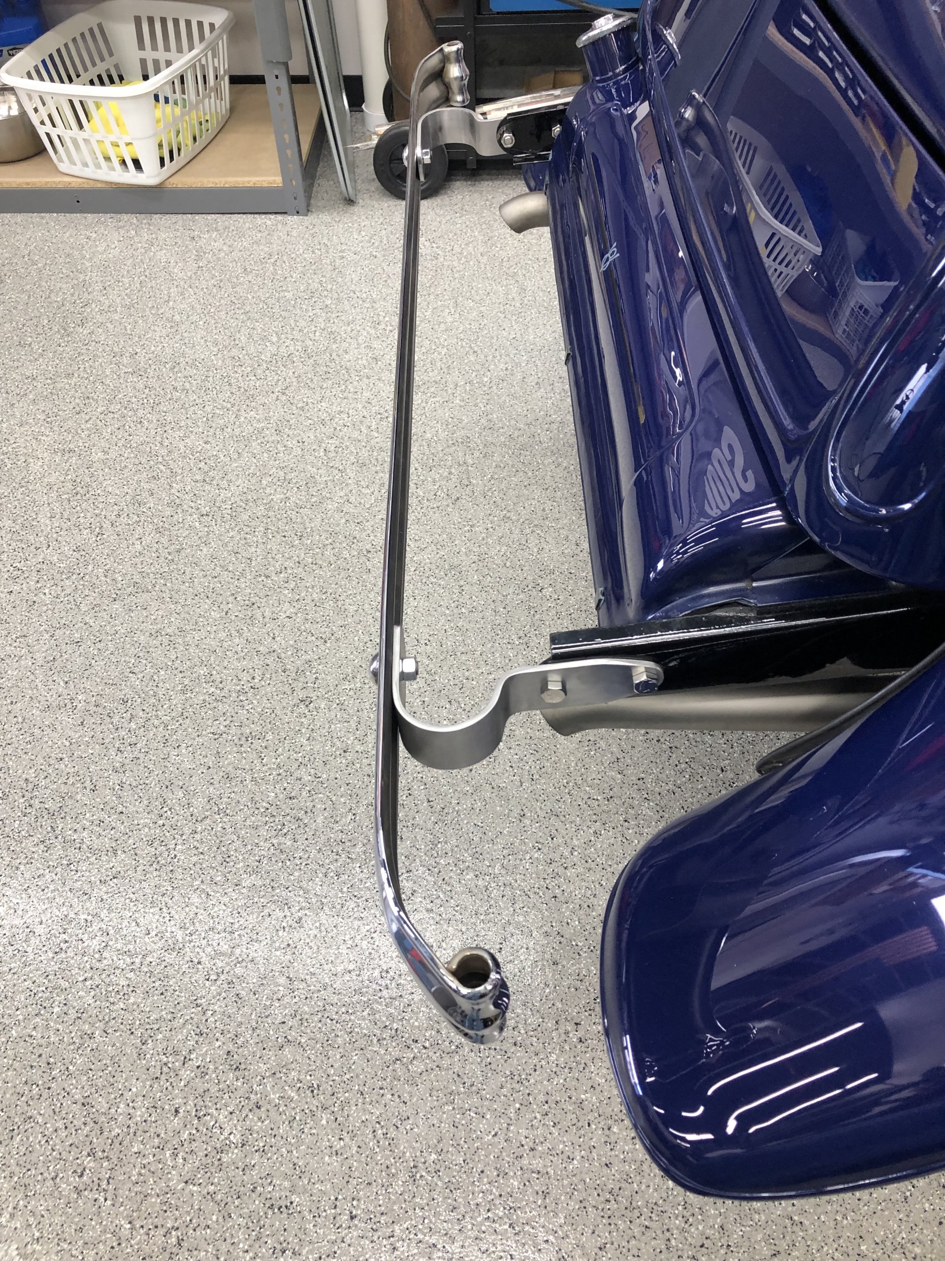

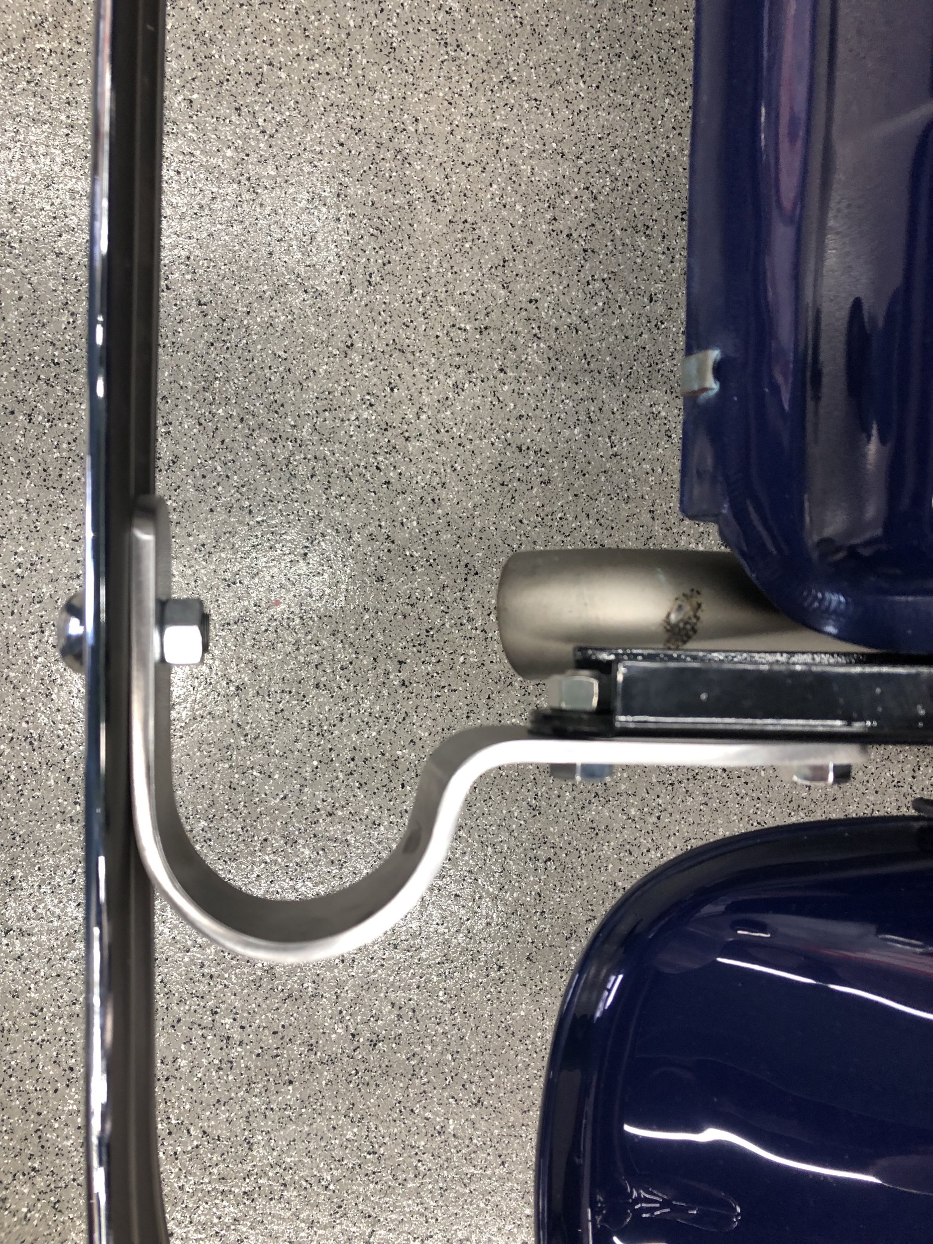

    I ended up making some really short rear bumper brackets... 20241102_122236.jpg 20241102_133959.jpg 20241102_143602.jpg 20241102_143742.jpg
    I took some original rear brackets that had been poorly modified in the past and cut the ends off to make filler plates to finish off the frame horn covers. They will get sent off to the plater soon.
