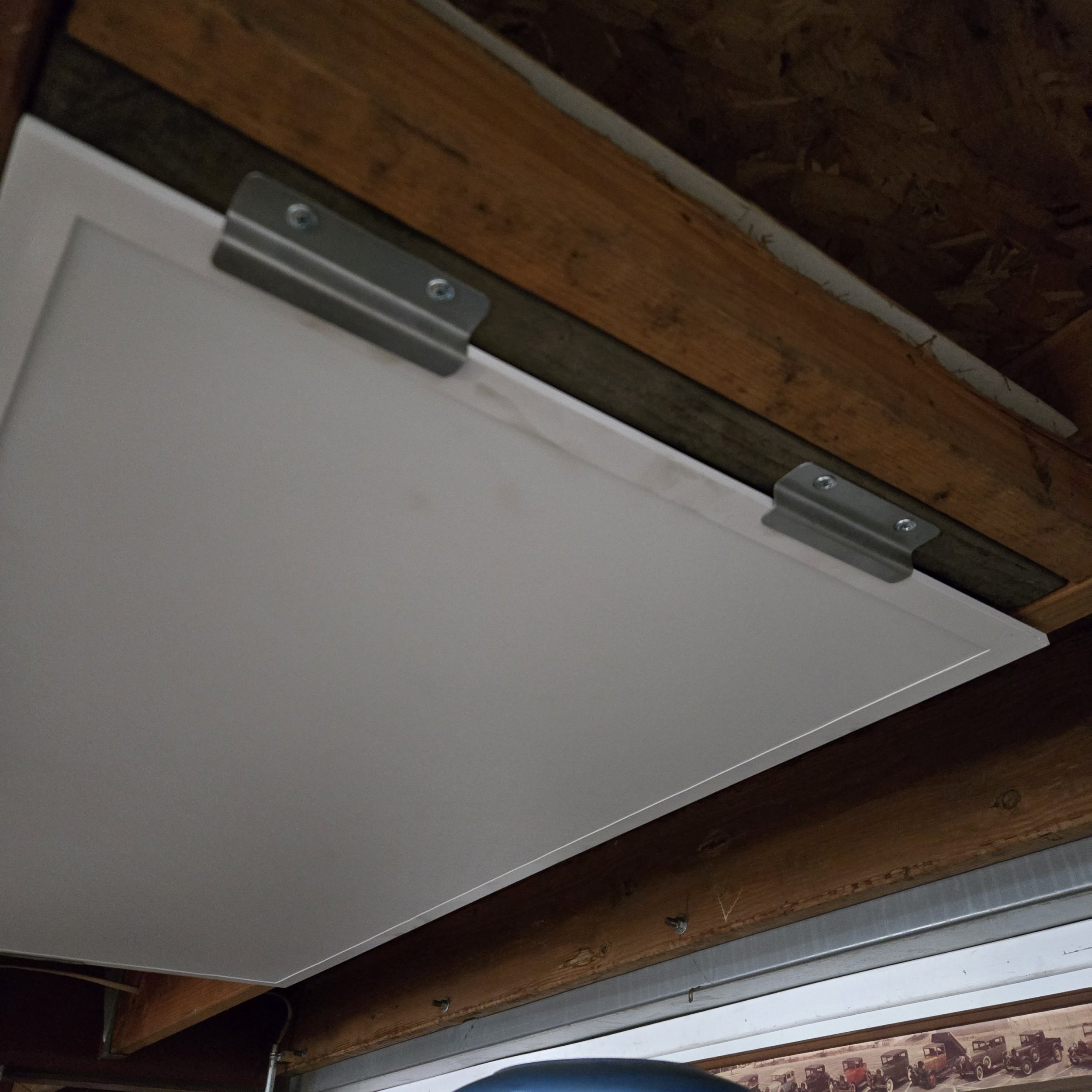

    I did some shop maintenance projects today. One was my continued effort to replace the flourensent lights with LED fixtures. I installed some more 2' x 4' panels in my machine shop area. These panels are designed to drop into T-bar ceiling, so I made up some sheet metal brackets to hang them between the joists.
    With a shear, brake and punch they were pretty quick to make. 20250101_151504.jpg 20250101_151520.jpg
    It is lit up pretty well now, which really helps with my 57 year old eyes.

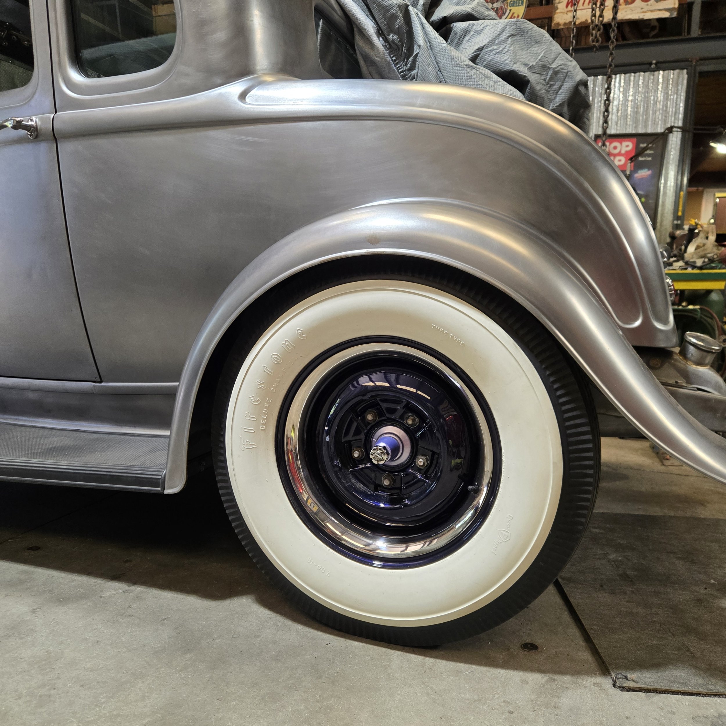

    I wasn't happy with the stance the car had when I took it to Oklahoma.
    I added a leaf front and rear and went from 5.00/5.25-16's to 5.50-16's up front. I like the rear showing some blackwall. The front stance is still up in the air until I get the engine back in.

    Lights look fantastic, I like the rear being raised up a bit as well.

    atch
    Yep; rear looks 100% better. Kudos.

  26. Tons better! Such a great car

    Lights are excellent. They will definitely make working in there much easier. The car is looking good, keep up the good work and keep us posted.

    Nice rear tire to fender gap now, I wondered if the tires were contacting the fenders before.
