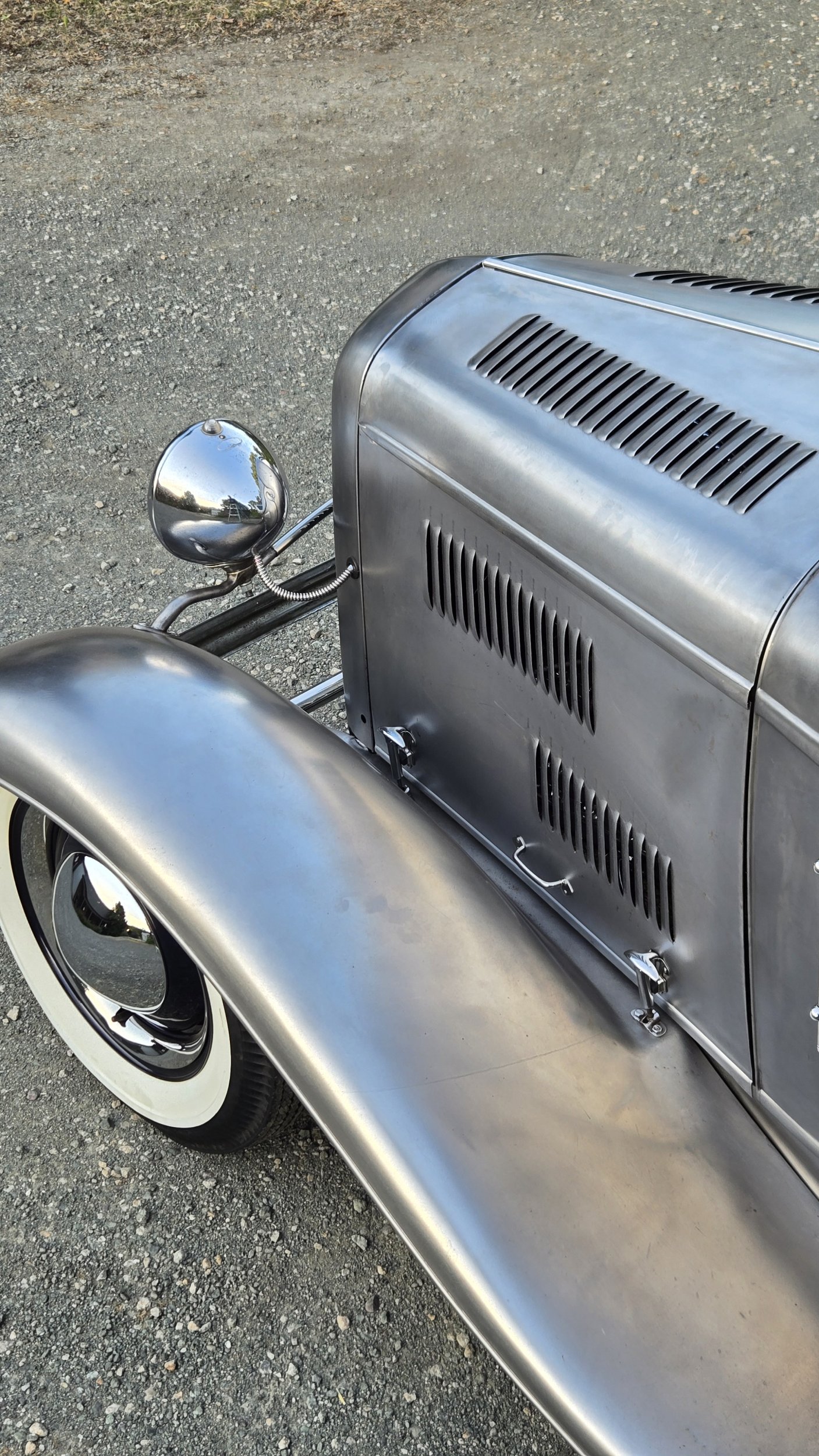

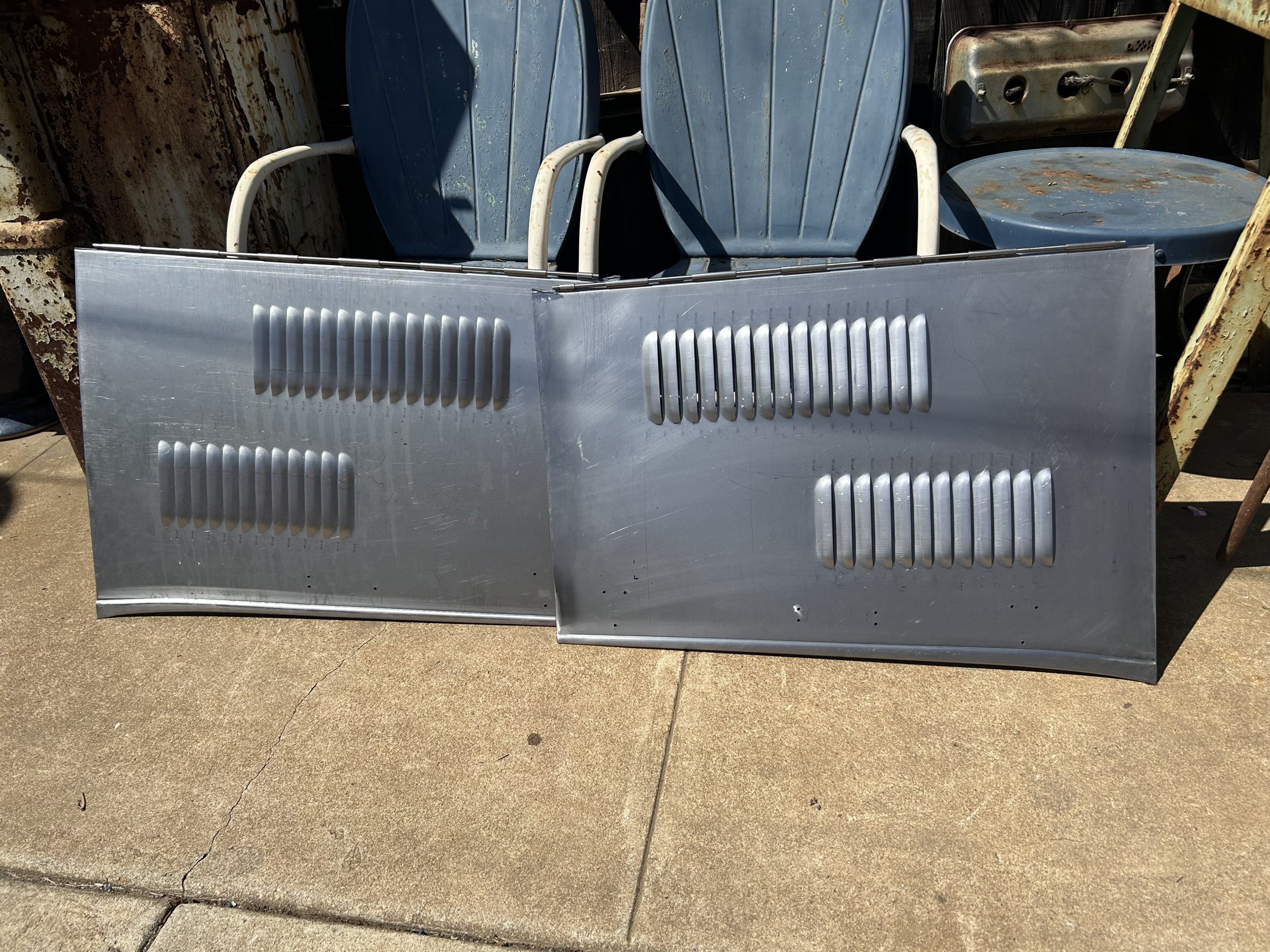

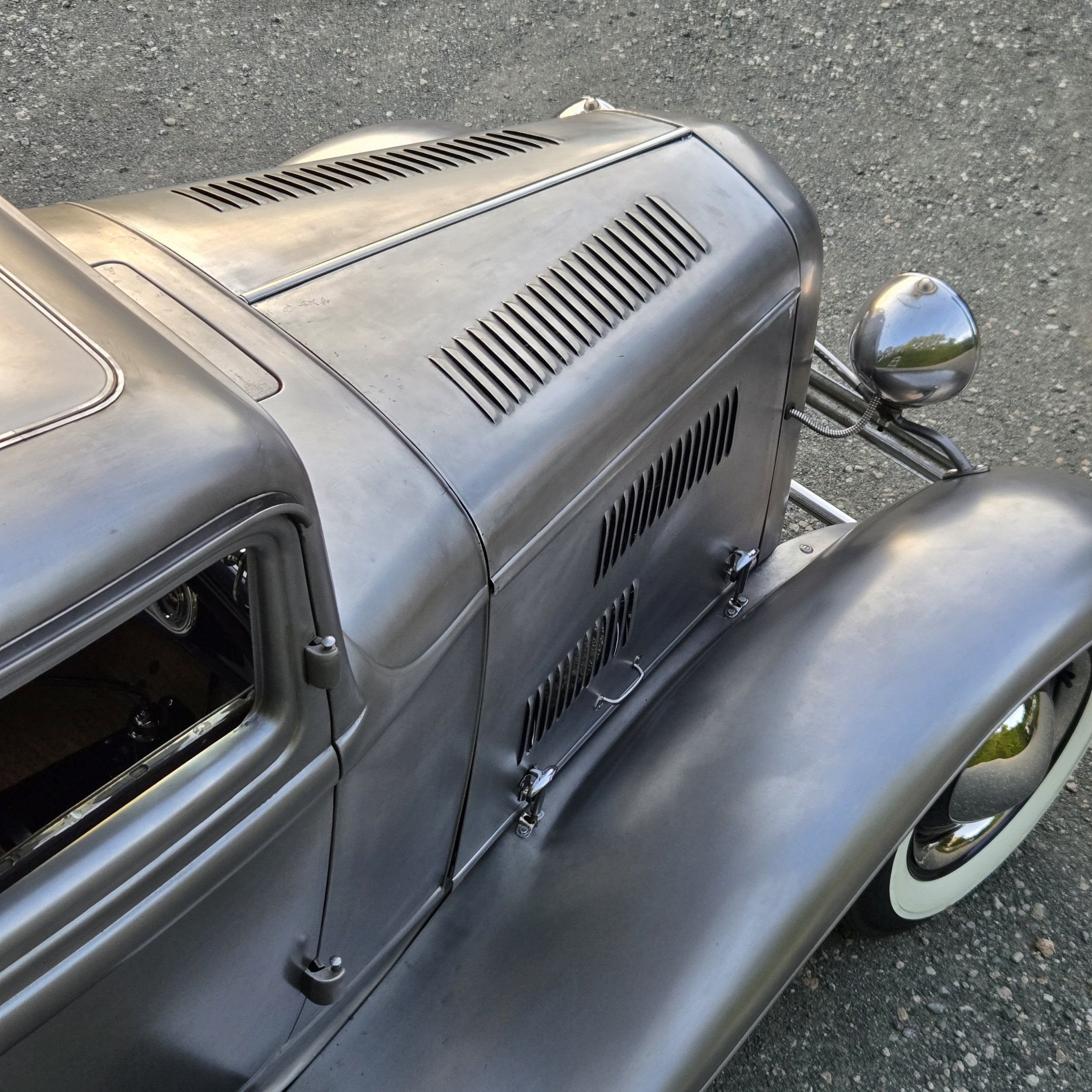

    The hood.
    Josh Carrillo @carrillocustoms made up some 19 gauge blank hood sides.
    IMG_20250504_083251(1).jpg IMG_20250504_083940(1).jpg 20250427_103655.jpg 20250427_161153.jpg 20250427_161923.jpg 20250427_161827.jpg

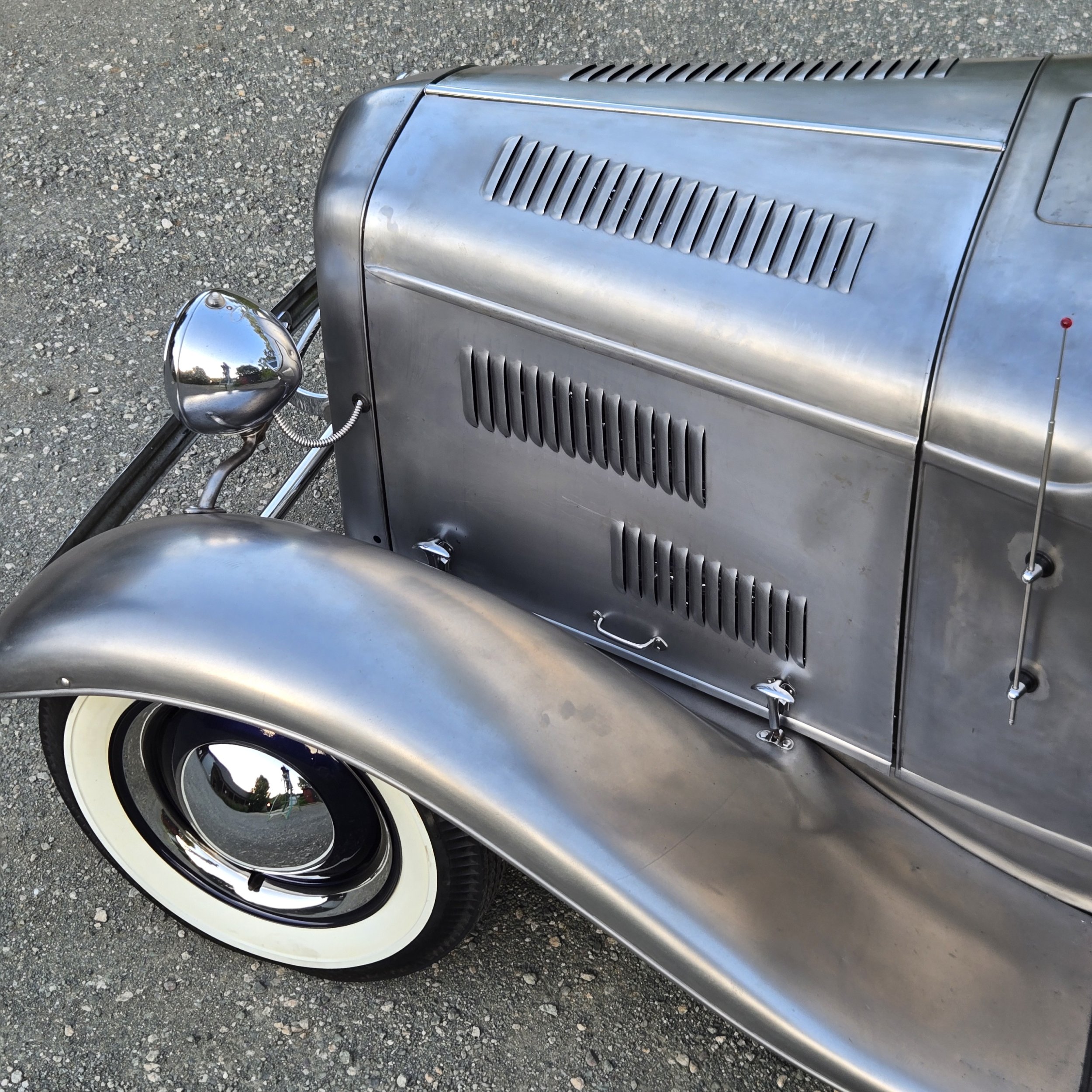

    The louvers.
    I've been kinda obsessed with early style 4 and 5 inch louvers for quite some time. I was on the hunt for them 15-20 years ago when I was building my RPU. There are modern 5" dies, but not the shape and spacing of these. Most had only 1/8"-3/16" spacing between louvers. I describe the look as louver, louver, louver. Not louver, space, louver.
    Screenshot_20250501_142129_Instagram.jpg zorro.jpg CABRIOLET (418).jpg COVER OF HOT ROD (2).jpg DeuceSedan louvers and antenna(1).jpg 31 Roadster 5 inch louvers.png

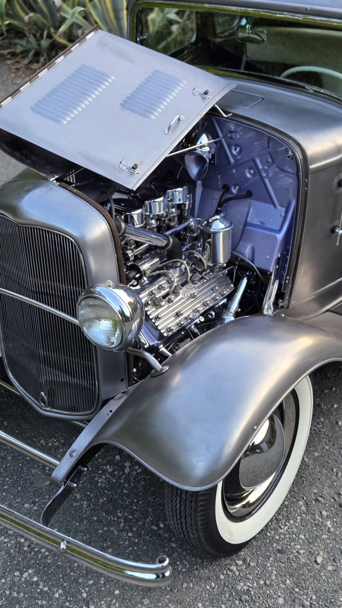

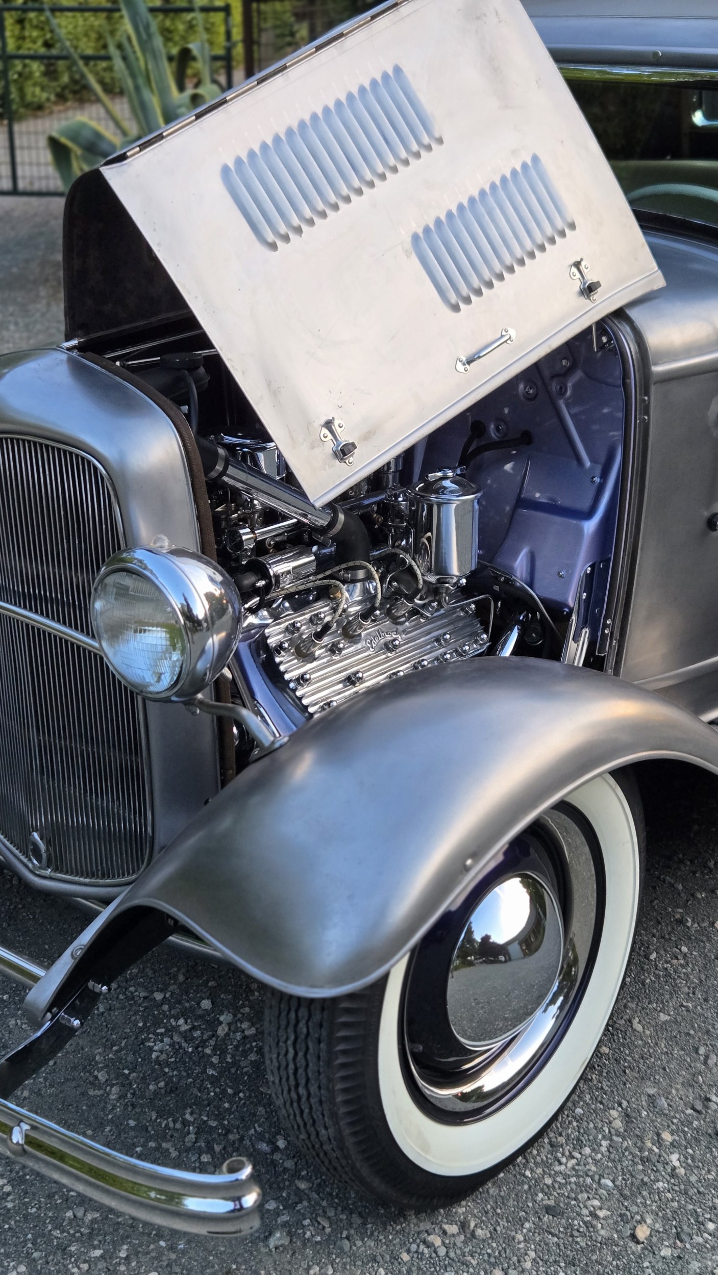

    The purple hood.

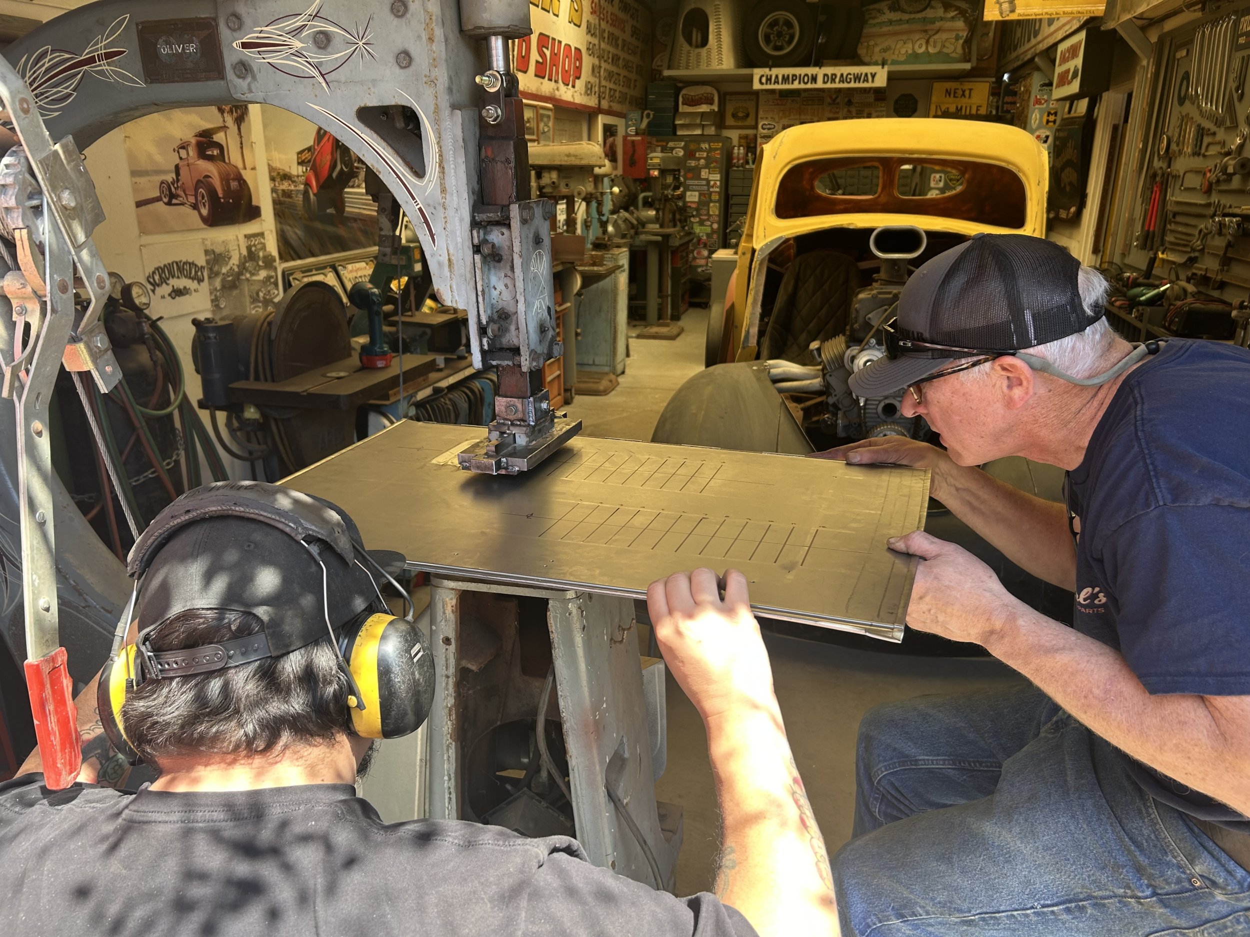

    I found these purple hood tops at the Turlock swapmeet 15 years ago. I decided this car needed matching louvers on the hood sides, similar to some of the examples above. With no luck on finding the correct dies, I had my friend Joe Ny digitally scan the louvers on the hood tops and then have pieces laser cut to make dies. After much trial and error, we were able to punch some test panels. Then I approached Kewi Kev to see if he'd be willing to help out with the use of his famous louver press. We built adapters to mount my dies and Josh and I headed down to Ventura for the day. Between Kevin, Josh and I, we made it happen and got the hood sides done
    20221121_094126.jpg IMG_20250504_085811.jpg IMG_6572 (1).jpg e1125c69-9fff-4633-bc6c-61717dd064bd.jpg 20250322_174150.jpg IMG_20250504_083608(1).jpg IMG_20250504_083622(1).jpg IMG_20250504_083631(1).jpg IMG_20250504_083637(1).jpg

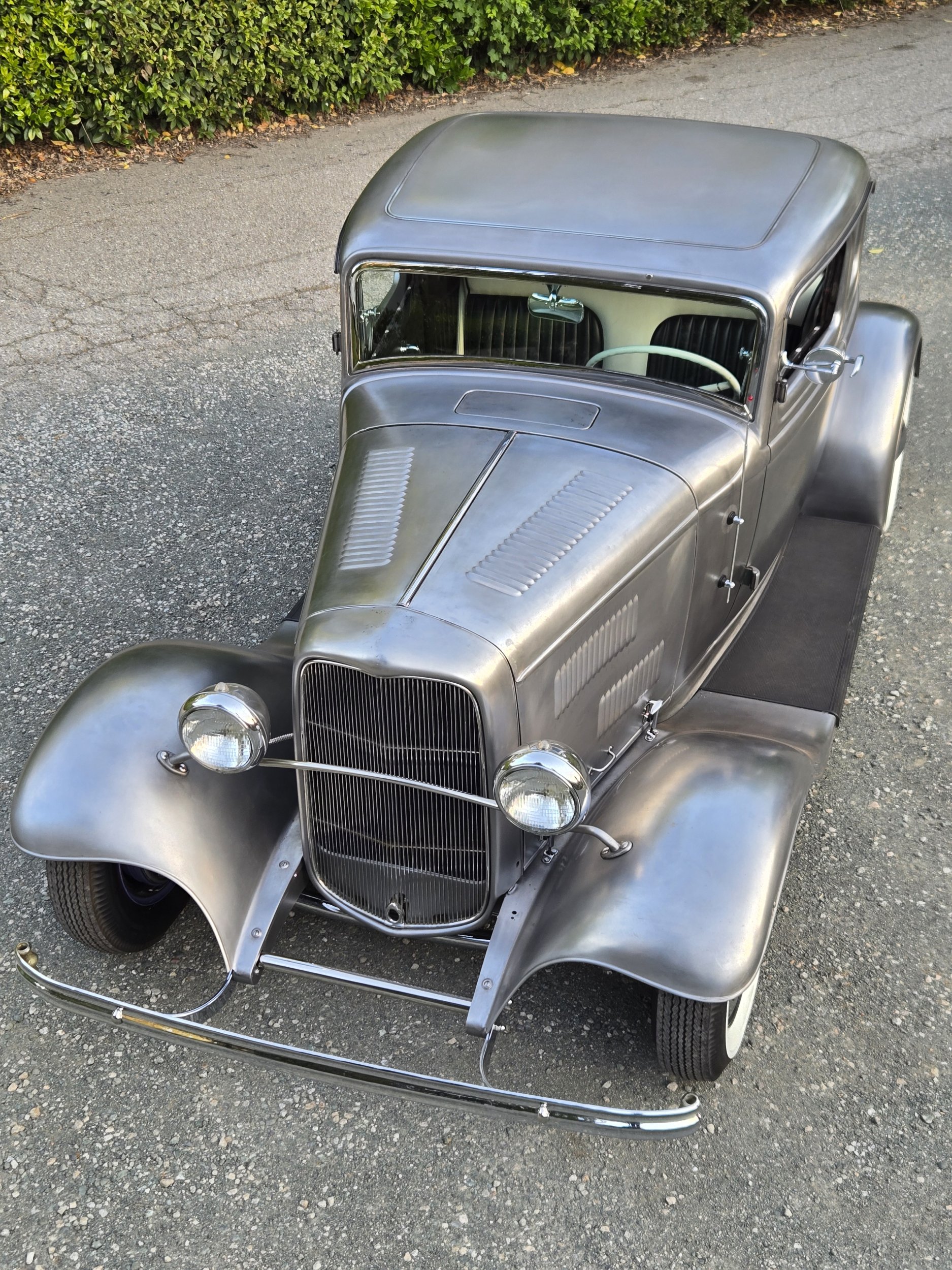

    The result

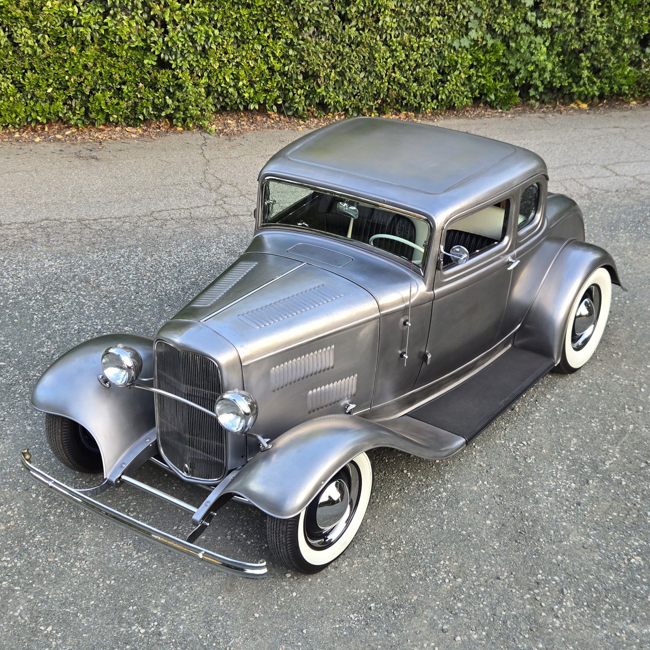

    I'm sure some don't get it, but it's the quirky 50's look I was after. I think the hood really brings it all together.
    The chop. The rear fenders. The hood.
    20250502_194446.jpg 20250502_194425.jpg 20250502_192017.jpg 20250502_191917.jpg 20250502_191812.jpg 20250502_191528.jpg 20250502_191645.jpg
    Your thoughts?

    Neal...im obsessed with old louvers too..and how they were laid out. I luckily later scored a louvered hood from the guy who I got my '38 Chevy from...it was intended for my car. They just don't lay them out like they used too..and normally use way too many louvers for my taste. The way your side louvers line up with your hood top louvers is magic. Awesome as always.

    The hood looks great! I'd really like to see how the hinge is rolled in to match the original top pieces.

    Beautiful hood! I like the at***ude of can’t find something, just make it!

    The story on the hood as well as making it with buddies is the best... and it looks rad, too.

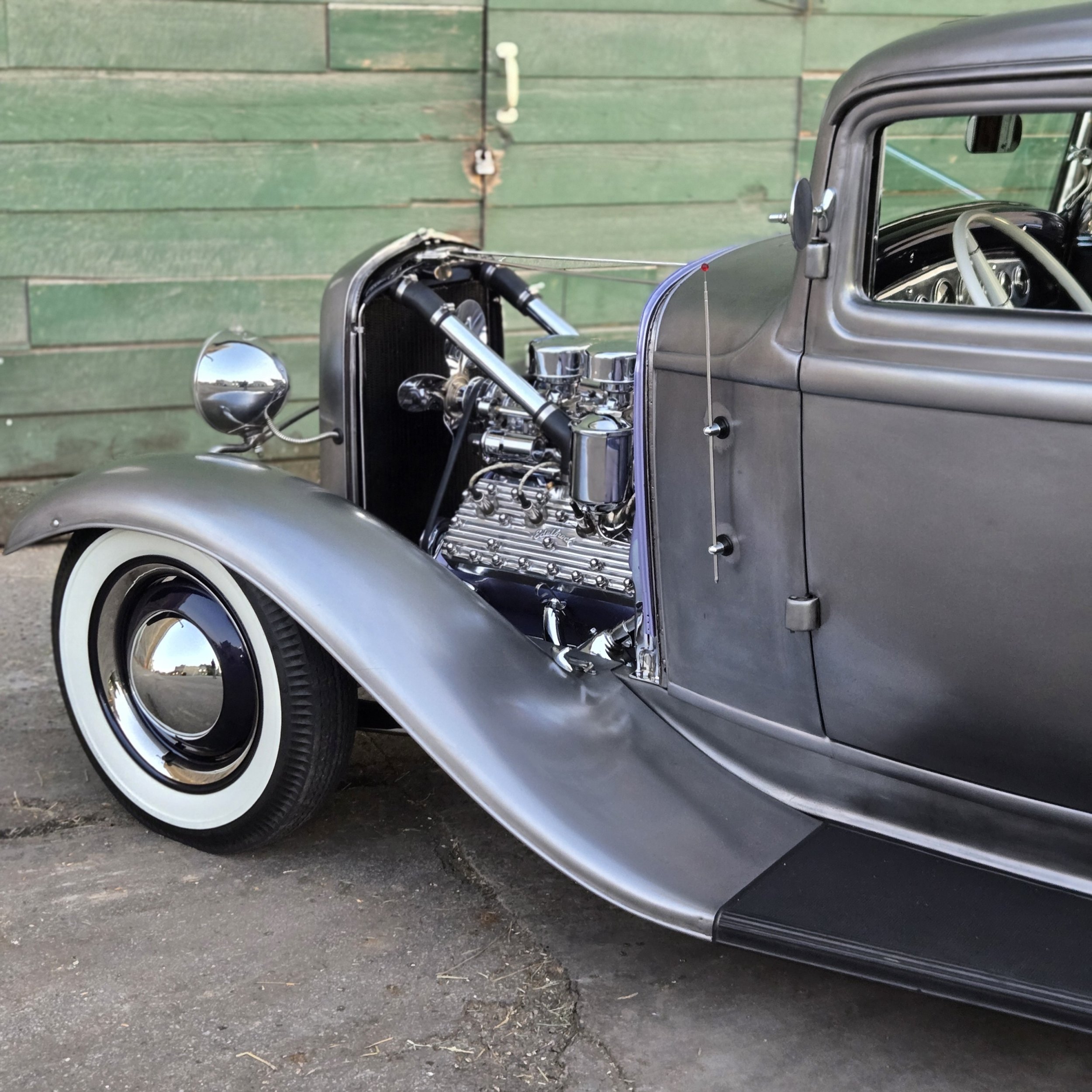

    19Eddy30
    from VA
    The RollPan under frame is interesting,
    I wonder just Cosmetic, for exhaust header , To look cleaner ?
    If so wonder why builder did not continue to the rear tire.

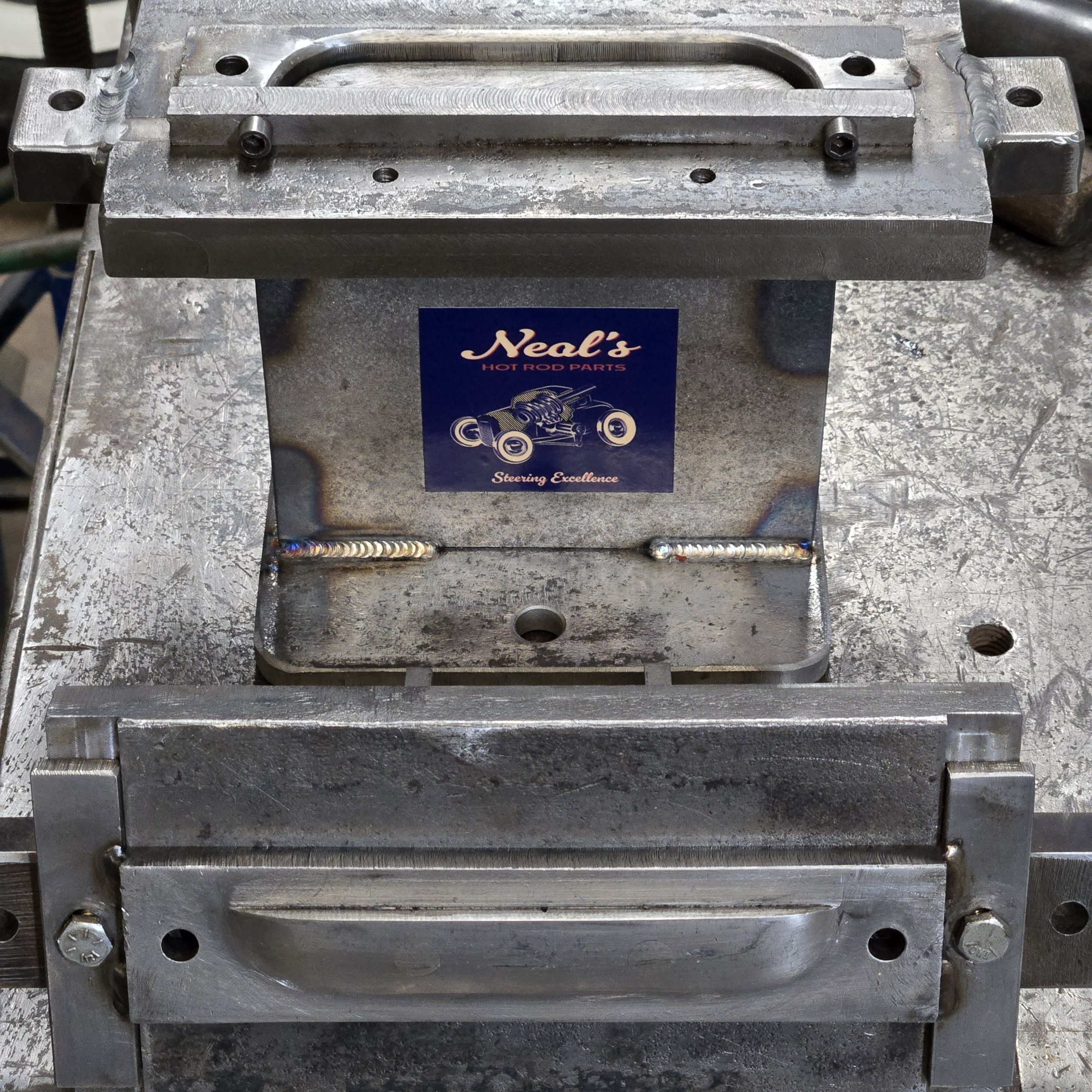

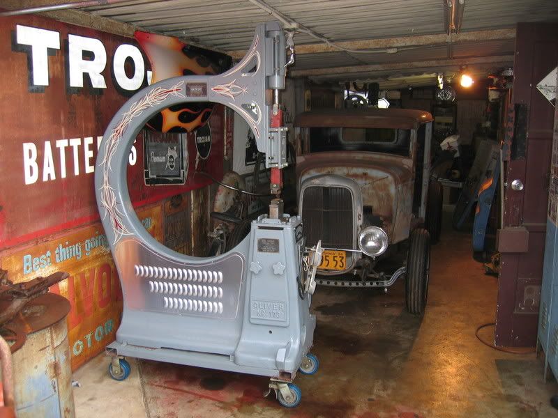

    Josh made up dies for his Pullmax for the upper and lower details. He even made dies to stamp the inverted Y-shape behind the latch catches.
    IMG_20250504_112955(1).jpg IMG_20250504_113009(1).jpg IMG_20250504_113004(1).jpg IMG_20250504_112915(1).jpg
  19. Looks perfect on the car Neal! It was a pretty stressful day, my press was maxed out, straining to cut those 5” louvers. It took a couple of hours setting it up so the dies would stay in adjustment. I had to add a back brace with a length of tubing and a couple of come alongs to help with the extra flex. It was very nerve racking when Neal started punching the side panels, we sharpened the dies several times during the process. No one could relax until the last louver was punched. It is very rewarding seeing the end result! It was fun spending time with you and Josh, 2 very smart, cool and talented guys! Welcome back any time.

    The hood is perfect!
    That’s an amazing amount of talent in one place, at one time. Excellent work.

    Absolutely nailed it. That hood all together 100% looks off the cover of a little book. Well worth the effort!

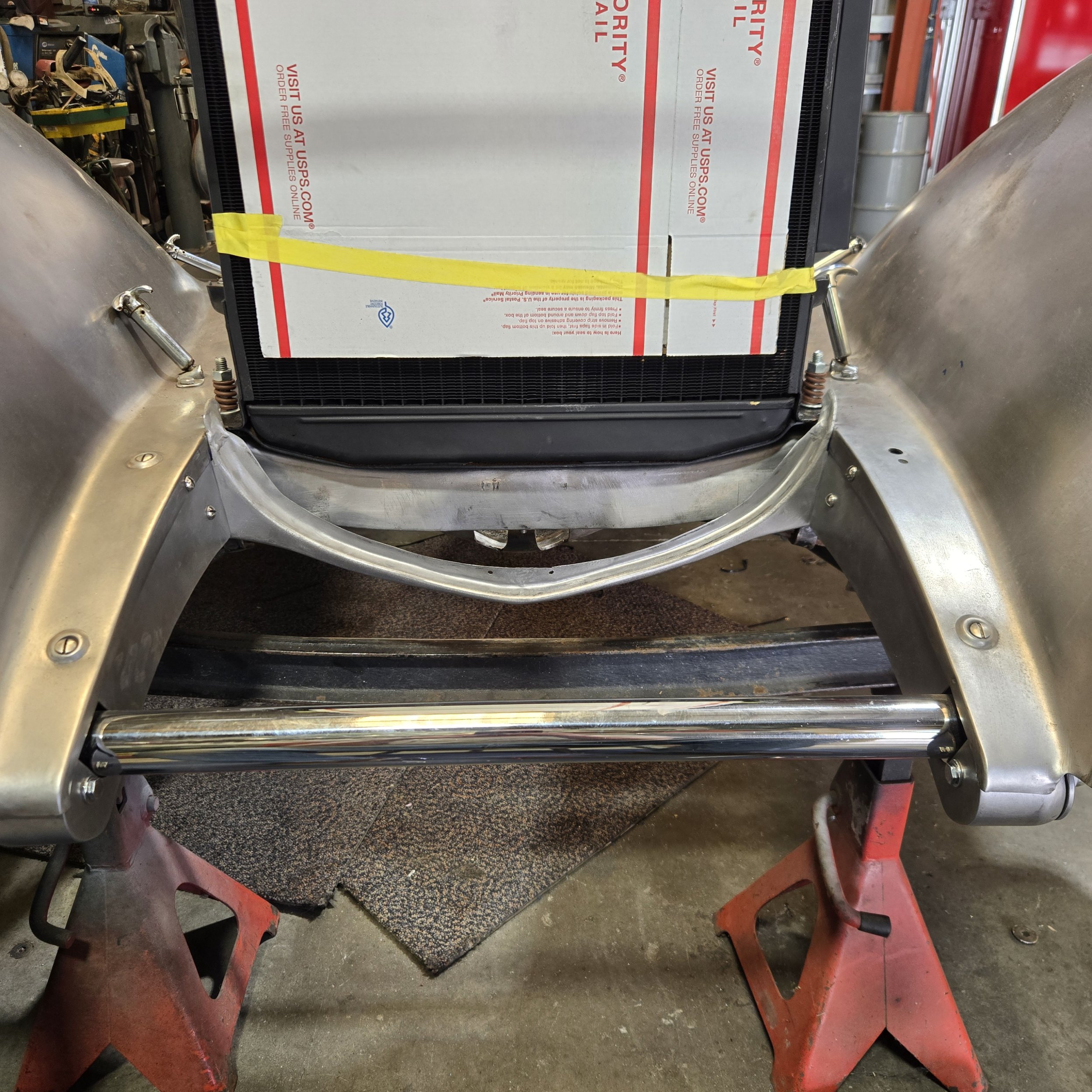

    I had one last project to finish up before paint. Since I'm not running a stock front valence panel, I needed to finish up my version. I had made up panels to cover the insides of the frame rails, but never addressed the small triangles at each side of the grille shell. You could see the crossmember and spring, as shown below
    I had an original valence from an old showcar that had been modified. The thing I liked about it was that they added some little ears on each side that go up under the corners of the shell, filling in the corners where you could still see the crossmember.
    I didn't use much of it, but it was easier to cut one up than start from scratch
    20250504_115944.jpg 20250504_124519.jpg 20250504_154834.jpg 20250504_155706.jpg 20250504_155733.jpg
    A lot of work to cover up two tiny triangles, but I'm happy with the results. The frame cover pieces will be chrome, the valence piece will be painted body color.

    I get the spacing, while it is a thinking man's layout though. The first Louver lines up with the front of the Louvers on the Hood. Then you play the start of the second Louver while taking into account the swoop of the Fender. This line both sets up the end for the top row and start of the bottom. Keeping both in line with the hood dimensions front and back and playing the fender swoop into it all. Then ending the lower row in line with hoods last Louver at the row closest to the firewall. - This is the Engineering Major version I am quite certain :)
    Or in short, just laid them out so it looks *****in' !
    Quirky - I think not.
    However you slice it, BUENO

    Impeccable craftsmanship on the hood. Thank you for the insight into the process. I love that this isn't a traditionally inspired car—it's a traditional one.

  30. It's been said before in this thread, but the attention to detail in this build raises the bar for all traditional builds going forward. Truly an 'all time' 32.
