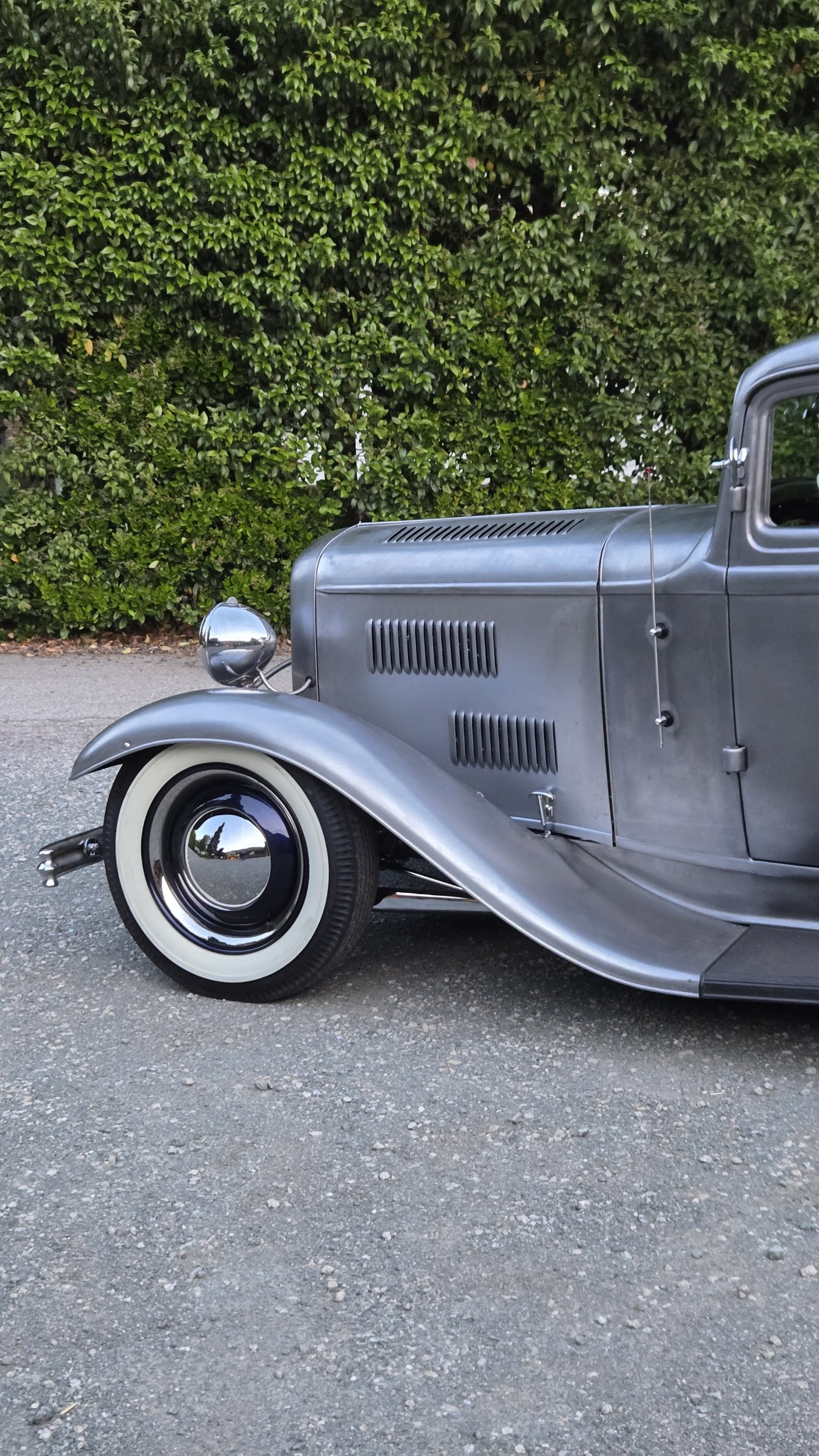

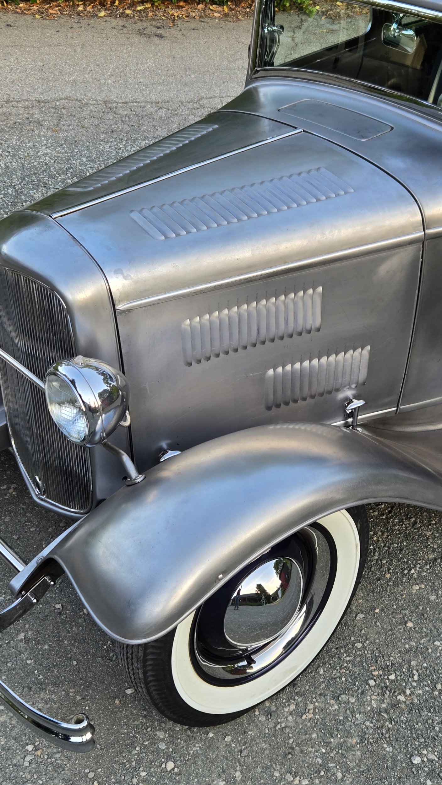

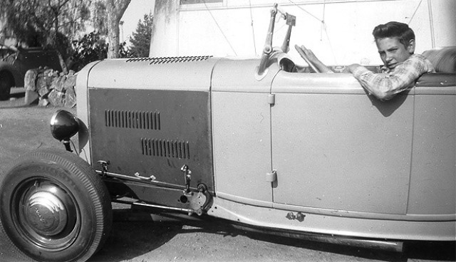

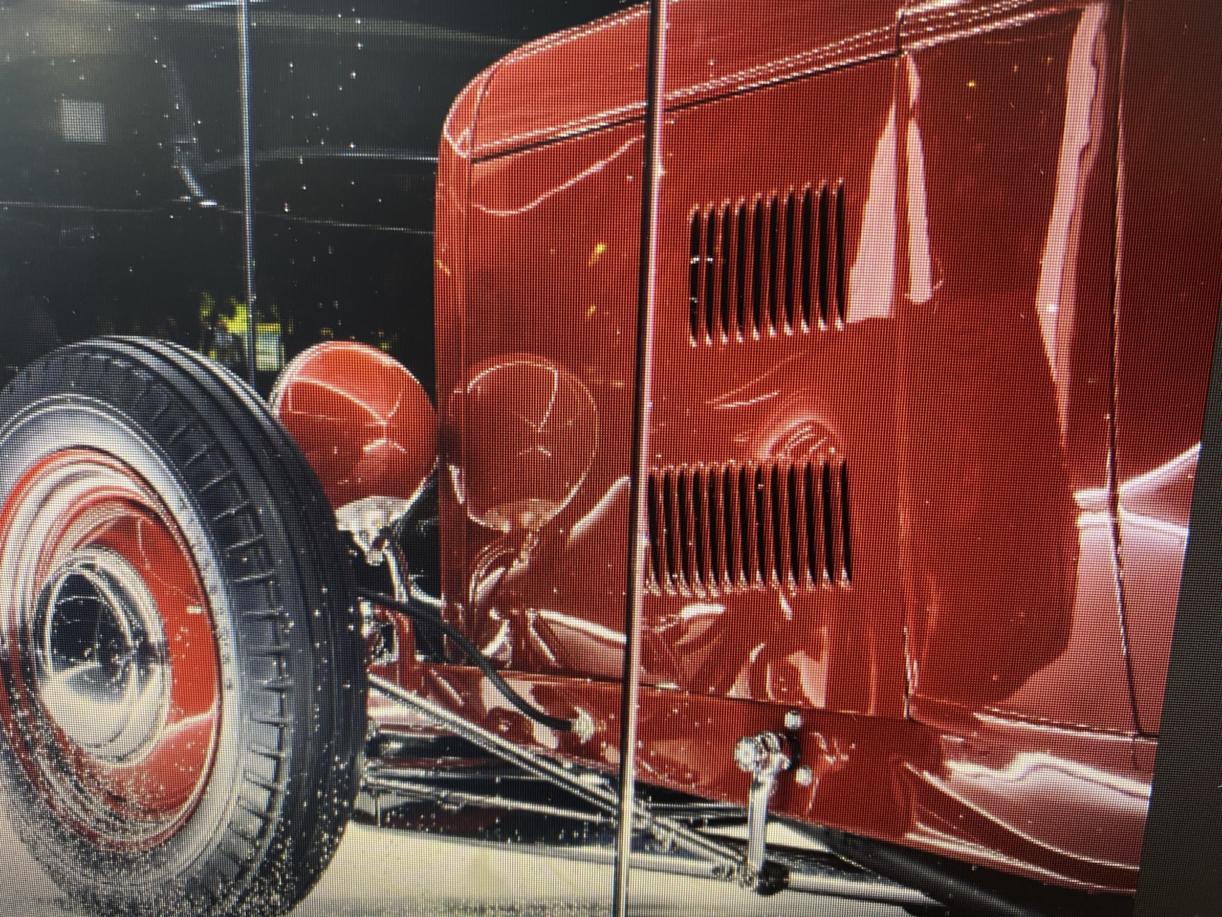

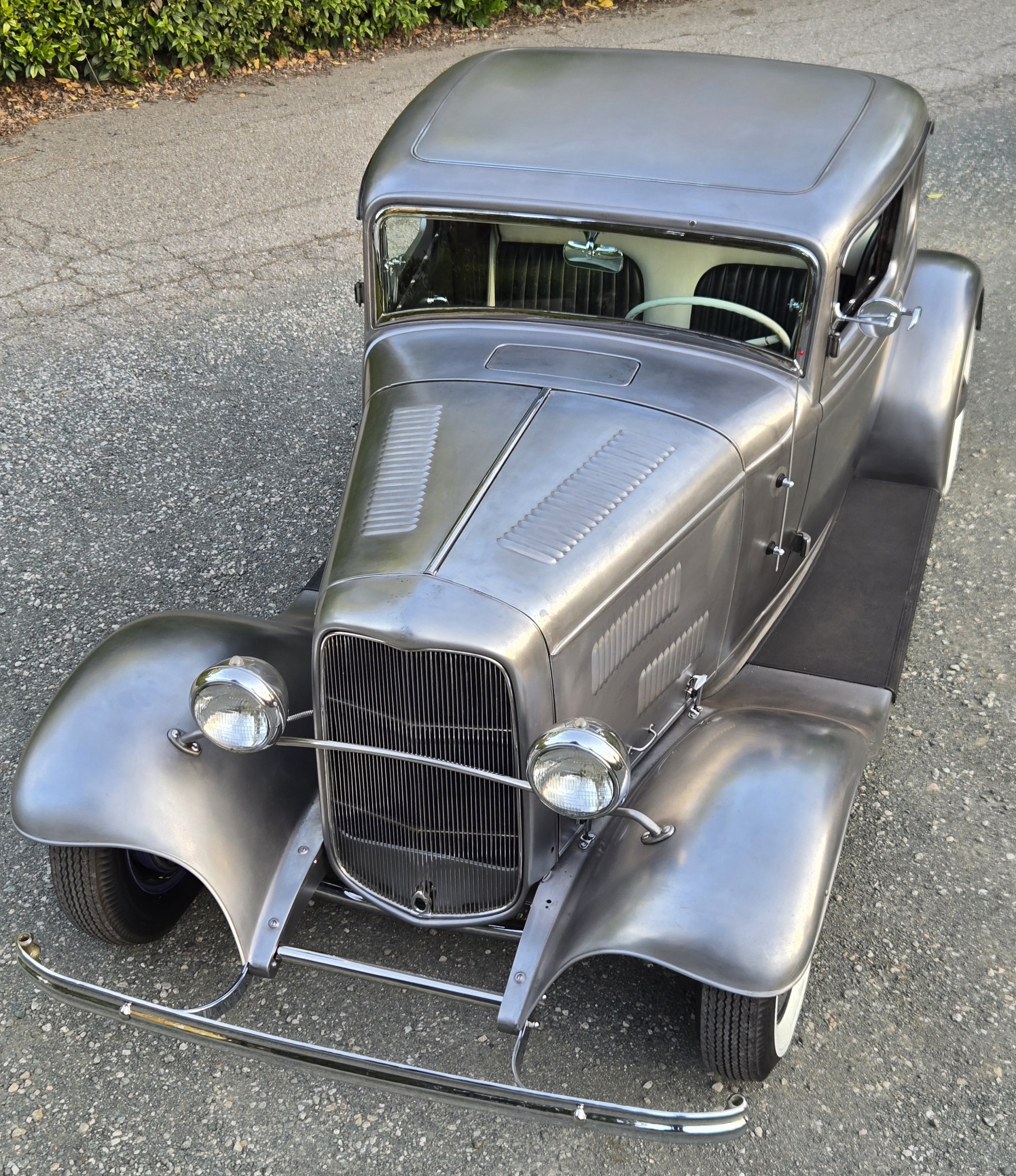

    You pretty much nailed that one. Yes, there was a lot of thinking and over thinking involved. I had the general layout planned all along, playing off of the vintage photos posted above, but the number of louvers and spacing took a few times to get what we ended up with.
    I had planned on 12 louvers in each row, but then saw this pic of Ed "Axle" Stewart's roadster. I really liked the longer row on top. The louvers are likely 4" and different spacing, but this was ultimately the inspiration for the what I ended up laying out.
    16 upper row, 13 lower row...
    15 upper row, 12 lower row...
    While still starting and stopping the two rows in alignment with the existing louvers in the hood tops.

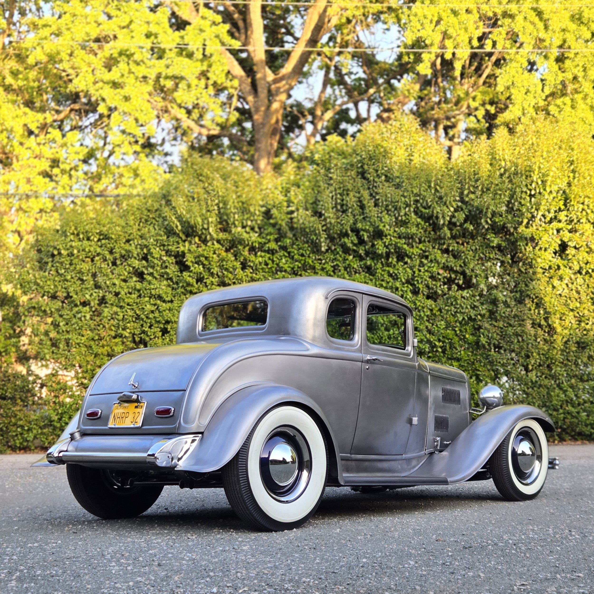

  6. NealinCA
    Joined: Dec 12, 2001
    Posts: 3,513
    NealinCA

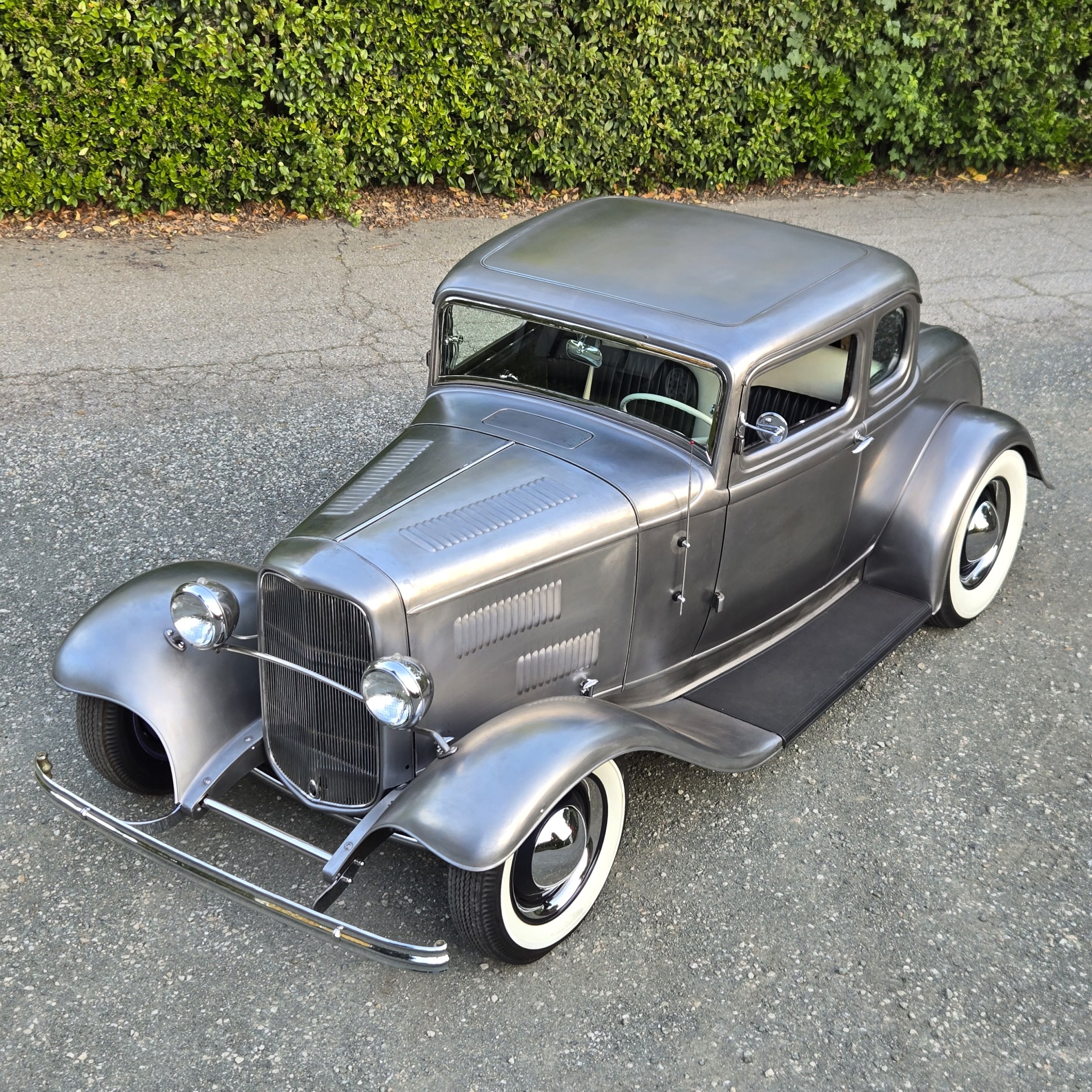

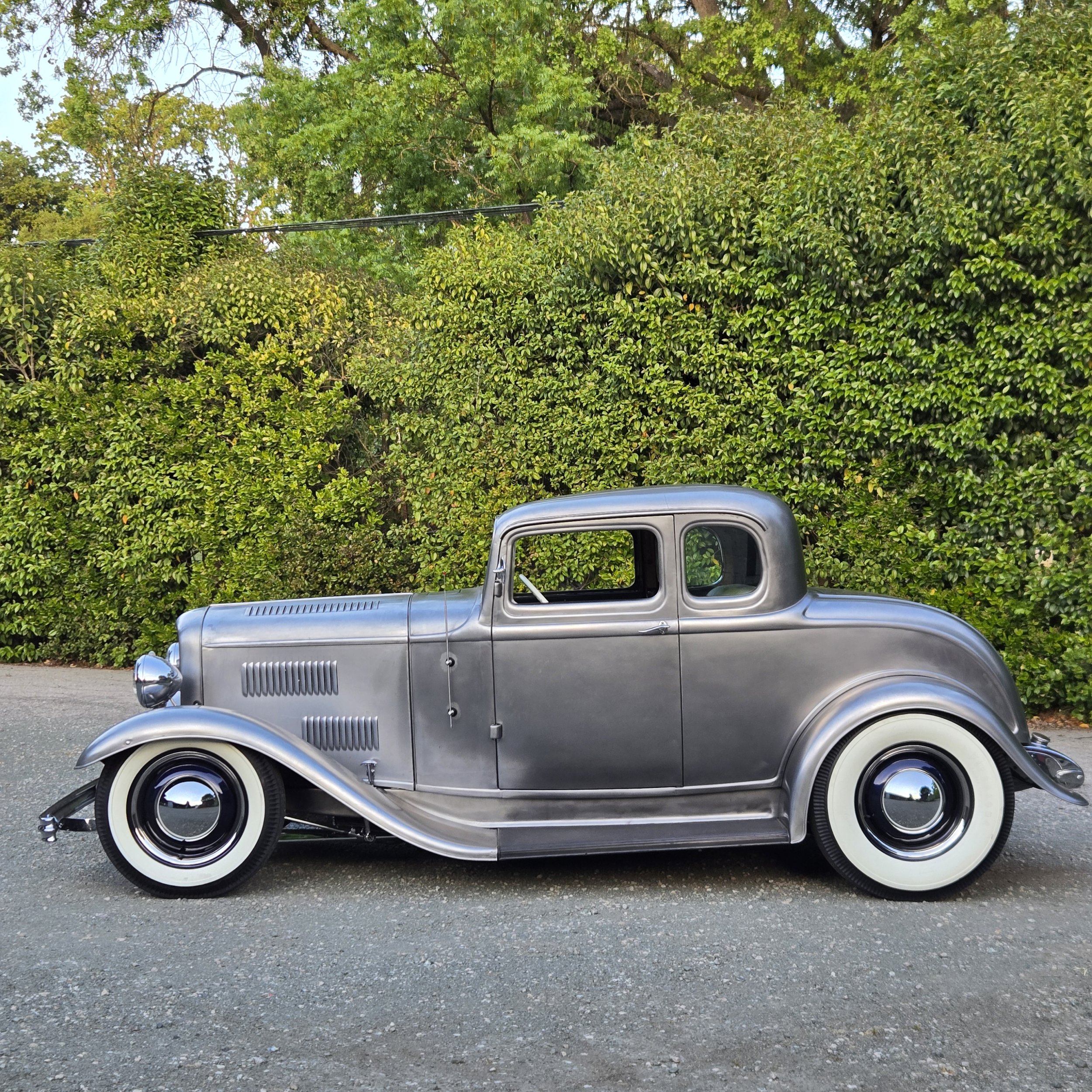

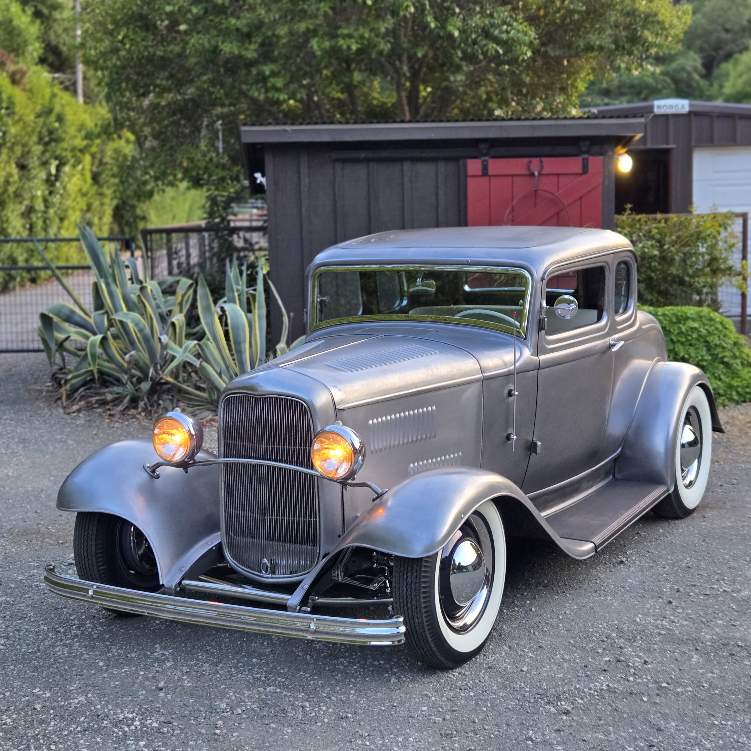

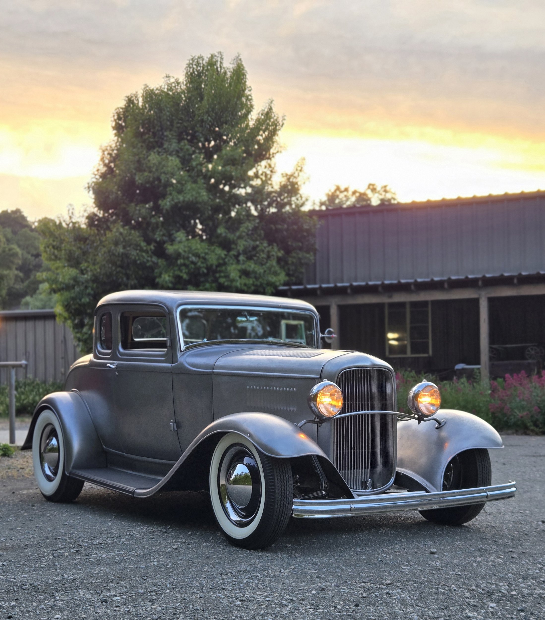

    Since last Friday night was the last time this car was going to be together in bare metal, I took way too many pics. Here are a few more. The Milner shot was me living out childhood dreams I guess...haha.
    The last pic from up high is still my favorite.

  15. That last photo is the cover shot, but I think that front quarter shot with the sunset in the background is the best of the bunch. Excited to see it in paint... hard to imagine this car becoming even better!

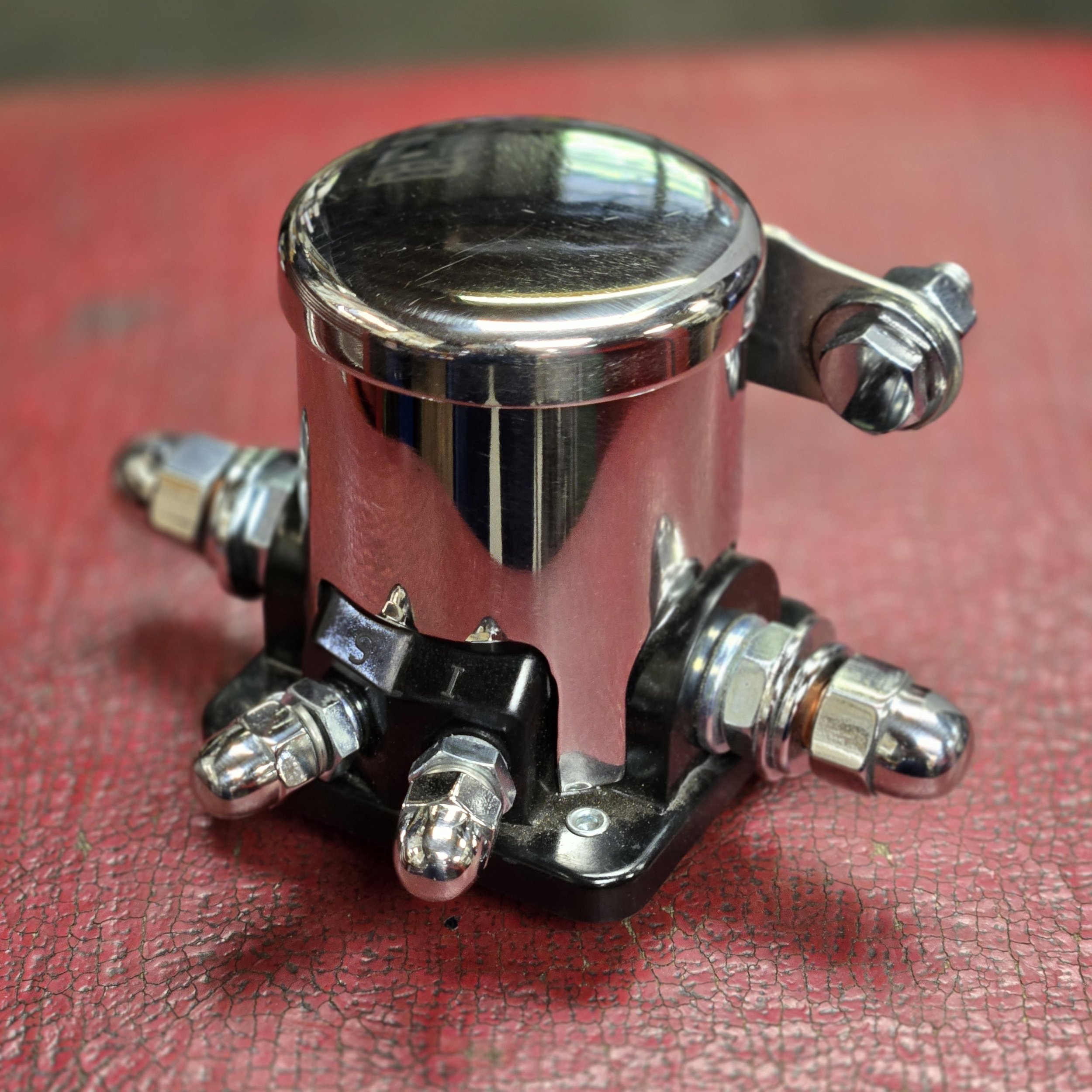

  18. NealinCA
    Posts: 3,513
    NealinCA
    The bedazzled solenoid.
    I didn't like the look of the Ford style starter solenoid, so was trying to figure out how to make it look better.
    I happened to find that 1-3/4" exhaust tube would just slip over, with some cutting and notching. I had some stainless tube leftover from the exhaust on the car, then I figured out an 1-7/8" freeze plug would slip over that, so I picked up a couple of those in stainless.
    Did some t******* and polishing
    And now the solenoid will have a little more bling

  20. Dubonet Garage
    Joined: Jun 10, 2022
    Posts: 200
    Dubonet Garage
    from France
    Super cool!
    How do you fix it?
    Stogy, 31chevymike, NealinCA and 2 others like this.
  21. 60 Special
    Joined: Sep 8, 2007
    Posts: 302
    60 Special
    from Omaha Ne.
    A very clever solution to a most usually accepted "eyesore" to the m***es! It reminds me of something that might have come from a J. C. Whitney catalog, but a much higher quality. For most guys it's a struggle just to get a car put together and running, but you sir come come along and seem to do it with that added style! Neal, you are the "king" of frost plug reuse ingenuity! It looks like a future product from the "Neal Jennings Garage"! 60 Special
  22. Tim
    Joined: Mar 2, 2001
    Posts: 20,445
    Tim
    from KCMO
    Very clever, I’m curious if there is risk of arcing between pole through the cover?

  24. NealinCA
    Posts: 3,513
    NealinCA
    I would think less chance than one of these full metal housing solenoids.
    That's on the list for today!
  25. Tim
    Joined: Mar 2, 2001
    Posts: 20,445
    Tim
    from KCMO
    I’m gonna be honest my mind completely blurred that the poles are completely outside of the cover and not inside lol what a brain fart
    Stogy, 31chevymike and porkshop like this.
  26. Mart
    Posts: 5,007
    Mart
    Great looking mod to the solenoid. There's got to be a market for some copies of that. Mart.
    Stogy, 31chevymike, Outback and 2 others like this.

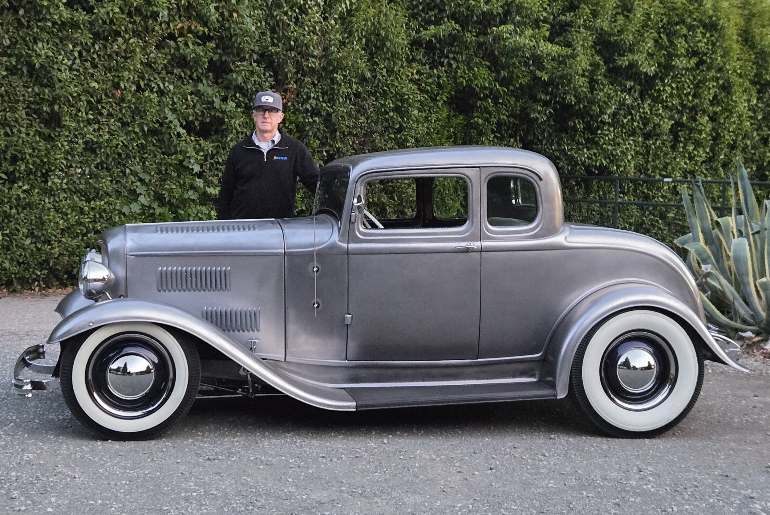

  28. 3w Hank
    Joined: Jan 29, 2022
    Posts: 1,018
    3w Hank
    Your coupe is Just amazing, hat off !
    On hood sides.

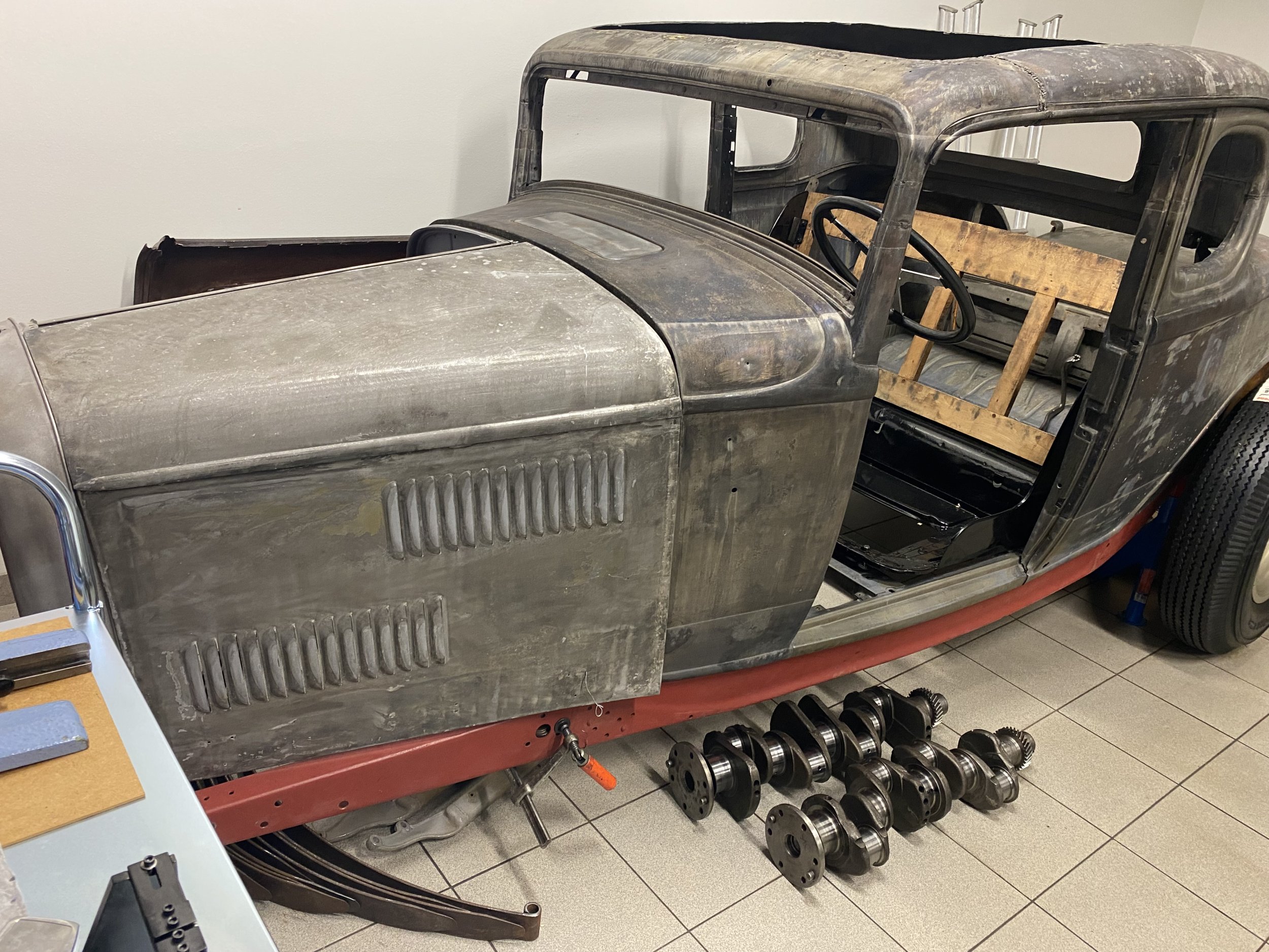

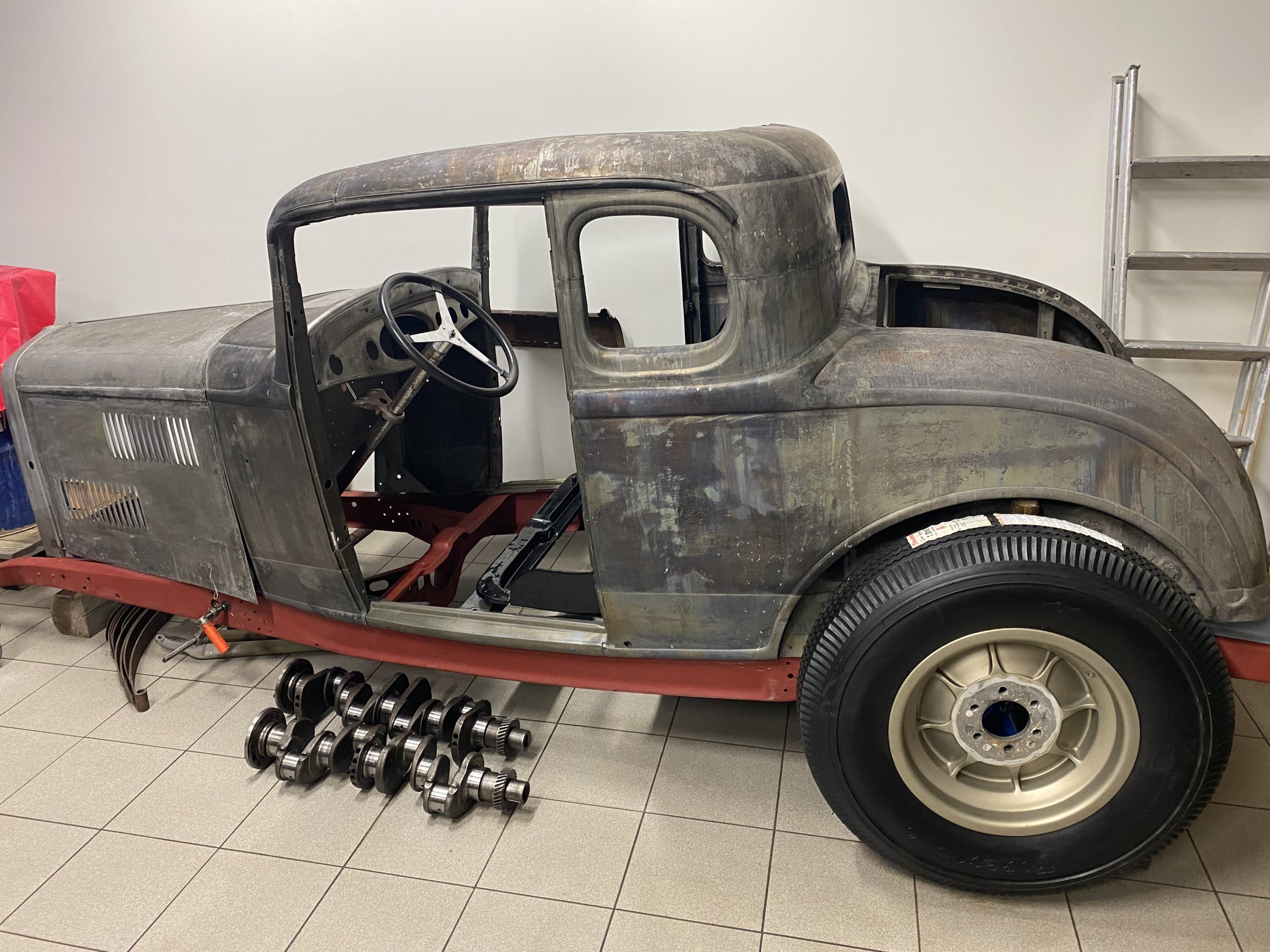

    My 5W coupe is all based out of LA speedparts and the late 40's pre dragracing ( street race ) style and I'm a fan of the McGee roadster, and when I was at LA last year on LARS I did try vis*** a 3W coupe that Kennedy brothers made to **** Wade In Culver City but I was never able to meet him, but I was in LA first hand to collect a Okie Adams axle, and he is one that can those axles.
    His hood sides was racy with louvers but before that I was into the 25 louvers but I wanted a more racy and LA style as I like short the nose on the horns.
    But at LARS I found allot of good stuff as a old time ported Merc 41 block and a complete hood from a old LA hotrod, seller was from Colorado and had it on his 5W but he wanted a 25 louvers. I asked Kennedys on the hood and they said this is old style LA. I did like it direct I saw it and I has bought a NOS set of the eraly 32 hood hatches to it.
    It took forever get the parts from Ca to me in Sweden.
    One thing I noted now as I just got back the hood from accid dipp today, it had not the lower profile made ( as on a std hood )
    I direct checked what McGee had and he used no profile ( my coupe is no fenders and a moderate 3" chop ) but it might look better with a profile but I guess I go straight as it came.
    Here is a very fast mock-up to see how it look, and the Okie axle and the Aburn dash I will use.

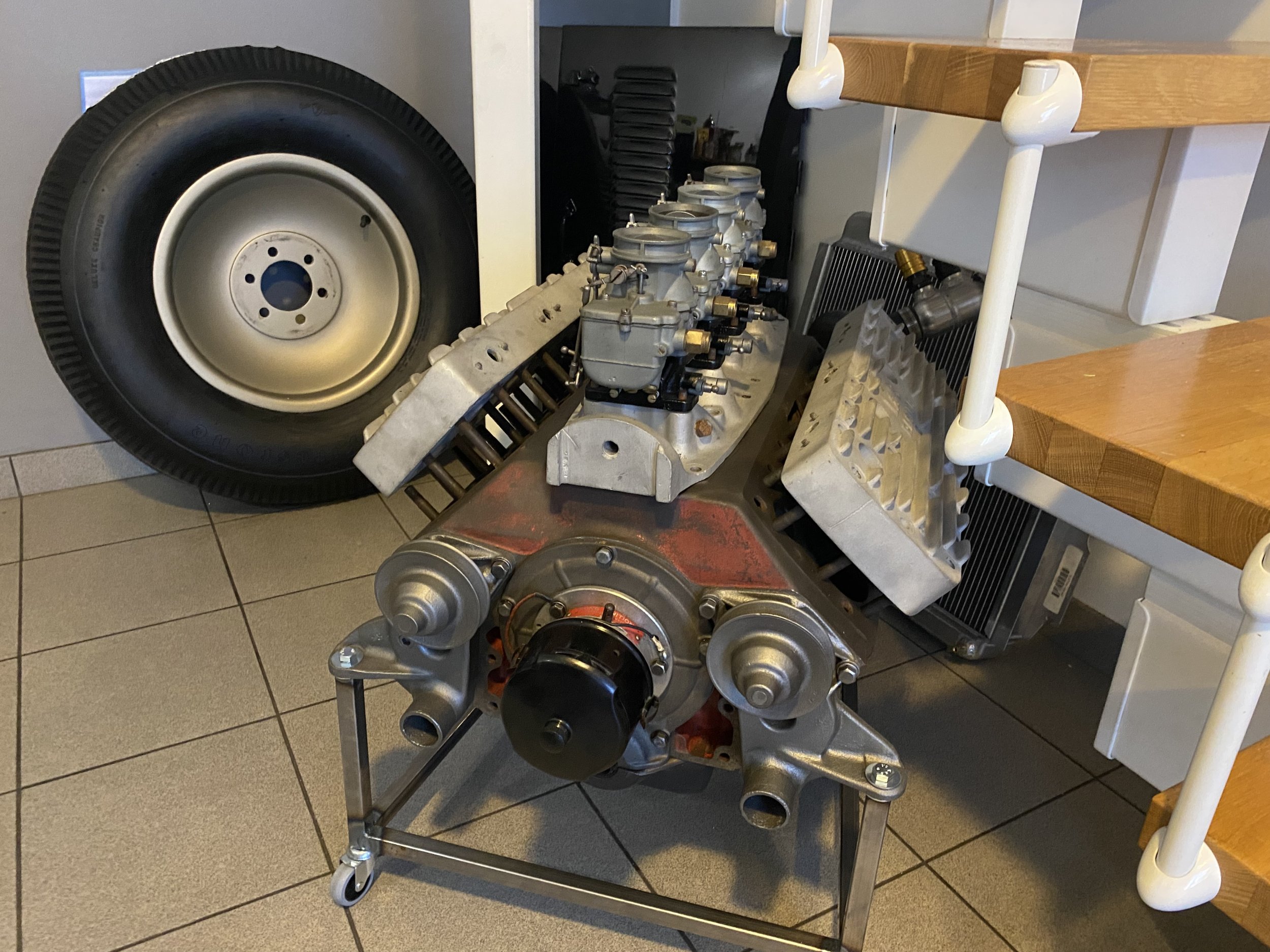

    I has a full restored Wing series in a Hollywood panel, Bell Auto 15.5" wheel, baby stroked 4" crank, 21A rods, L&S heads, Multi X4 intake and LZ carbs and this is Burbank made parts, Potvin 425 cam. Kong Jackson distributor, dual DSM coils, truck pan, 39 LZ transmission, 37 rearend, moved in 37 style rear bones, splitted 32 bones in front. 40 style 3.5” steel front wheels and Halibrand 6" at rear.
    A note, my hood ( top and sides ) is extended some but it its now 32” long and I wonder why they did that ?
    Neil. How would you go on the hood sides lower side, make a profile or use it as McGee did straight.

    Ok, I went to the local hardware store, but all they had in polished SS acorns were the pointy ones.
    I'm not a fan of that style, but I own a lathe and a polisher, so I fixed them.
    All better now
    Im going to talk to a local shop that just bought a tube cutting laser, maybe they can knock out a batch of these. We'll see.
