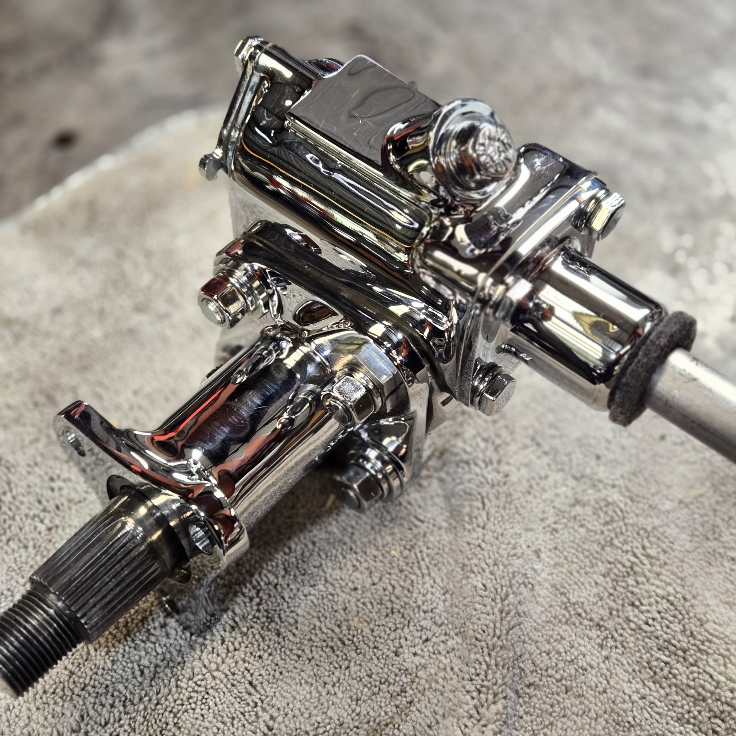

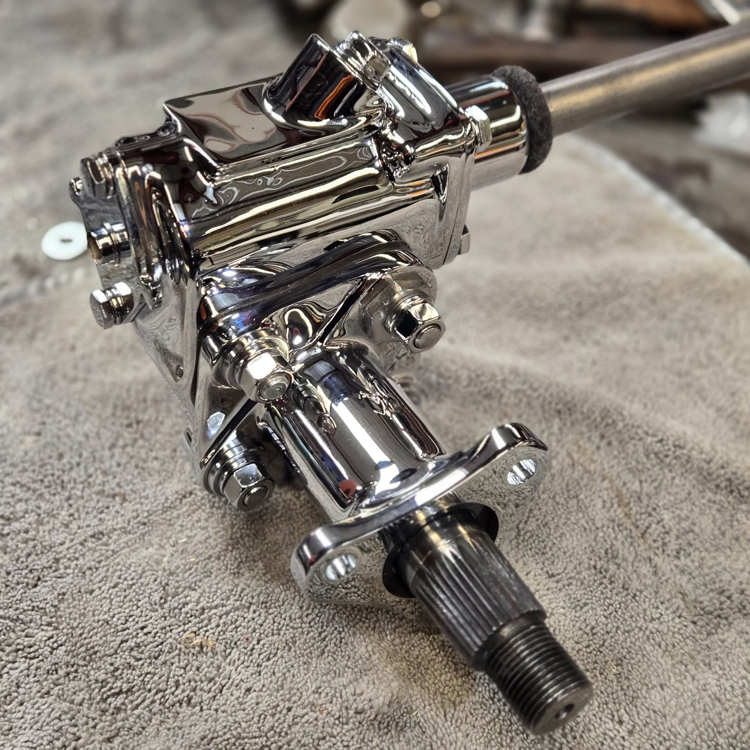

    Working on other projects while the 5w is away at paint camp.

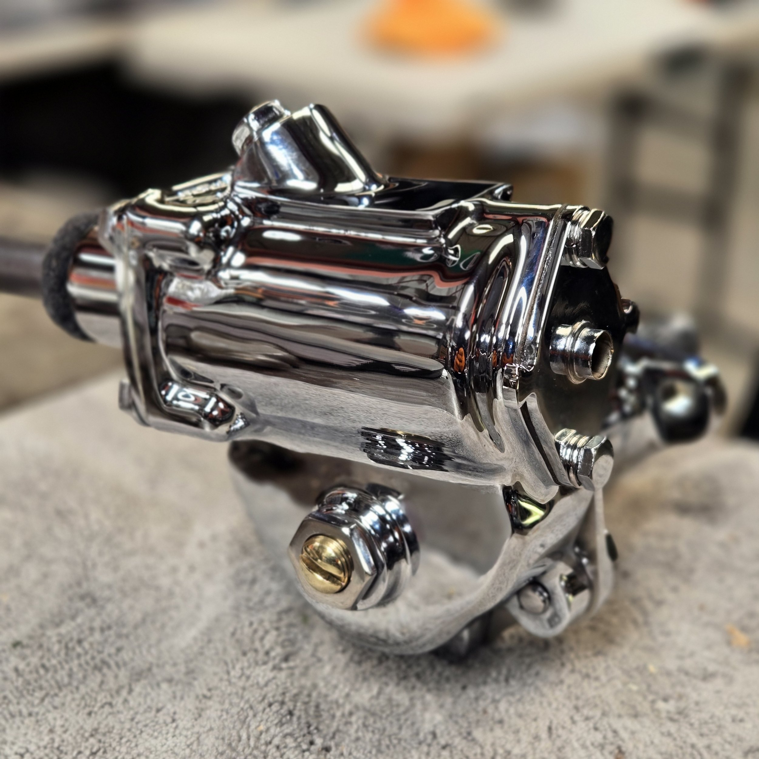

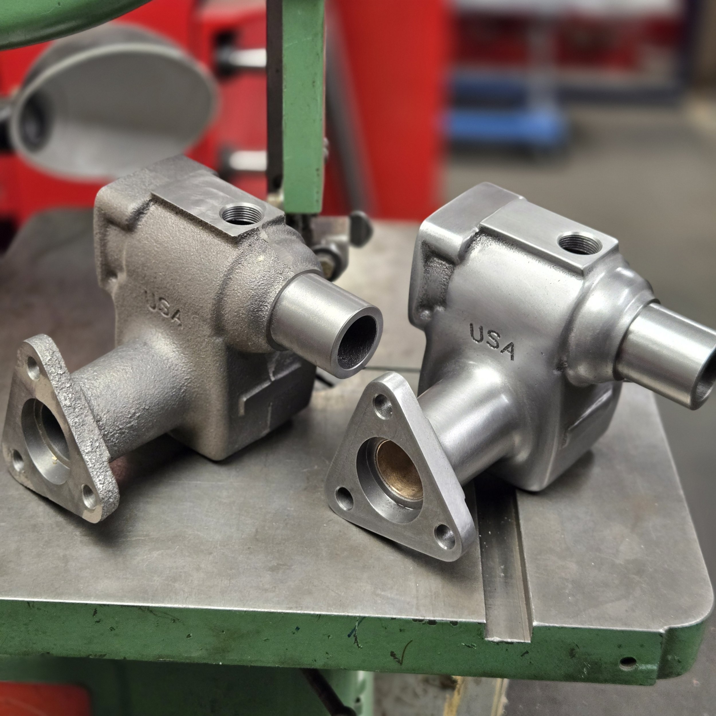

    Assembled this box for Cory Taulbert for the Silver Saphire restoration.
    He sent it to me last year to do the initial machine work, then he sent it off for plating. Advanced Plating did a beautiful job. Way nicer than anything I've had done for the 5w.
    Now I'm prepping another steering box to go to chrome.
    I have a love/hate relationship with chrome. I love the way it looks, but hate the prep and especially the cleaning after plating before assembly is the worst.
    But here I am again

    How do you protect the machined inner surfaces? Plug up the whole insides, or coat the delicate areas with something special?
    porkshop likes this.
  8. NealinCA
    Joined: Dec 12, 2001
    Posts: 3,438
    NealinCA
    I will leave an old bearing race and bushings in the housing to protect those machined surfaces, then use masking lacquer like this on the rest of the inside..
    I've even used Duplicolor lacquer touch up paint with success. Even with masking, there is still a lot of clean up work to do after it comes back from chrome.

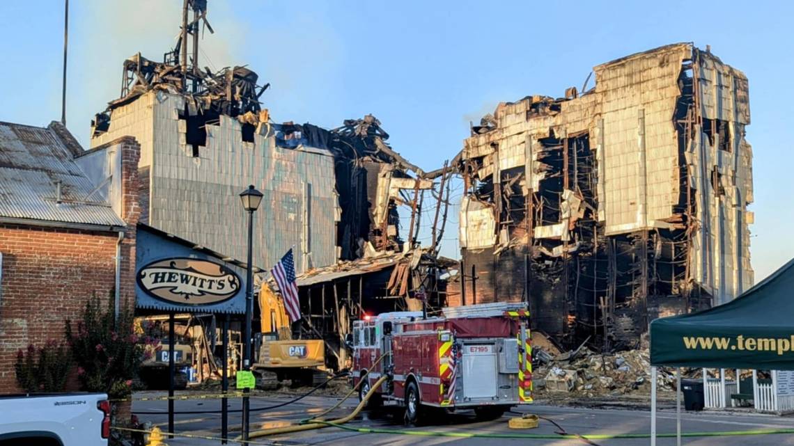

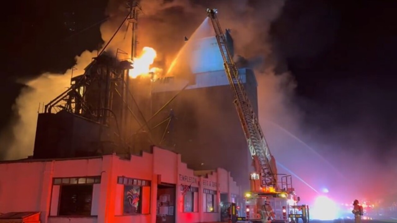

    Last night we lost a local icon and favorite picture spot.
    "Templeton Feed & Grain has long been a San Luis Obispo County institution, with its iconic 80-foot grain elevator and grain silos standing proudly above Templeton’s Main Street for decades.
    The original concrete building was built in 1912 and was used as a garage for Chevrolet vehicles and Illinois tractors. It was converted to a granary in the 1930s."
    RIP Templeton Feed and Grain.

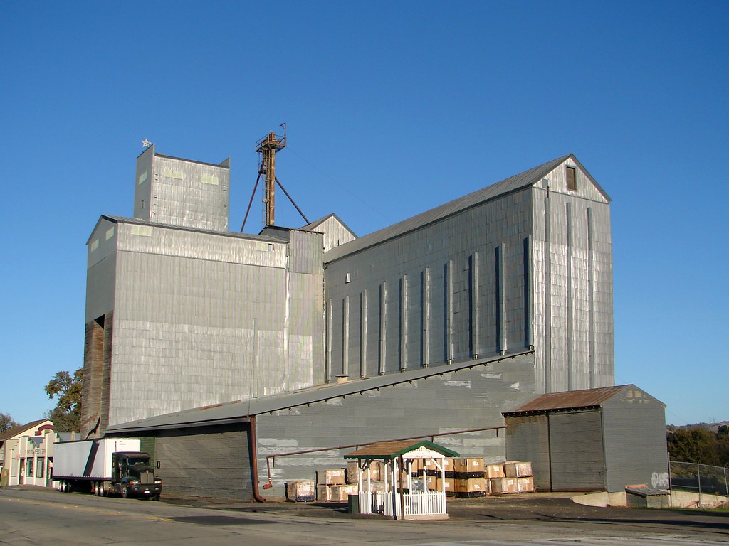

    This building was right in the center of downtown. And even as it became surrounded by restaurants and shops, it was a clear reminder to the cattle and grain heritage of the central coast. Now that is gone.

  23. @NealinCA was that still in use? In the pictures it appears to have grain spilled out of the facility?
  24. NealinCA
    Posts: 3,438
    NealinCA
    Yes, still in operation by the same family that has run it for the last 80 years. They are having another Central CA mill produce their proprietary livestock feeds until they can find another facility or rebuild to some extent.
