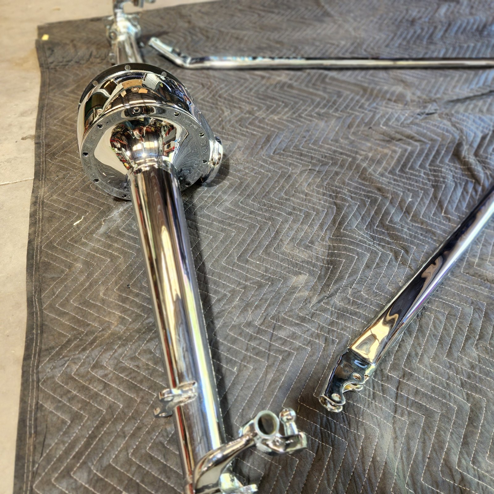

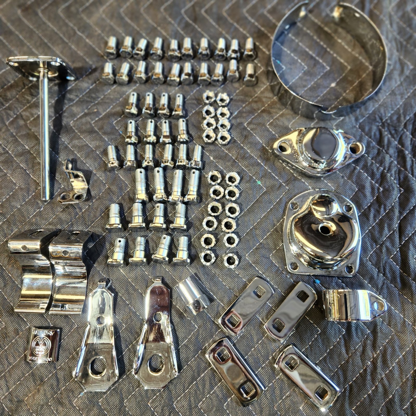

    Chroming one of your steering boxes too?

    Amazing. It's time for me to start this as well. Those. Brake line brackets are amazing. Now I want to do mine.

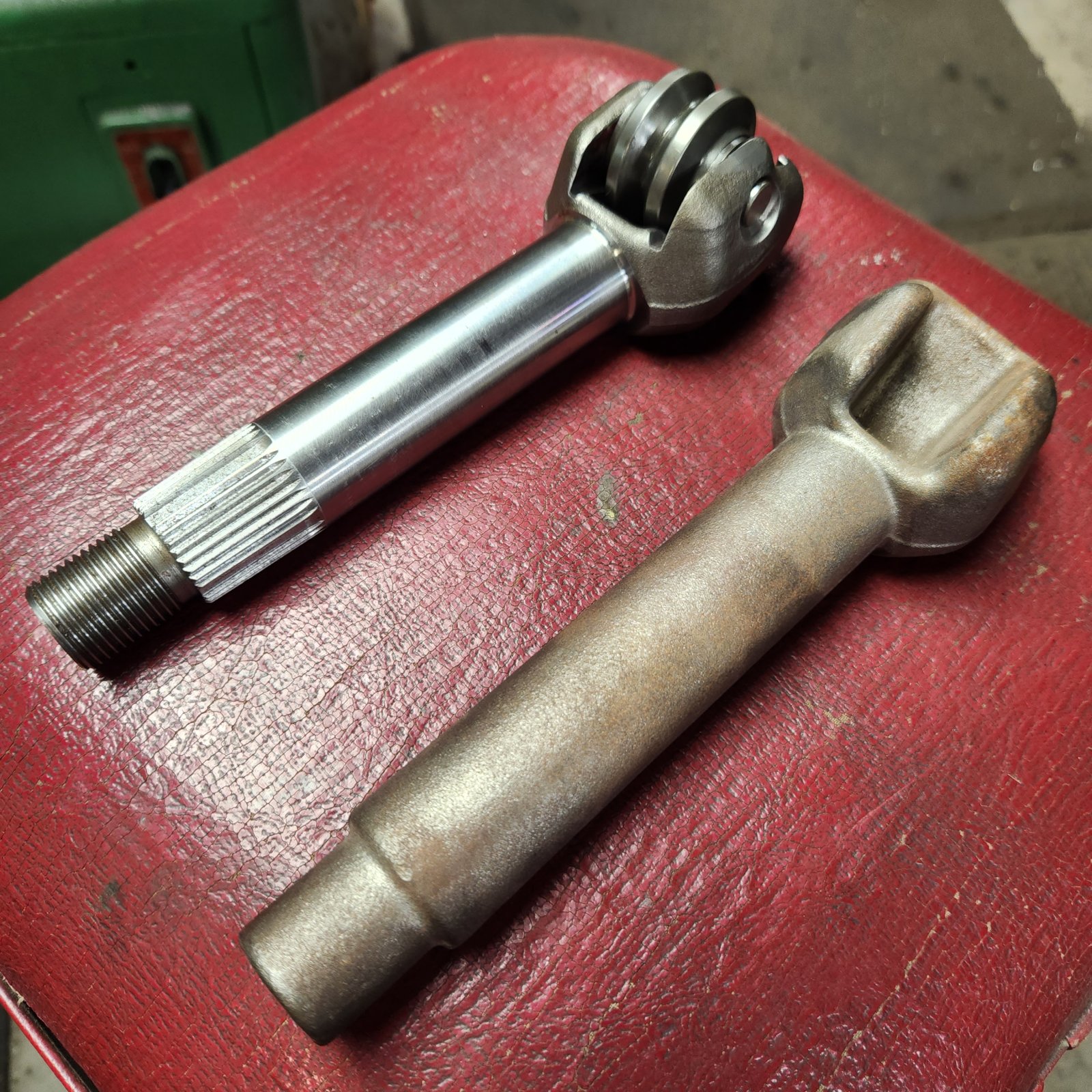

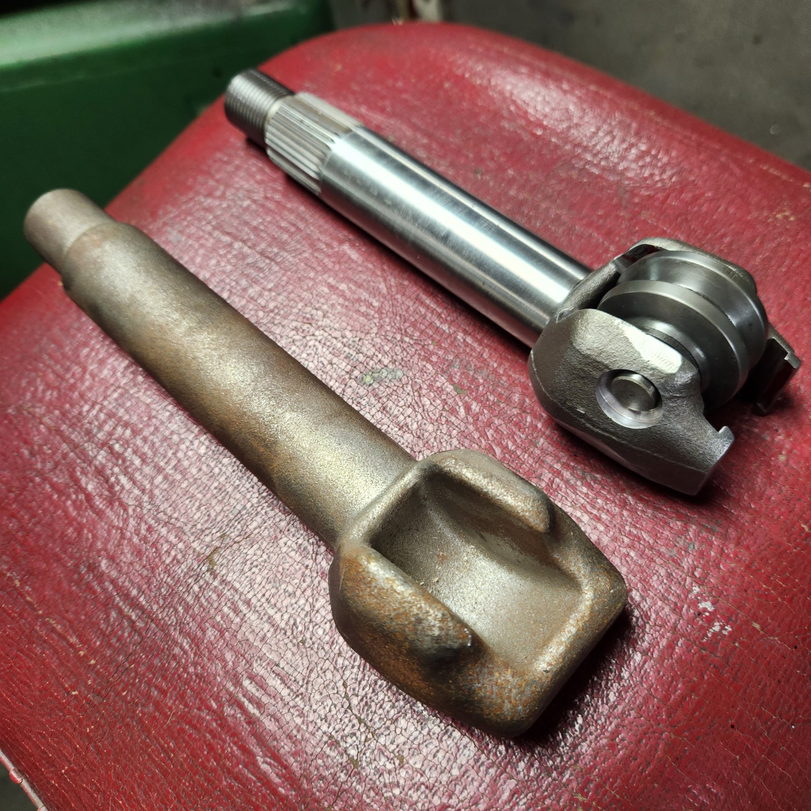

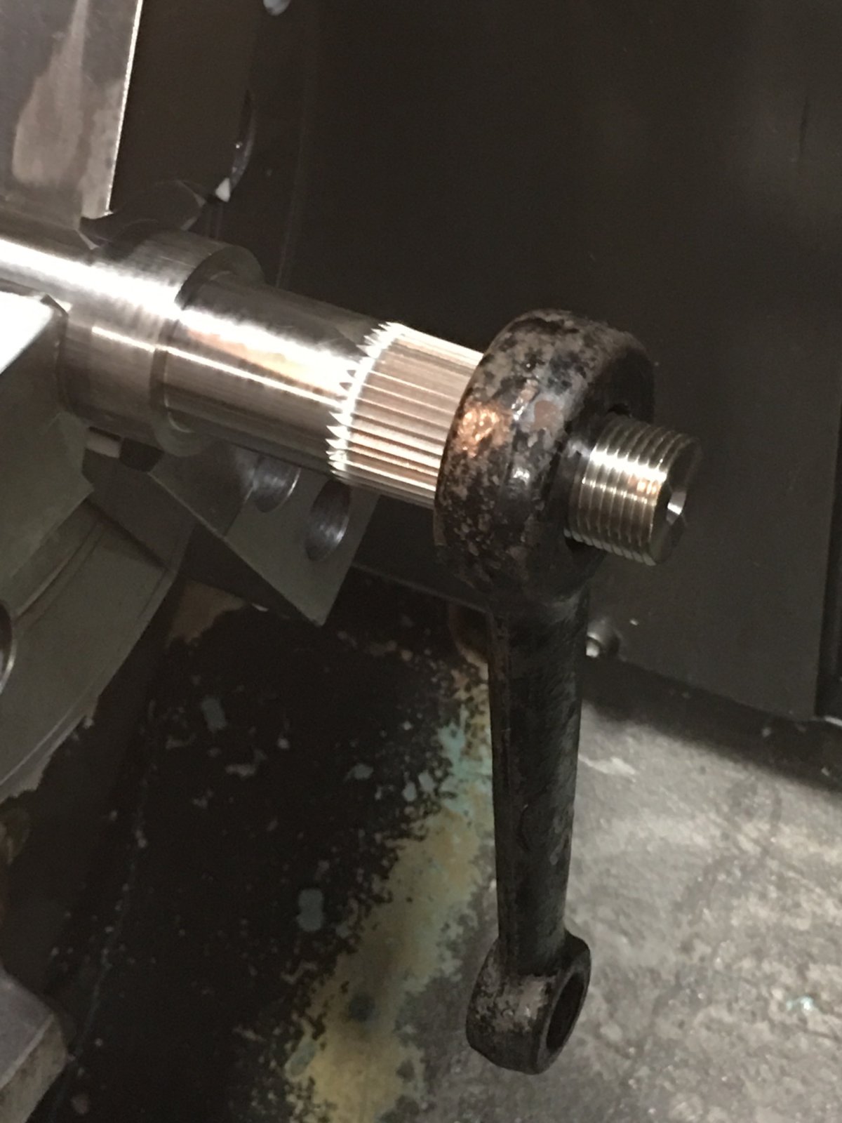

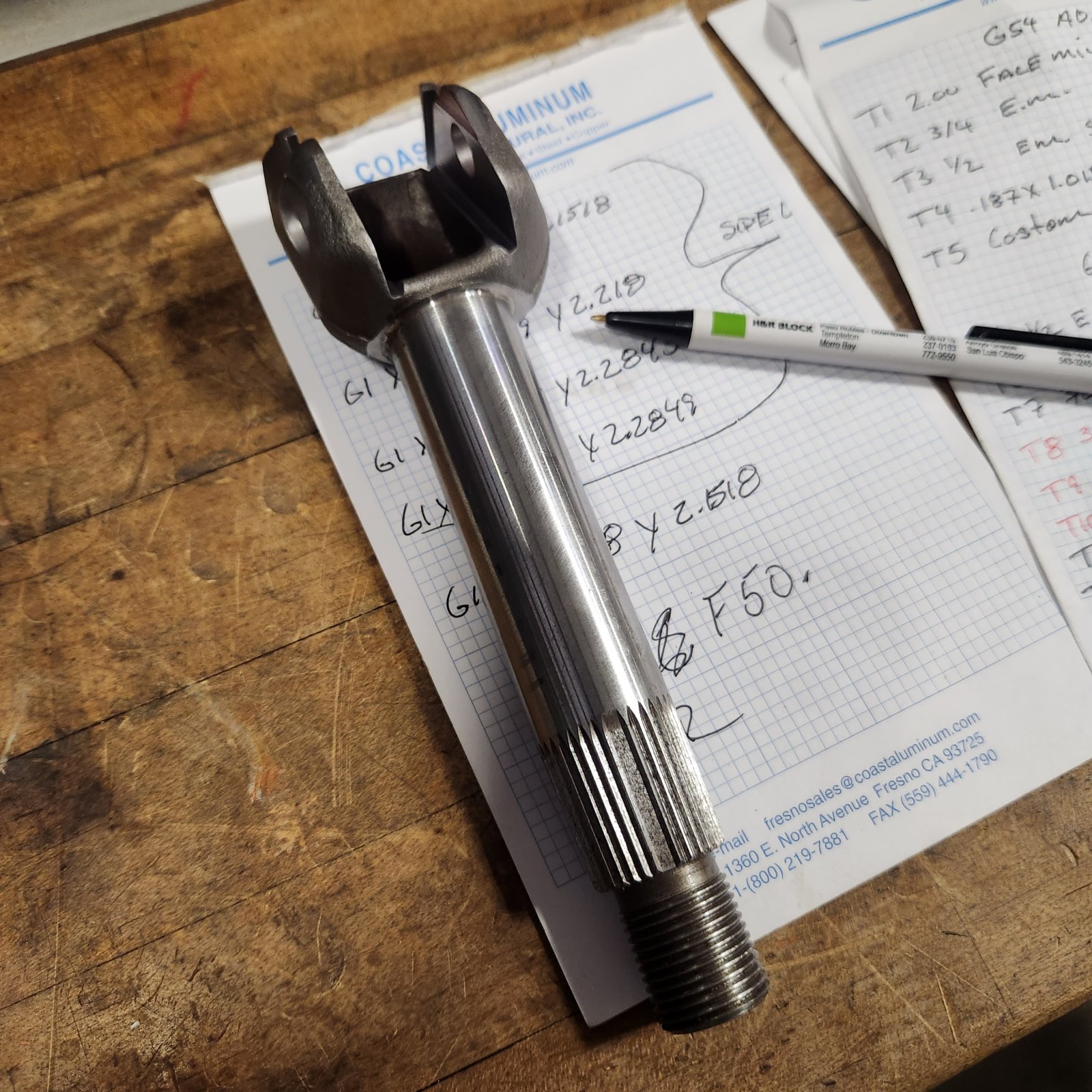

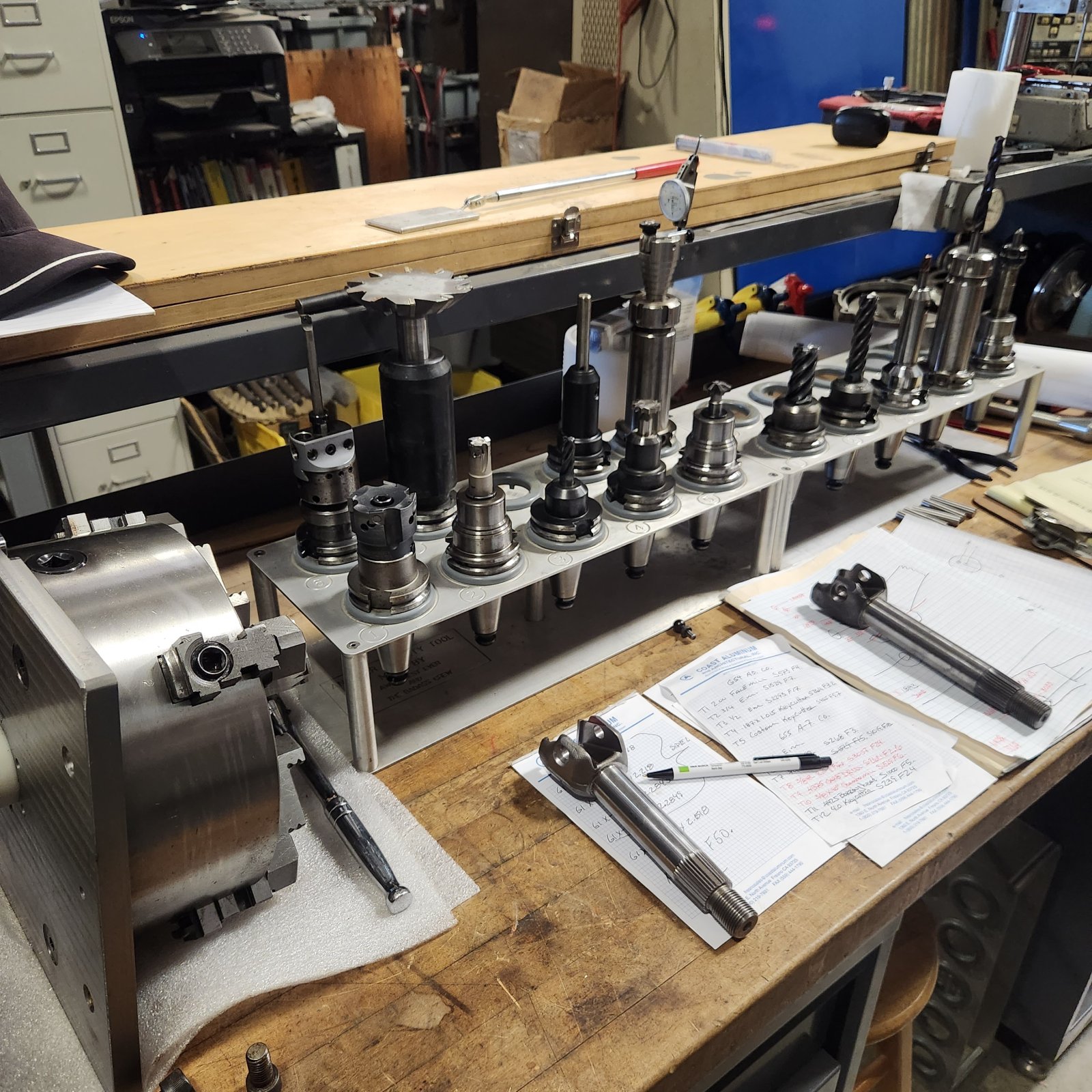

    As many of you probably know, I dabble in steering boxes. Ive been working on a newly cast 37 Nash/Hudson style box for a while. The next step in that project was to produce a sector shaft.
    I had these bkanks forged from 4140 ChroMo steel
    624393.jpg 20191219 (1).jpg 20191219 (2).jpg 20191219 (3).jpg 20191220 (1).jpg
  13. Tim
    Joined: Mar 2, 2001
    Posts: 20,449
    Tim
    from KCMO
  14. NealinCA
    Joined: Dec 12, 2001
    Posts: 3,514
    NealinCA
    The next step finding a machine shop with the capability and willingness to take on the next step.
    I found a local shop, but he is a one man, part time shop, so this has taken a loooong time to fet to this stage, but I picked up a sample part yesterday.
    IMG_1740.jpg 20230715_162123.jpg 20230715_162136.jpg 20230716_115749.jpg 20230716_115803.jpg
    We still need to work out a few kinks, but this is a huge milestone on this project. Some friends have commented that " you must really want to build steering boxes" as it seems to be one road block after another, but i have stuck with this project. Hopefully one day I will have all the components. This project consumes my life at times, so the 5w project ends up on the back burner. Good thing I have friends like Josh Carrillo that can make that project move forward

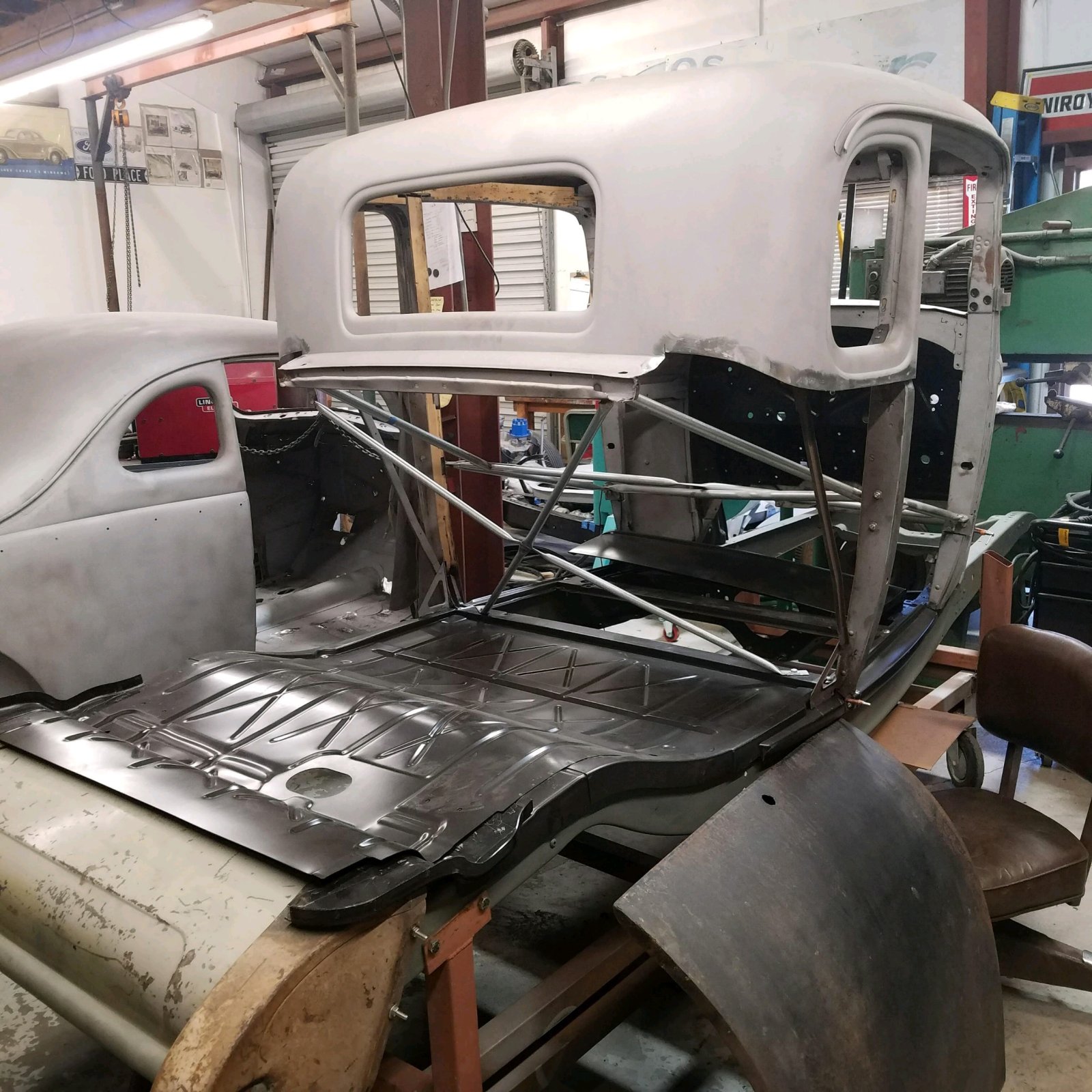

    His chopped window wood looks so good.

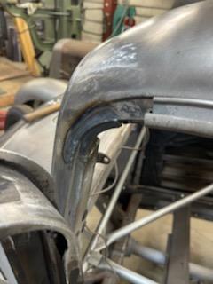

    I've been wanting to ask if the deep-set Lincoln backing plates combined with the 32 tie rod ends required steering arm weaking to provide needed clearance
  18. NealinCA
    Posts: 3,514
    NealinCA
    Yes, the steering arms had to be heated and bent, not only for the dropped axle, but needed to bend inwards to clear the backing plates.

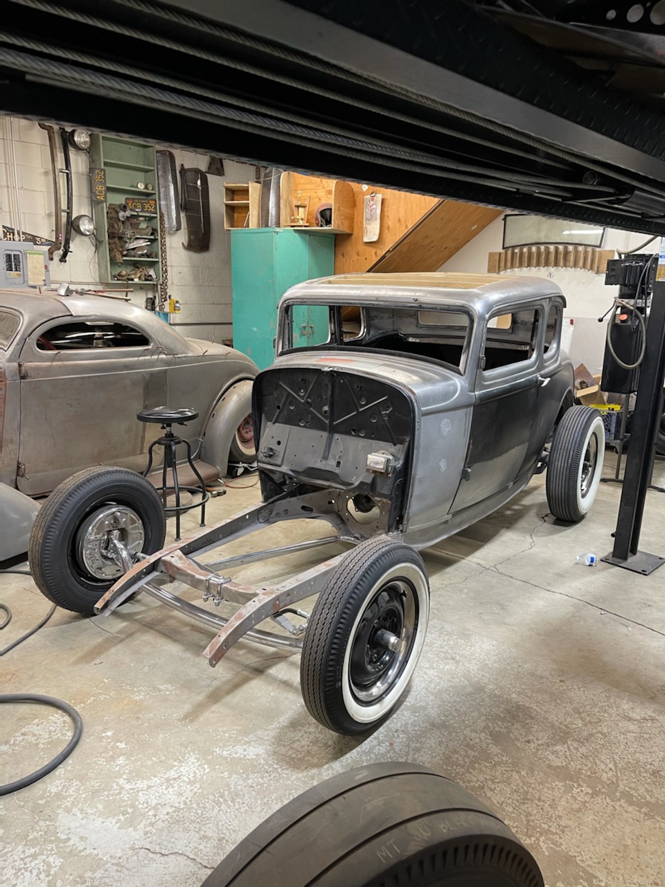

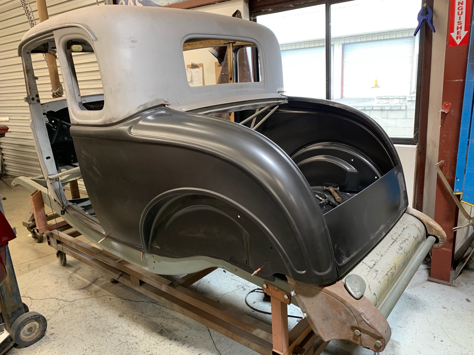

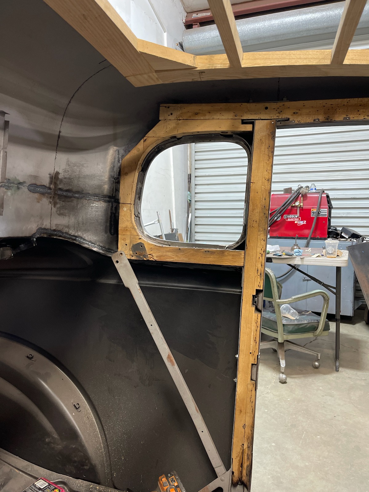

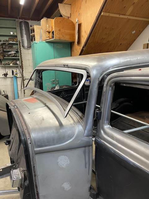

    I picked of the 5w from Josh today. We rolled it outside for a few quick pics before it went in the trailer.
    Garnish moldings and wood are done
    The man in charge. Josh Carrillo, Carrillo Customs. I can't thank him enough for making this happen.
    And a few more shots
    20230718_174205.jpg 20230718_174221.jpg 20230718_174923.jpg 20230718_175132.jpg 20230718_175018.jpg
    I think that rear 3/4 shot definitely says hot rod. I can't wait to get it all ***embled with fenders, hood, etc and see what the whole package looks like with the chop.

    I think that is the perfect chop, not too little, not too much. Excellent workmanship, also

    It doesn't look like a 4k body any more! It looks like a million bucks!

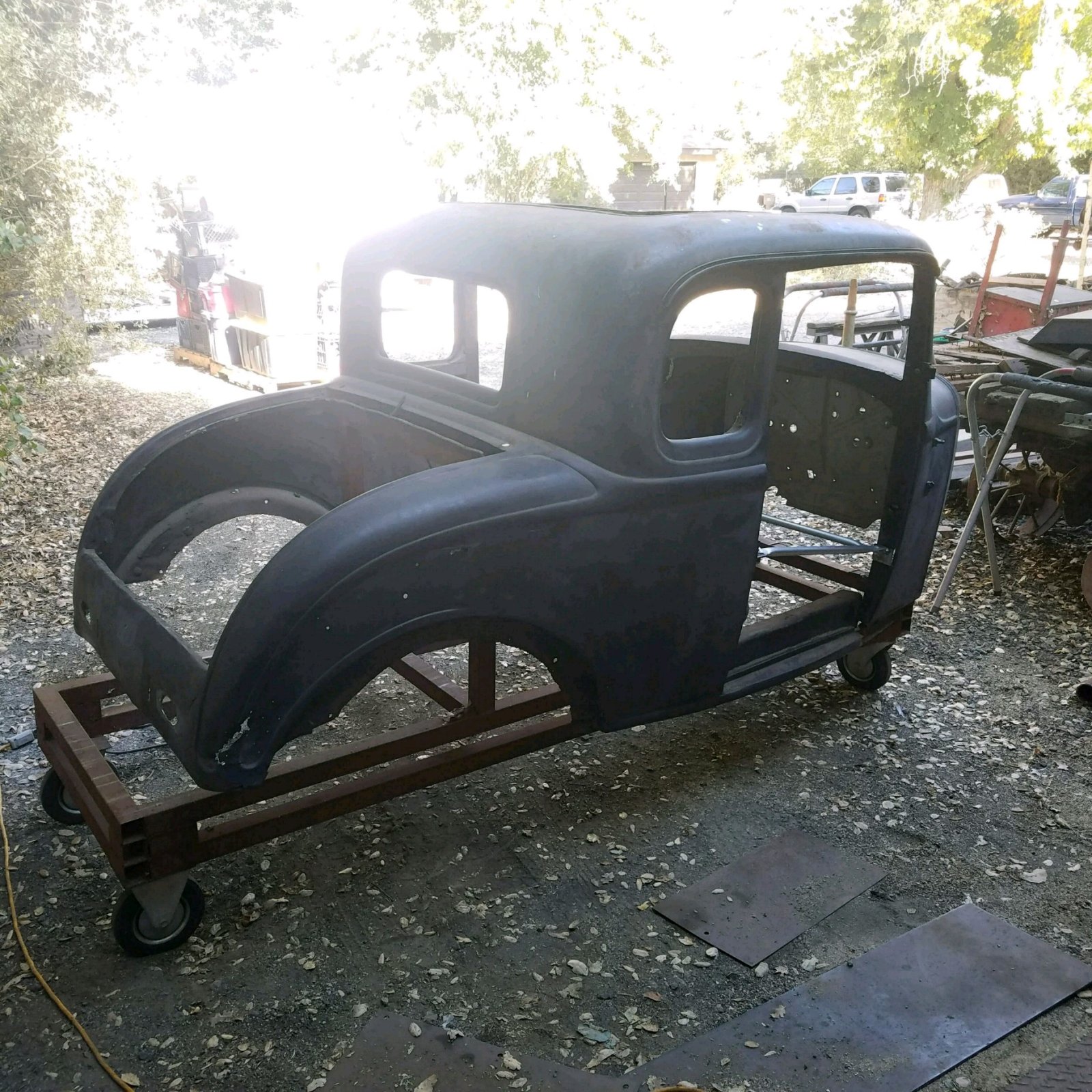

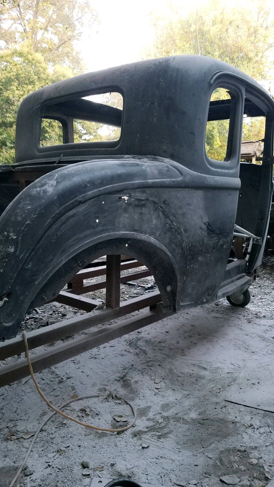

    Just a reminder from where it came... 54775.jpeg 54774.jpeg 54777.jpeg 32709.jpeg 20230718_175018.jpg

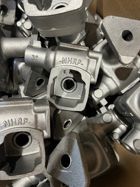

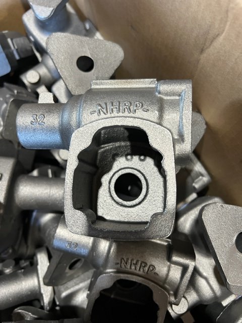

    More from my other "hobby". I have been working with the pattern maker and foundry for over a year to get a new batch of steering box housings run. We had to switch to a new foundry after the last two runs, which required rework of the patterns. Finally today we have raw castings that look really good. Now off to the "new" machine shop...as we are starting from scratch there too because the pandemic closed the old shop we were using.
    Fun with old cars...right?
