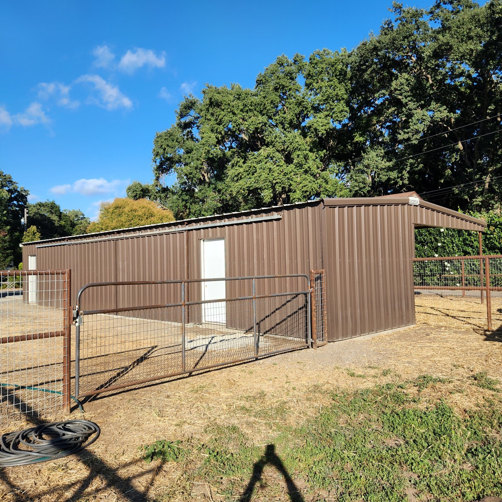

    I've been busy with other projects, like a hay barn and the flathead race car i help Josh with.

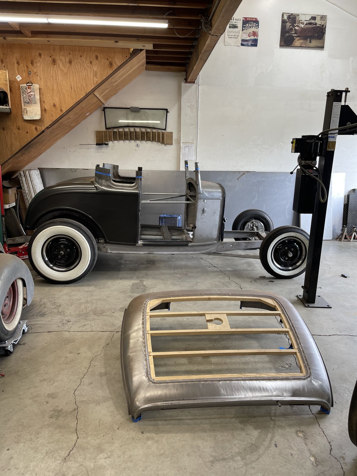

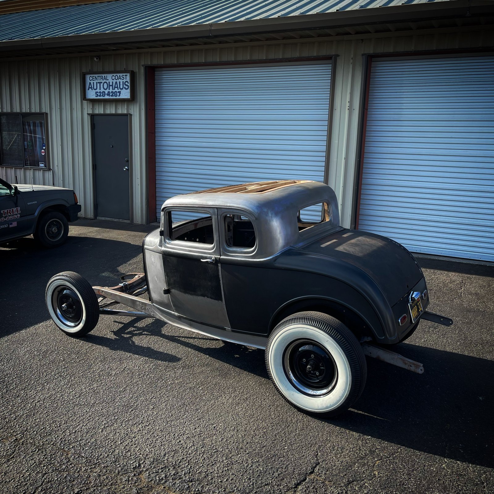

    Messed with rear fender and bumper placement yesterday. I took some inspiration from the Lloyd Bakan coupe on the rear fender treatment, then tweaked my worst pair of original rear bumper brackets to mock up the rear bumper. I ended up moving the bumper up about 2-1/4" and closer by about 2-1/2".
    20231015_141923.jpg 20231015_150157.jpg 20231015_155725.jpg 20231015_173130.jpg 20231015_173138.jpg 20231015_173308.jpg
  23. -Brent-
    Joined: Nov 20, 2006
    Posts: 7,705
    -Brent-
    Huge improvement!
  24. NealinCA
    Joined: Dec 12, 2001
    Posts: 3,396
    NealinCA
    Thank you. I think so...getting rid of the tall roof and long fenders cleaned up the look. More the subtle vibe I am going after.

    I'm missing something. Where did you section the fenders or is that a photo chop?
  27. NealinCA
    Posts: 3,396
    NealinCA
    As was done on the Bakan coupe, fenders are rotated forward, and about 2" sectioned off at the running board.
  28. Great look! Thanks for the tip!
