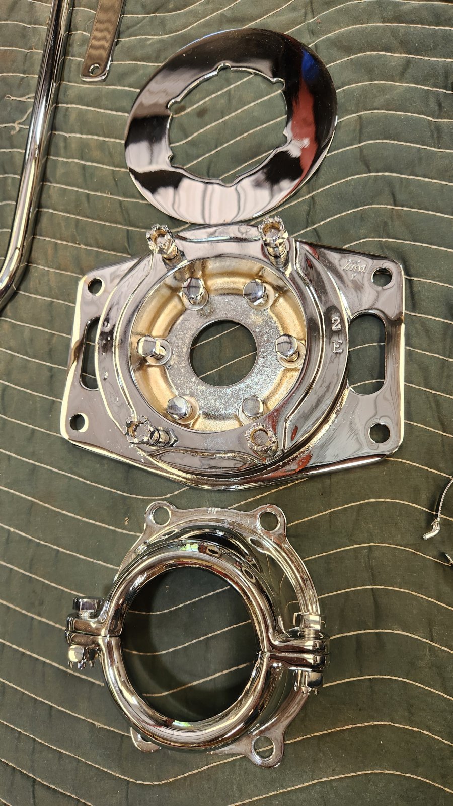

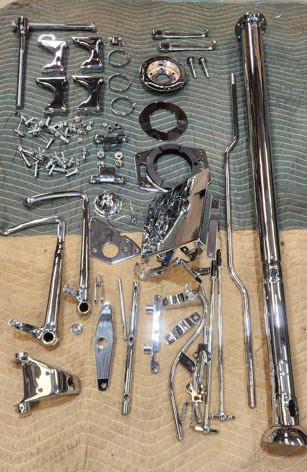

    What happens to the rubber on the trans mount when it goes in the tanks?
  2. NealinCA
    Joined: Dec 12, 2001
    Posts: 3,323
    NealinCA
    I asked about that before sending it, and they said it would not be affected. The rubber still looks new after plating.

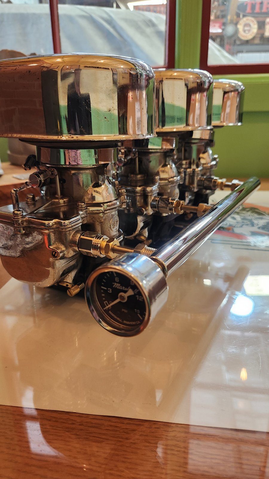

    Neal, is your fuel pressure gauge a Marshall and do you have any experience with them? I'm currently running a Moon but wondered if the Marshall was a better gauge.

  14. Moon Direct Mount Gauges are made by Marshall

    Thanks for that Luke, with your connection to Moon you'd know the correct info. Don't remember any info on the gauge. No need to switch it out then.

    Marshall seem to be a good Quality,
    I did have one that was about year old give me a Scare,, It blew out seal Fuel every where , Luckily hot tubes did not
    Light the fuel up ,,, Could of happen with other Name brands , High pressure set up , 75 psi , I changed over to a sending unit , In pass Never had Name brand blow a seal .

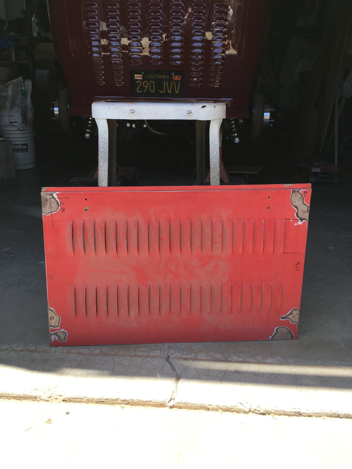

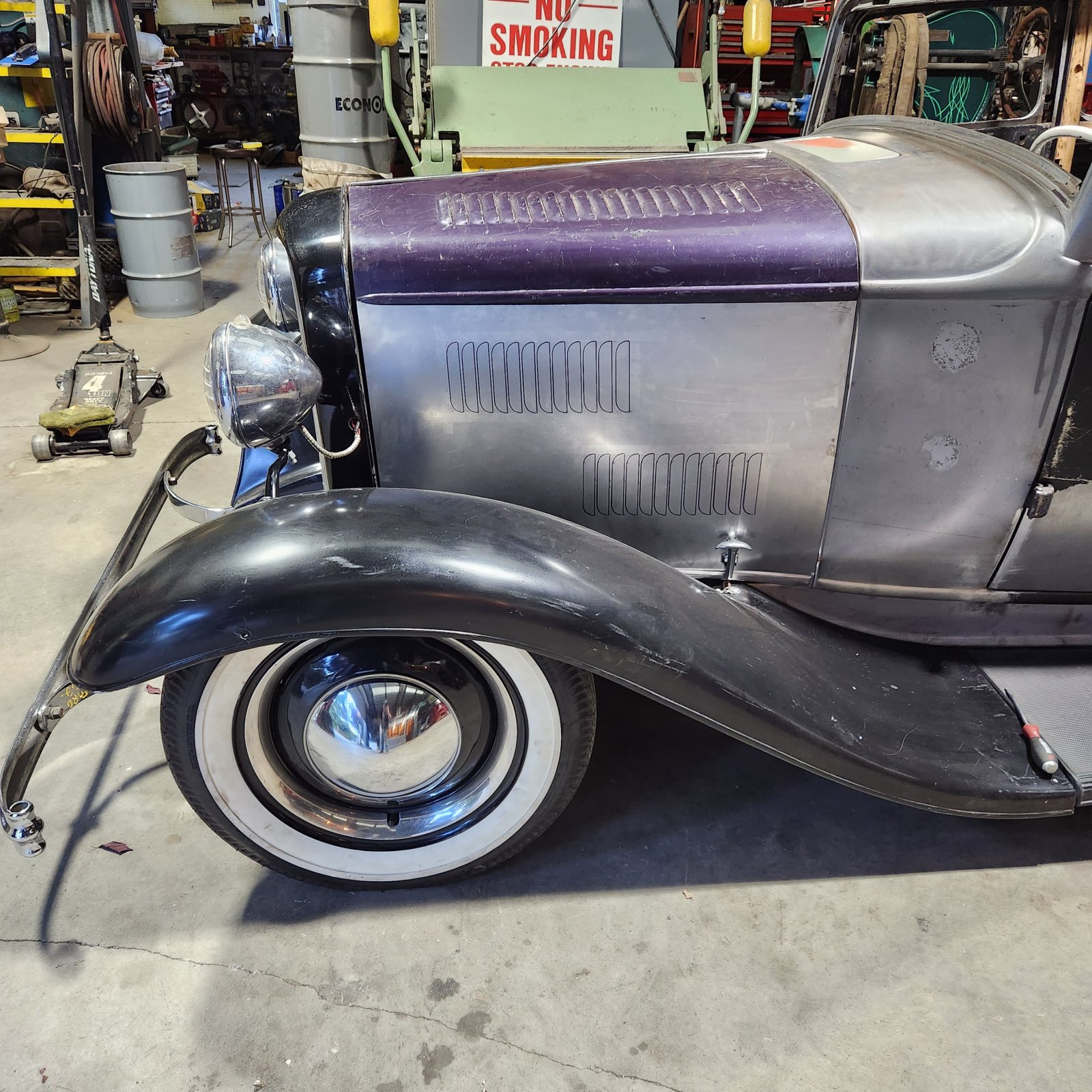

    Here's my sad story from LA Roadster's swap.

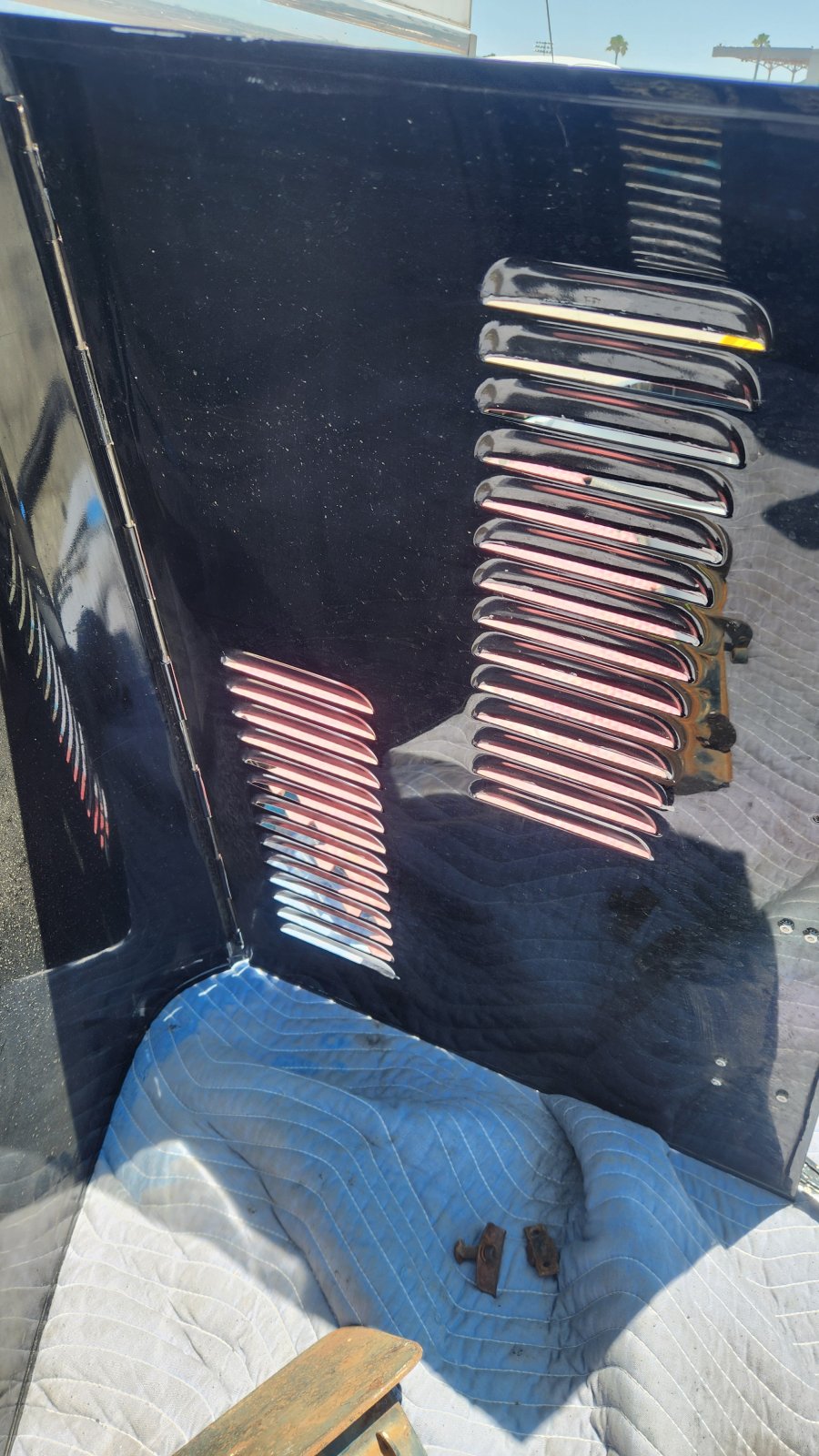

    I bought a 32 hood top at the Turlock swap years ago. It has some unique 5" louvers, and I have been on the hunt for some matching hood sides ever since.
    With no luck, I did buy some smooth hood sides and started working on getting some dies made.
    Thursday afternoon, on set up day at LARS I spot this hood. My heart was racing and I was reaching deep into my pocket for cash...
    Then I saw this.
    I was kinda over the whole swap meet at that point and didn't really go out shopping the whole weekend.
    I will keep on with making our own dies, but I would have loved to owned those vintage hood sides. You win some, you loose some.

    That’s the beauty of blue tape, it peels off easily! All’s fair in Love, War, and Swap Meet Shenanigans!
  20. alchemy
    Joined: Sep 27, 2002
    Posts: 21,416
    alchemy
    Ya still could have asked. Any true blue hot rodder would have let them go to your good cause.
    brEad likes this.
  21. NealinCA
    Posts: 3,323
    NealinCA
    We did ask. The answer was a hard NO! The hood is headed to Sweden.

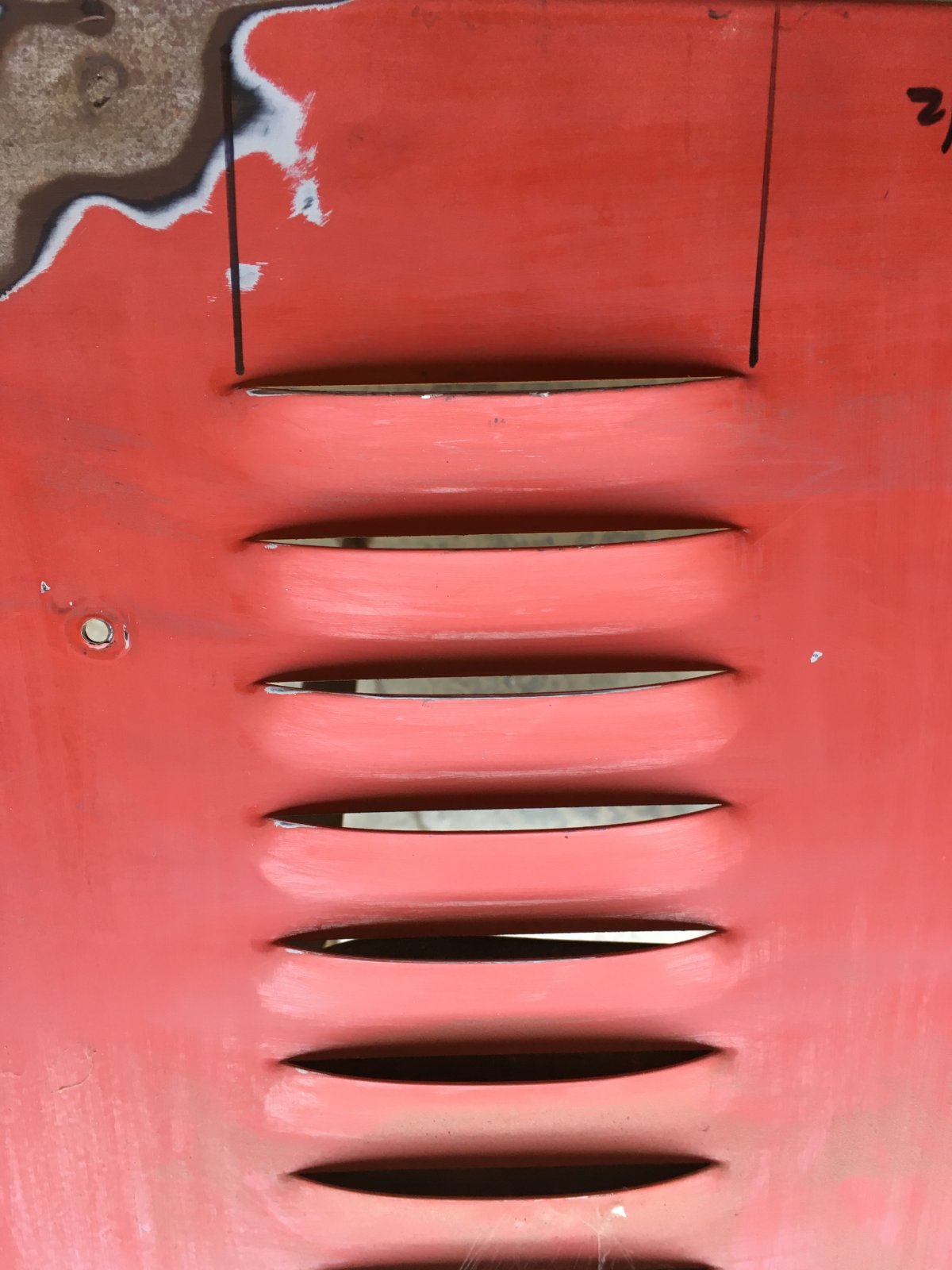

    Neal, I had some holes punched at Blair’s in the early 70’s, think they are 4 inch, but if the press is still there maybe there’s different dyes too. When I get up into the rafters I’ll take a picture.
    Outback and pprather like this.

    Well they are not exactly like yours, a little flatter at the ends and 3 and 3/4 tip to tip. 004F9ABB-63C6-4FD5-B2F3-5D3211ED5FD3.jpeg 1B1F3589-5D62-454F-A605-2BD8DD1FC9B8.jpeg F5ACDF17-C720-4FE7-8E27-BD60E0223723.jpeg F5ACDF17-C720-4FE7-8E27-BD60E0223723.jpeg

    Thank you for the pics. Those are neat louvers, but very rounded profile. I will keep "pressing" on with making dies to match the hood tops...

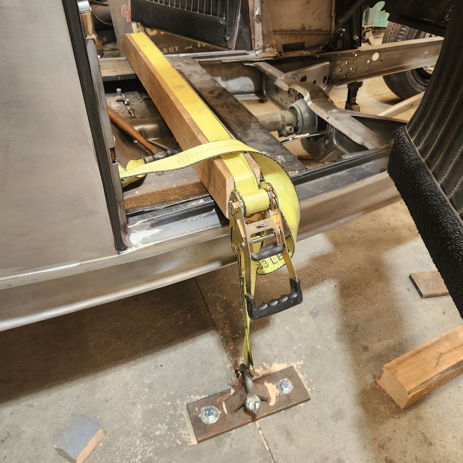

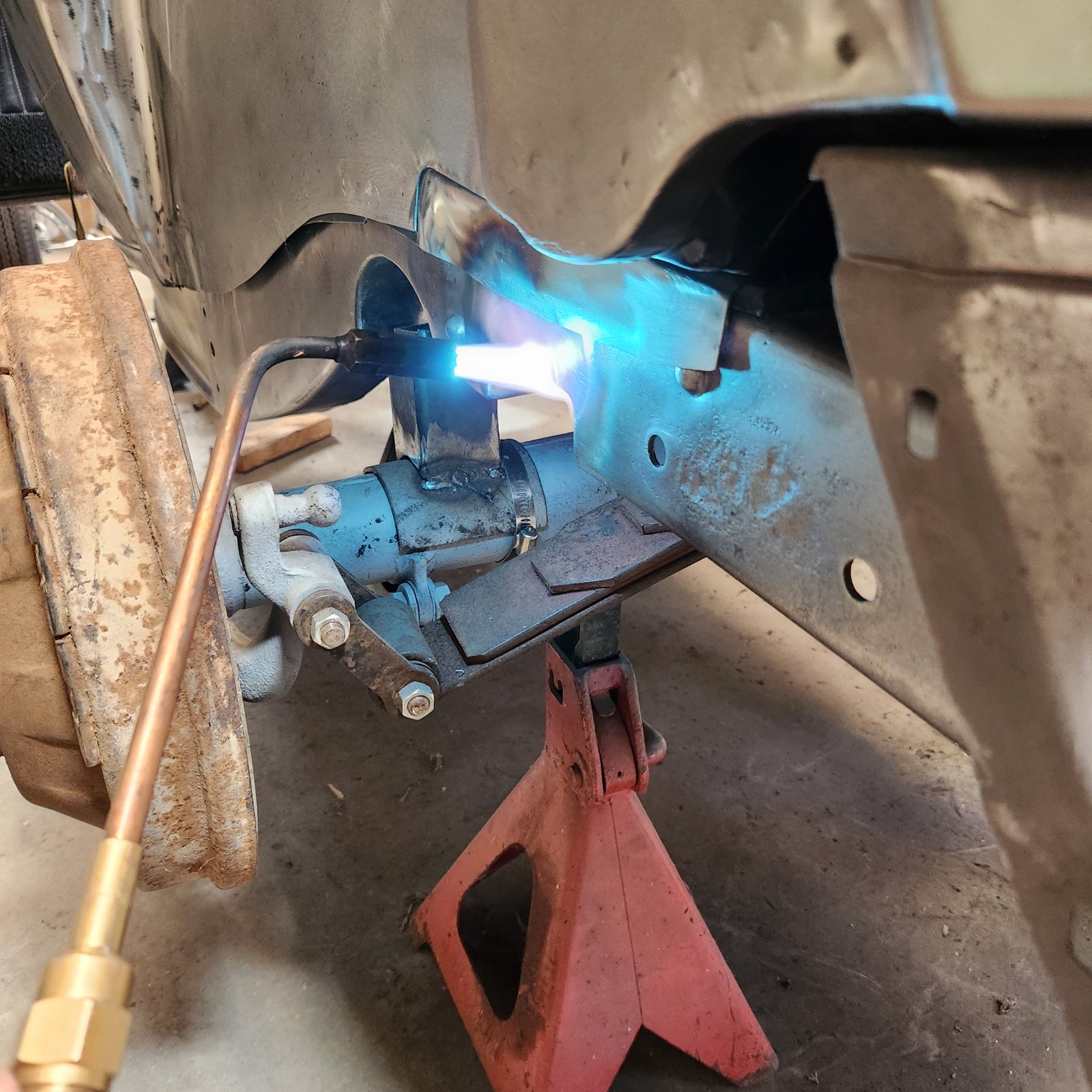

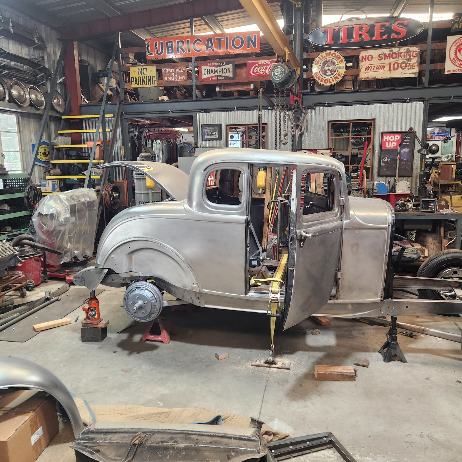

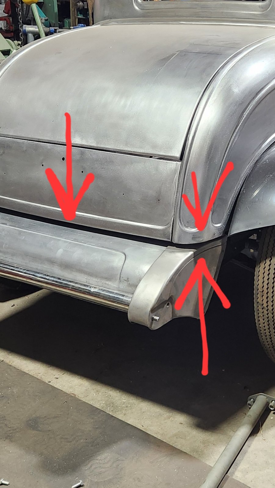

    After welding the C-notch and spring notch, the rear frame horns pulled down a little, leaving a gap between the body and tank. We put the car on stands with a strap through the doors to some anchors I have in the shop floor. We then heated right at the spring notch with a rosebud and jacked up the tails of the frame horns with 2 bottle jacks. I went gradually side to side, taking the gap from about 5/8" down to about 1/8" at the frame horn cover. It took longer to get the car set up than it did to do the job. One more task off the list though. 20240620_195420.jpg 20240622_150811.jpg 20240622_150828.jpg 20240622_143501.jpg 20240622_143505.jpg 20240622_143648.jpg 20240622_143706.jpg

    I'm going to guess you are real glad you found this gap before you chrome plated the rails. ;)
