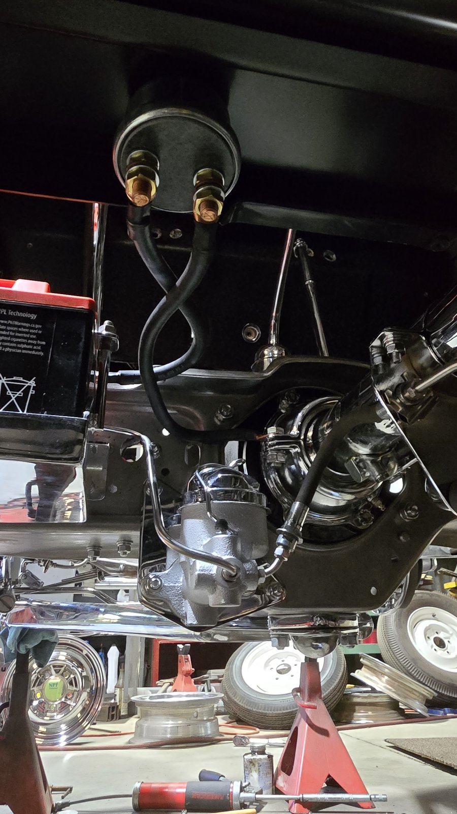

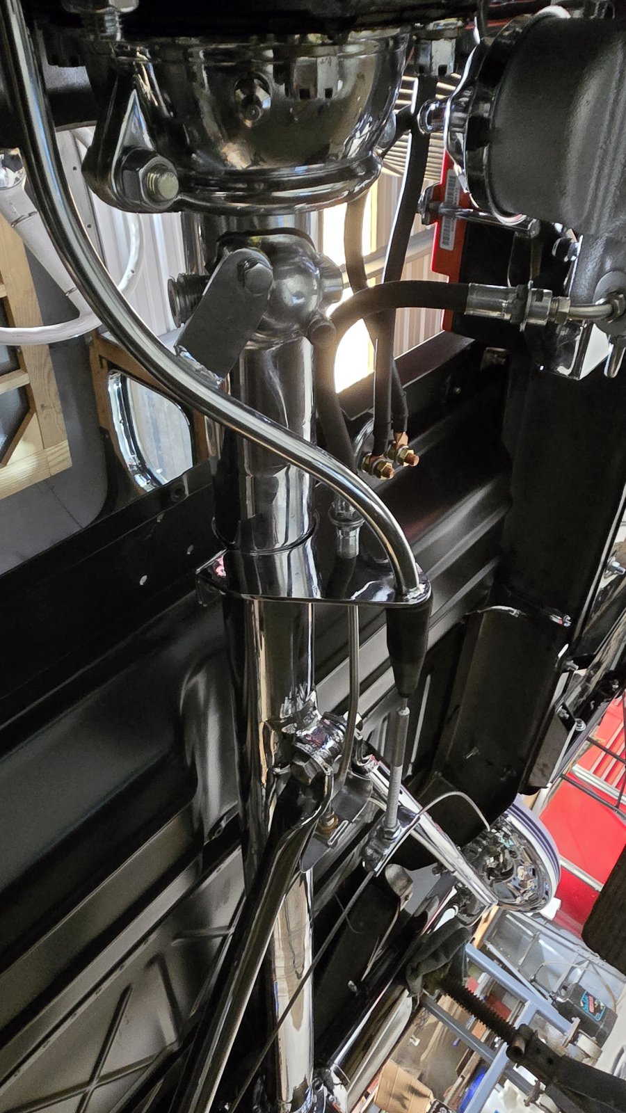

    Neal, for the brakes, do you do inverted flair on the stainless tubing ?
  2. NealinCA
    Joined: Dec 12, 2001
    Posts: 3,323
    NealinCA
    Yes, they seemed to form nicely using an Eastwood flaring tool, as well as my old Imperial Brass flaring tool. Stainless tube is from Inline Tube. Anything I should be worried about?

    Regarding flaring S S. tube, I was always advised to use a 37° flare, never use a 45° inverted flare.
    In addition, always cut the tubing with a hack saw, never use a tubing cutter. The tubing cutter work hardens the tube right where you need to expand it. Details, details, details.
    Hope this helps.
    Tom

    Info from Inline Tube:
    Can I double flare stainless steel tube by hand?
    Yes, you can double flare stainless steel lines bought from Inline Tube. Our tube is fully annealed and is very easy to work with. We recommend and offer several good flaring tools: Rigid, Imperial Eastman or Blue Point. Carefully follow all the instructions that come with the tool and the tubing, and the flare will be perfect every time.
    Inline Tube bends hundreds of miles of long-lasting stainless-steel brake line every year. Our stainless-steel lines are more resistant to corrosion, deterioration, and damage than our standard OE steel lines. They are double annealed for supreme workability in bending, straightening, and flaring. All coils have a .028” wall thickness.
    This Inline Tube professional-grade flare kit will form 45° double flares as well as metric bubble flares on OE steel, automotive grade annealed stainless, and any soft metal tube.
    Please note: All Inline Tube bending and flaring hand tools are designed to be used with fully annealed automotive grade tubing with a wall thickness of .028”. As such, we cannot guarantee results or tool performance using these tools with any other grades or wall thickness.
    The annealed stainless tubing seems to be the key here and not what we have heard about in the past with stainless tubing cracking when double flared.

    Yep annealed will be easier to flare as it's softer. However it will still work-harden, so you still need to be careful with how you cut and flare it.

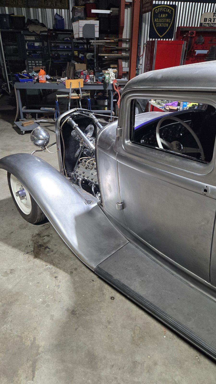

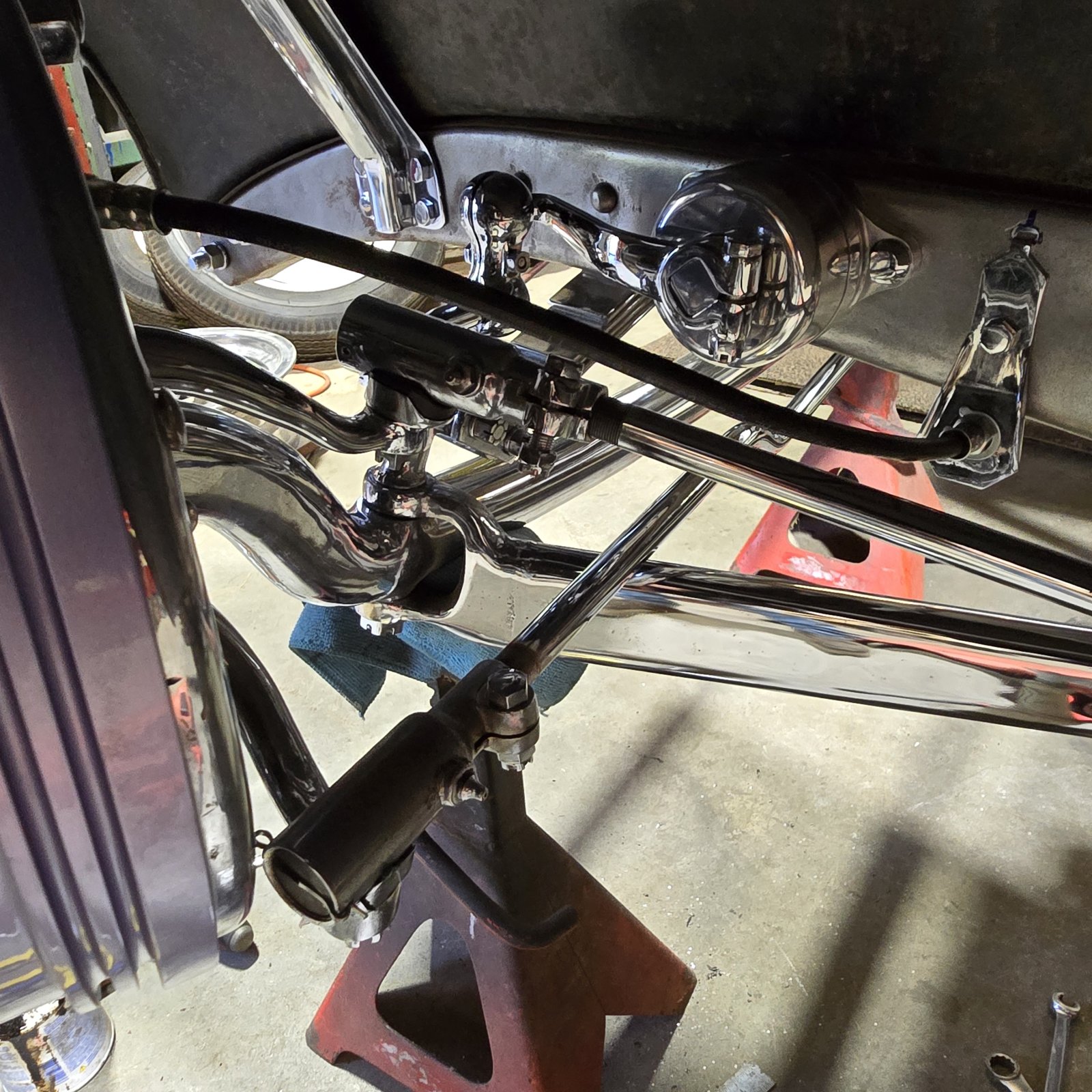

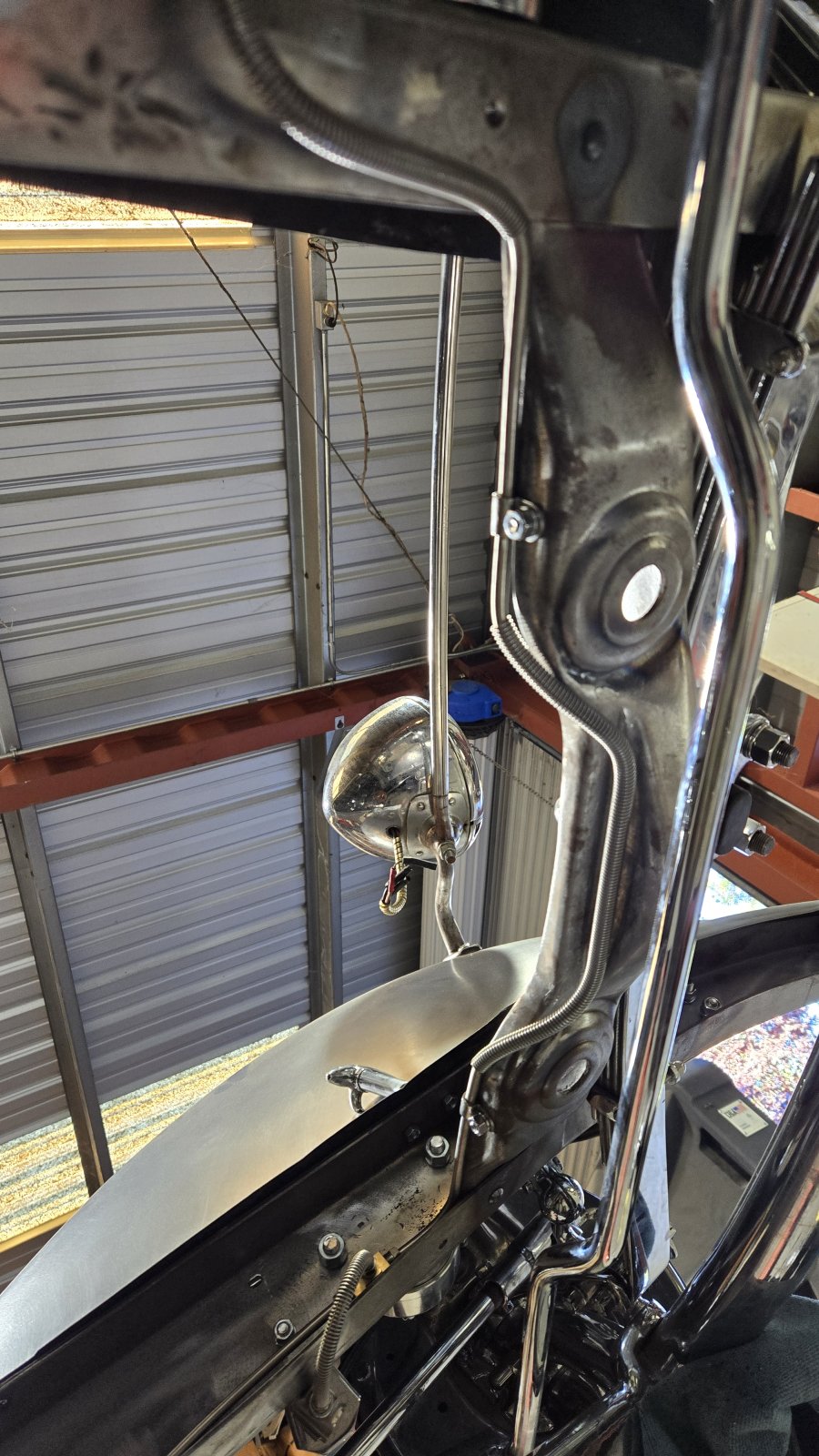

    Progress today. Brake lines done. Seat mounted. Dash installed. Hopefully the engine goes in tomorrow.

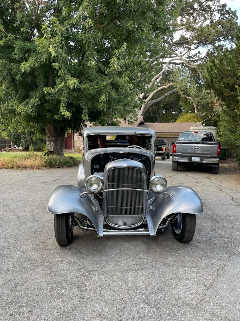

    We got the brakes bled, engine in and made it out of the shop under it's own power. I have some ignition issue, as we made it to the end of the block and it died. Fuel, but no spark. Gonna swap out the coil and then condenser and see if either fix the issue. 20240915_154737.jpg 20240915_154725.jpg 20240915_155942.jpg 20240915_183347.jpg 20240915_204102.jpg IMG_20240915_200536.jpg

    I replaced the coil and made a successful lap around the neighborhood. Lot's of little things to finish up now.

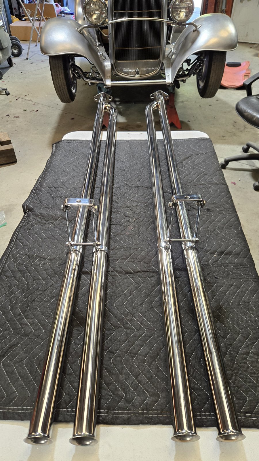

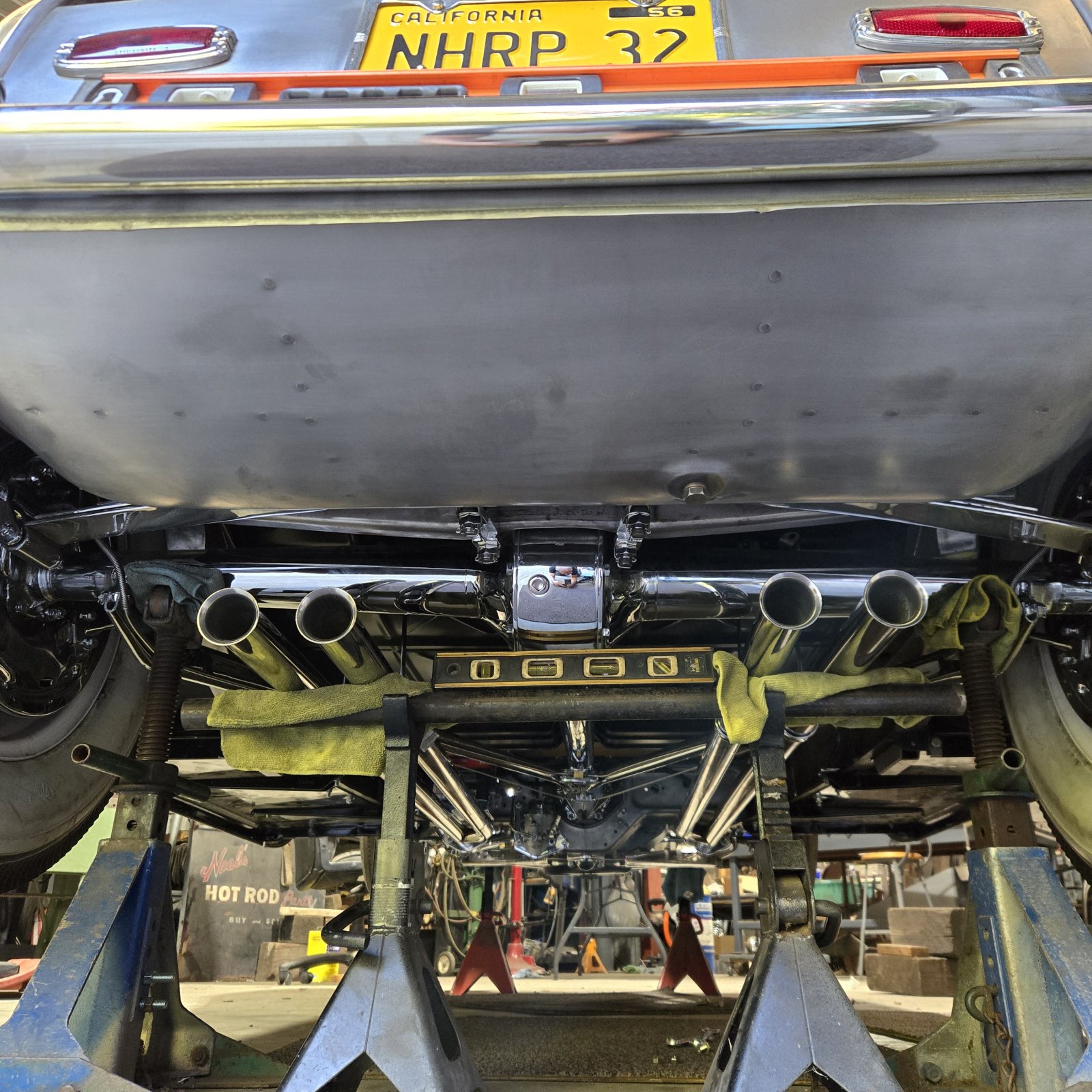

    Got the polished stainless scavenger pipes installed this afternoon.
