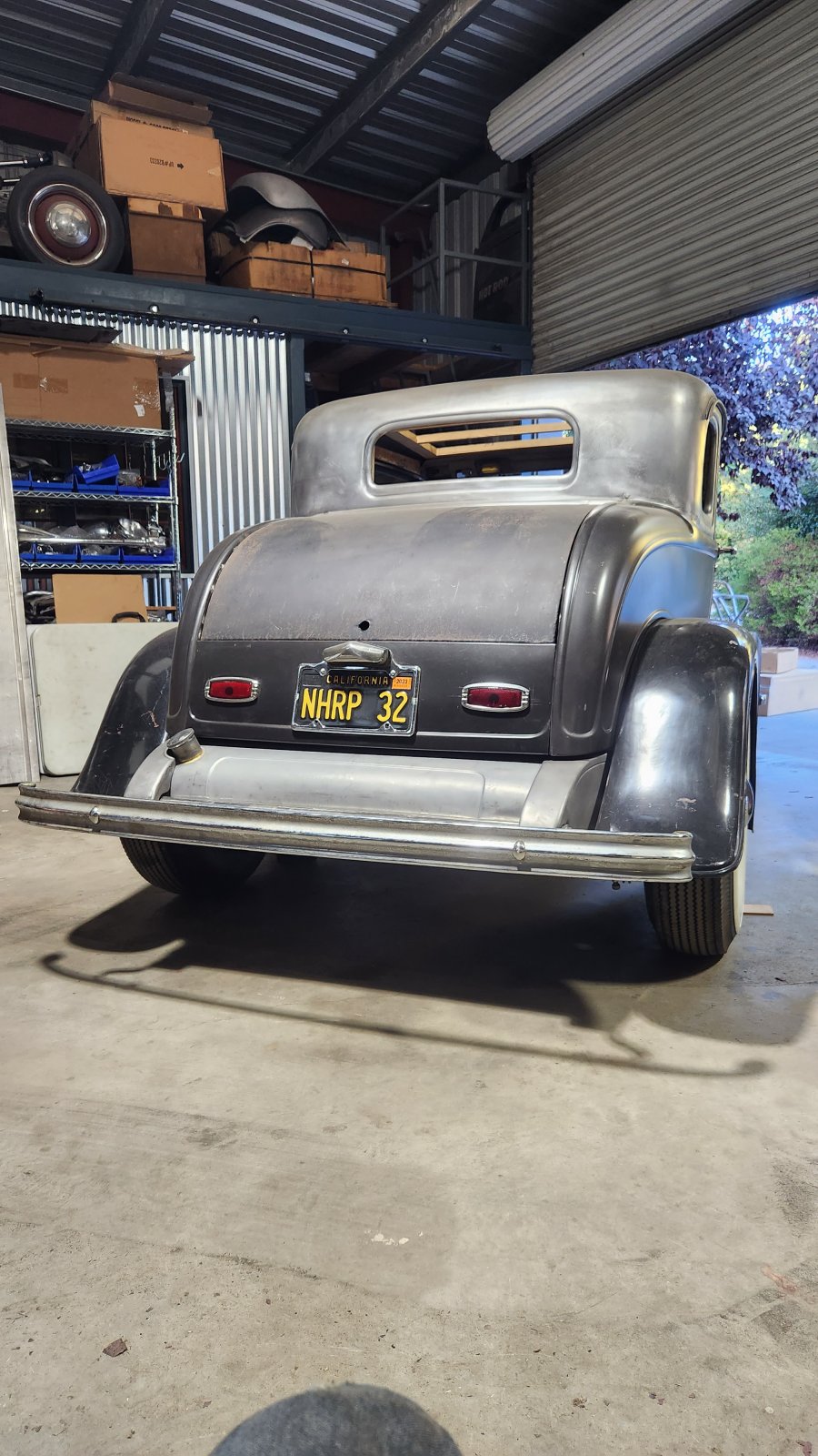

    Got the rear end back from my friend JR that set up the new 3.54 gears
    And put the mockup engine back in so I could work on exhaust and a few other details before it comes apart for paint

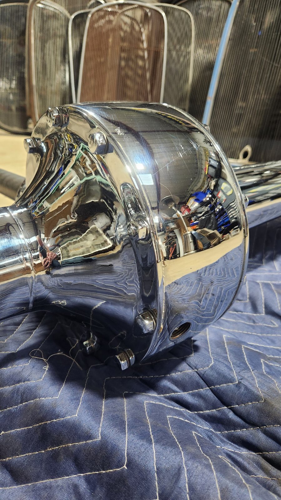

    For the new plating, yes, Mike at New Age, but a good majority of the plating on this car is old, swap meet chrome.
    The front axle, perches, front and rear springs, U-bolts, wishbone, front and rear backing plates, shocks, steering box, pitman arm, starter, generator, idler, fan, timing cover, carbs, air cleaners, oil filter, fuel pump and stand, voltage regulator, transmission case and shift top are all old 50's chrome. I have been collecting old chrome for a lot longer than I have owned this car. I am now just filling in with new plating when I can't find old to keep the project moving along.
    Major pieces of new plating are the rear banjo, axle bells and radius rods, oil pan and at the chrome shop now are the chopped windshield frame and garnish moldings.

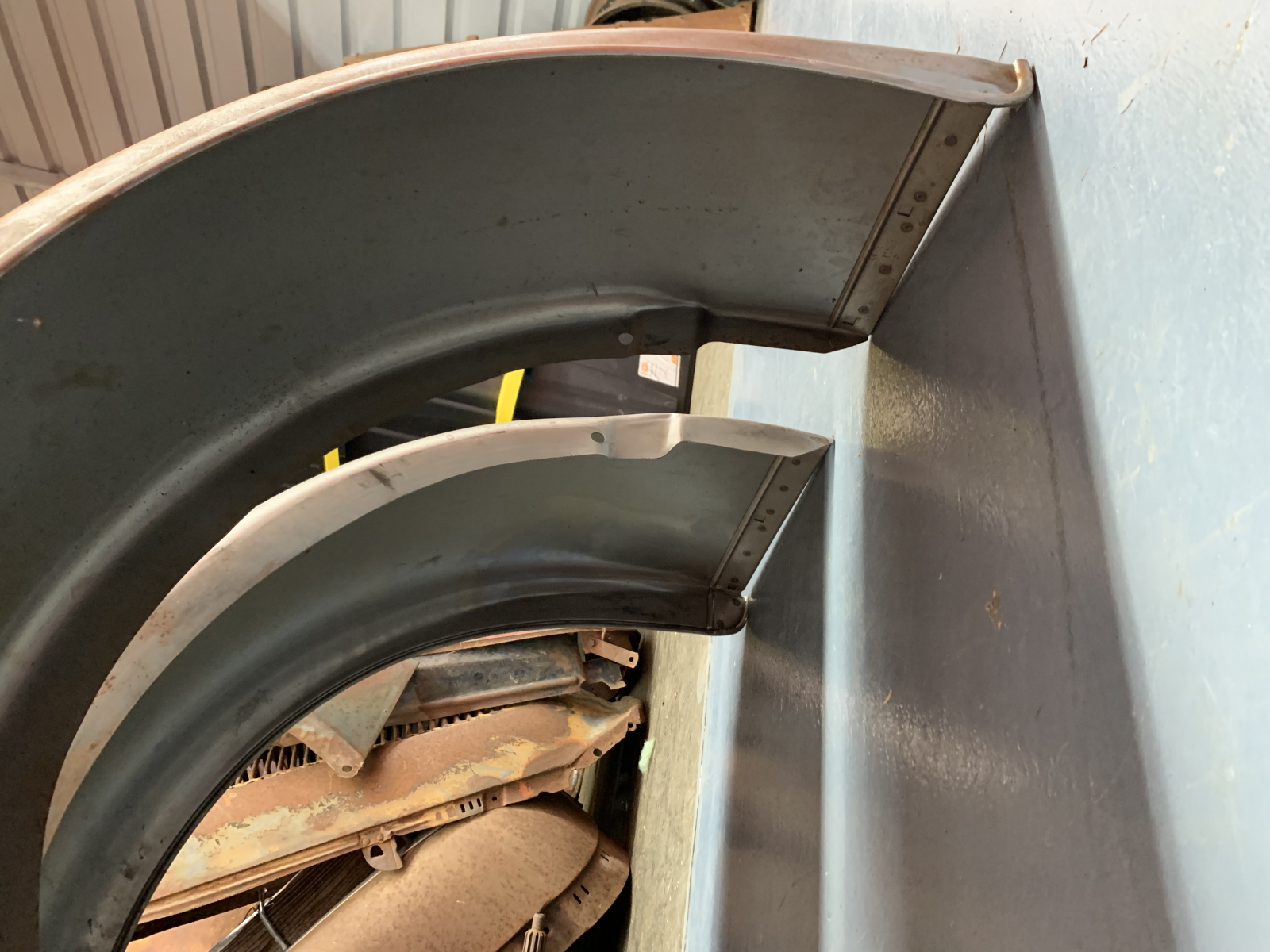

  12. That’s a great tip! THANKS!
    What did you do with the step/jog in the fender flange where it meets the frame at the running board?
    Hammer it in further up the flange?
    Cut it out and weld it in further up the flange?
    Pic from the net for reference.

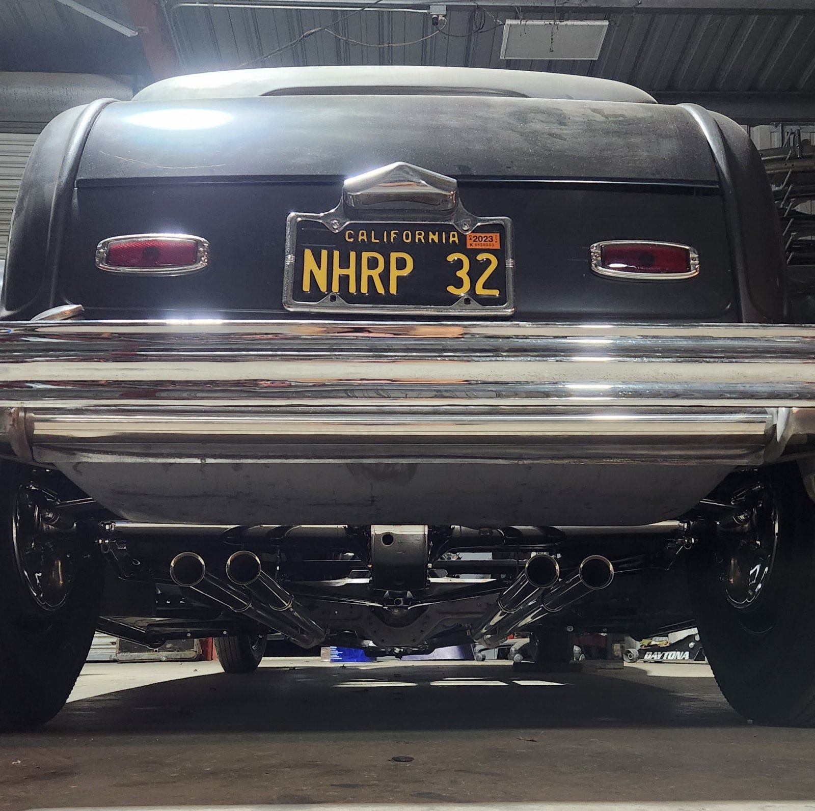

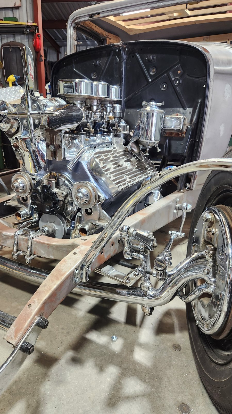

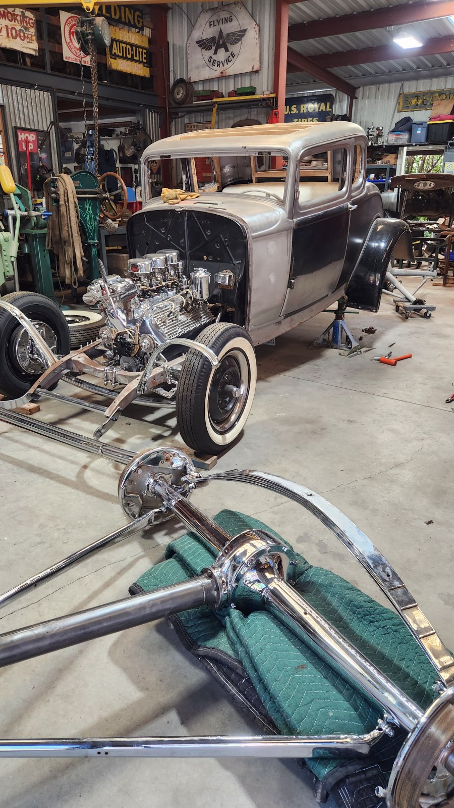

    I put the mockup engine back in the car to sort out the exhaust. I am headed towards some variation of these, 4 flared pipes out under the axle.
    I started working on some hangers
    And added a few shiny bits to the real engine. I just need to decide on the color and get the block painted.

  19. NealinCA
    Joined: Dec 12, 2001
    Posts: 3,389
    NealinCA

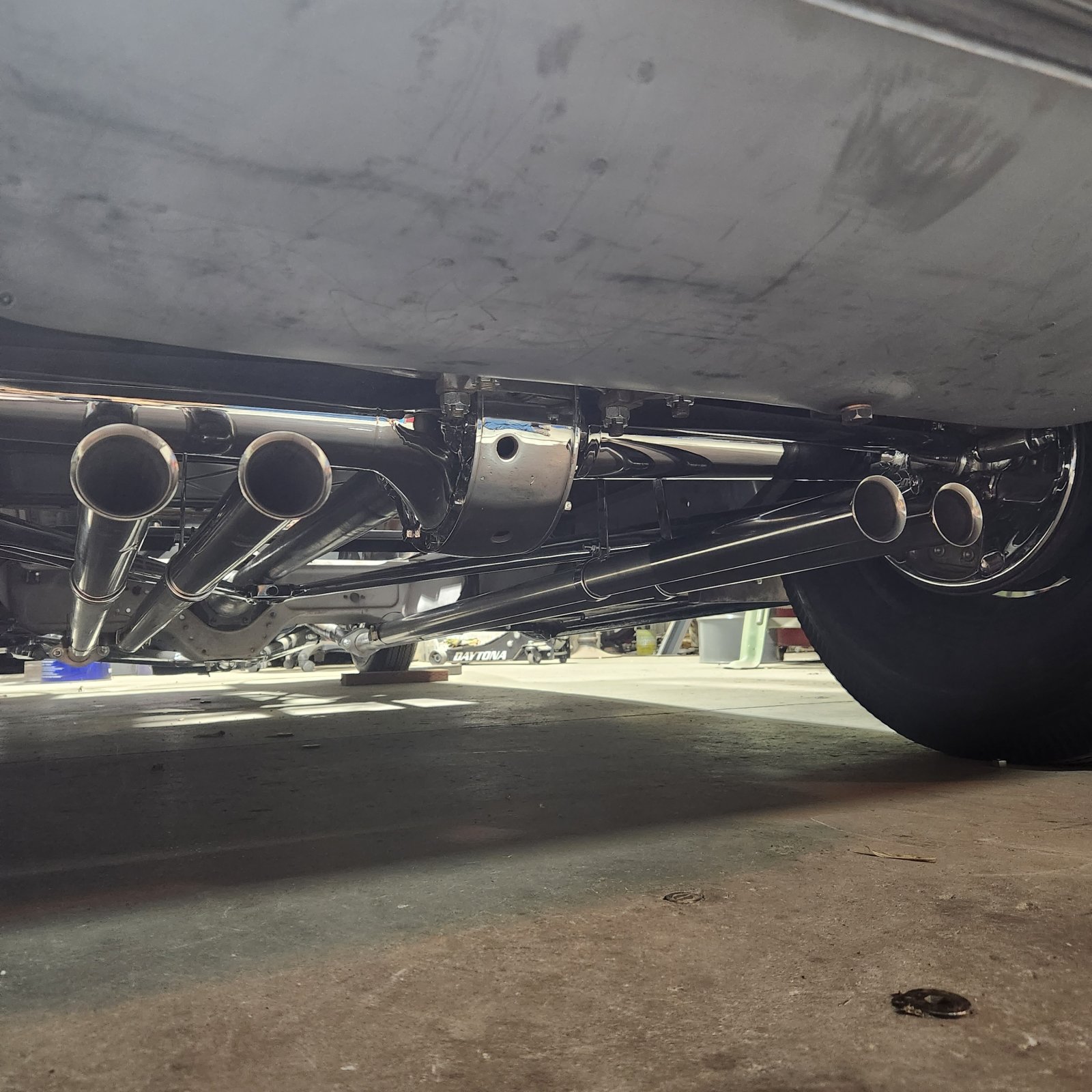

    A little update for the 5 guys following this build. I had some 1-3/4" tube bent up to extend the Red's Headers back past the K-member. This is the third set I have done like this, as I like having the flange further back. This worked especially well on this car, as I am running straight Scavenger Pipes.
    I slid the chrome rear end under. The torque tube will get plated, but I need to weld some tabs for an E-brake cable before that happens.
    The pipes split using this long radius U-bend after the header flange
    And here is the look I was after
    I am sure it's not for everyone, but I have had this idea in my mind for a long time, so happy to see it coming to life.

    Pipes look great! Did you make a Y for each side or did you keep one straight run and one branched off with the bend more like a h ?
    loving the updates :)
    Stogy likes this.
  24. NealinCA
    Posts: 3,389
    NealinCA
    The outer pipe is straight off the header, the inner pipe is attached in an "h" pattern.
    porkshop, Stogy and Tim like this.
