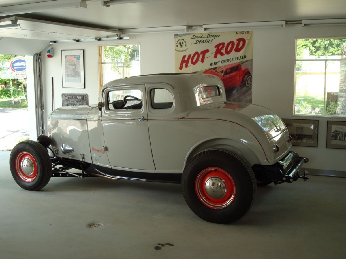

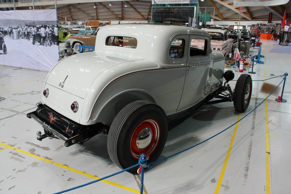

    I don´t remember how much I chopped 15y ago this 1932 5w. I slanted very littlerA-pillars after upper hinge.
    I like, if 5w coupe quarter window is after chopped more long than high.
    You find more chop rod oulu.JPG rod-7.jpg rod-14.jpg pics in my website: www.auliz.fi

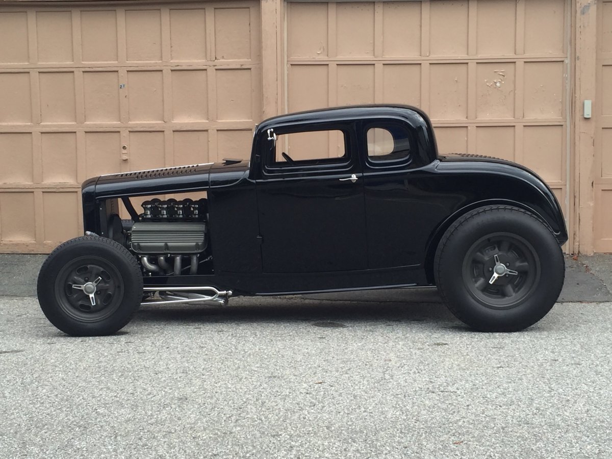

  8. alchemy
    Joined: Sep 27, 2002
    Posts: 22,827
    alchemy
    2020

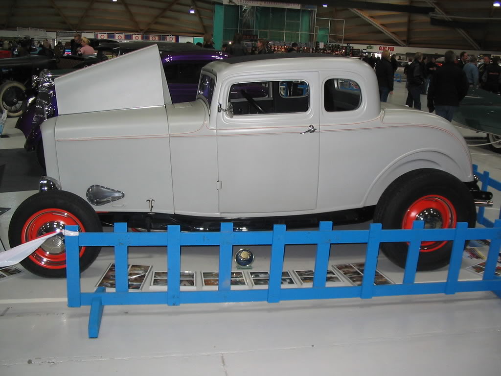

    1975 (probably hotrodded 20 years prior to this)
    This coupe was chopped a lifetime ago. It is currently gettin a little tuneup, but the chop is staying the same. It's cut about 5.5" straight down. Required splitting the top over the doors and the quarter windows.

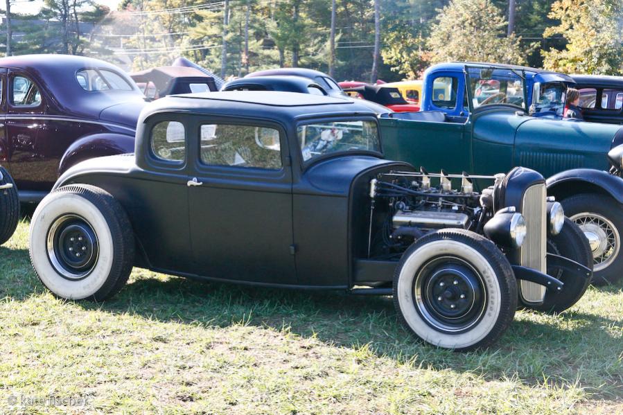

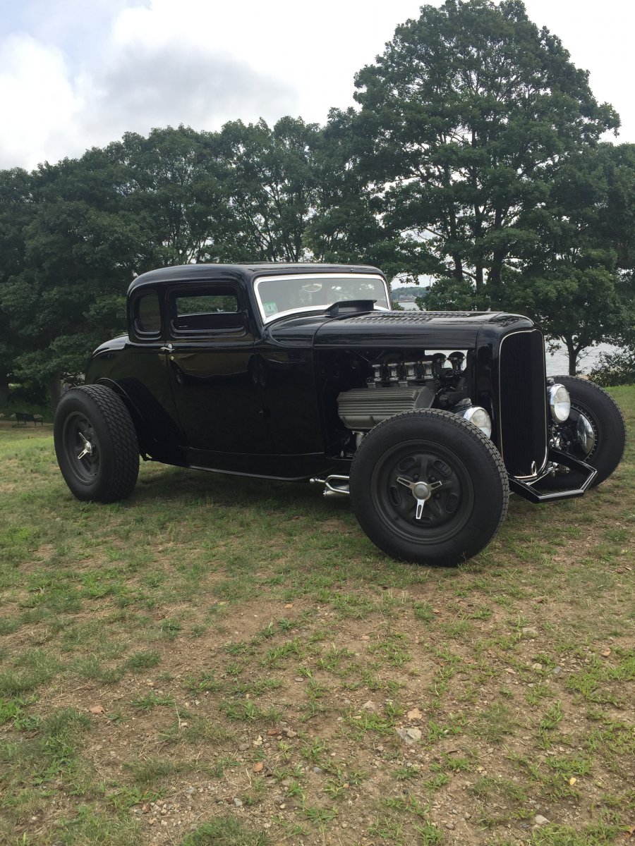

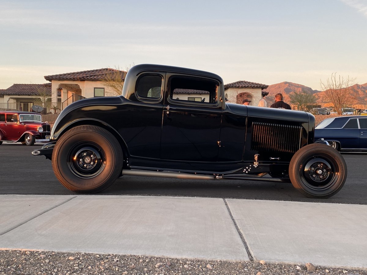

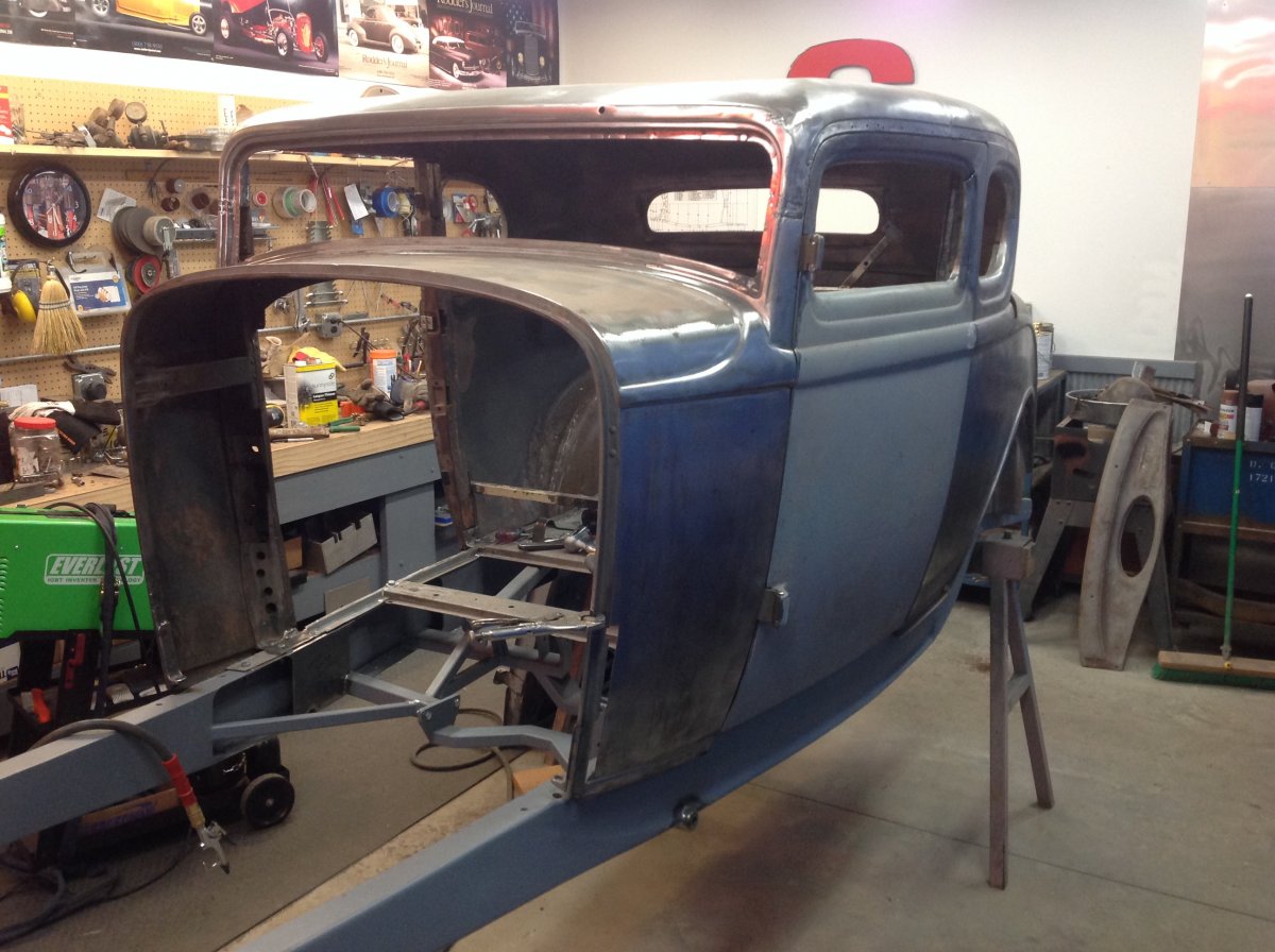

    I cut this one 4”. Laid the posts back. Required significant work on the forward upper door. Also moved the lower rear quarter of the quarter windows forward about 3/8”-1/2”. C5F03A47-6A2A-410C-912A-60090BF0BDF8.jpeg

  19. harpo1313
    Joined: Jan 4, 2008
    Posts: 2,589
    harpo1313
    from wareham,ma
    My bad Clem , and you are correct , the channel was five , the chop three and a half.

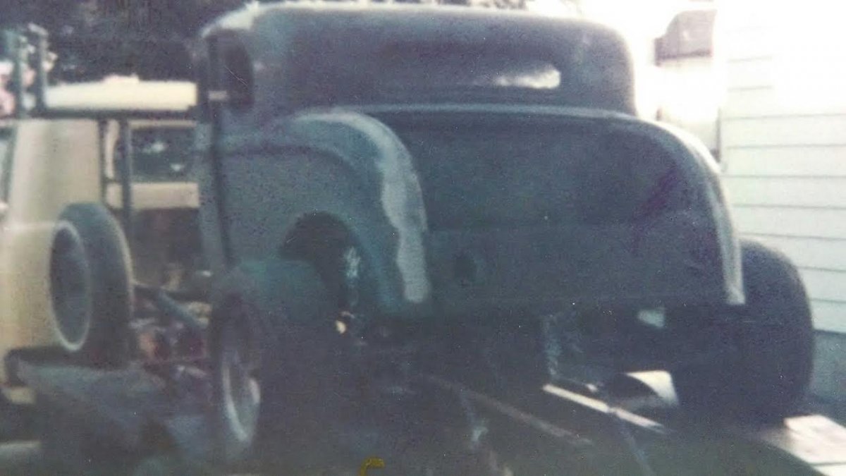

    Here's 32 my friend drug home. Can't find a completed pic right now! [​IMG][​IMG]
  24. 51 mercules
    Joined: Nov 29, 2008
    Posts: 4,495
    51 mercules
    Here we go! [​IMG]

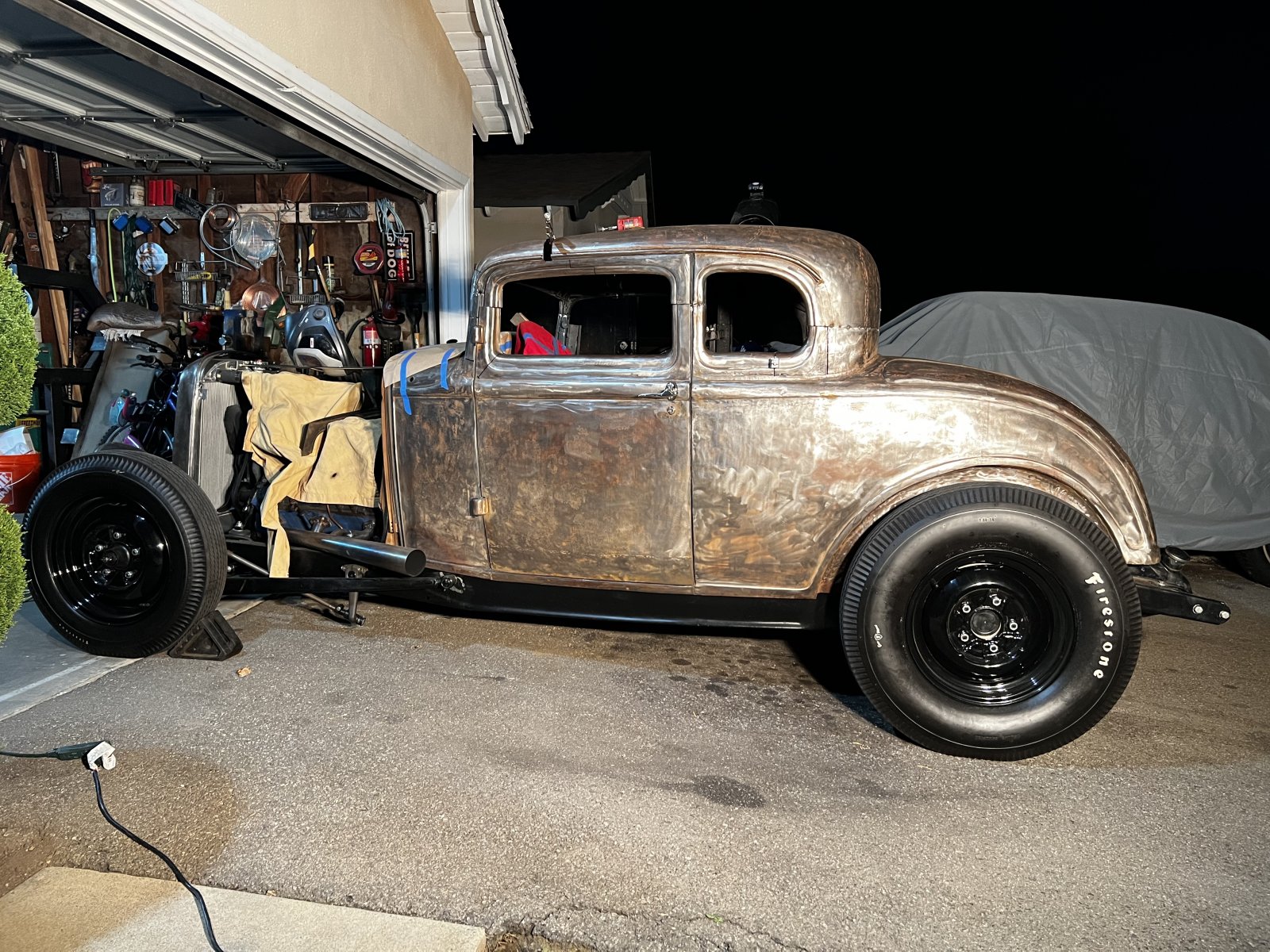

    42F2648C-DCCD-45EE-8CEF-FA969FF47C7E.jpeg C6559ABD-F9ED-454C-829C-4B6399945C0A.jpeg 4.5”, leaned the posts back, no stretch.

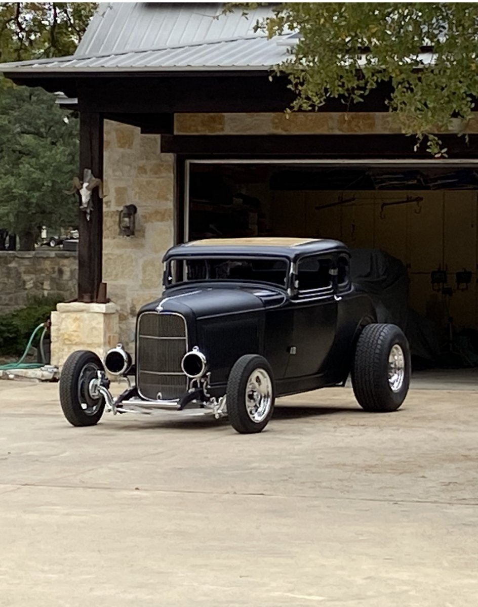

  27. CrazyDaddy
    Joined: Mar 30, 2002
    Posts: 671
    CrazyDaddy
    from Austin TX
    This chop is perfect !

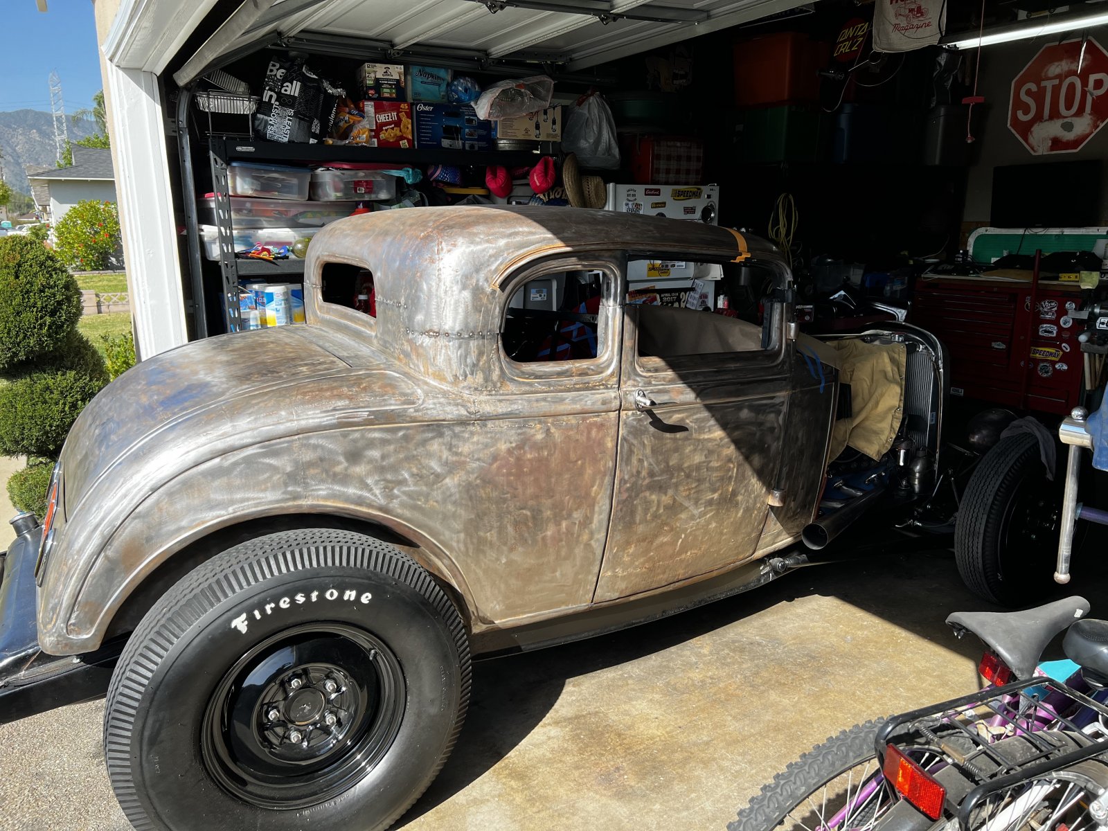

    Budweiser
    from california

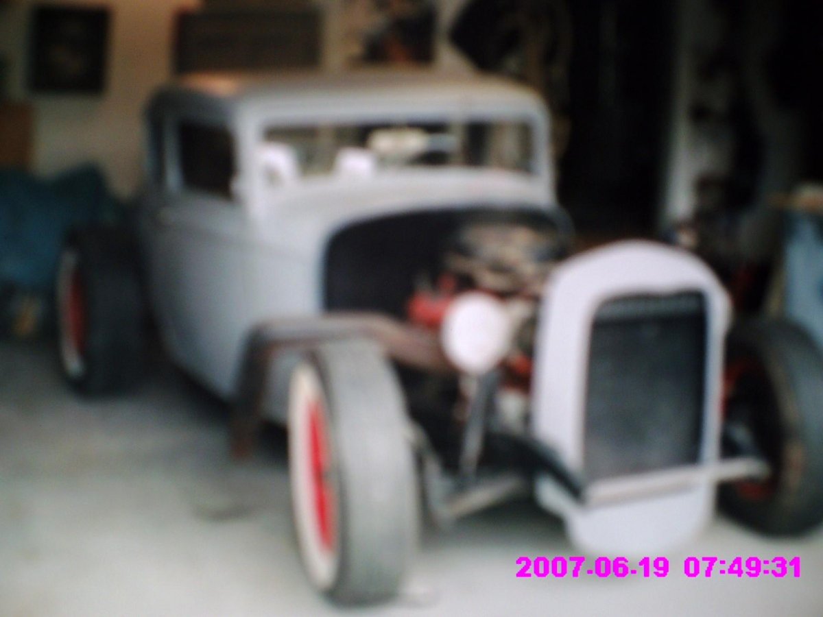

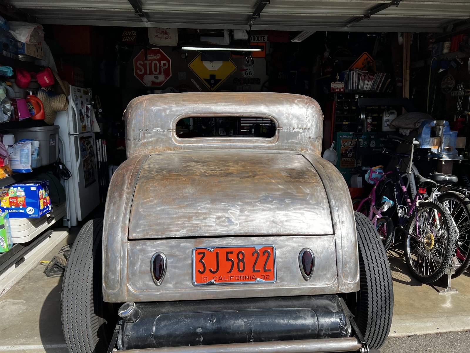

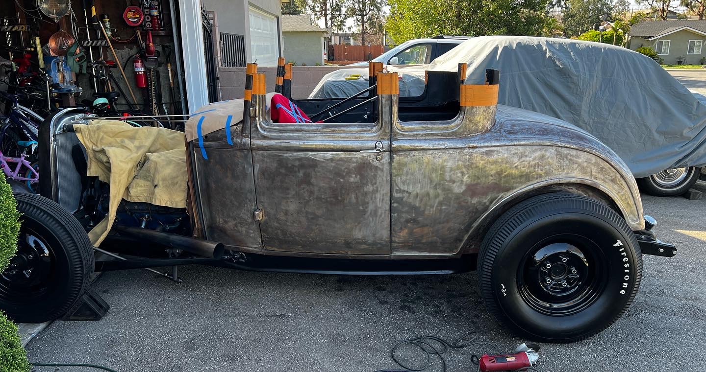

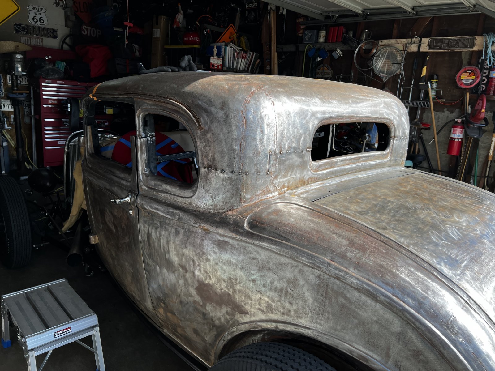

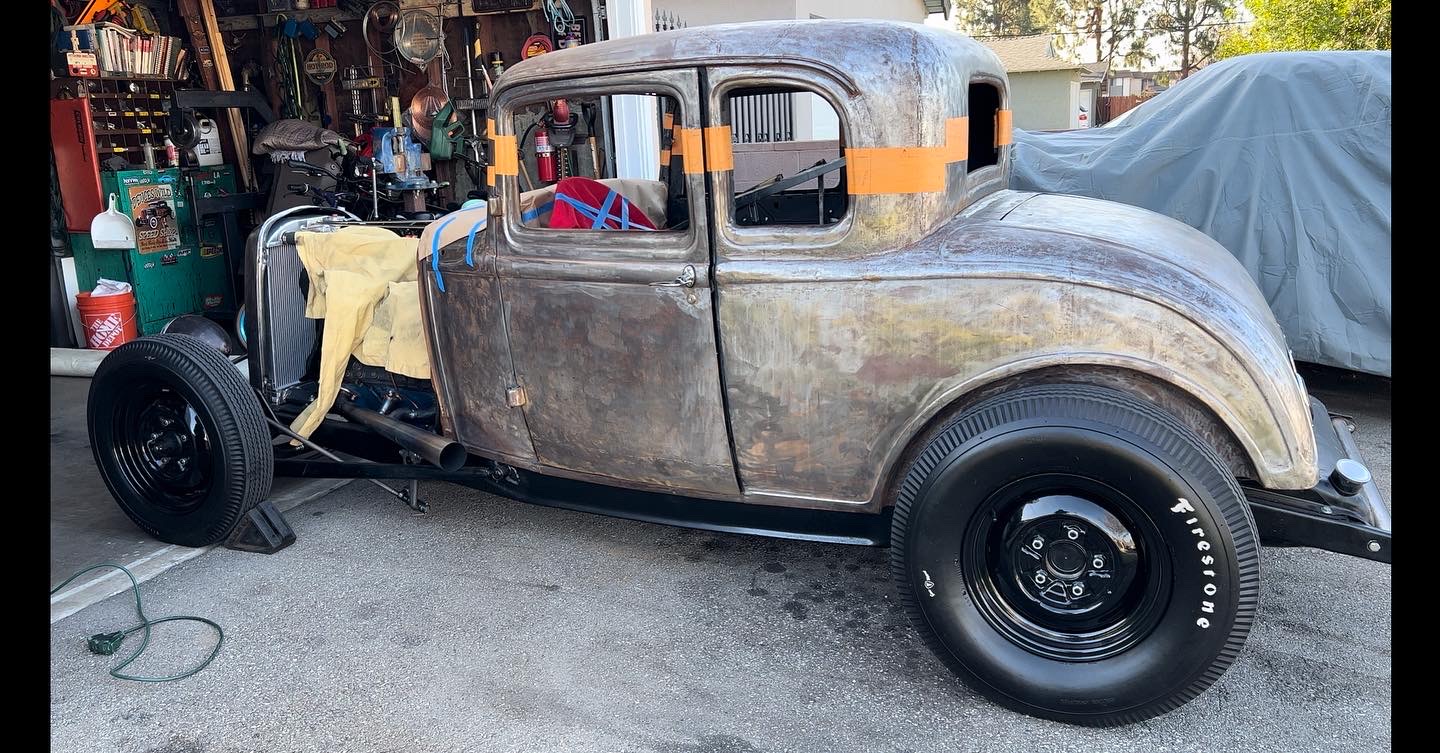

    Here’s my 32 five window I’ve started to chop. I took out four inches all the way around. Moved the top roof and inch to meet the pillars. My First chop , the body isn’t that great so decided to go all out and chop it up. It probably won’t get a paint job in my lifetime way too much metal work needed for that. 5014F460-0A56-476A-94CB-E252EEC65C32.jpeg
