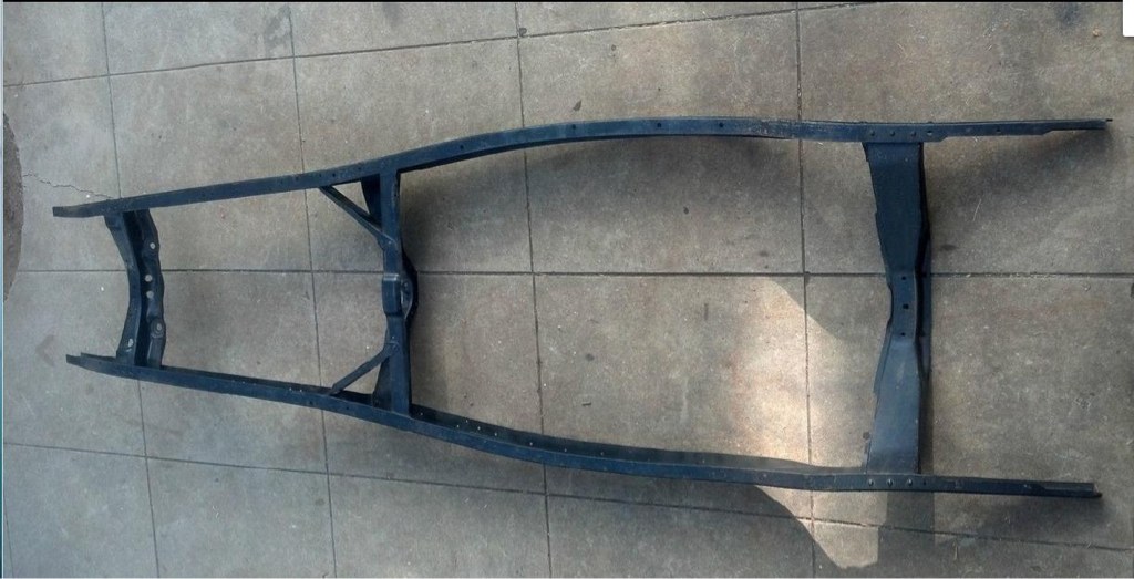

    That sure looks like an original frame from here. But note that the rear has been kicked up, the frame horns are missing from both ends, and the front may even be pinched. That's in addition to the weird boxing plates and mounts that may or may not work with your application. Lots of opportunity for things to not fit right on your car. If you are trying to put a more original fit ch***is under your body, I'd look for a different frame.
  2. thirtytoo
    Joined: Jul 10, 2014
    Posts: 30
    thirtytoo
    Yeah, been looking for something I can afford to get me closer to being on the road.. This being the closest so far..
    Im only interested in the real deal Henry Ford body and frame.. I want to be able to fully enjoy it when its done and not have to worry about anything down the road.
    So like 29AVEE8 said hopefully be able to ***le it based on an orig VIN on orig frame or go the Specialty Constructed route.

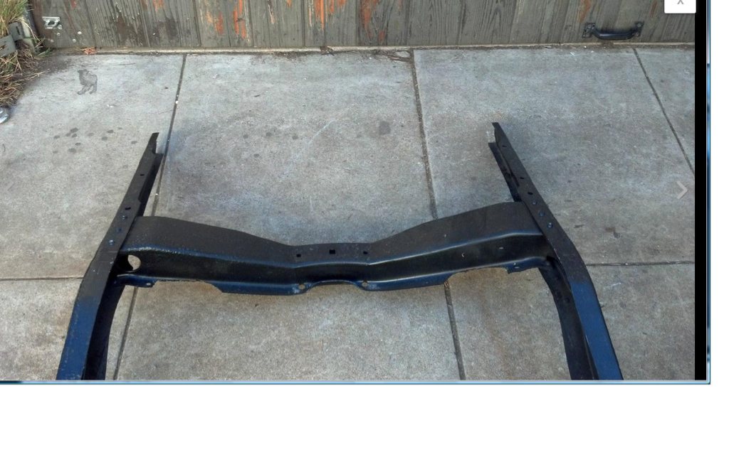

    Found what looks much better.
    Seller says:

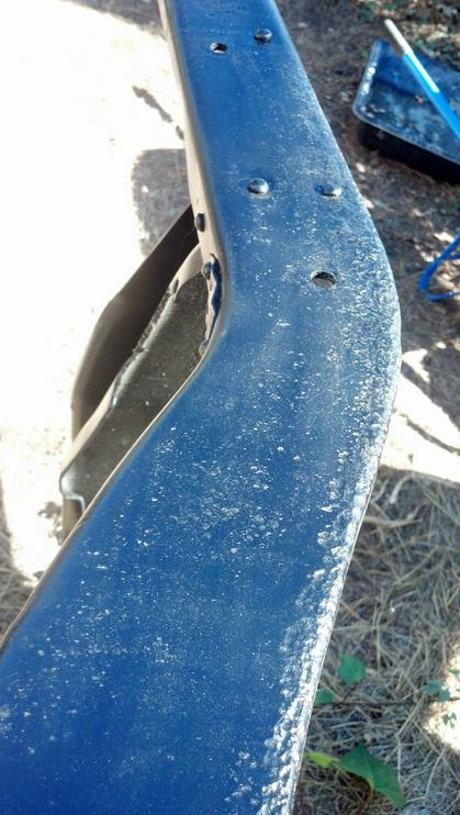

    "Original 1932 Ford Frame (late). Was V frame. Front crossmember bolted in. K and rear cross member are riveted. K has ben cut on left leg and on vertical back (shown in photos). Rear cross member ha common cutting (likely for dual exhaust). Frame has some sight pitting on inside/ top of p***enger side rail - at junction with rear cross member. Rear cross member pitted in same area. This frame will clean up nicely. Has excellent sides and reveal."
  4. alchemy
    Joined: Sep 27, 2002
    Posts: 22,710
    alchemy
    That looks like a great frame. A flathead and banjo rear would be great in that frame. If you want to use a more modern drivetrain, you could still make a lot of money back if you carefully remove the center crossmember and sell it to a traditionalist.

    What's your view on strengthening the frame if I keep my 351W, C4 trans and 8 inch rear in this..?
    I ***ume box the frame rails, remove the existing crossmember and maybe use a center X-member would be strong enough.

    If you are going to not use an old Ford transmission, don't waste money on the original frame with original center crossmember. Look further for a less complete frame that you won't be spending as much money for, and install a tube X in it. That center crossmember alone is adding $500 to the price of that stock frame.
