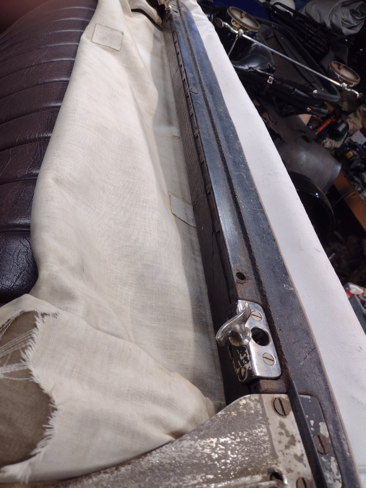

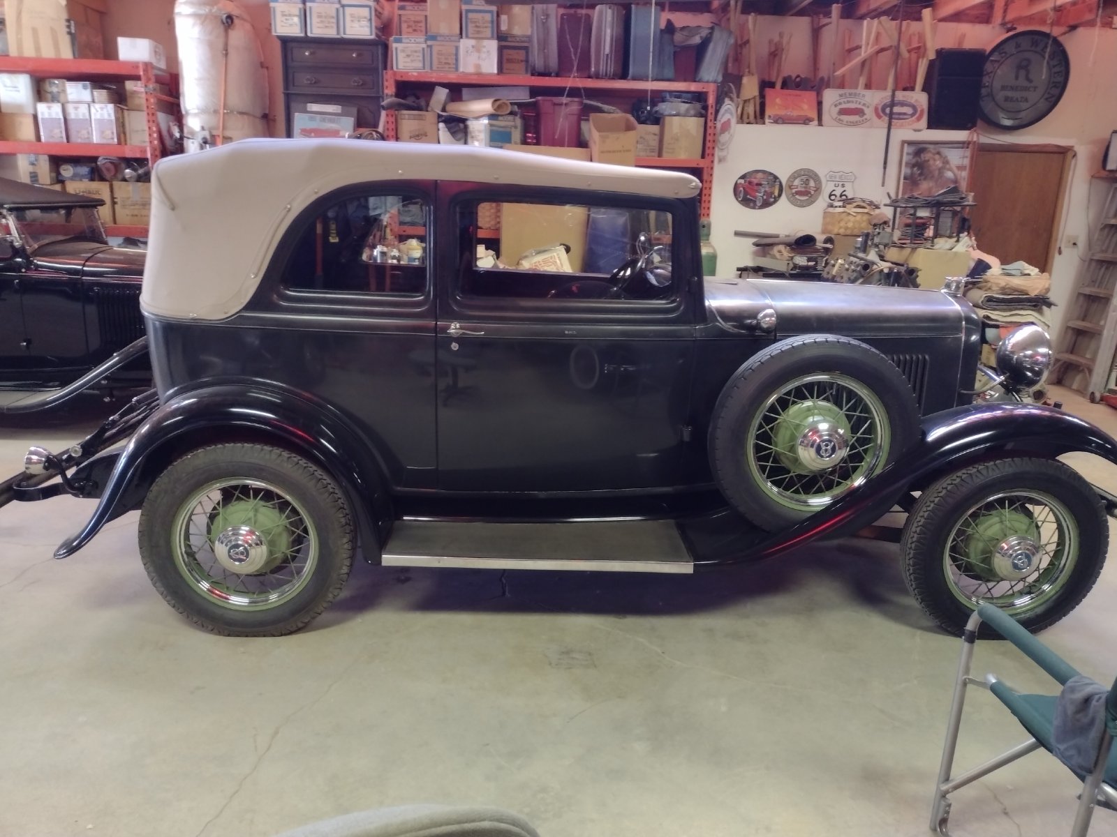

    It's going to look something like this
    IMG_20230613_115036455.jpg bit this is a late '31 but I suspect it is similar. The picture in the Wescot catalogue make me think so. There are big pins on the windshield post and they fit into the sockets in the top header. The thumb screw wingnut tightens to hold it down. @Hamtown Al is a '32. I happen to know where there is a B400 of you need more information, let me know as it is a nice original car. IMG_20230607_123143589.jpg

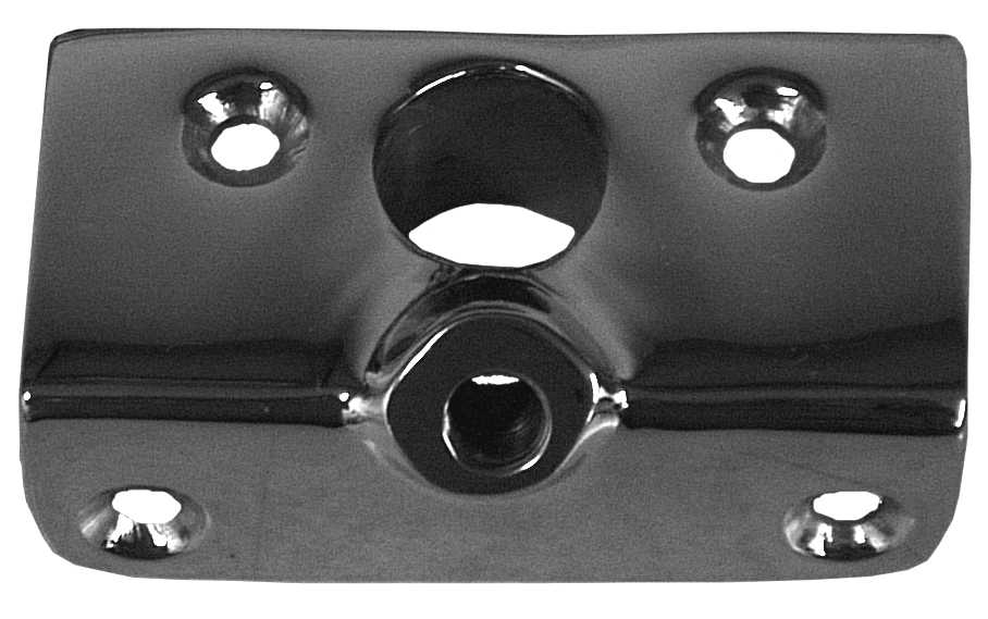

    As I understand your shopping list:
    1. Latches
    No latch but rather a socket that fits over a dowel on the windshield and locks using a thumbscrew. We make the socket and sell thumbscrews that will work. I am out of stock but have a bunch of casting to machine and send to the plater. Per original Ford parts book the socket fits 1931-32 Cabriolet, and the A-400 and B-400.
    2. The front arm on the top irons attaches directly to the wood header. See winduptoy's picture. If you are missing the arm contact me, I have an original set of irons for patterns and will expedite making that arm.
    3. Header metal cover. You can see it in winduptoy's picture. Oak Bows in Pennsylvania might have them, otherwise not reproduced at this time.
    4. Bumpers between header and windshield. There were three. You can see two and the hole for the third in winduptoy's photo. Note there were two different ones used. The early style (which winduptoy's looks to be) has a smaller hole and the bumper snaps into the hole and compresses against the wood (also used on 1931 68-C and A-400). The late style is larger and uses a center screw to hold it in place with the hole in the cover big enough to clear. Both are reproduced and we have them.
    5. Seal. There was a sponge seal between the header and windshield, not specifically reproduced so find a weatherstrip that looks to fit.
