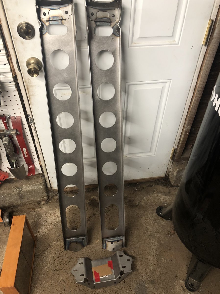

    Sorry Andy I hadn't picked up on your comment. I don't see this as finding fault at all. If I had the last ch***is out of the fixture for a longer period before it was collected, and the first set of fitting prototype braces fitted I would have enjoyed collecting some for of data to back up the concept.
    On that note, I have 2 brace kits back in stock. Please see the forsale section for further info.
    [​IMG]14 by joe curtis, on Flickr
    [​IMG]9 by joe curtis, on Flickr
    [​IMG]1 by joe curtis, on Flickr
    alfin32, brEad, loudbang and 2 others like this.

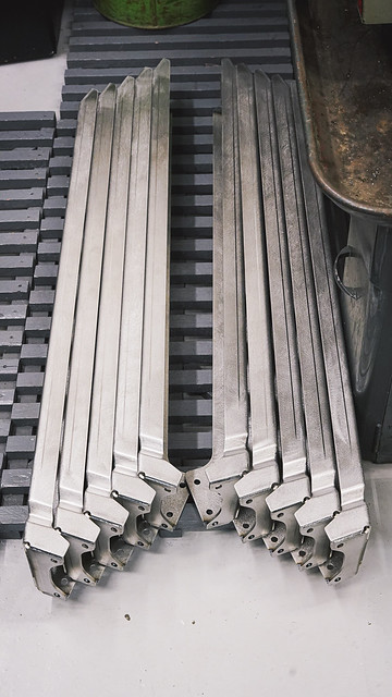

    Another batch of brace kits complete- 2 sets left ready to ship. We are shipping up until the 24th, then again from the 27th on December.

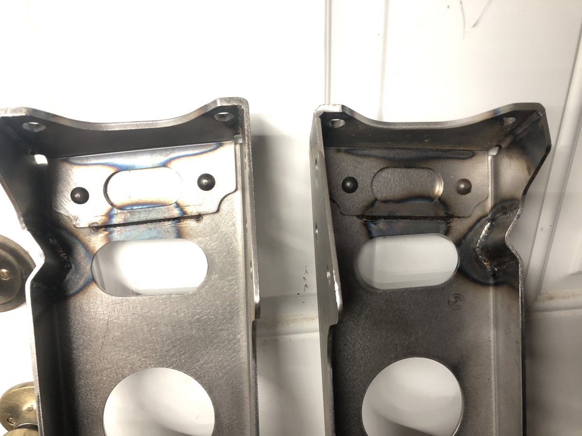

    I bought a set of ch***is braces from Joe. They are first rate. My rod is a 30 roadster on a 32 ch***is; repo rails and original crossmembers. I built to replicate what might have been a typical build in the 50's with no boxing and drove it like that for 10 years. I was sick and tired of the "roadster door pinch" and the rattles and banging I got. I installed the rails with the body in place. The heap is still not completely back together but I expect great things. Jacking the the ch***is at a rear corner shows the doors stay in alignment and the gaps stay as they should. Amazing the rigidity they added. As mentioned they were a bit north of $500....but to try and duplicate for less.

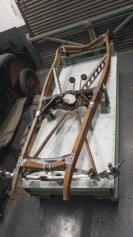

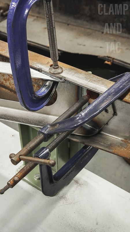

    Right here we go again then, we just completed another ch***is build so get ready for a the photo overload. A few small changes with this build, the customer wanted all members TIG welded in and the rivets to be set in also, best of both worlds in my opinion.

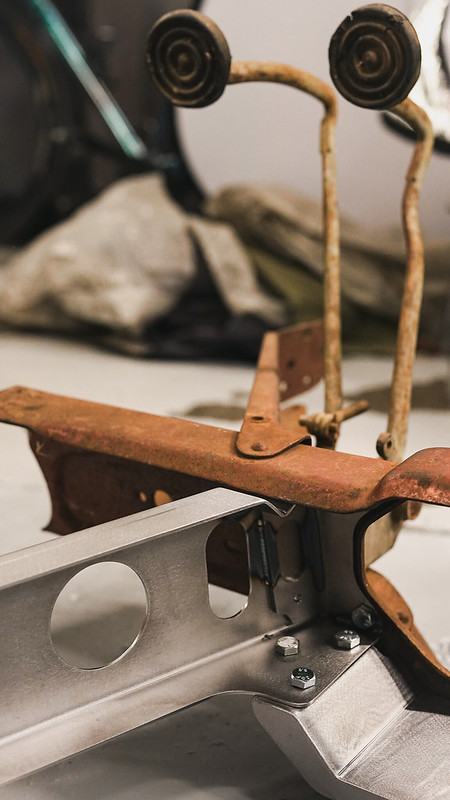

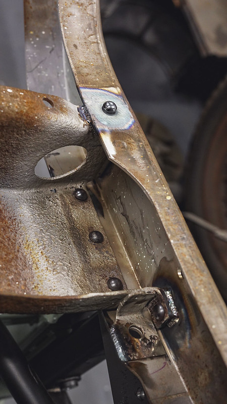

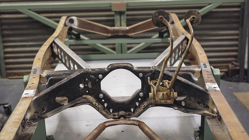

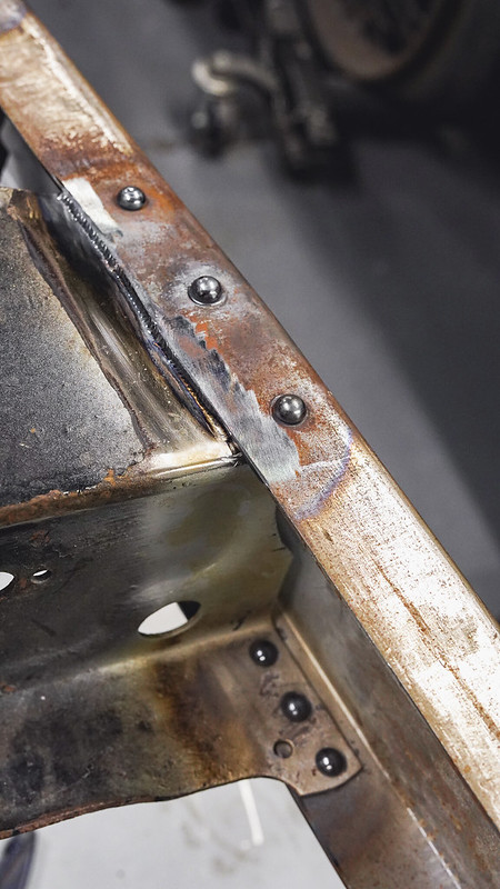

    As the ch***is supplied come bolted together and primed under the members, first up was a full brake down in order to get some clean metal before going back together ready for welding.
    [​IMG]DSC00936 by joe curtis, on Flickr
    [​IMG]DSC00937 by joe curtis, on Flickr
    [​IMG]DSC00933
    Back together for welding
    [​IMG]DSC00938 by joe curtis, on Flickr
    [​IMG]DSC00941 by joe curtis, on Flickr
    [​IMG]DSC00943 by joe curtis, on Flickr
    [​IMG]DSC00944 by joe curtis, on Flickr
    [​IMG]DSC00954 by joe curtis, on Flickr
    [​IMG]DSC00948 by joe curtis, on Flickr
    [​IMG]DSC00951 by joe curtis, on Flickr
    [​IMG]DSC00952 by joe curtis, on Flickr
    [​IMG]17 by joe curtis, on Flickr
    [​IMG]20 by joe curtis, on Flickr

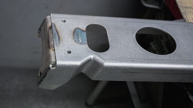

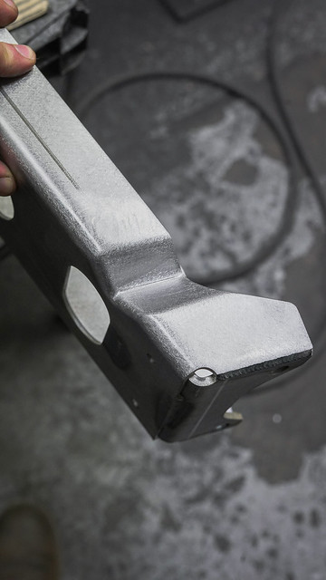

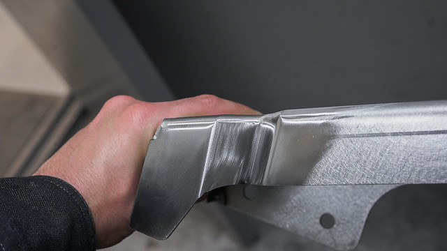

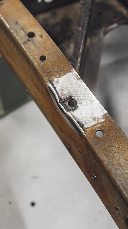

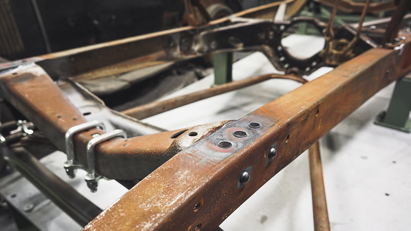

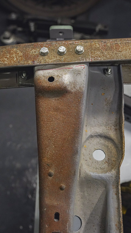

    The countersunk rivets we set in the K top to grind off, how ever with front member I wanted to try get a sweet spot to drive the rivet in flush and leave as is. Really happy with the results
    [​IMG]15 by joe curtis, on Flickr
    [​IMG]5 by joe curtis, on Flickr

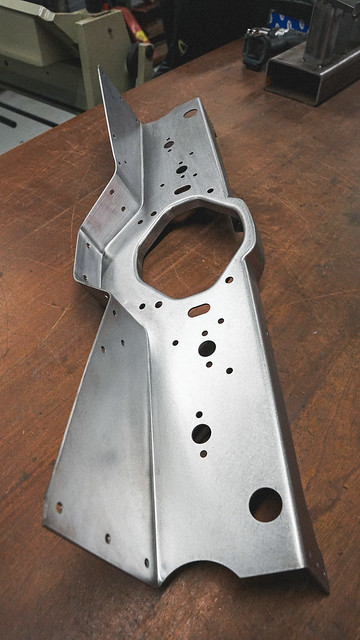

    Onto the next addition, the customer wanted firewall dimples into the new rails. Luckily enough I had access to a stock ch***is to measure and a few guys around the world on instagram were kind enough to send over reference material so I could compare a few ch***is. I knocked up some press tooling and set about seeing what we could do, everything was heated in situ and pressed, no welding or blending. Heres the results
    [​IMG]2 by joe curtis, on Flickr
    [​IMG]4 by joe curtis, on Flickr

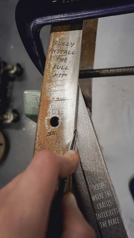

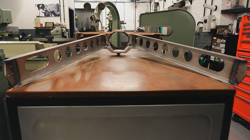

    With having a ch***is on hand to install a ch***is brace kit, I thought it would be ideal timing to put together some images to help visually with the use of the shim kit thats included in the package. I thought posting the guide here maybe handy to all of you cracking guys who have purchased a kit, to all of you thanks m***ively for your support.
    JoeFR
    [​IMG]PSX_20210309_200408 by joe curtis, on Flickr
    [​IMG]PSX_20210309_201903 by joe curtis, on Flickr
    [​IMG]PSX_20210309_202829 by joe curtis, on Flickr
    [​IMG]Project - Drawing 14408550535623822182 by joe curtis, on Flickr
    [​IMG]PSX_20210309_212639 by joe curtis, on Flickr
    [​IMG]PSX_20210310_220614 by joe curtis, on Flickr
    [​IMG]PSX_20210310_221037 by joe curtis, on Flickr

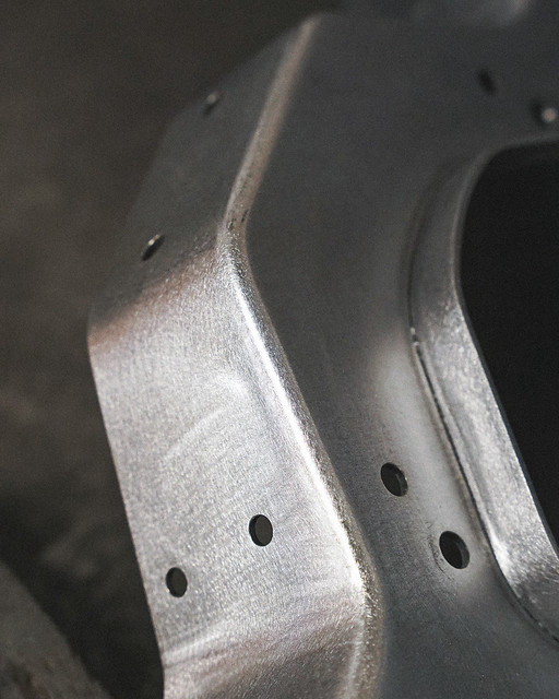

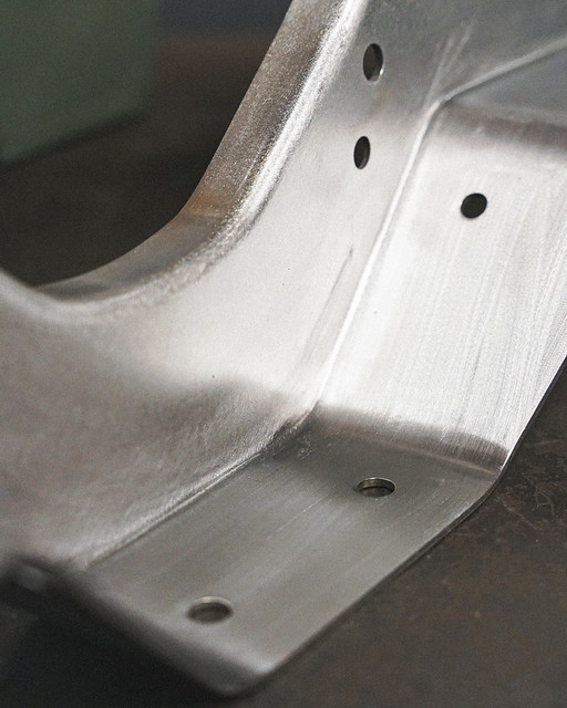

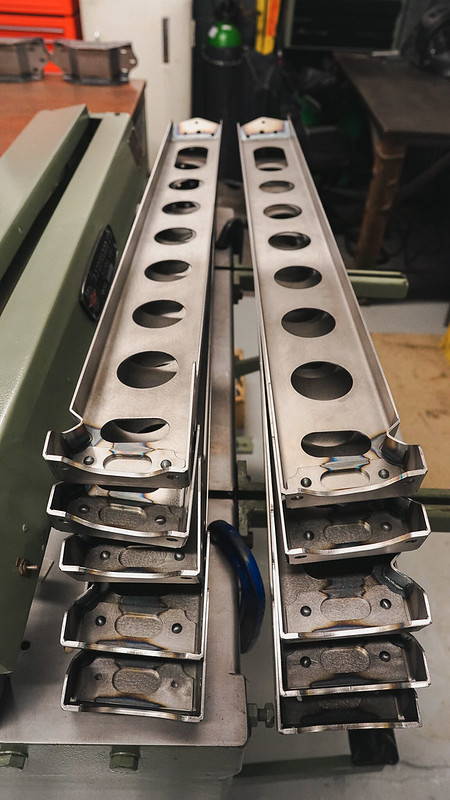

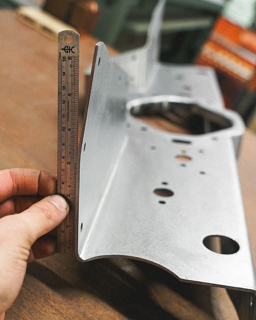

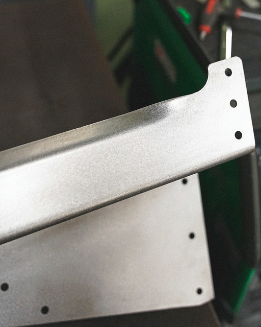

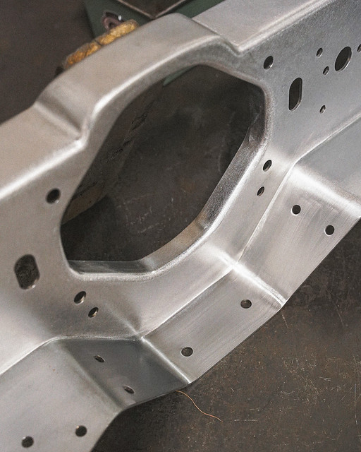

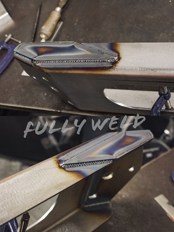

    Another batch of braces done, a few have asked what consumables I have used on the clean up.. I tried to take photos of each step but the lighting isn't great in my dirty room, it seems I blocked half the light out when taking photos. I have this end of the brace down to 4 minutes of clean up, total of around 7 mins total per "leg" which I do in stages.
    This weld in relief allows the braces to go in with out having to bend the return fold on the K up out of the way. Not a huge visual but they just look nice with the welds blended. Stack the weld in as much as I can to get enough filler on to blend it back out evenly.
    [​IMG]3 by joe curtis, on Flickr
    Roughed out with 80 grit
    [​IMG]6 by joe curtis, on Flickr
    smoothed out with a conditioning disc, not cheap but give great results. Pull up your faces night and tight, leaving all your sharp edges on still. Loads of grades to chose from- used a lot for blending stainless. Hook back disc, super speedy to change your grades on the fly. Pretty sure this is a medium grade.
    [​IMG]7 by joe curtis, on Flickr
    [​IMG]8 by joe curtis, on Flickr
    80 grit DA sanded, just knock of the edges to a full blend. Job done.
    [​IMG]DSC01392 by joe curtis, on Flickr
    [​IMG]DSC01394 by joe curtis, on Flickr
    Same steps wit the tail end of the braes, you don't see this end once installed. But that's no reason not to clean them up the best we can.
    [​IMG]25 by joe curtis, on Flickr
    repeat, repeat, repeat
    [​IMG]23 by joe curtis, on Flickr
    [​IMG]19 by joe curtis, on Flickr
    [​IMG]DSC01399 by joe curtis, on Flickr
    [​IMG]24 by joe curtis, on Flickr
    [​IMG]21 by joe curtis, on Flickr
    More photos on my flickR account, loads of non-Hamb posted work on my IG too for those who are interested.

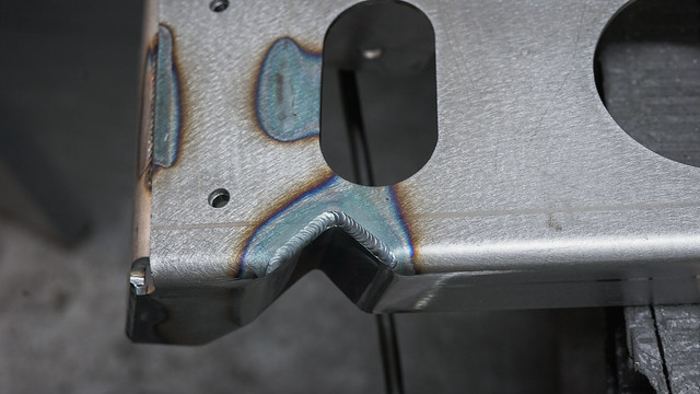

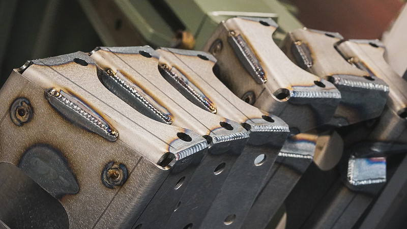

    Well it's been a while, m***ively far behind with updating this with the ch***is builds that have come out of the shop. Here's what turned into a rather long winded project- full ch***is was 95% finished back in august 2022. Anyway big team effort getting this ball rolling.
    Back story with this was Jamie scanned the original ch***is we made the fixture around, and started playing on cad as and when, we had a prototype cut and short put to one side due to the effort involved in some folding, the idea was to have these as a production item with the leg brace kits. The shape in these from factory is frankly mad. What you see here is V2, (V1 got cut up and wanton into an A ch***is, to make the AV8 kits - which I'm still to fully finish too)
    In the end this become a welding and blending learning curve for me, with 85% of the parts folded up on a cic press brake, there was a lot of unknowns left to stumble over when sticking it in a set of rails. A fair bit of handing cutting of parts left, t******* bits to fit and taking notes what we wanted to change. Enough rambles, here's a new as close to factory K member we could produce at the time.
