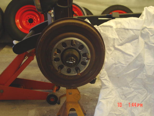

  3. What's going on with the 11" (or even 10") looking backing plates in the Buick drums ?
    The wheel cyl. is so far down they look like they could be 9" shoes ?
    You using the drum as a cover only ?

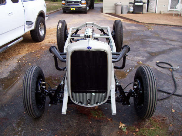

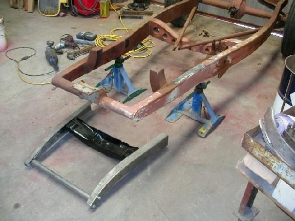

    I've posted these a few times...

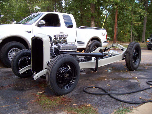

    That thing is sweet Kilroy!!, is that a 36 x-member?

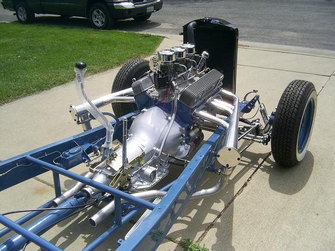

    Mine...

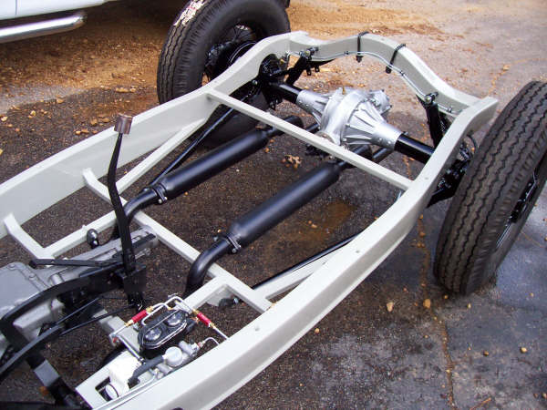

    Thanks==the rear has a model a crossmember/T spring. the front crossmember is almost flat with a rev.eye spring mounted behind a 4"dropped axle--now I just got to figure our how to mount my steering-I'm thinking about going above the frame instead of below it

    The x-member is 40 Ford... I worked it so I can use use 39 pedals with no modification and the trans mount is stock just moved back a bit.
    Since those pics I redid the rear sweep...

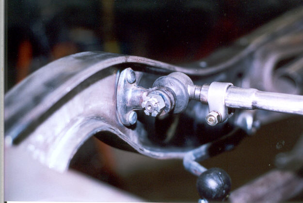

    HotRodDrummer,
    What is this little piece? Well, I know what it is now but what was it originally?
    Awesome detail.

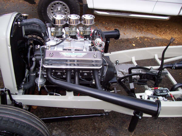

    here is another pic with alittle more progress. IMHO This is how I like to see an original ch***is set-up.

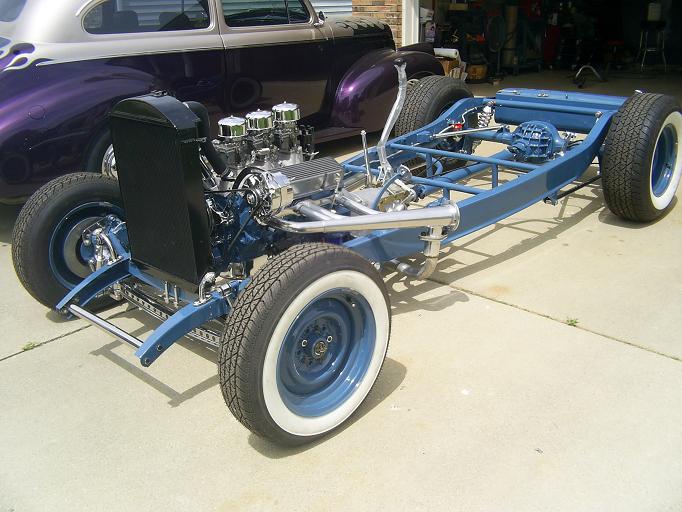

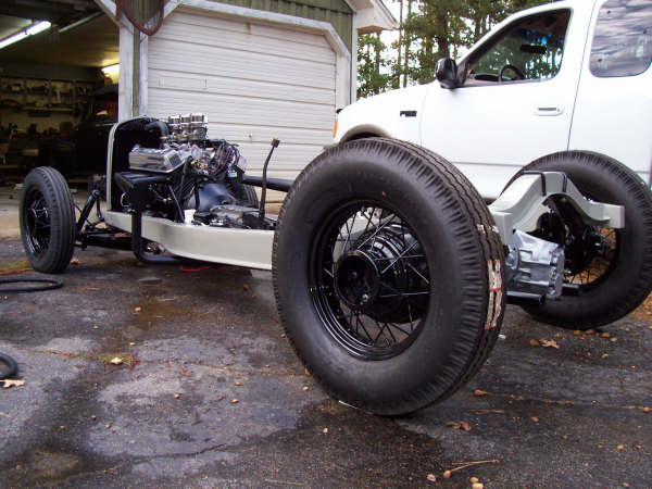

    Here is some of mine.

    Wow. I like it. What'll sit on it?

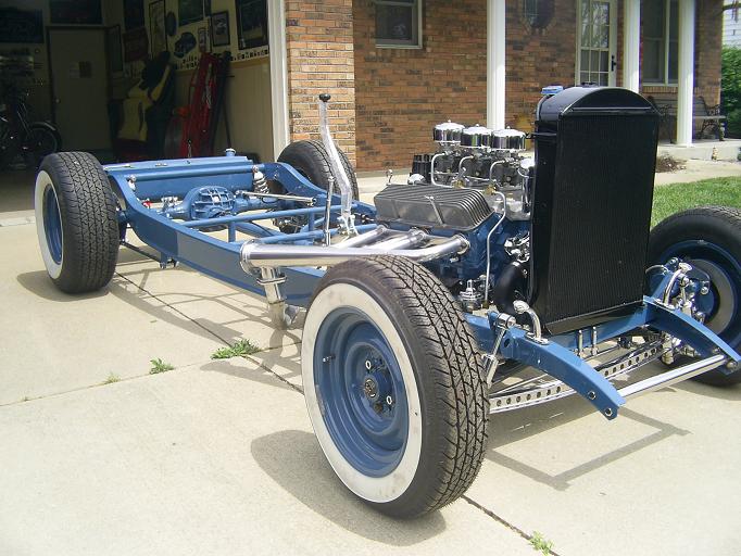

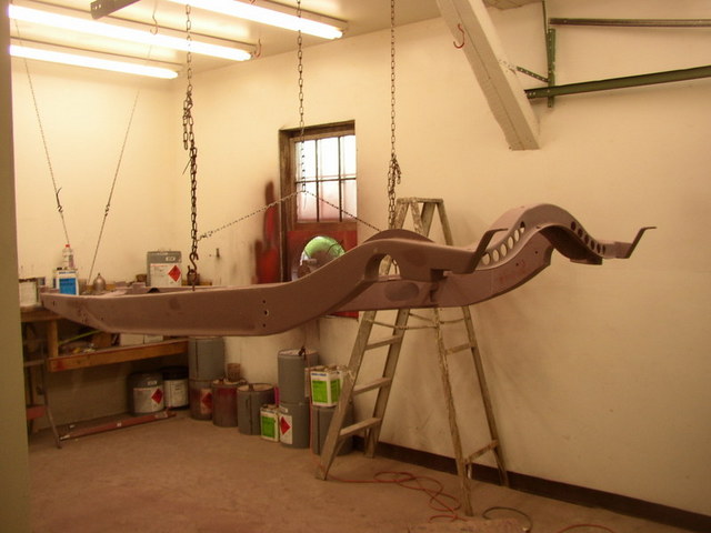

    I love to look at deuce frames, thinking of building another 32 frame just to have around! Here's the only one I have of the ch***is under my vicky.
