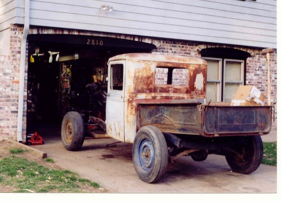

  15. My Friend has that 39 Coupe here in New Zealand, just been through a rebuild after having it on the road as found for sometime, Running a Y Block. I thought I recognised your pick up from his photos but wasnt sure. He calls it the San Lorenzo Coupe

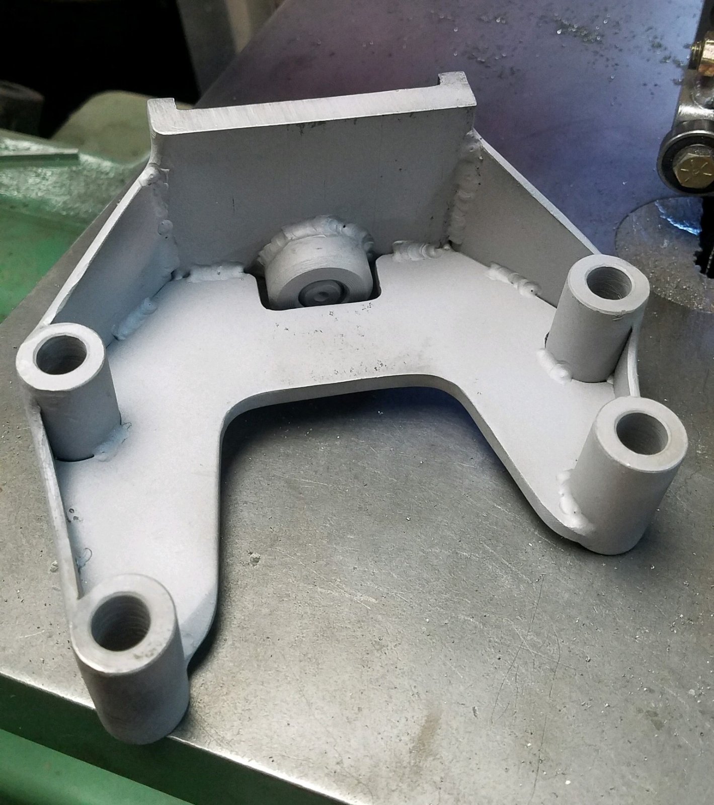

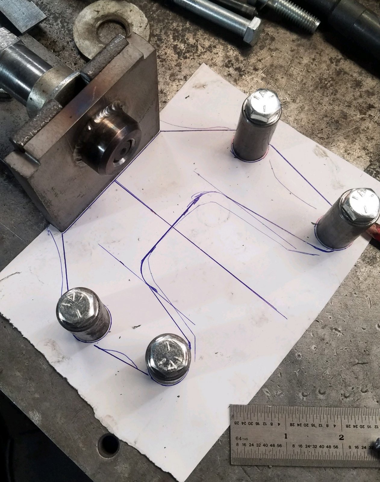

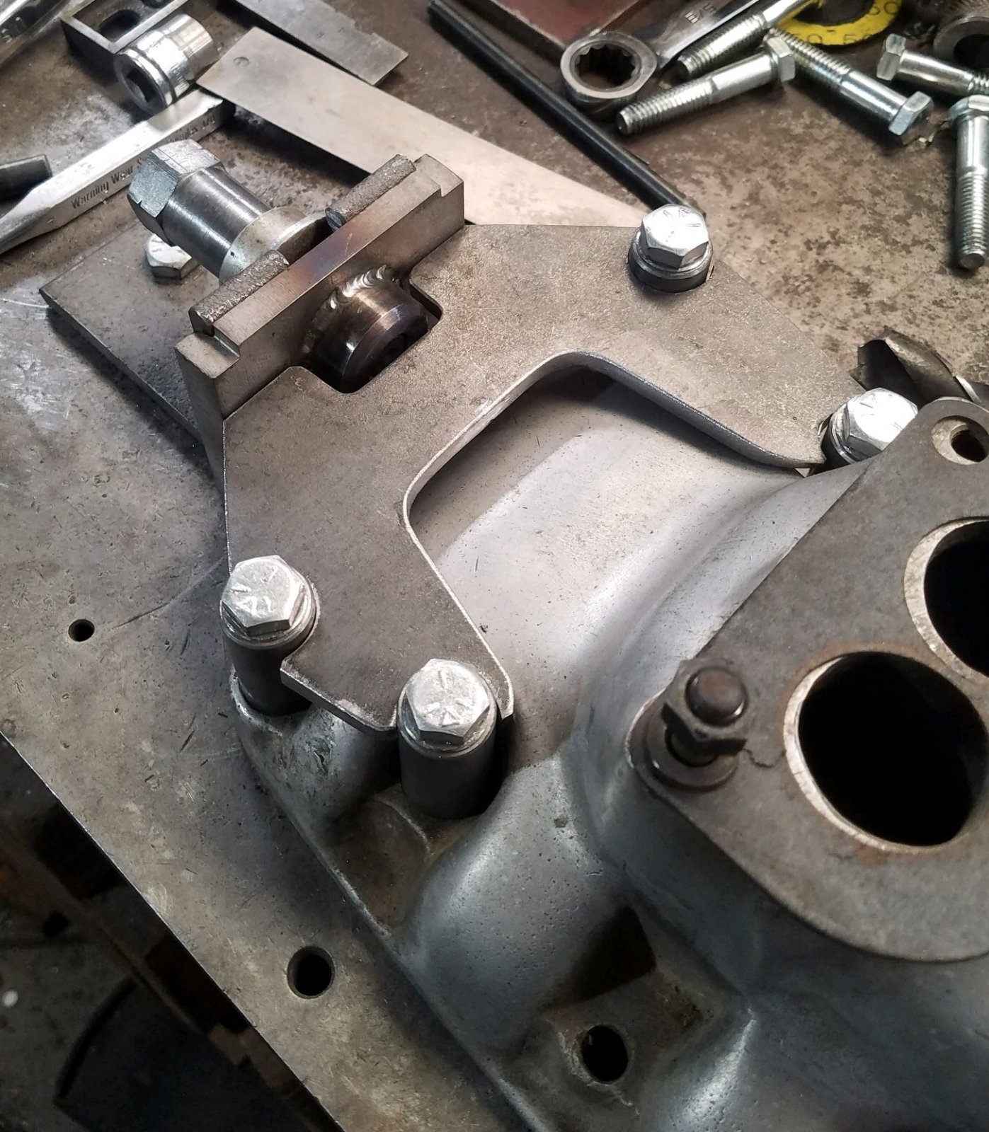

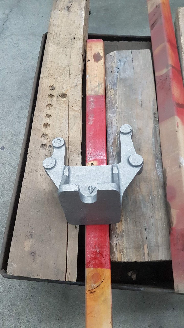

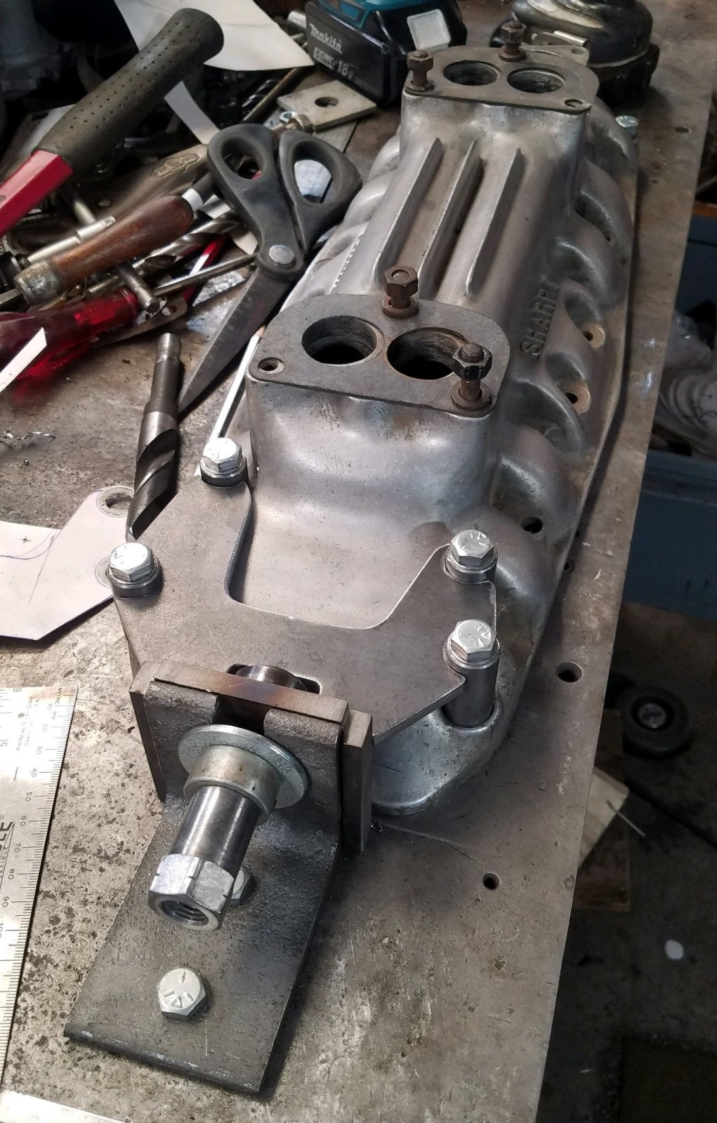

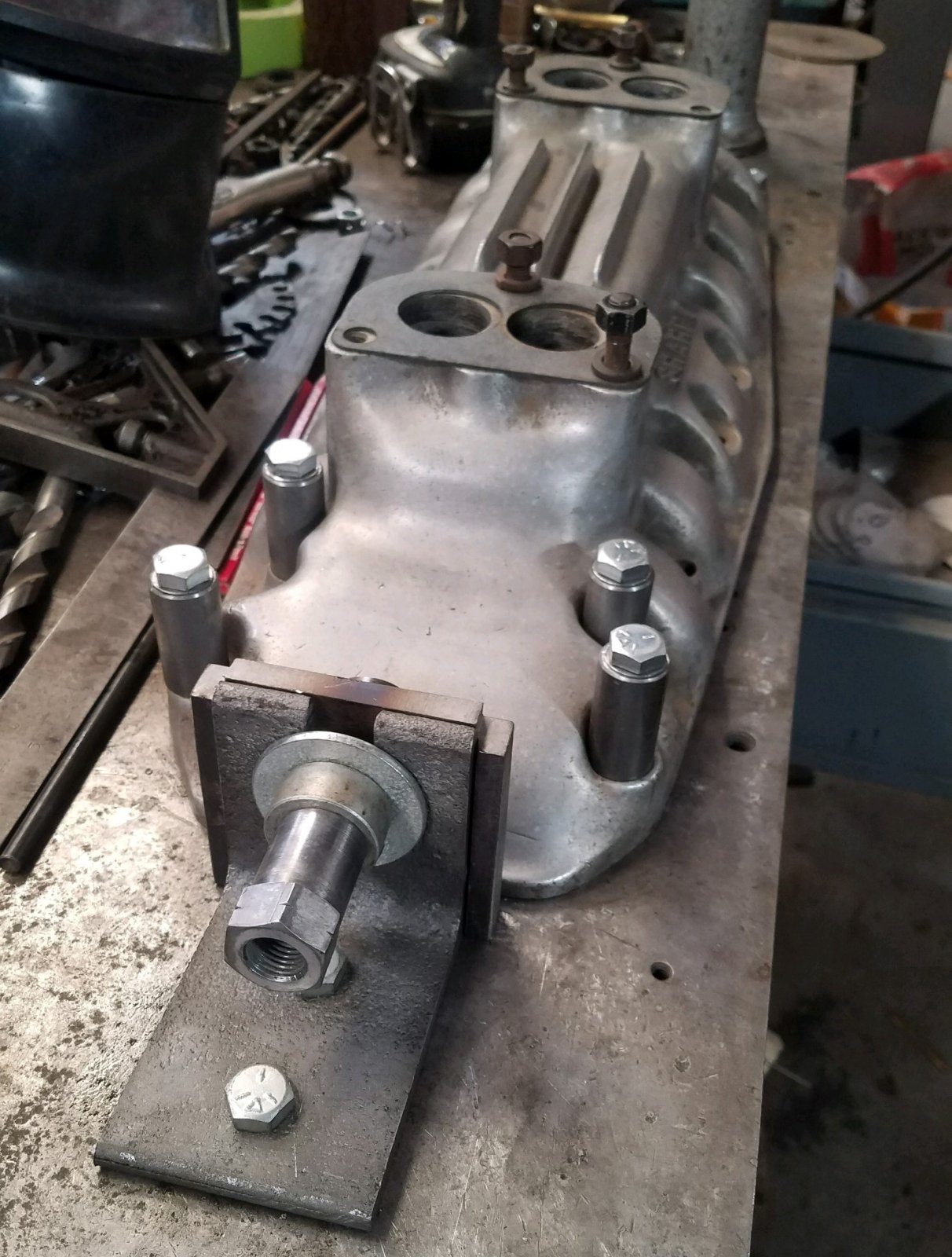

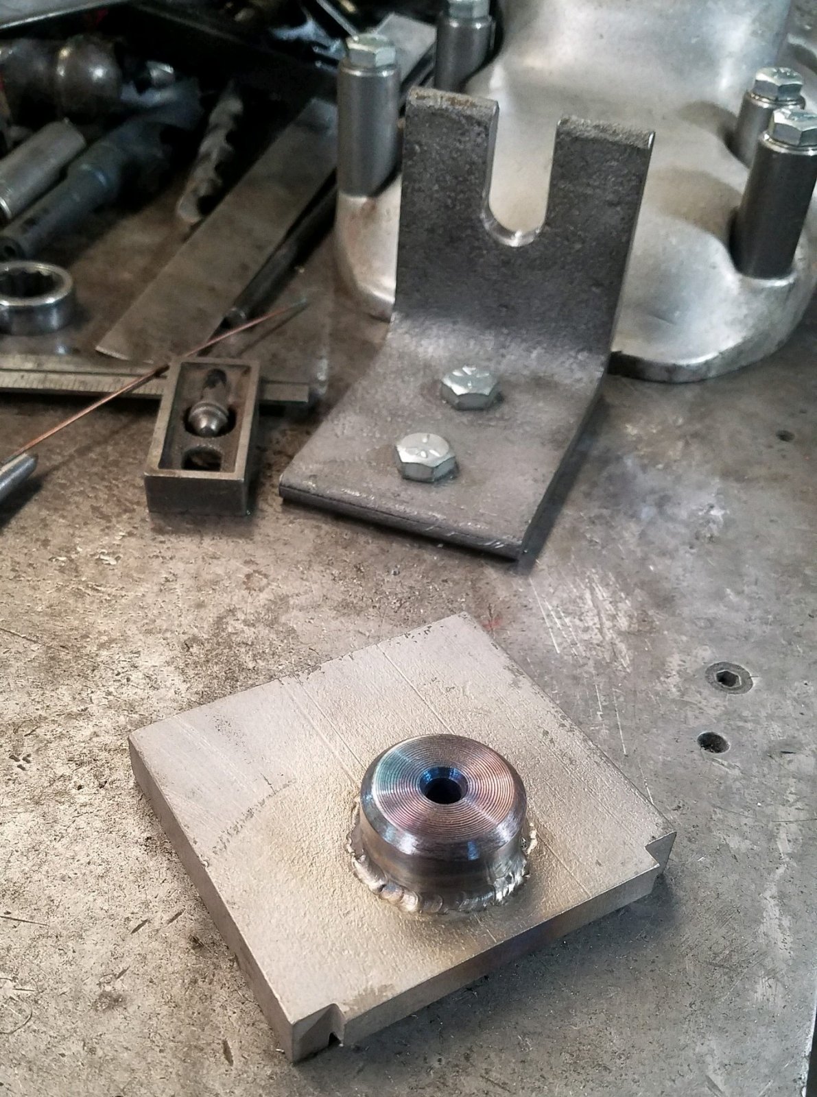

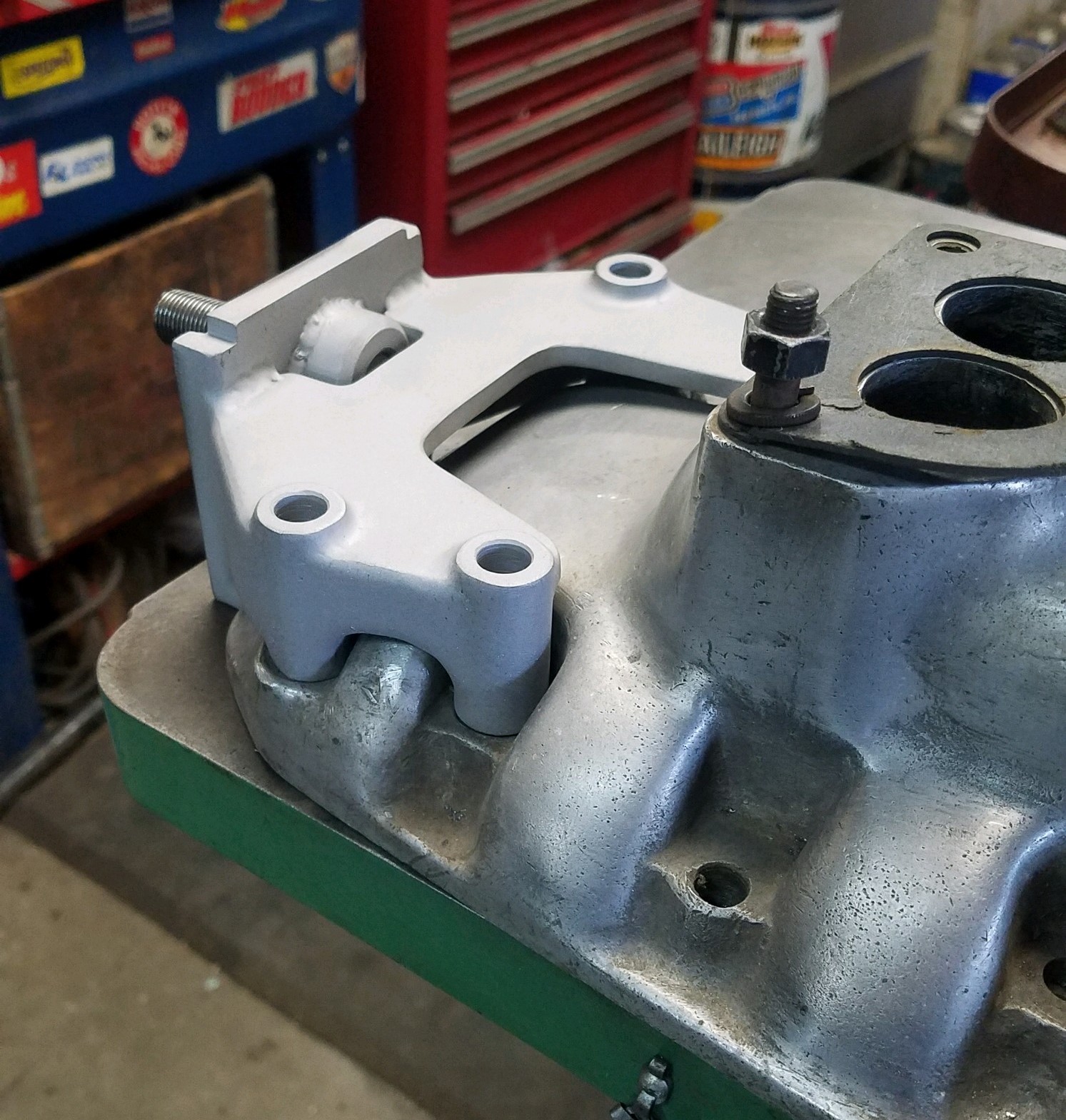

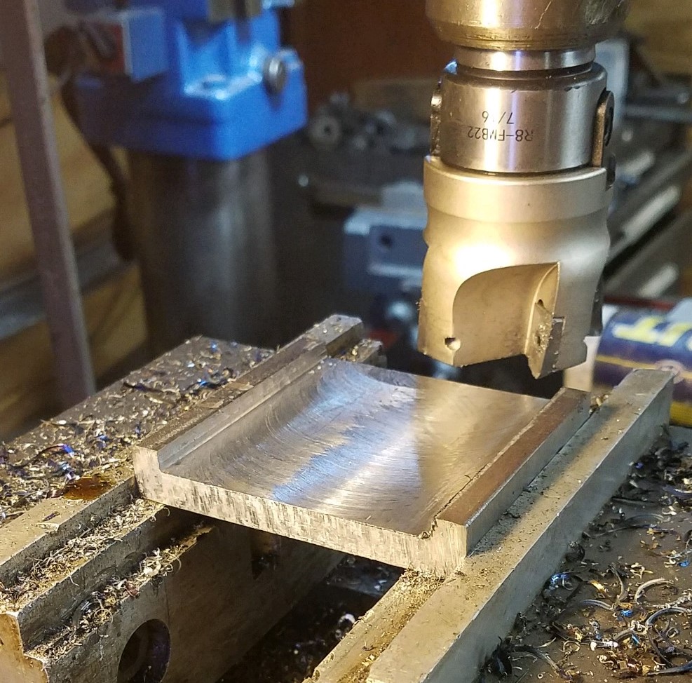

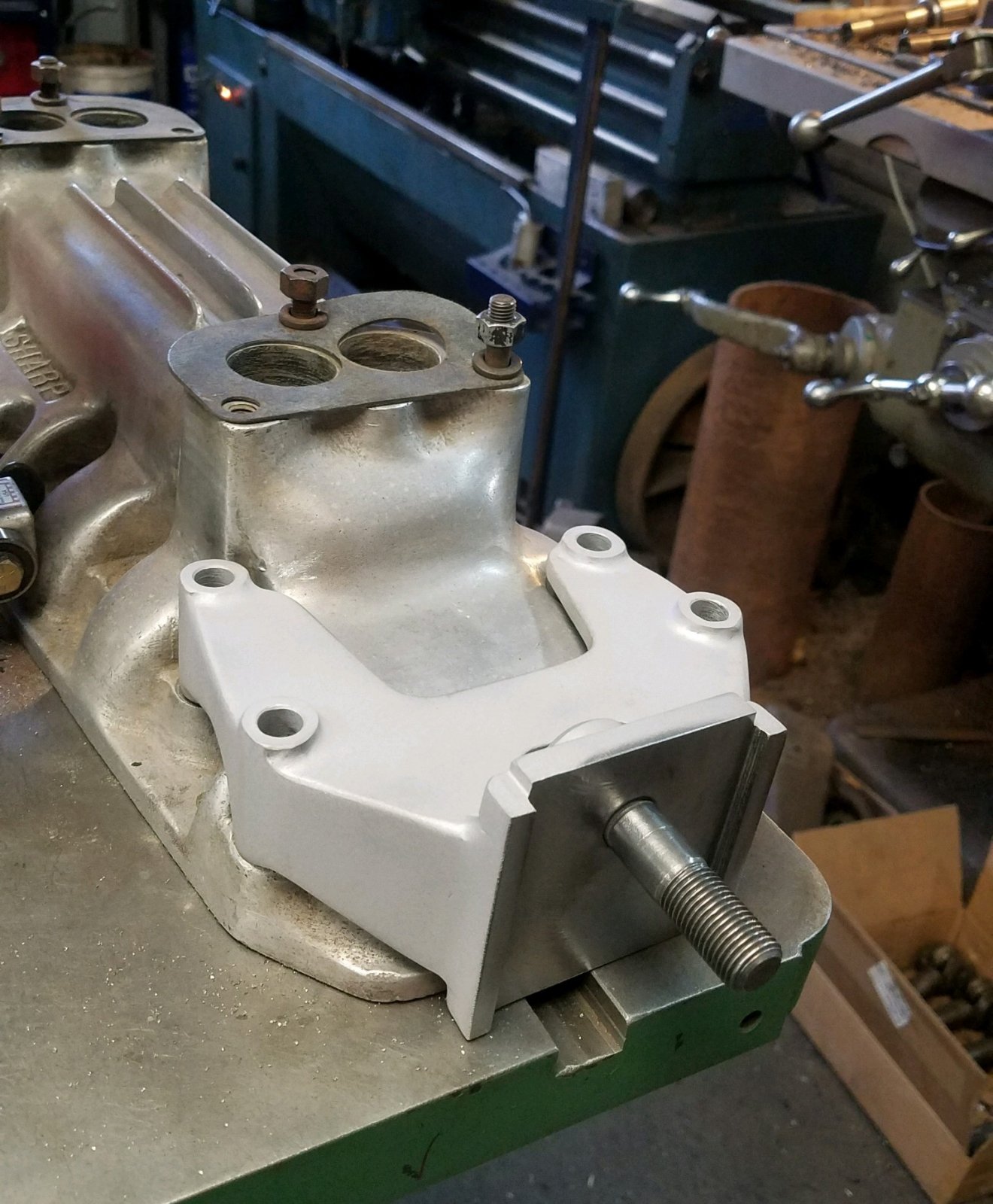

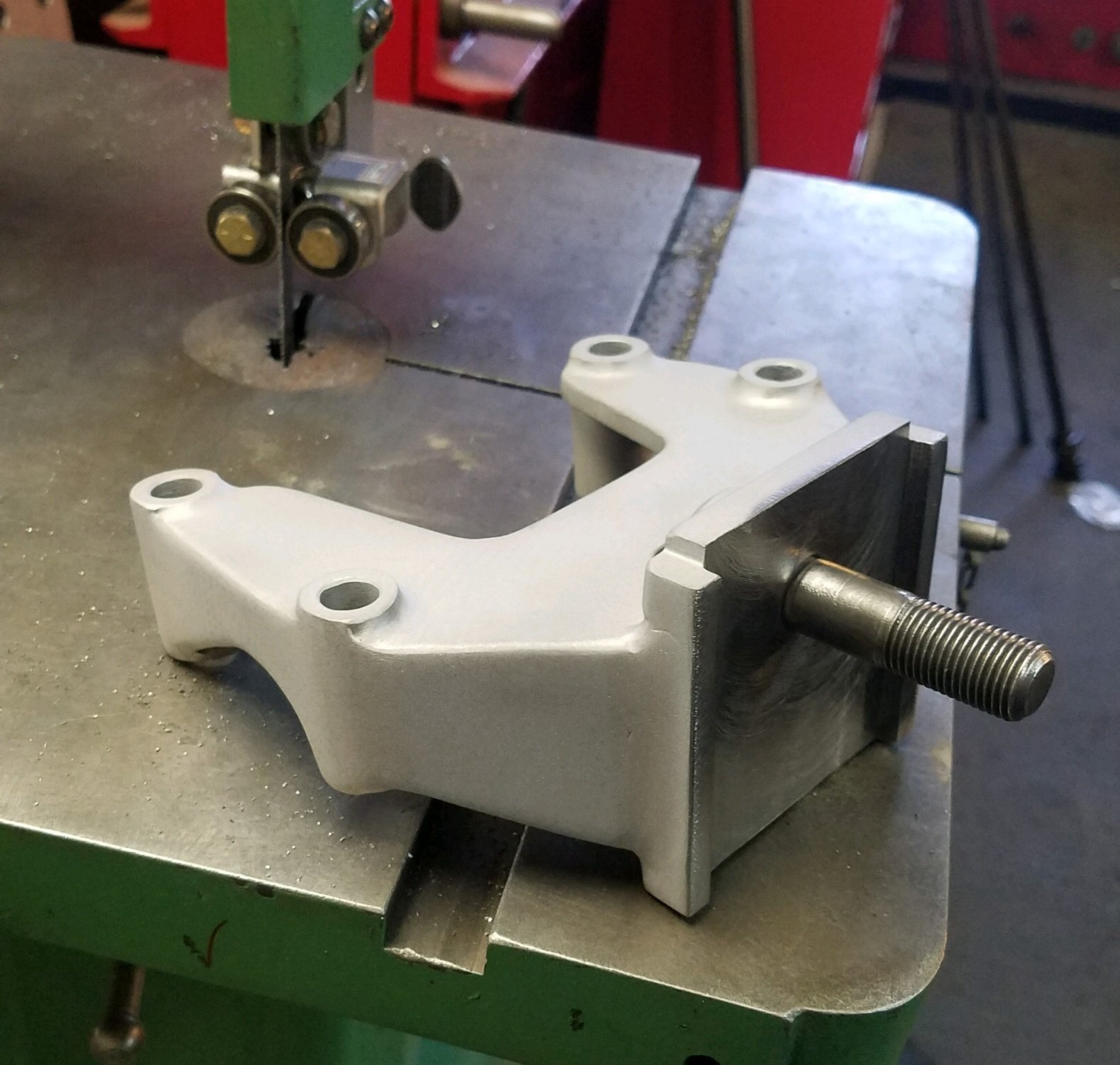

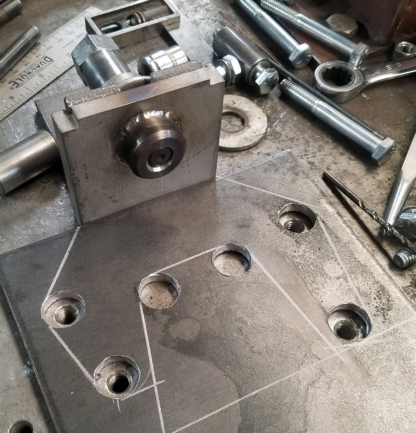

    Not much progress on the pickup this weekend, but I did get an idler/fan bracket made for a friend's 32 project. He is using an Sharp intake without a generator mount, so this is what I came up with...

  30. akoutlaw
    Joined: May 13, 2010
    Posts: 1,644

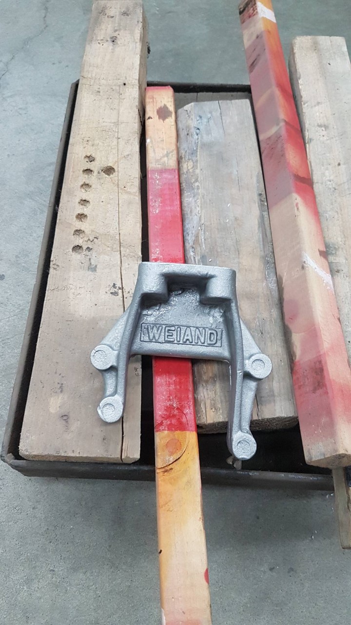

    akoutlaw
    Weiand generator mount 2.jpg Weiand generator mount.jpg That is similar to the one that was offered by Weiand. Here is the unfinished one that I have.
