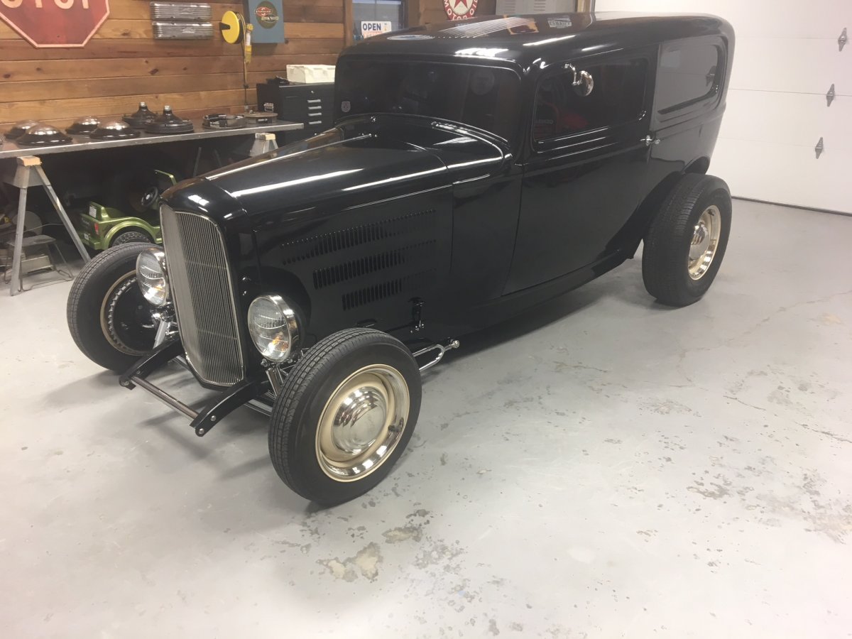

    I have a 32 Sedan with a 350 Chevy, Walker Radiator, with an unknown brand electric fan. It seems to pull pretty decent. The car runs hot when setting a short period of time in traffic. It wasn’t bad until I put hood sides on the car. It had a 180 thermostat but now a 160 and it didn’t change it much. I want to put A/C in it but have to get the cooling problem corrected first. The question I have, (I know it’s been debated on here a lot) would I be better off with a Zips an a manual fan ,or an electric fan such as Cooling Components, or a Flex-a-Lite black magic fan that is 3300 CFM? Also would changing to 25 Louvered hood sides have any cooling affect. The picture shows the hood sides on it now. Any help would be appreciated! Sorry for the long post! Thanks EC57F78A-D084-4F2A-99E1-C81B23282930.jpeg

    I would go with a zip's raised pump with an engine fan and a 25 louvre hood. You need the right ratio pulleys too. This combo has worked for me always. Every body has their own opinion though. Good luck.

    Do you have a proper fan shroud, so the fan pulls air through all of the radiator, instead of just in front of the fan?

  26. Nice looking Car- so you lets say you put your 180 stat back in- and you have a 15 lb cap. Your boiling point will be in the 250 plus range. You are at 220. If you have never boiled over- I would not worry about it.
    There is a reason modern cars have a green ‘normal operating’ range with a red zone way off the the right- with no numbers.
    My advise- stop staring at the gauge and worrying
