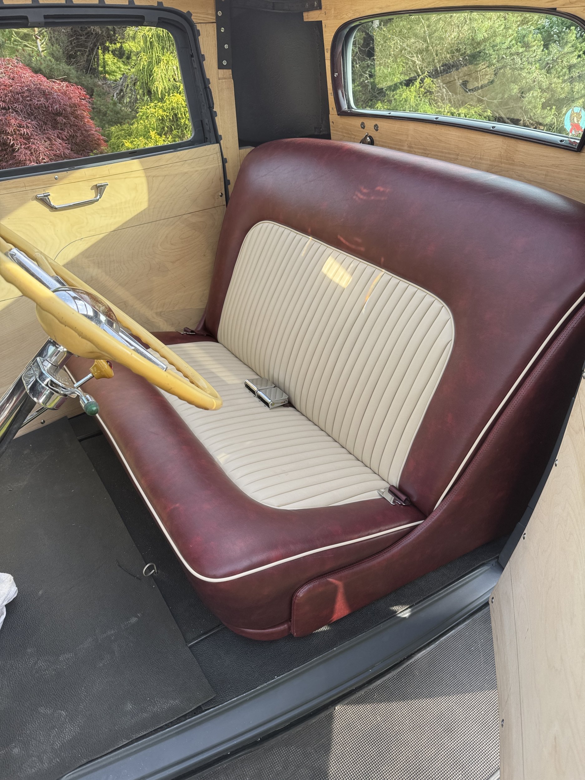

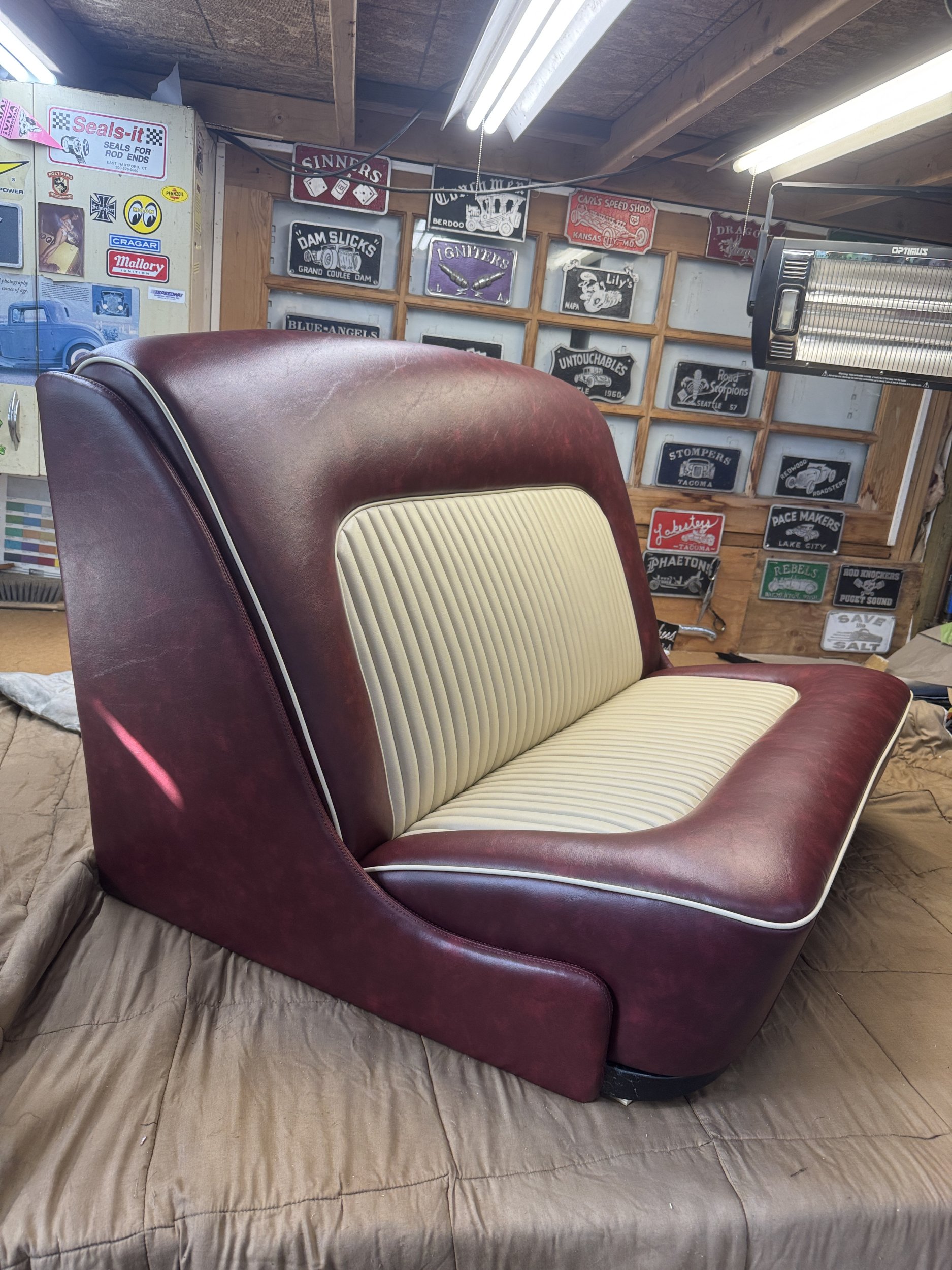

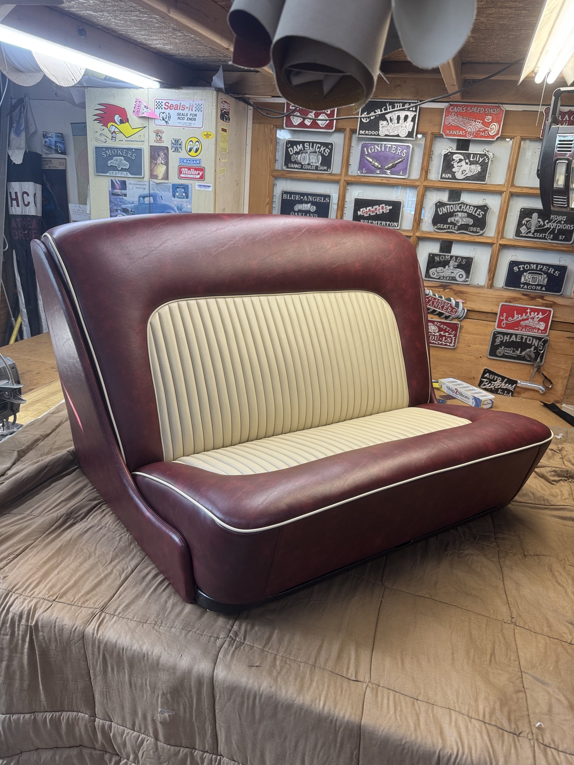

    Here’s a seat I built up for my coupe 15666D42-8E0F-4E41-9D44-ED441850B553.jpeg IMG_5374.jpeg IMG_5378.jpeg IMG_5393.jpeg IMG_5416.jpeg IMG_5498.jpeg IMG_5499.jpeg IMG_5163.jpeg IMG_5166.jpeg

    looks fantastic! top job

    Impressive! What kind and how thick was the plywood?

    Carriage boards are 1/2” back is 3/4”

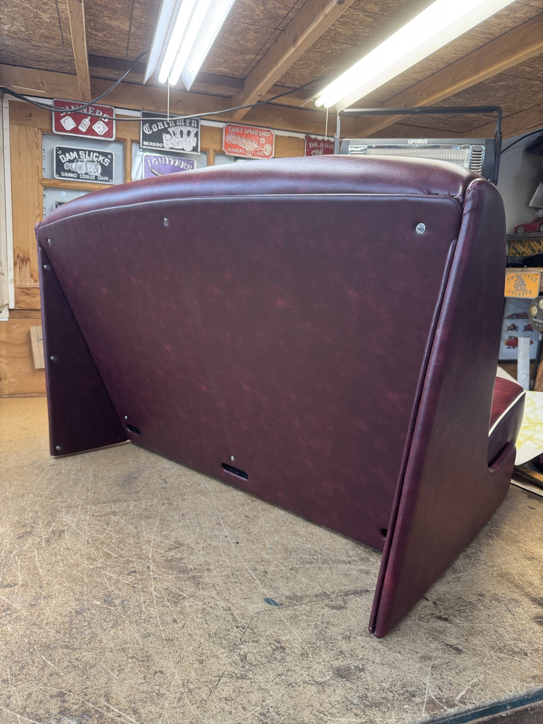

    The bottom is all foam, but the back has springs, right? Can you tell us why you didn’t use all foam in the back too? I can testify that original 32 springs under your **** are rather bouncy and will rock you from side to side. I understand the reason for the foam base.

    I would have used the spring on the cushion also but is made it too high
    The foam can be made any height, I used the backrest spring because I had it

    You did fantastic work . And you have researched , the seat springs to raise you up rather high vs. foam seat . I noticed this about finishing the real springs in my 32 . Really high in the saddle !

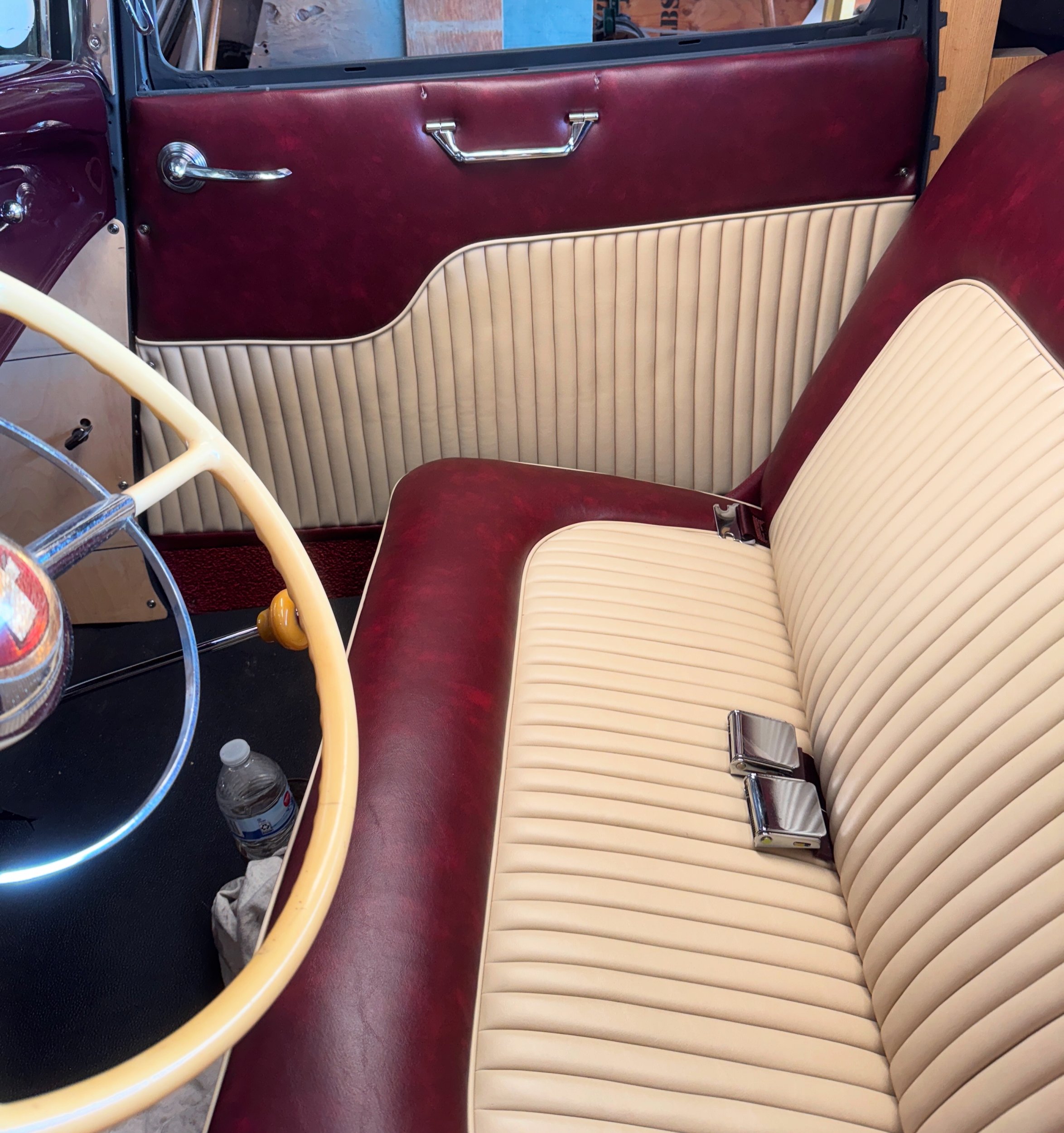

    Very nice! I dig the colour scheme, cream rolls and piping opposed to the burgundy. Trad but not "Grandpa" or too bright, and cohesive with the wheel.

    Great job on the seat and the door panel

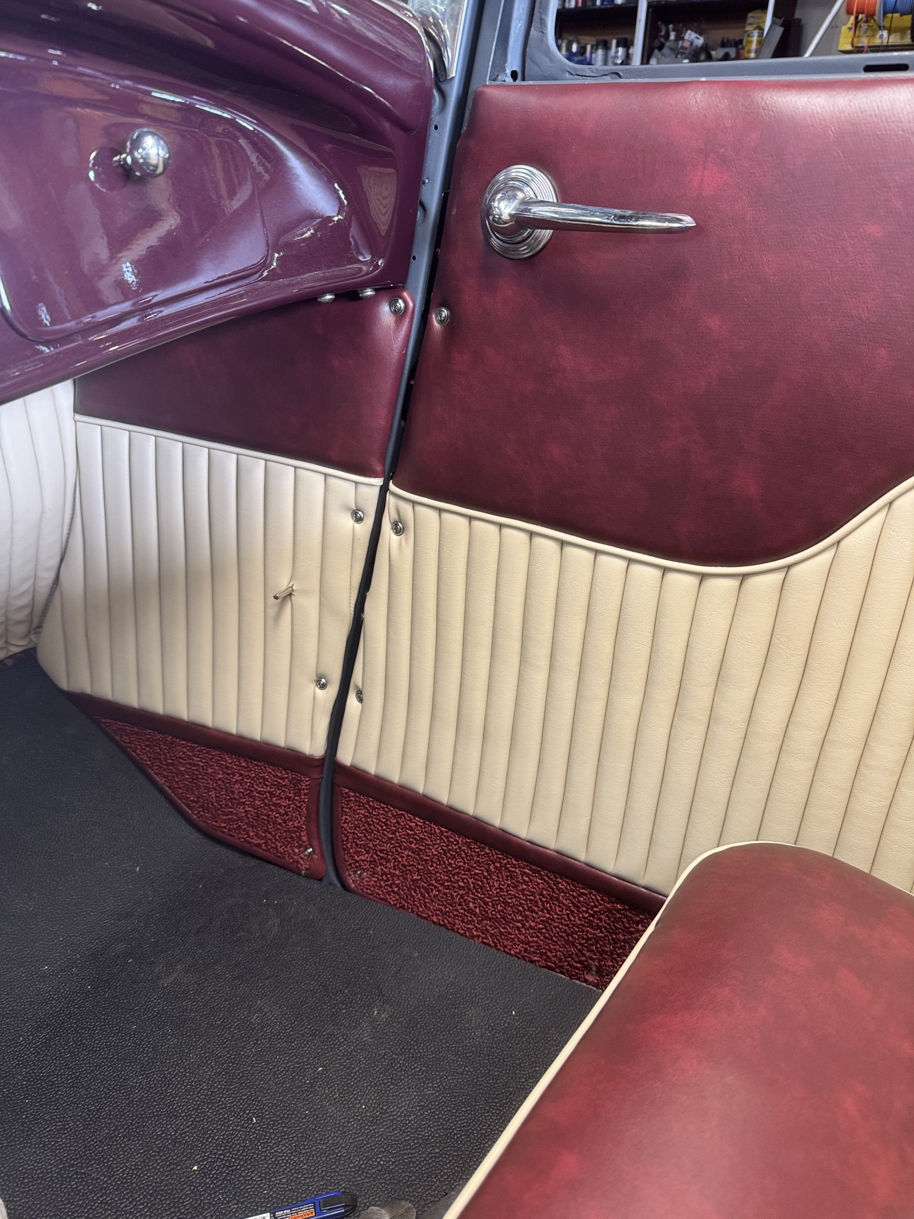

    Would you share any details on the construction of the foam seat base; like grades of foam used & why along with adhesive used to laminate the pieces.

    53 lb foam for the cushion
    Or very dense if you will
    The bolster is also very dense
    I also put a layer of 1” Dacron batting on the bolsters
    Glue is landau top adhesive, same as every upholstery shop uses, sprayed from a cheap siphon gun

    Can I ask... what's the purpose for the oval shaped cutouts in the lower portion of the back?
