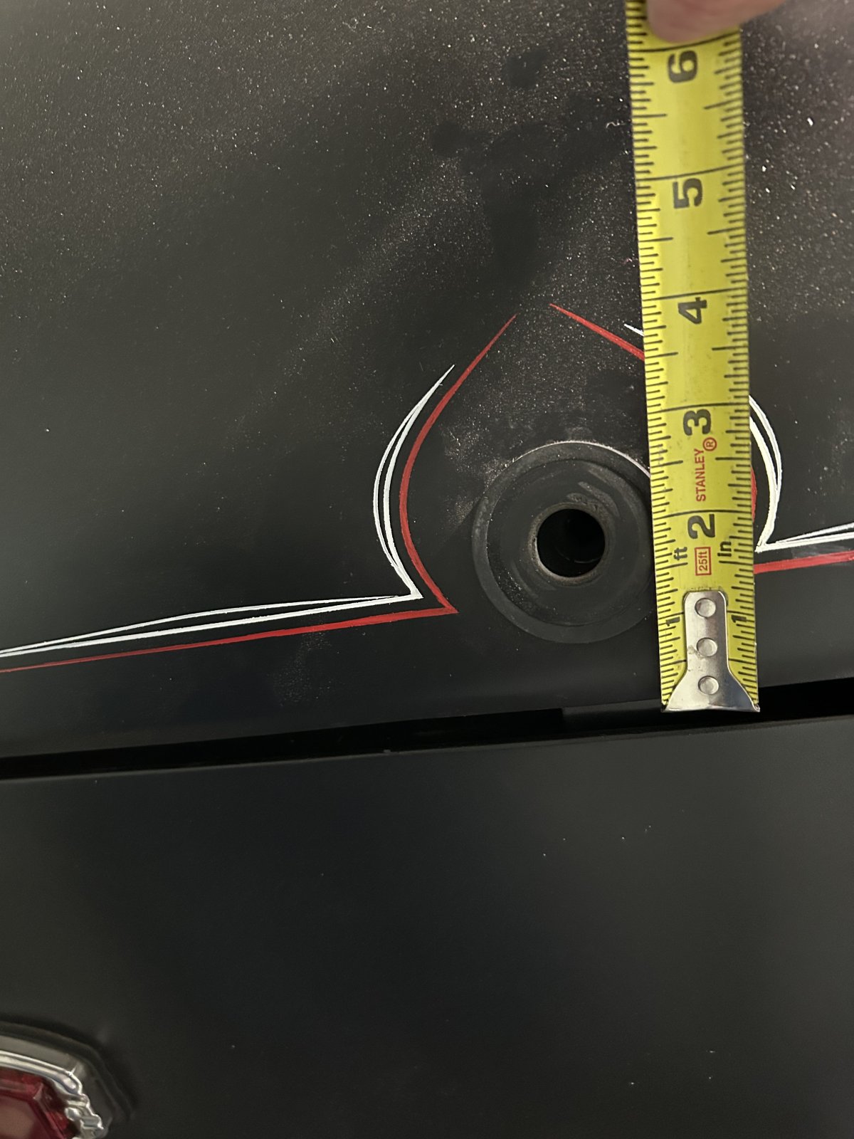

  12. How do you want the measurement. Picture with a yard stick taped in place
    19Eddy30 likes this.

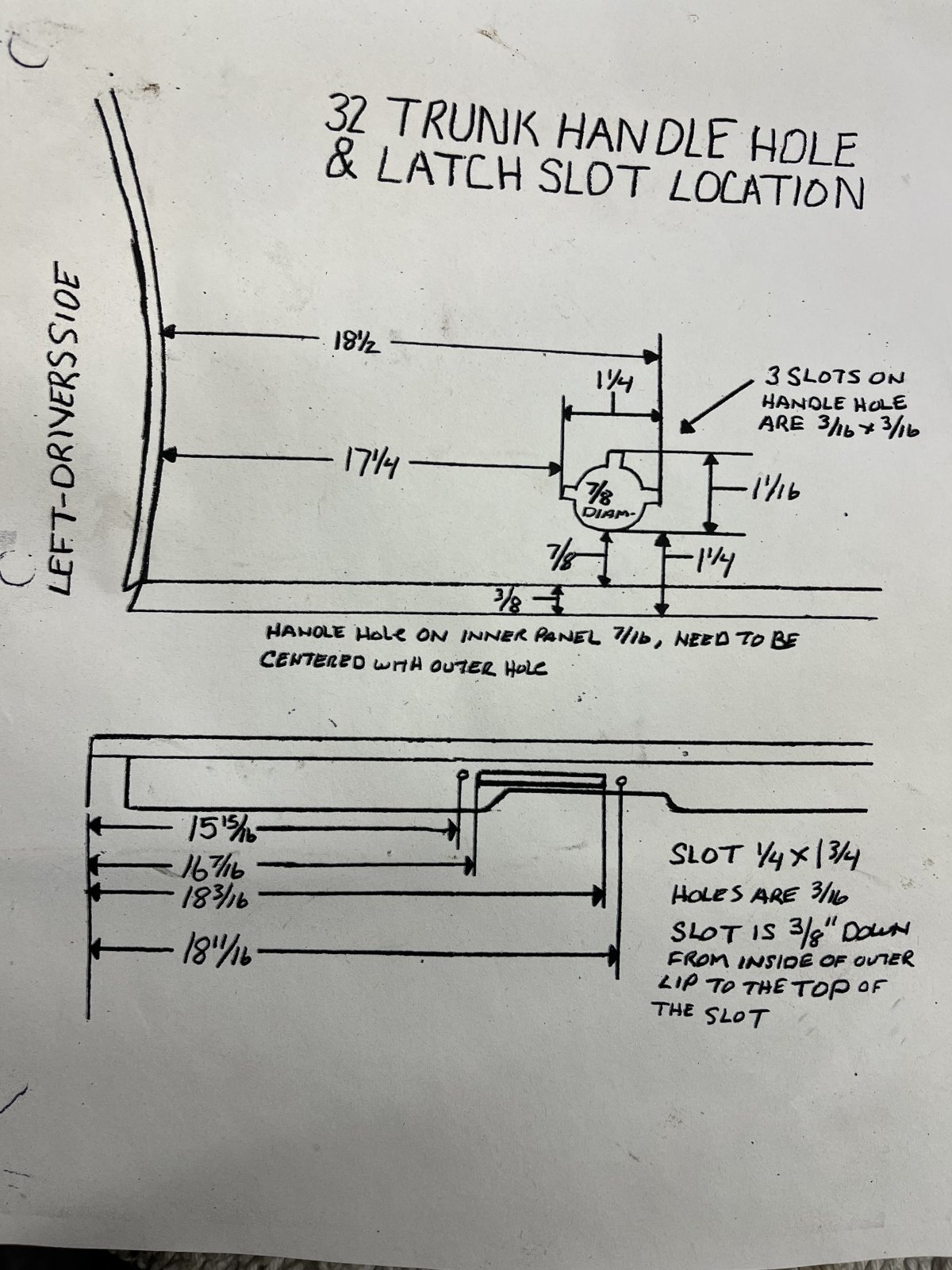

    325W- - - -Thank you so much! That is exactly what I needed. It's funny in that back in Nor Cal in the 60's. guys used to turn the handle facing down instead of up. Said it looked "Dorky" Ahhh well to each his own huh?
    Thanks again,
    Jon
  17. You probably have it done by now, but if not, these are dimensions from Brookville
    V8-m likes this.
