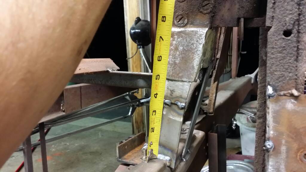

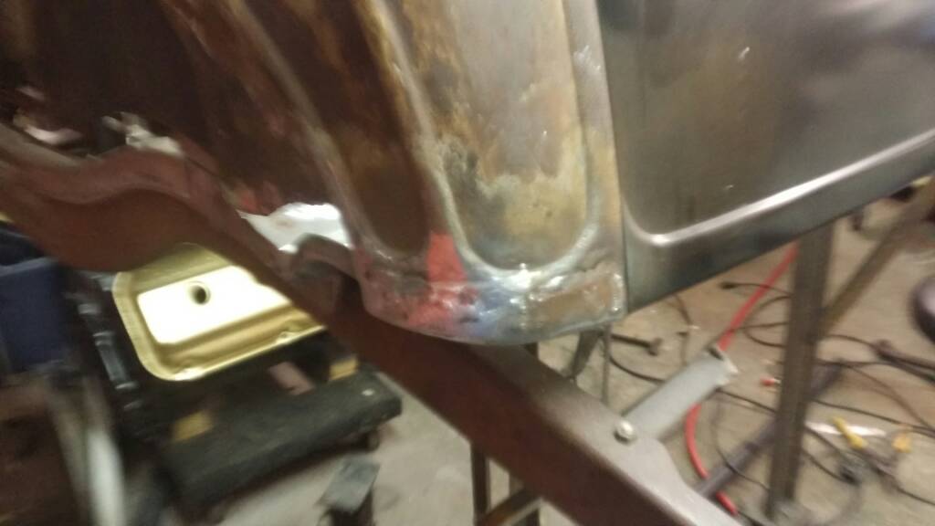

    1437696492951.jpg OK so here is the latest progress after getting the body set up on the frame there were a lot of question marks like where to start welding after taking hundreds of measurements and staring at it for a while I just decided to start welding the a pillars and the move on from there. The measurement I came up with for the front a pillar is 7 1/4 inches from the sub rail to the crease of the bottom hinge plate body line. And I did it exactly the same way on the other side

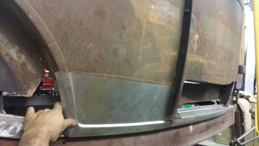

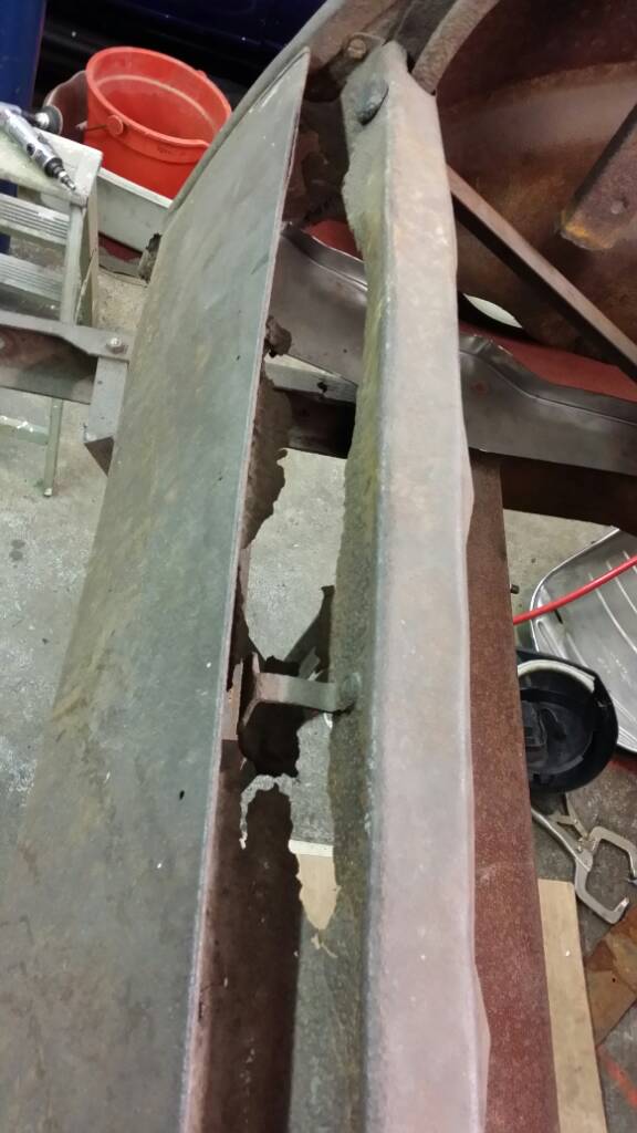

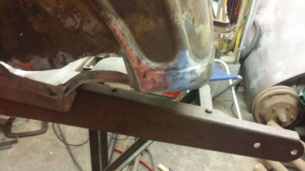

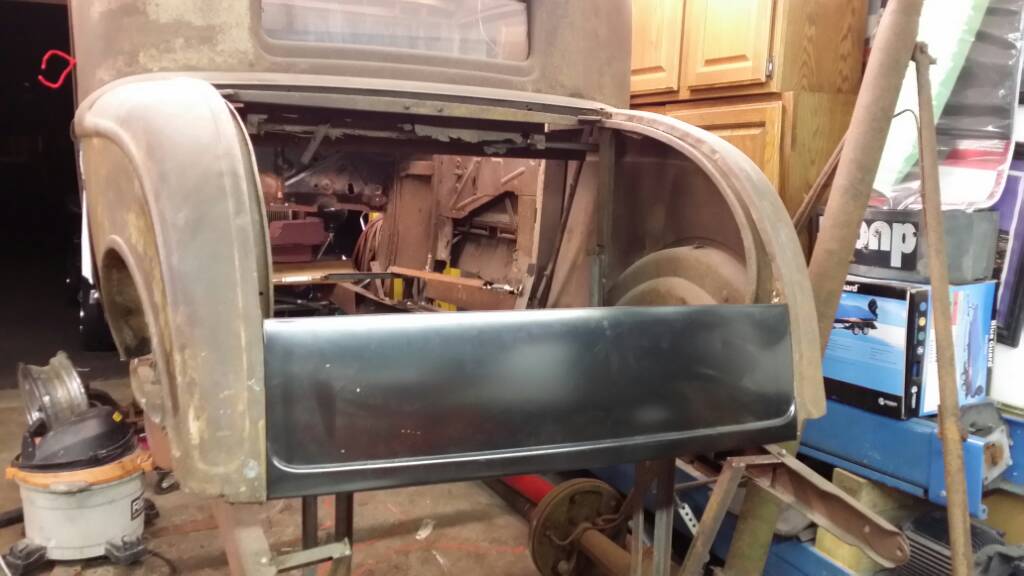

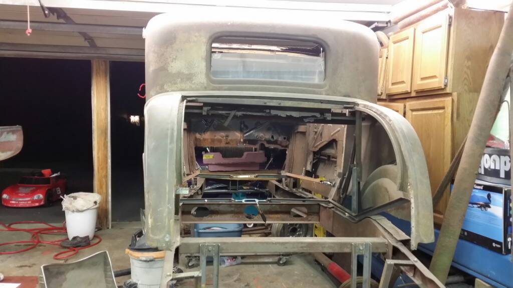

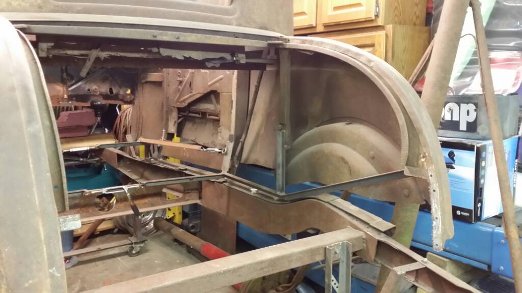

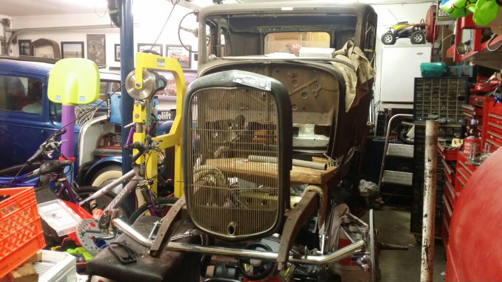

    1437778617288.jpg 1437778640017.jpg 1437778658071.jpg So now once I got the B pillars welded and the door gaps looking good now I need to get the rear of the body lined up to get a square trunk line. Because this car sat in a field for 30 years the metal has taken a different shape and the whole body is out of proportion. So now it's time to cut this old body panel out and replace it

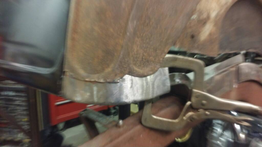

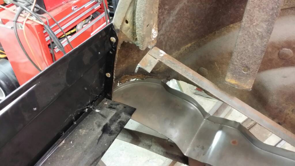

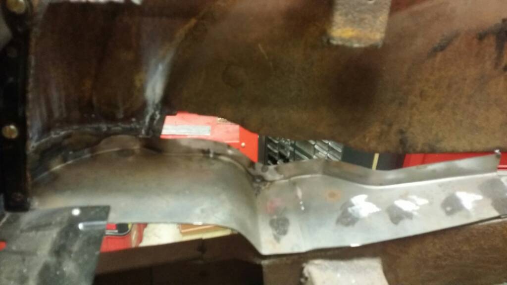

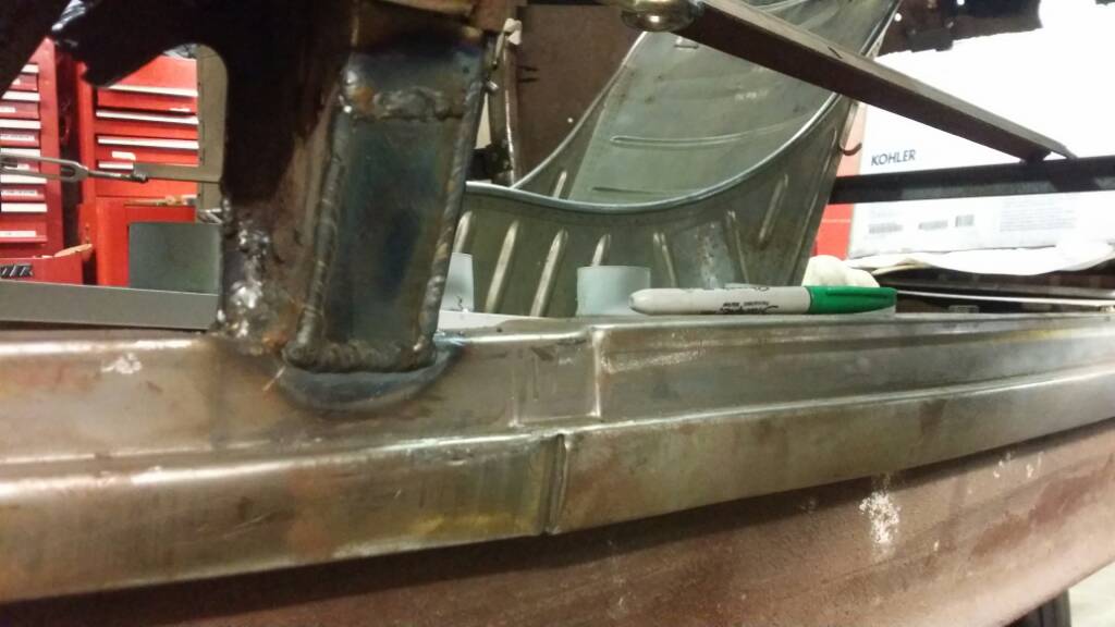

    1437778808445.jpg 1437778838250.jpg 1437778867787.jpg 1437778885055.jpg 1437778905262.jpg 1437778922677.jpg So saw all it is. After a lot of grinding I got it out

    For those of you guys out there who have a body in the same shape now you can see how the Brookville 32 roadster sub rails and extentions work out. The body panel is from socal speed shop

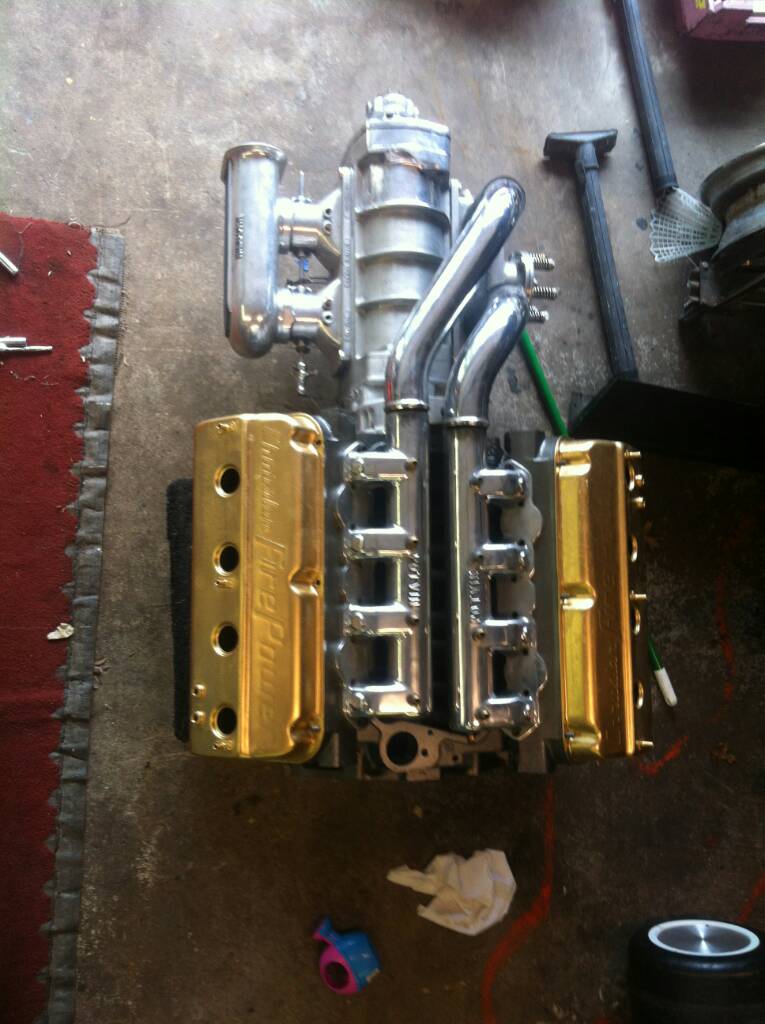

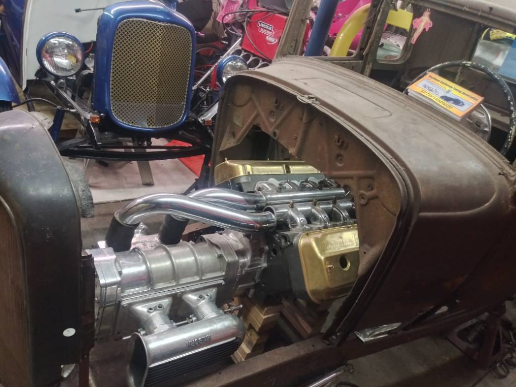

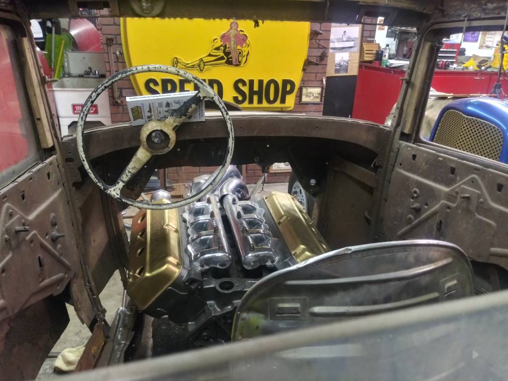

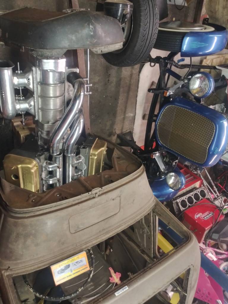

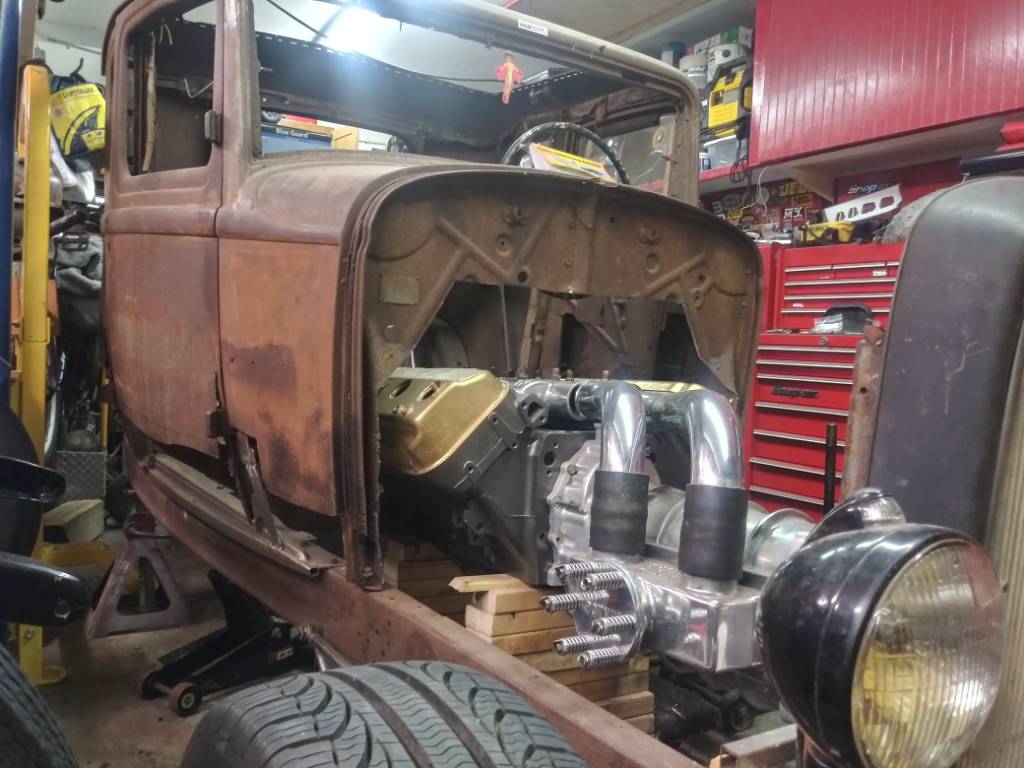

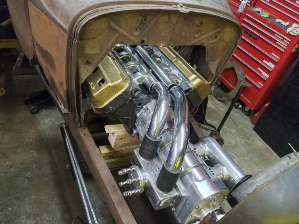

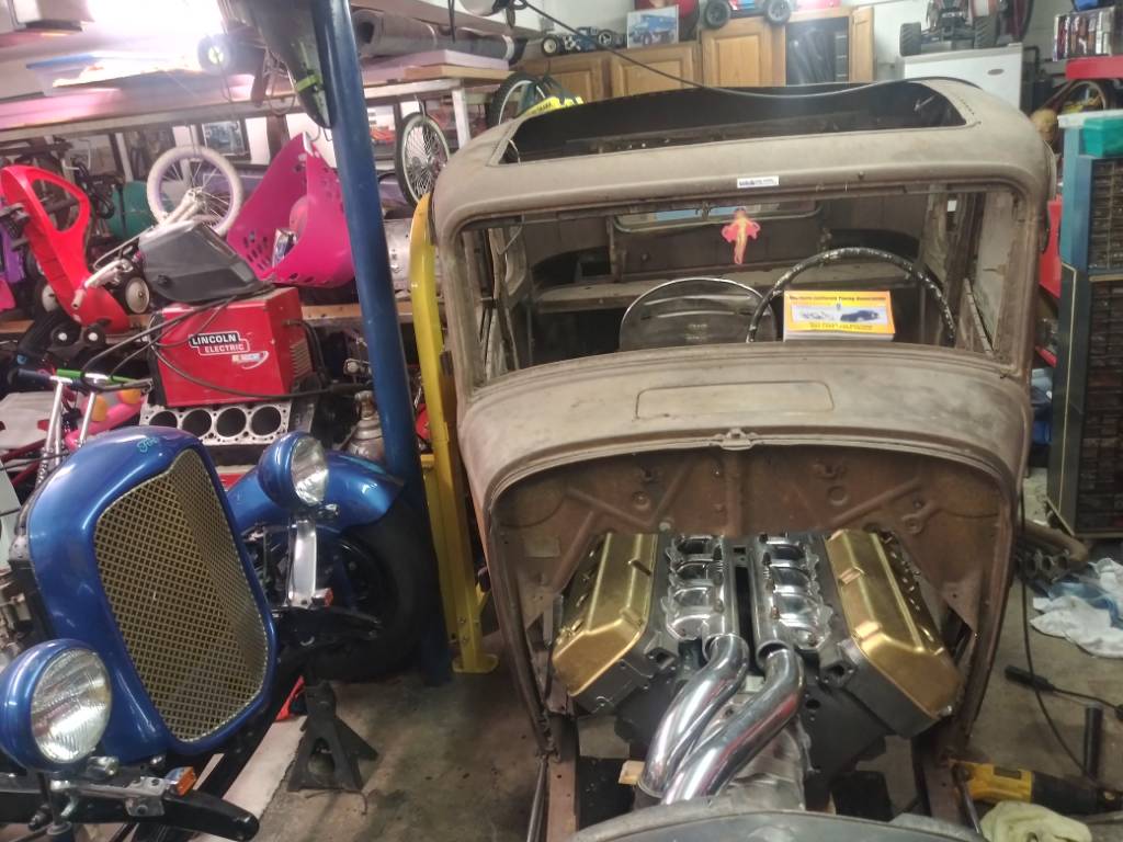

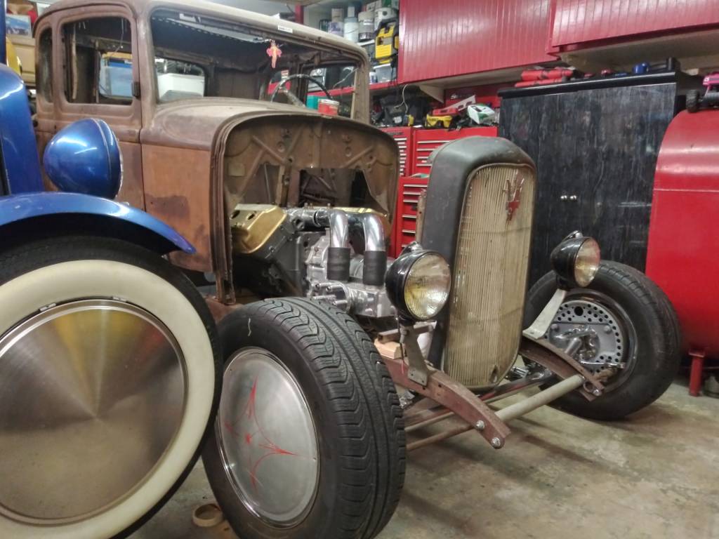

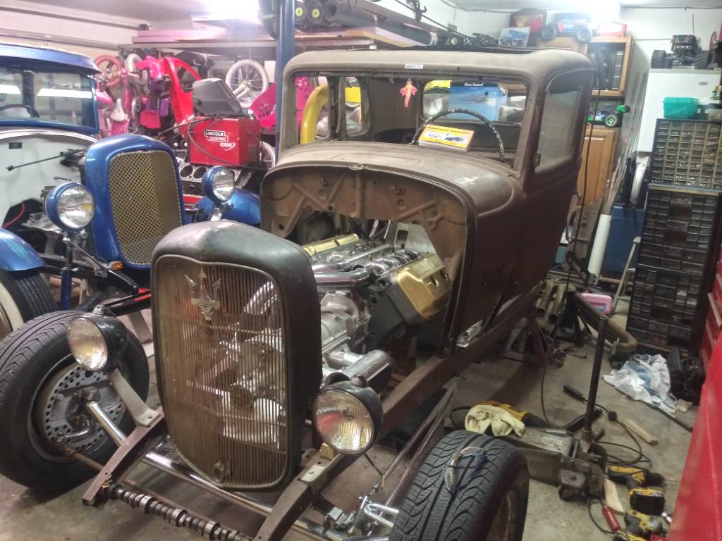

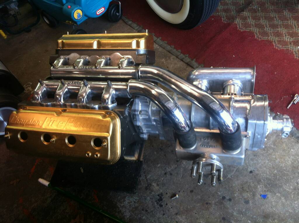

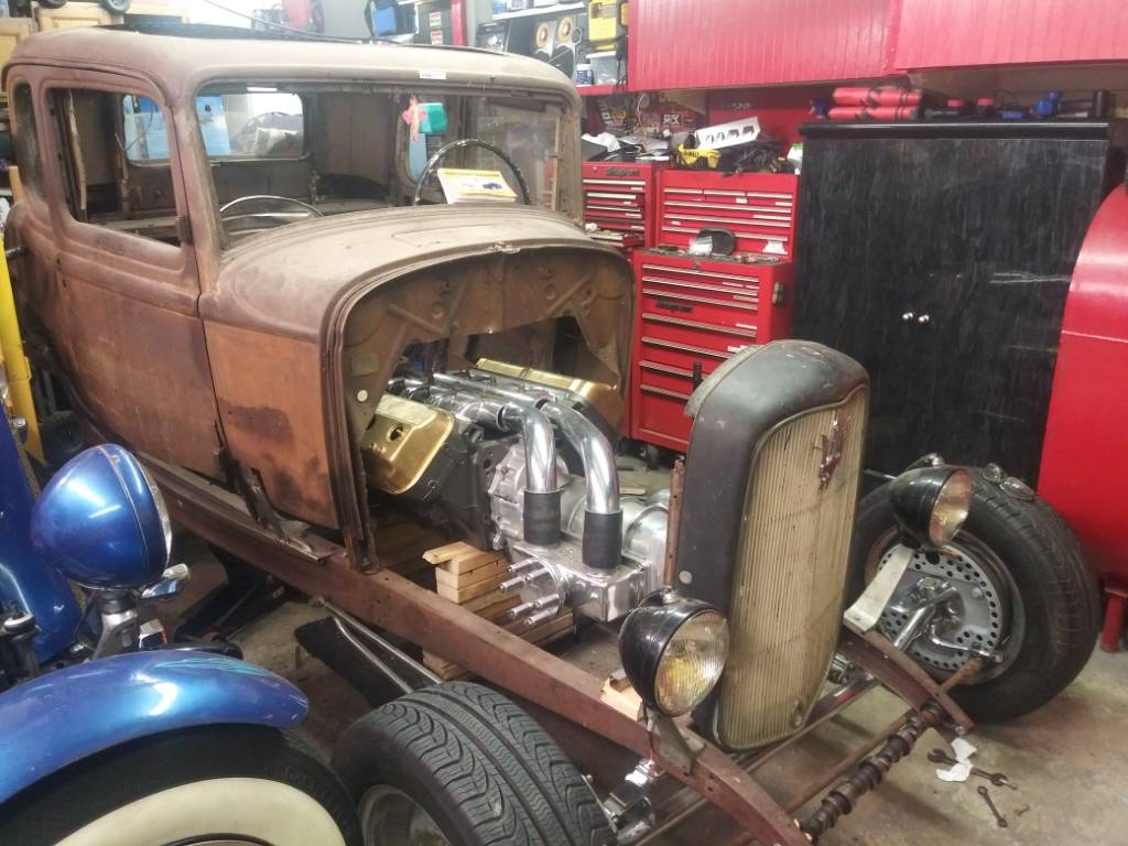

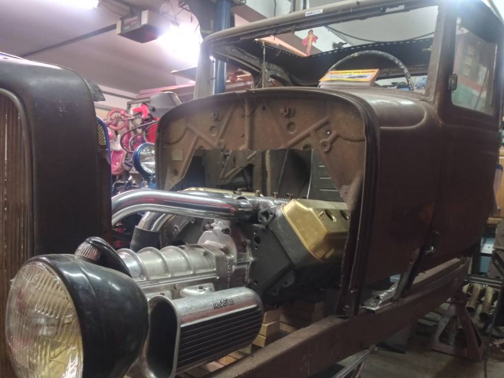

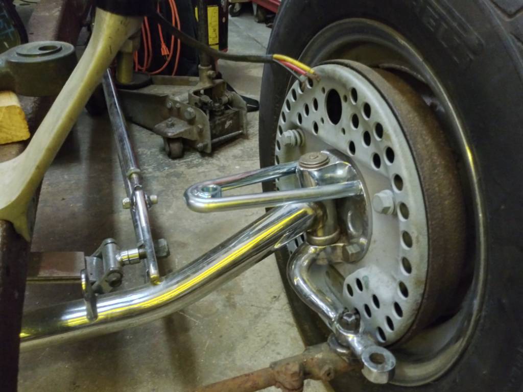

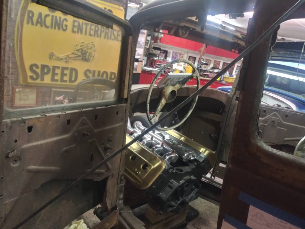

    My steering arm came In and I had to throw it on right away . From speedway only 19$ and looks period too. My dad had these old von Dutch striped moons. He told me they were striped by Kenny the mad striper who ends up to be Von Dutch. I think they fit the warn look had to cut out a little more of the fire wall and bring the engine up a little more because the injector is only a 1/4 inch from the frame rail on left and pressure release is about the same on the right. Still trying to keep the engine as low as I can. 20210129_220220_HDR.jpeg 20210129_220244_HDR.jpeg 20210129_220440_HDR.jpeg
    Sent from my LM-Q720 using The H.A.M.B. mobile app

  30. Corn Fed
    Joined: May 16, 2002
    Posts: 3,406
    Corn Fed
    Are you planning on running the tie rod in front of the axle or do you just have it that way to roll it around?
