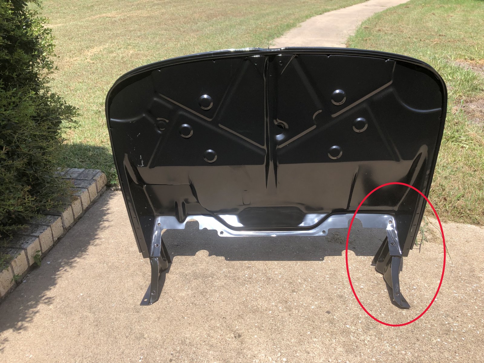

    Hey y'all, I have a quick 32 firewall question. I've now received two firewalls from United Pacific and on both of them one leg is bent inward. The first one I thought it had gotten bent in shipping as the box was fully boogered up. The second one (See attached photo) has got the same leg bent inward as well. I'm new to 32s so my question is...is it supposed to be like that? I could bend it back but I'm concerned the rivets at that leg could pop due to where it's bent Firewall.jpg .

    Looks like something is a miss . Both sides should be sitting on the same flat area of the frame . Notice how lt side is flat on the ground , and rt side is somewhat raised . It’s bent . I would contact them again with photos . It can be fixed , but it was supposed to be new and not need any repair work .

    I've had a couple like that and I just bolted the left side to the frame and pulled the right leg into position. Contacting them will probably not get much of a response. I bought body number 11 and it was POS. They had plausible deniability.

    No, it's bent, as already said.
    As a thought, I wonder if these get drop shipped from somewhere? Or, if not, when UP receive the parts from the manufacturing facility (off shore)...do they check them before selling to customers?
    I don't expect anyone to have answers, but this is another example of businesses selling products blindly. I mean if you're selling a 4 leg table, you need to make sure it has 4 legs before sending it to the customer.

    I serious thinking this is another off shore product or purchased from someone who is importing . It can be fixed , but you should not have to fix it .

    No, as Krylon32 said, pull it back.
    ( sometimes it is quicker to fix the problem than spend copious amounts of time trying to get them to fix it, - not the right way to go about it, but often the easiest).

    Thanks for the replies y'all. I think I'll go with what @clem and @krylon32 suggested to do. I really don't want to have to mess around with trying to get a third replacement. As a side note I bought a fair amount of parts from UP directly all at once (Figured I'd start a relationship with them and that the original company would be easier to deal with) then had to return them. It was a total pain in the *** as they are pretty inflexible and don't discount their parts very often. I should have bought them from one of their distributors who have more leeway in returns and pricing parts cheaper.
